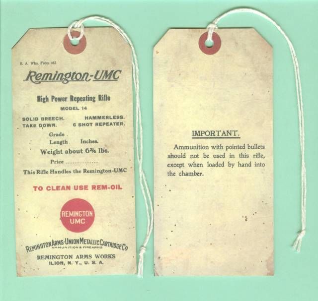

For whatever its worth you should NEVER use ballistic tip or ANY pointed ammunition in these rifles, nor should you use hard cast lead bullets unless you load them directly into the chamber. The rifle was designed in 1910 to use only pristine RN ammunition and in fact came with a "hang tag" that states exactly that. The feed system is designed for RN only and after 50+ years of doing repairs on these I can tell you that ballistic tips was a boon to my business because little slivers would shear off jamming the feed system, same with hard cast bullets where tiny seemingly harmless slivers can get in places where you don't want them.
Not trying to be overly sarcastic here but you stated "your other rifles" as pertaining to them cocking BUT the thing is these are not like other rifles, a unique design like no other, and they are really-really fussy about the ammunition you put through them. Based on my experience and that of other experienced Model 14/141 owners, use 200gr RN bullets, always use a factory crimp die, set your seating dies using an original factory round, don't reload brass more than 2-3 times because the feed system is brutal to the brass. Original brass is hard to find but Hornady stuff works great but the feed/eject system will beat up/nick the edges and after cleaning them 2-3 times they become just enough under size so they eject poorly.
Will try to attach a picture of an original hang tag but one more "tip" is you will need to "snug" up the stock bolt after each 40 rounds or so, they shoot loose, and when they do the stock bolt will flex against the stock causing it to crack. The stock design is weak to begin with because of pilot holes necessary for shaping the stock located where the wood meets the frame are essentially "crack starters" and now the wood is near or over 100 years old.
Do what you think best but the above is the best information I can provide!

Thanks for the insight, Jim! That tag is cool! I save old stuff like that, too.
There's lots of conflicting information about these rifles out there and it's good to hear from someone who really knows them. What I had heard from many sources was that the spiral flutes in the magazine tube were to allow pointed bullets to offset to avoid a magazine tube detonation. The FTX ammo I bought were mostly for the brass and the opportunity to initially test fire it with factory ammo. The FTXs were the only .35 Remington ammo I could find at several LGSs. I tried the FTX bullets in my .30-30s and none of them liked them for accuracy vs 150gr and 170gr RNs. I already have a few boxes of Hornady 200gr RN bullets on the way for my 14. I'm also going to try the Speer 180gr FN when I can find them. Unless the 180s shoot much better, this rifle can expect a steady diet of the Hornadys. I won't be shooting it often enough or far enough that I need to get too creative.
