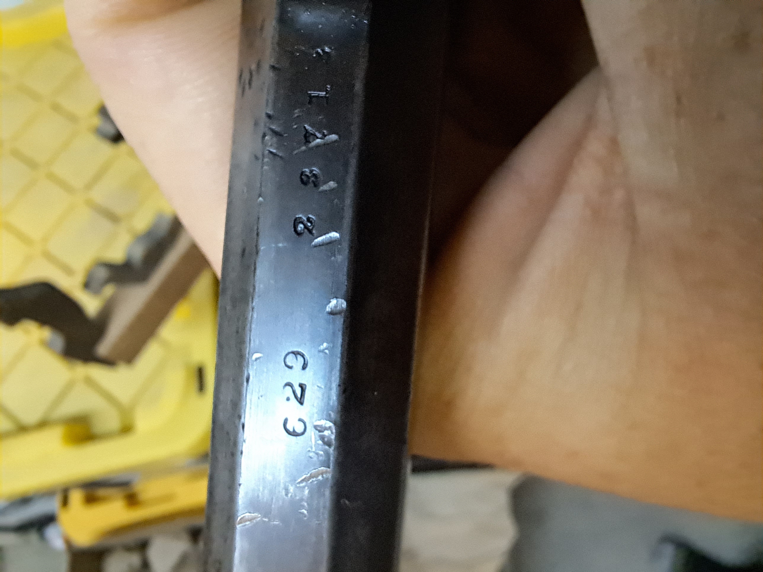

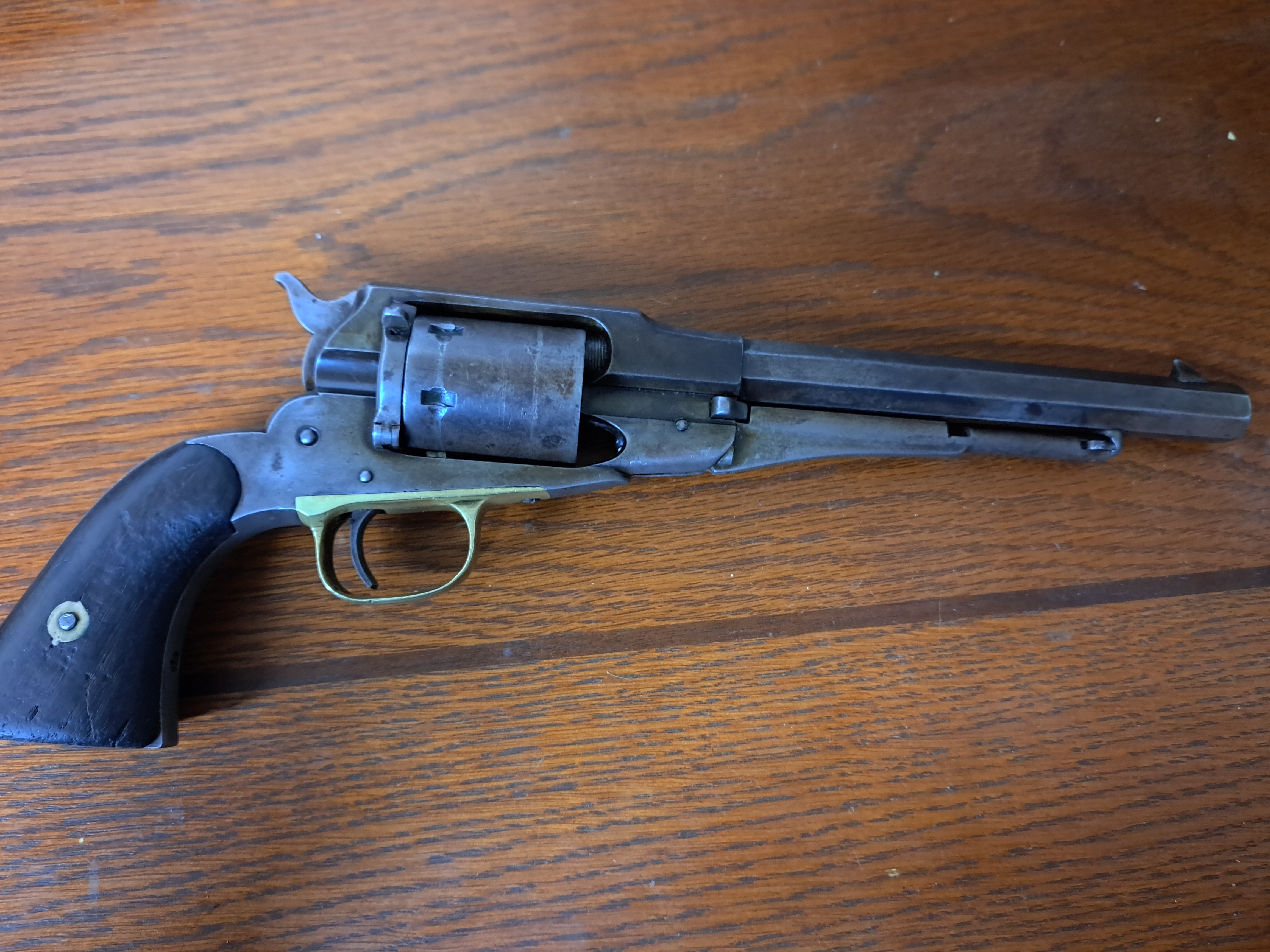

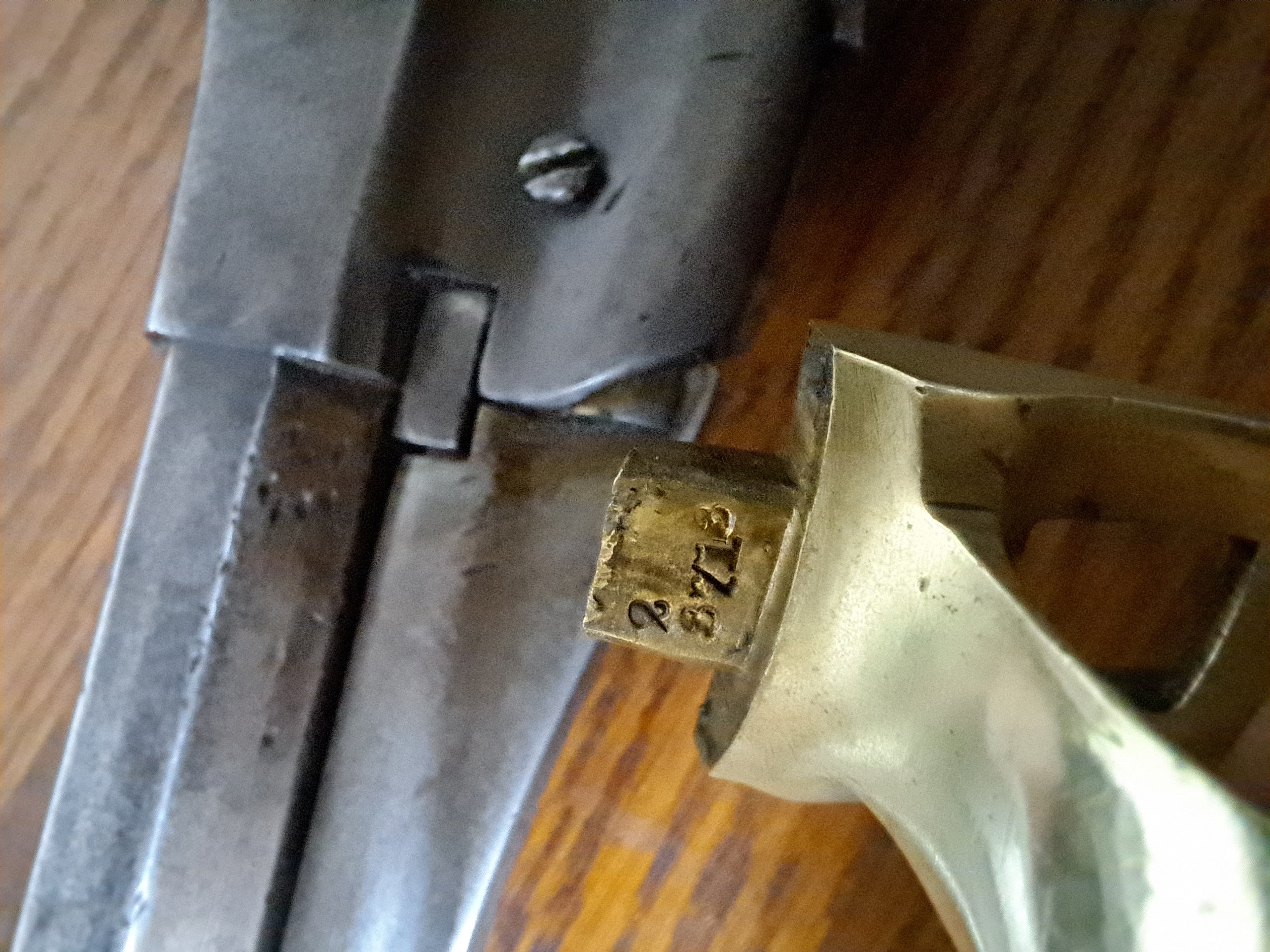

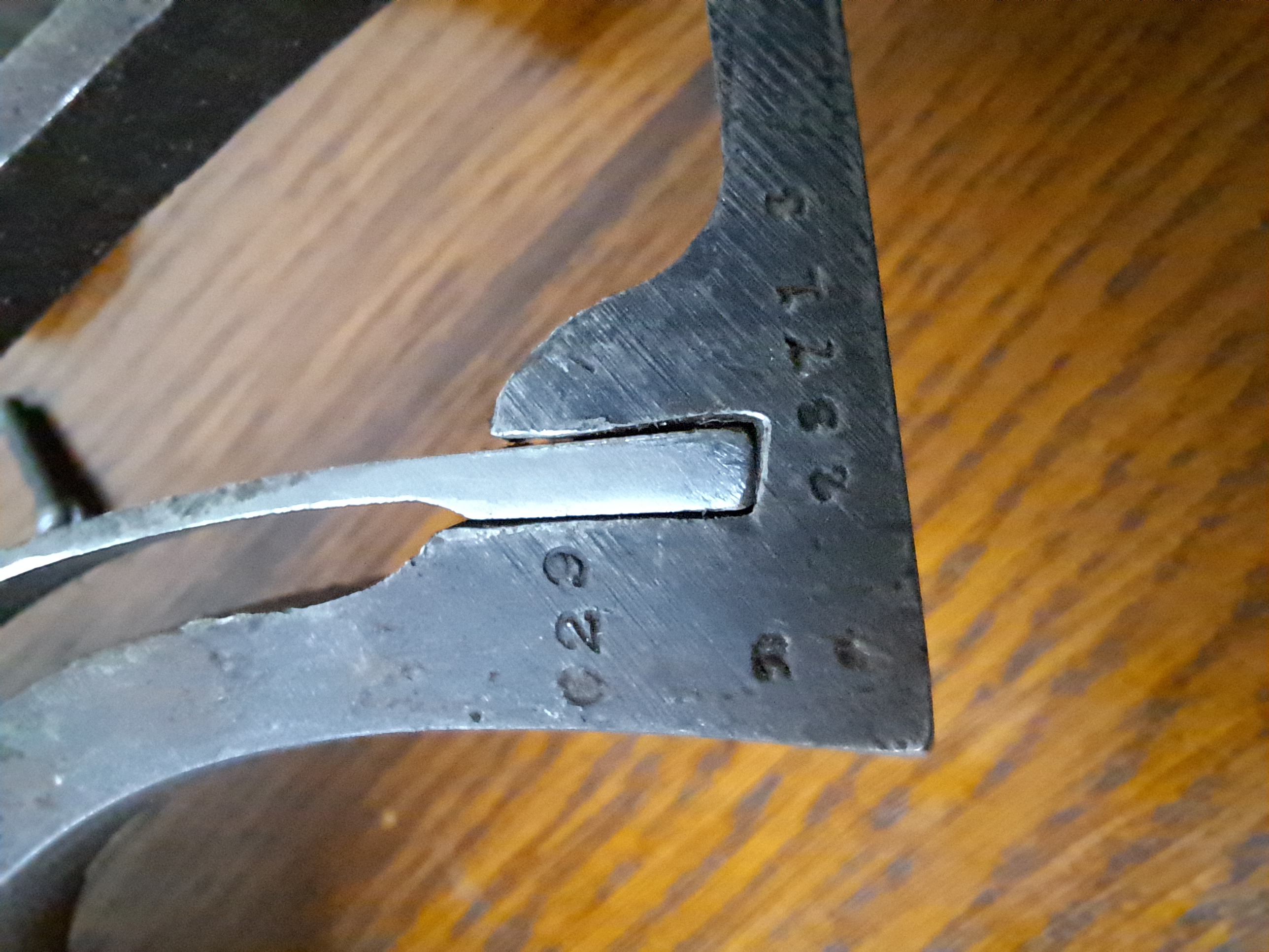

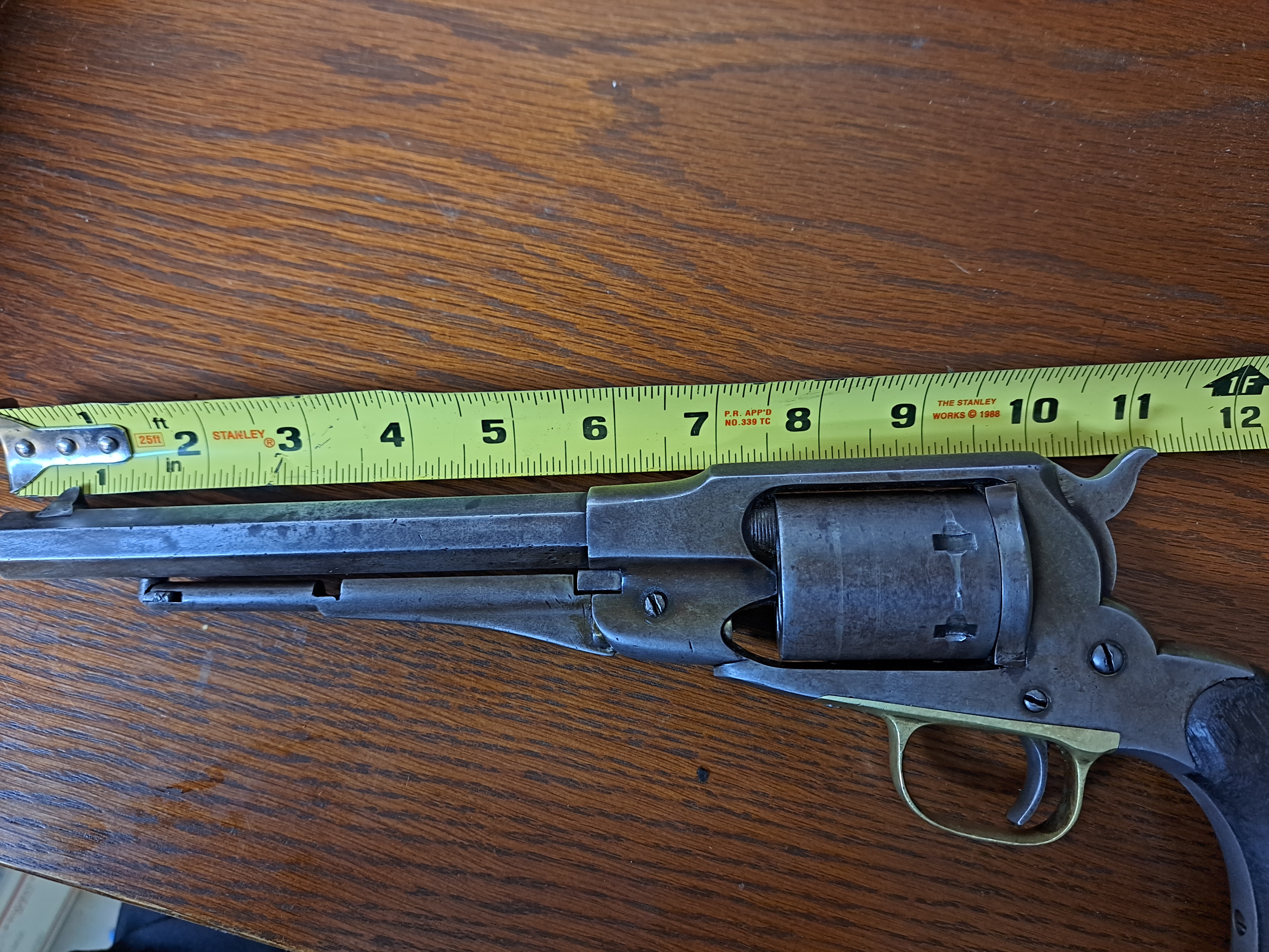

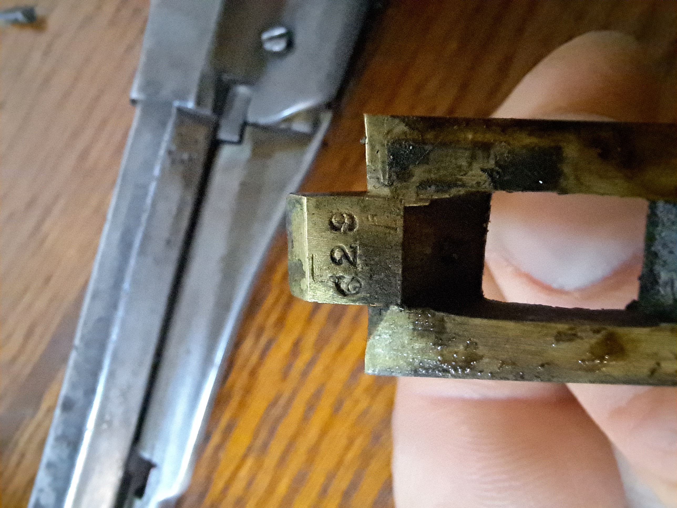

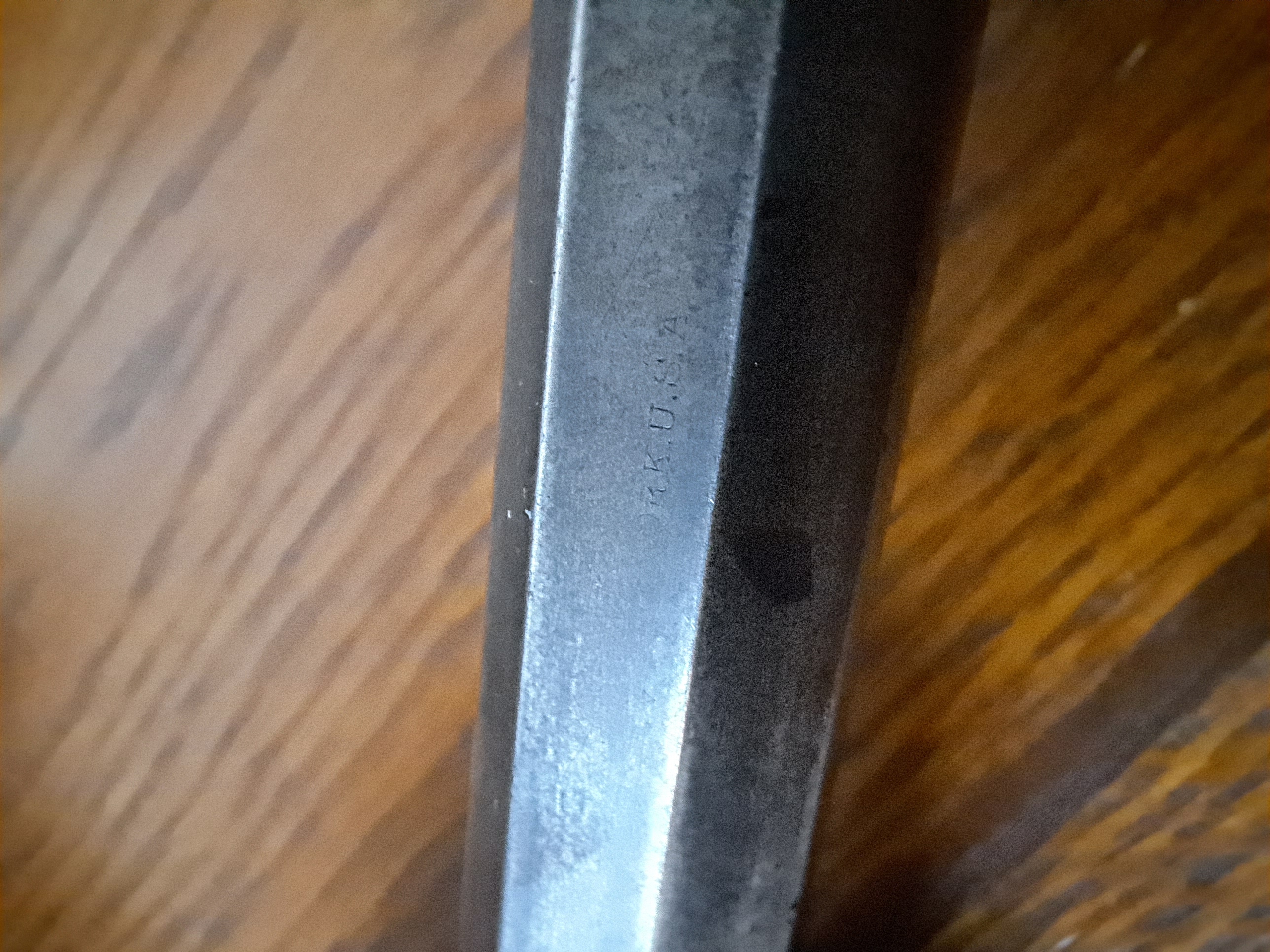

Just picked up what appears to be an authentic 1858 Remington Navy. I'm certainly new and inexperienced at these older revolvers. It was marketed as a 1858 Beals Navy Factory Conversion but after looking into it, I have some hesitation on whether it is an old or new model (which would not be a Beals?). The serial number (28713) exists on the underside of the barrel, under the grips, and on the trigger guard. An additional number stamp (629) also exists in those same locations. Maybe this is a number stamp from when it was factory converted? There is also an 'R' stamped under the grips, which I've learned may be an inspection stamp. The only other identifiable markings are the last few characters from the barrel stamp 'ORK. U.S.A.' presumably the last three letters of 'New York'. As seen from the photos, it has been converted to .38 CF and the barrel is exactly 7.5" leading me to believe it is indeed a Navy. The barrel threads are visible which would lead me to believe it is a new model, since as far as I could tell (from my limited research), none of the original Beals had barrel threads exposed. What confuses me though, is that the cylinder pin is located behind the loading lever, which I thought was only characteristic of the old model Beals. I thought once they started producing the new models with the barrel threads exposed, they also cut out the cylinder pin so that it could be removed without moving the loading lever.
Any help on the identification and/or history of this gun would be greatly appreciated! Photos are attached.

Hi J,
You are 100% correct in all your assumptions. Serial 28713 is a New Model Navy, made in July, 1864, but I suspect that the serial is actually 23713, which means that it was made in Oct 1863. It is one of 1010 various Remington Navy models that were sent back to Remington for conversion to .38 center fire in 1875. The Navy also had some of their Colt Navy Model revolvers converted to .38cf.
These pistols were polished and re-blued, so a lot of the markings were polished off.
You are also correct about the cylinder pin location, and that I can't explain. It has to be a fluke, but by mid-1864 all the bugs should have been worked out of the New Model production. Here is my guess (99% guess). During production an Old Model frame (only one??) was scooped out of the bottom of a parts bin. It was already cut for the cylinder pin, so it was machined to New Model specs exposing the barrel threads, and assembled. This is more likely if the serial is 23, not 23, because it's more probable that some Old Model frames were around in 63, than in 64.
Another guess is that if it was only one frame it might have been scrapped, so maybe there were several more Old Model frames that were found.
The "629" indicated that it was the 629th of the 1020 pistols converted.
What I don't understand is what happened to the ejector housing and the ejector. The loading lever has the cutout for the tab at the end of the ejector, but there is no ejector housing and ejector. Can you tell if there is any trace of a housing attached to the right side of the frame.
By the way, there never were any 1858 Remingtons. That's just a designation collectors and dealers put on Remingtons a century ago, because of the patent date.
There ya have it, facts and guesses all bundled together.

Thanks Daniel!aardq wrote: Wed Nov 27, 2024 2:20 am Hi J,
Have a Happy Thanksgiving,
Yes, it was hard to make out if the second digit of the serial number was an 8 or a 3. No trace of any ejector or housing on the right side. There appears to be a groove in the right side that is not present on the left side but no evidence of anything ever seated in there. Almost like they were going to put something there (hence the notch cut in the loading lever) but then they never installed it? Would help to see one with the ejector present to compare, but I haven't found any good photos yet.
thanks again for all the information!
Happy Thanksgiving.
