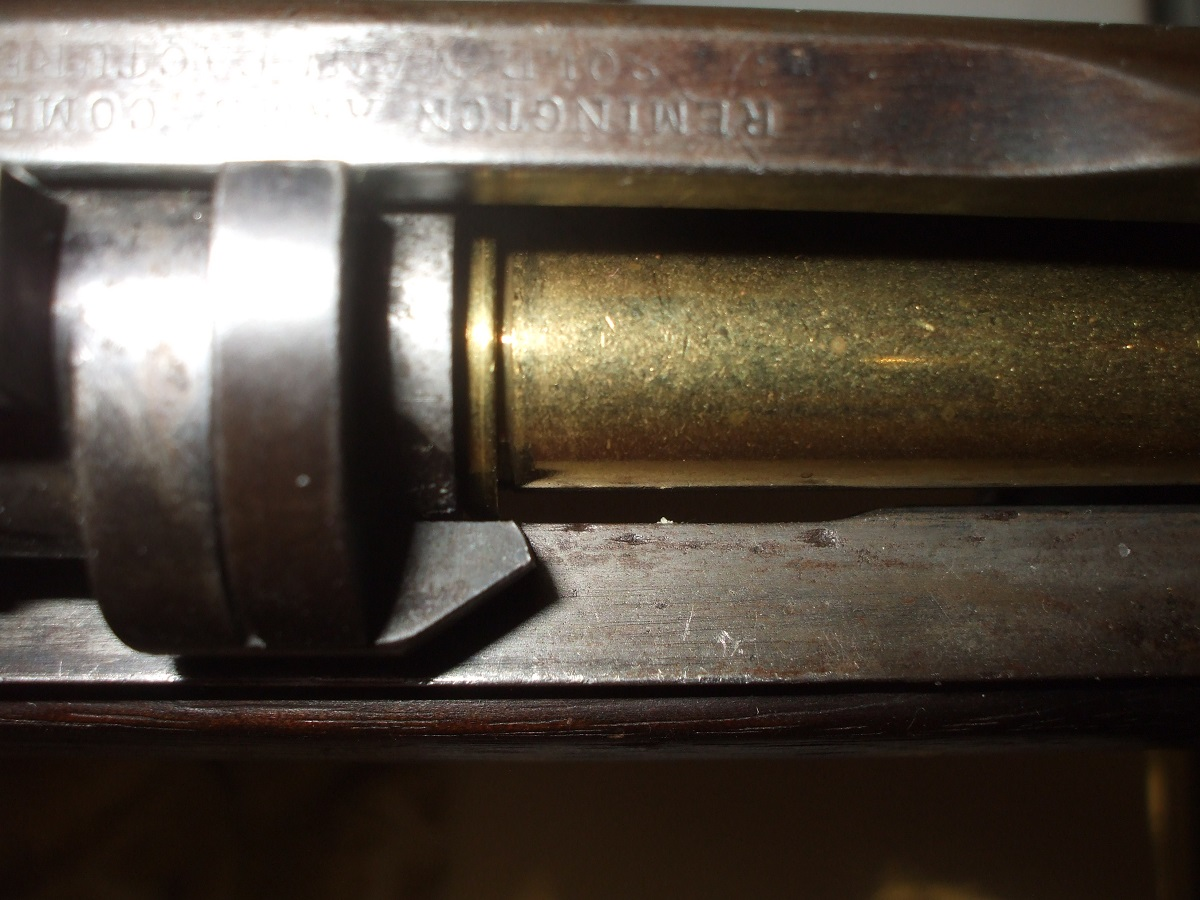

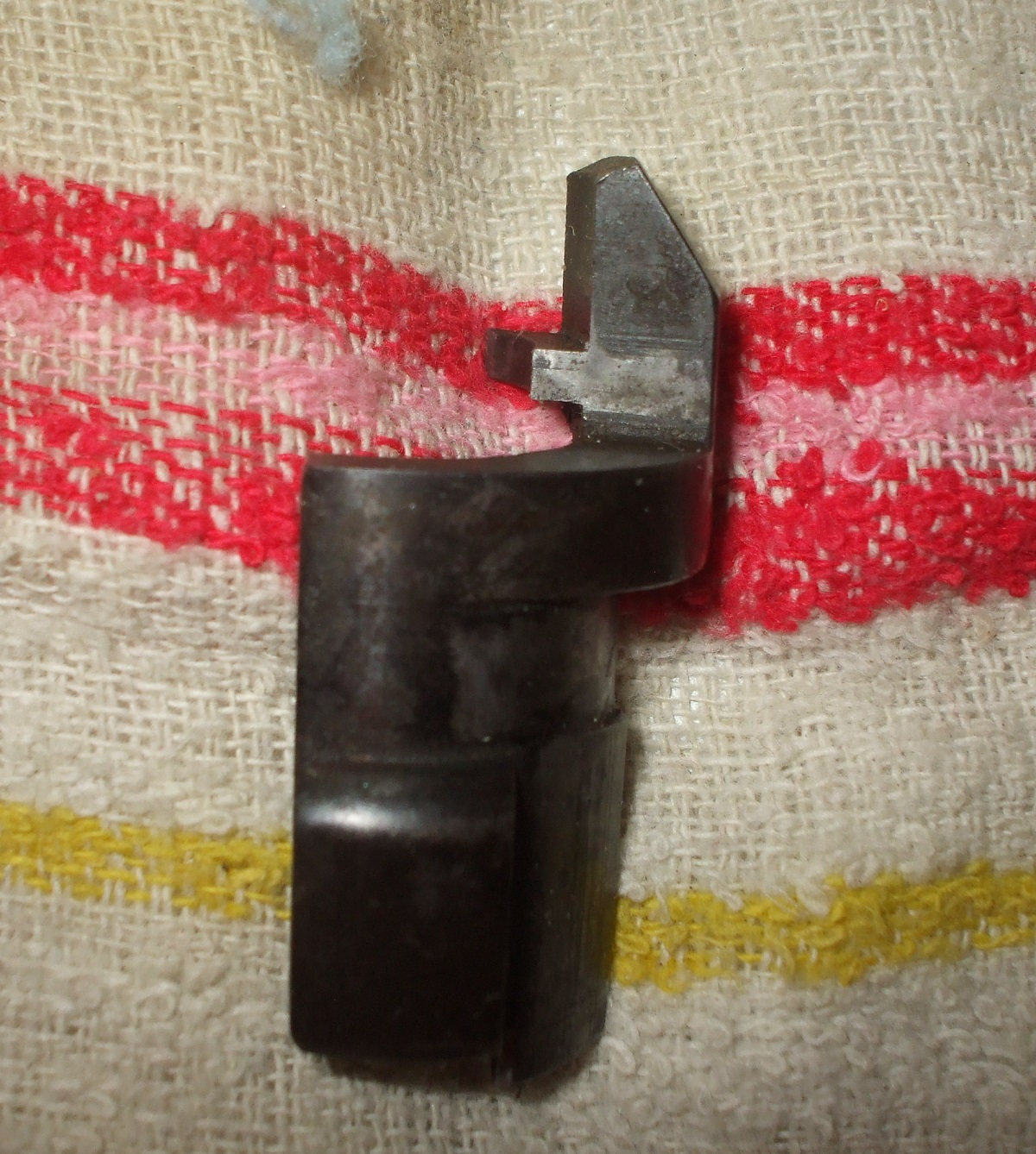

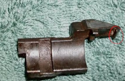

The the "hook" on my rifle's extractor is broken. You can see in the pictures below the tip is broken and how there is nothing to engage the rim of the .45-70 cartridge. There is also a picture of what it is supposed to look like. Does anyone have an extra extractor? Has anyone had any luck with a weld repair or advice on how to fix it?

Going to attempt a weld repair. Dimensions would be very helpful. I found this picture of an unbroken extractor. Anyone have an unbroken extractor they can measure? What is the measurement from the lug to the claw?
