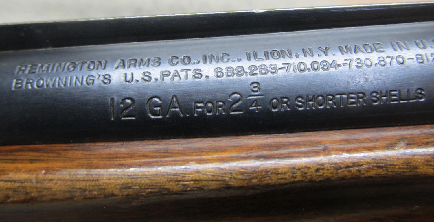

The Model 11 receiver with serial number 408992 was put in work during August 1938. That was a bit before Remington began marking the chamber length on their barrels. This gun from just over a year later is marked with the length --

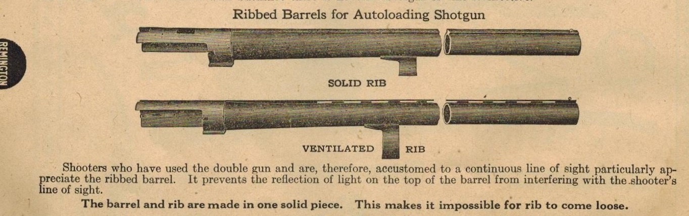

Here is a catalog picture of Model 11 barrels --

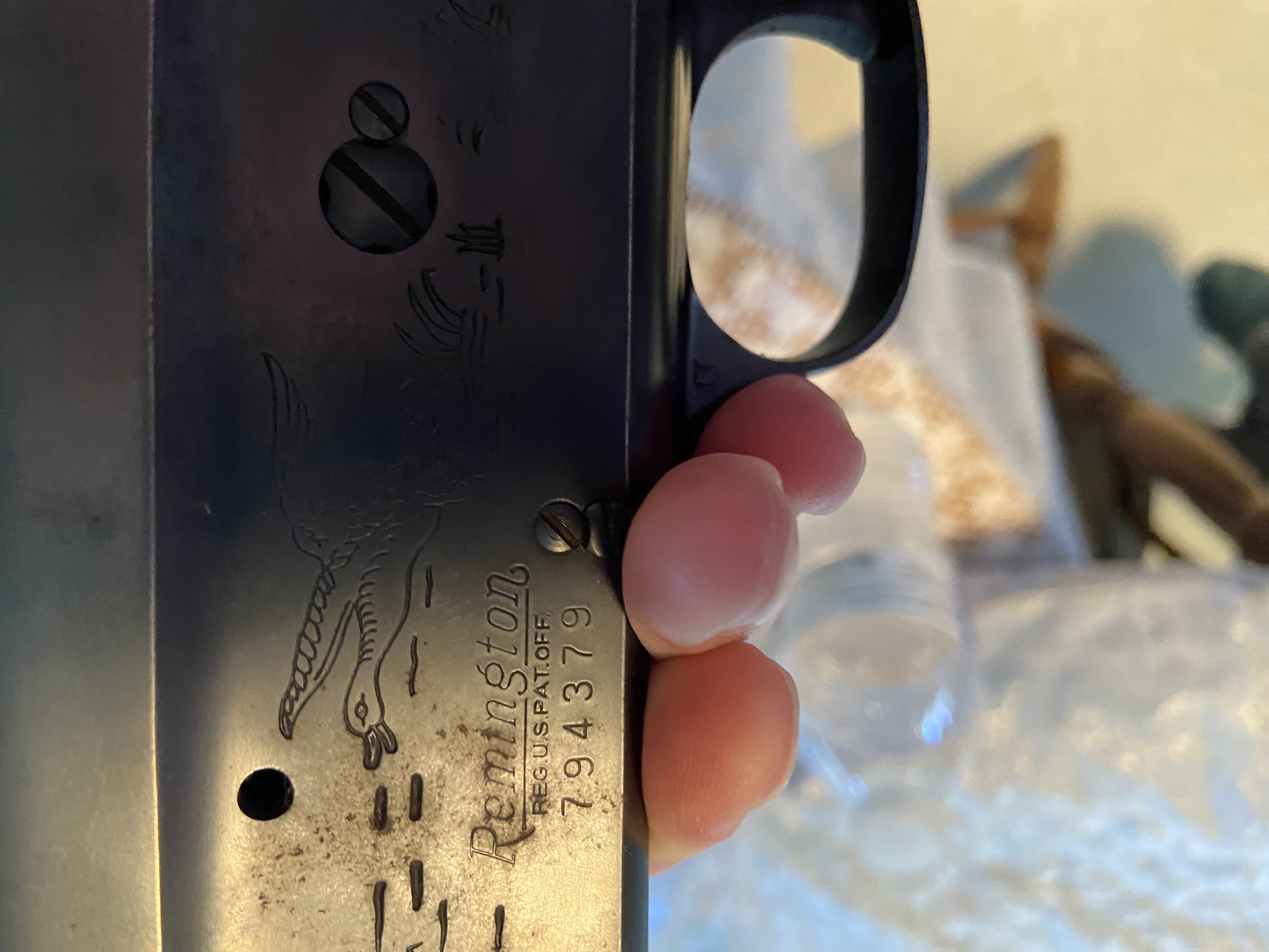

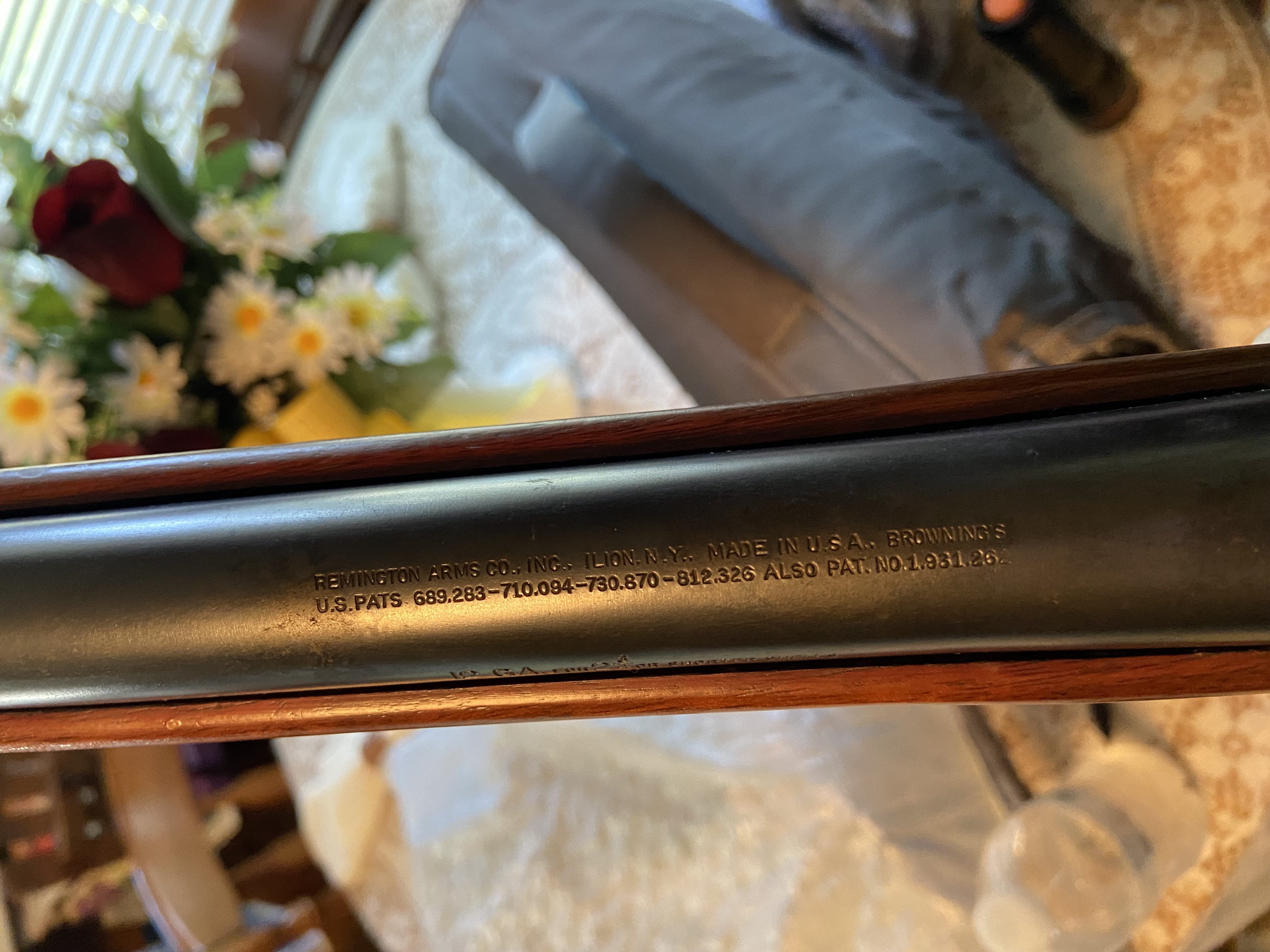

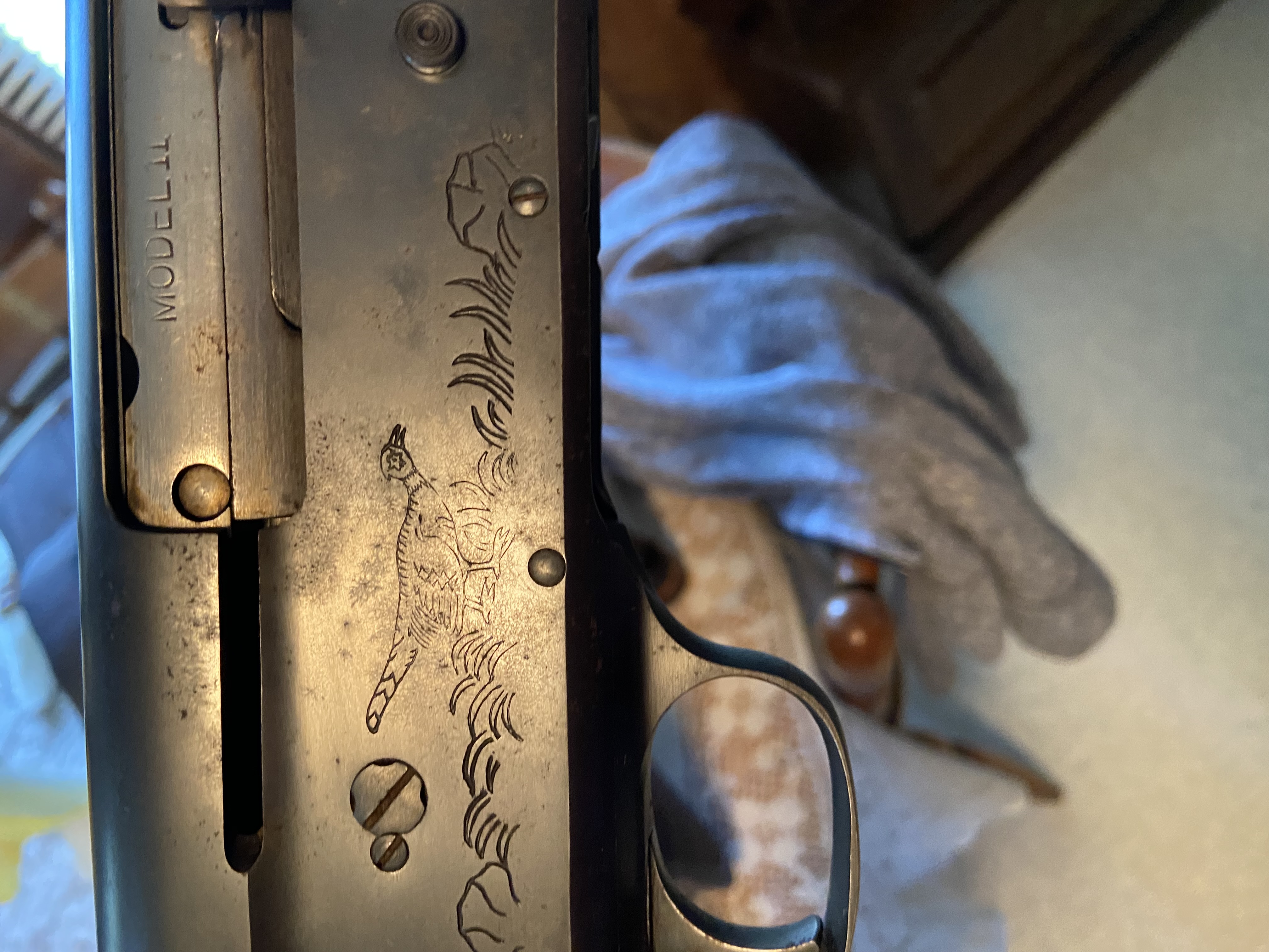

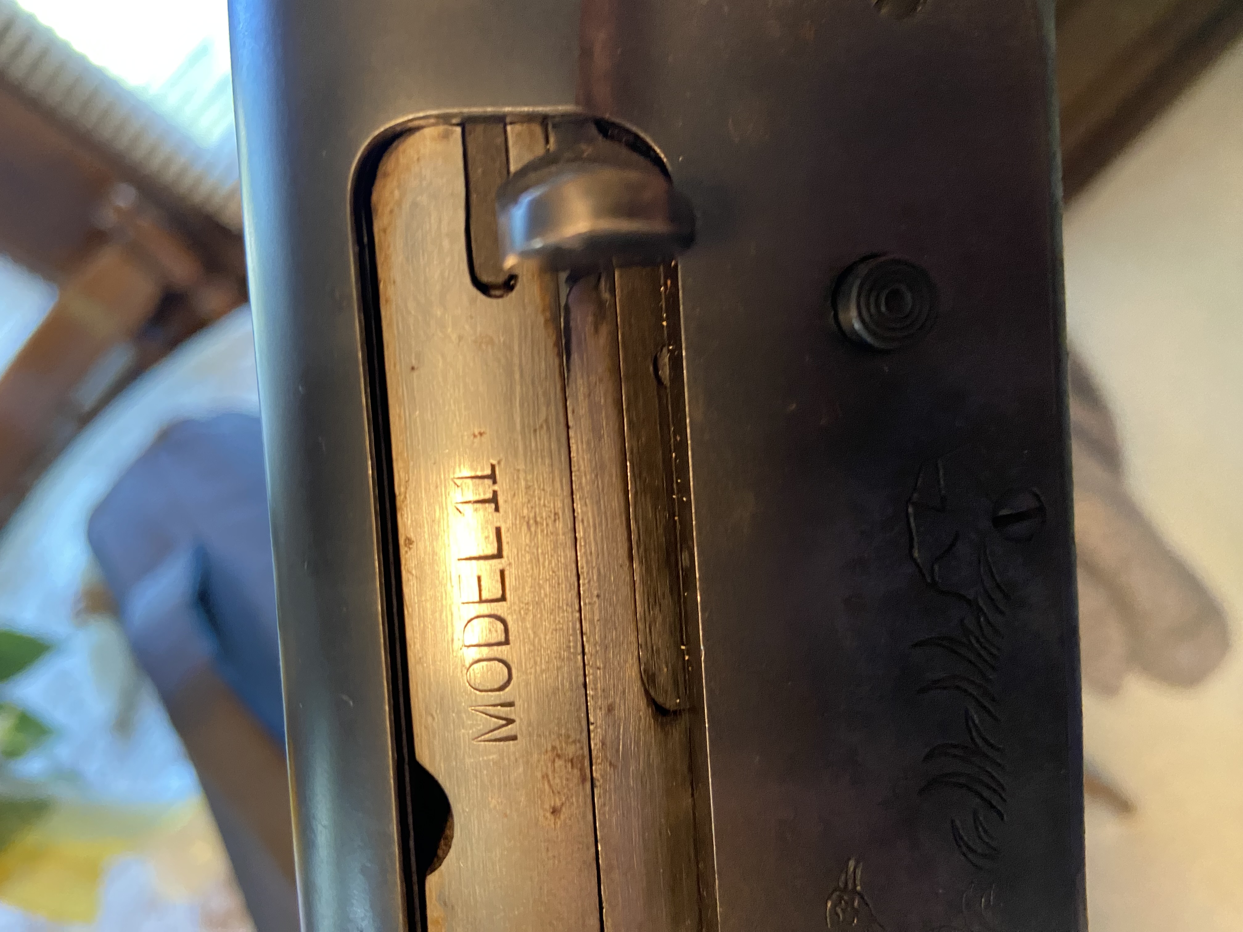

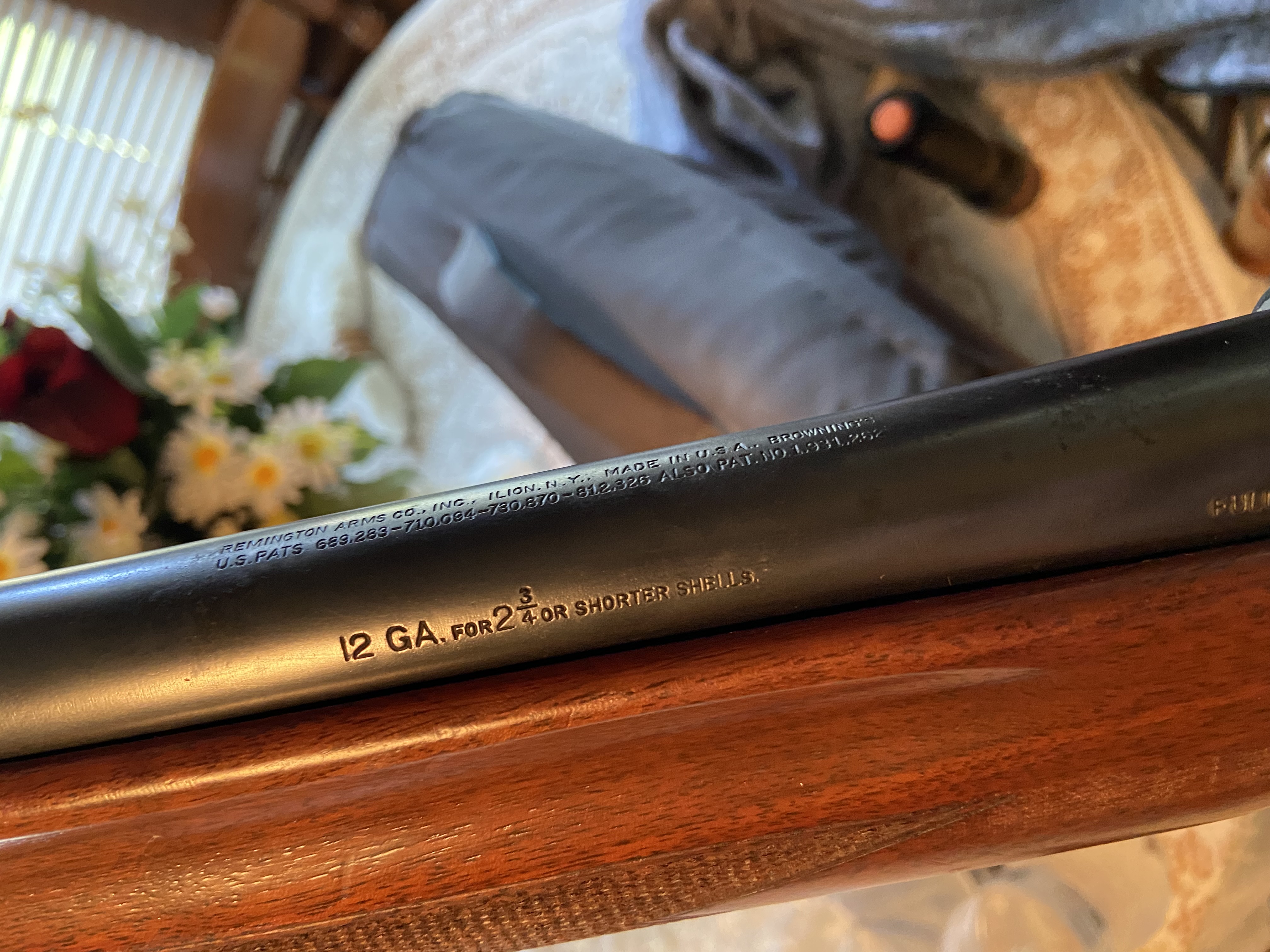

You seem to be the expert so I hope you don’t mind me asking for your assistance also. Here are pictures of my late, father in law’s model 11 12 ga. I’m trying to find its age. I’d appreciate any info you can give me.
Thanks,
Richard

rmgarcia54
- Posts: 2
- Joined: Sun Oct 08, 2023 2:52 pm
Re: Question on late Mod. 11
From what I’ve read, it seems numbers starting with 794 might be from 1947-1948?
- Posts: 1181
The highest 12-gauge serial number I've recorded is 804638 so your gun is from the last year or two,
