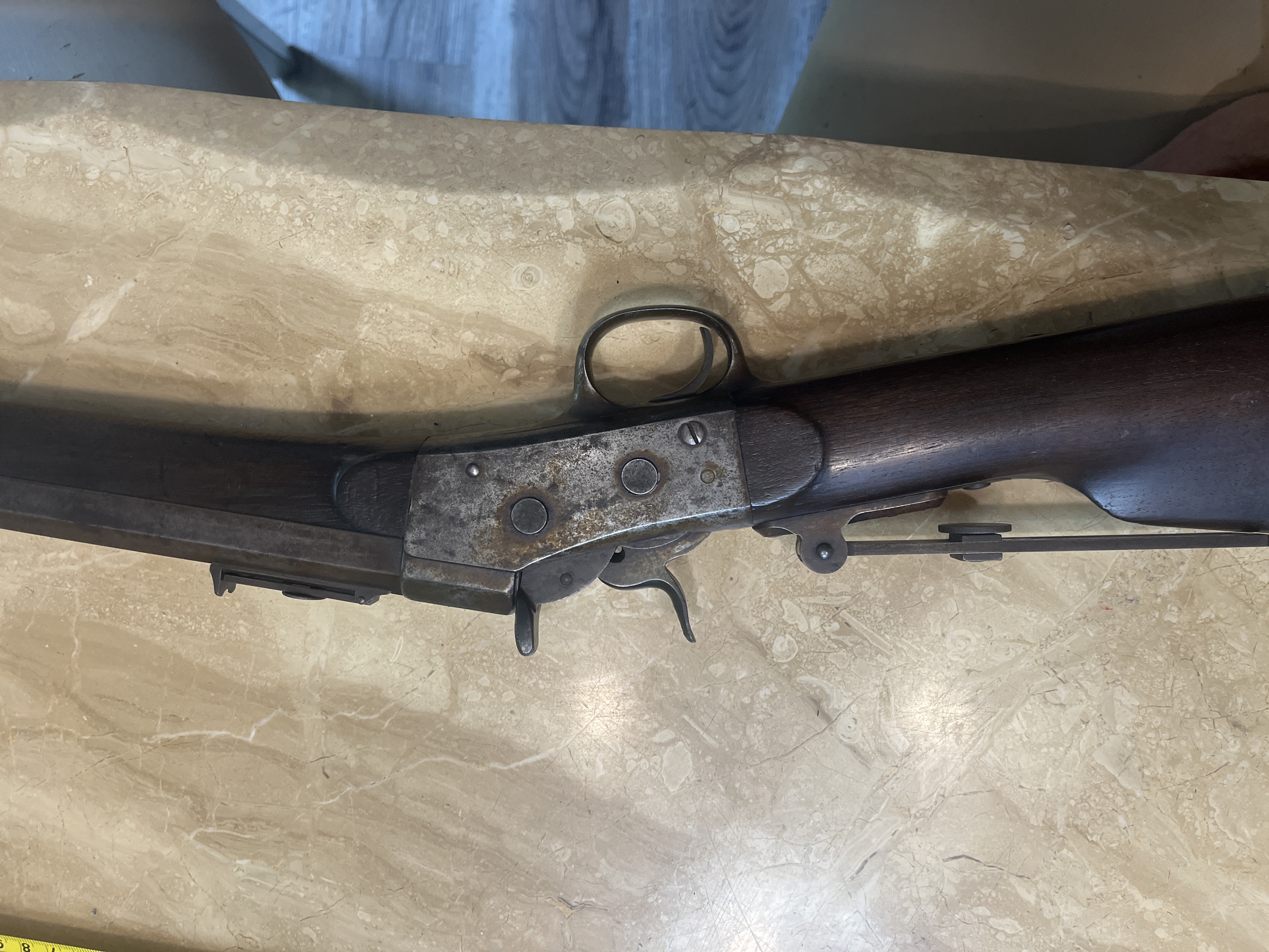

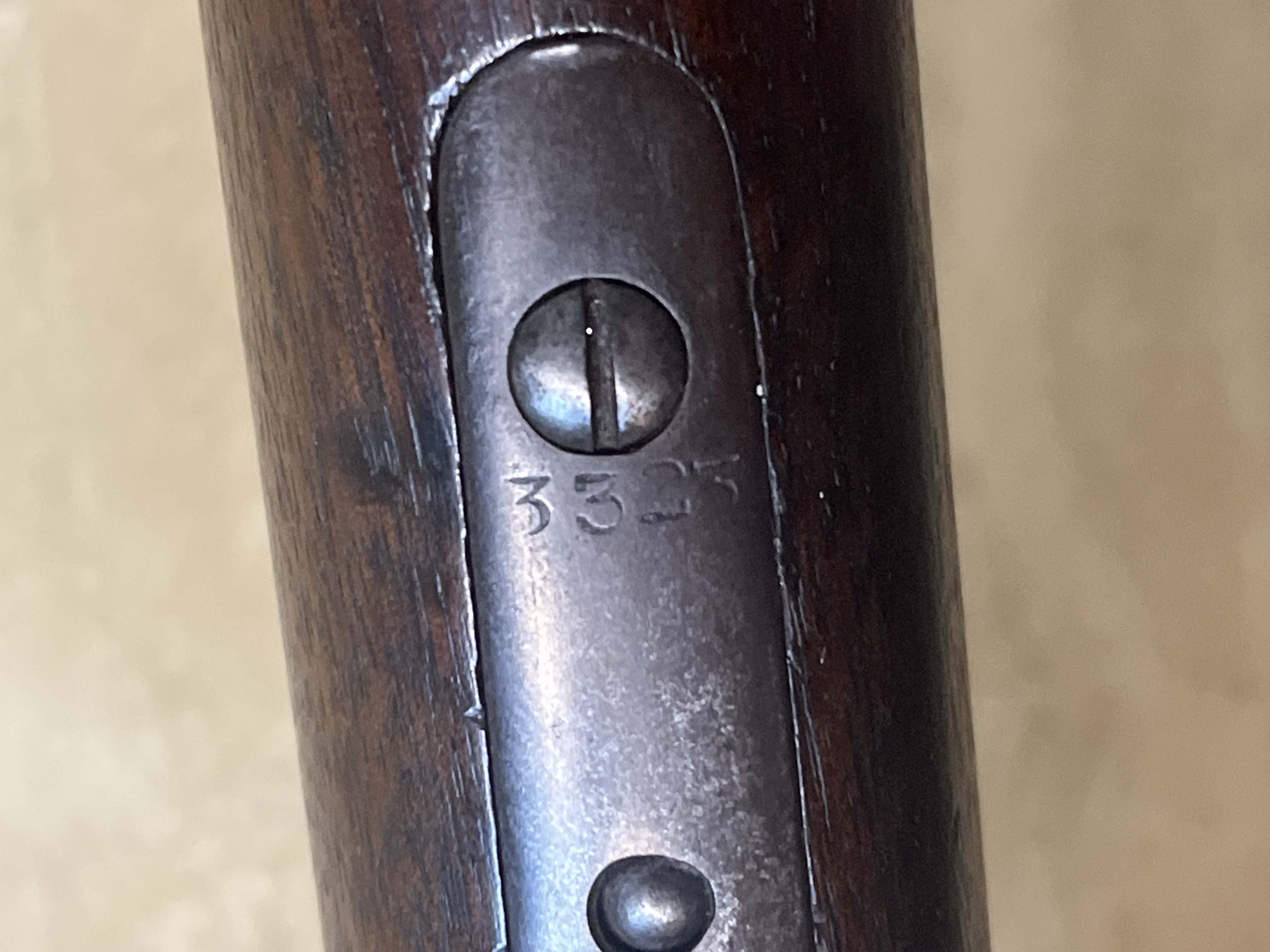

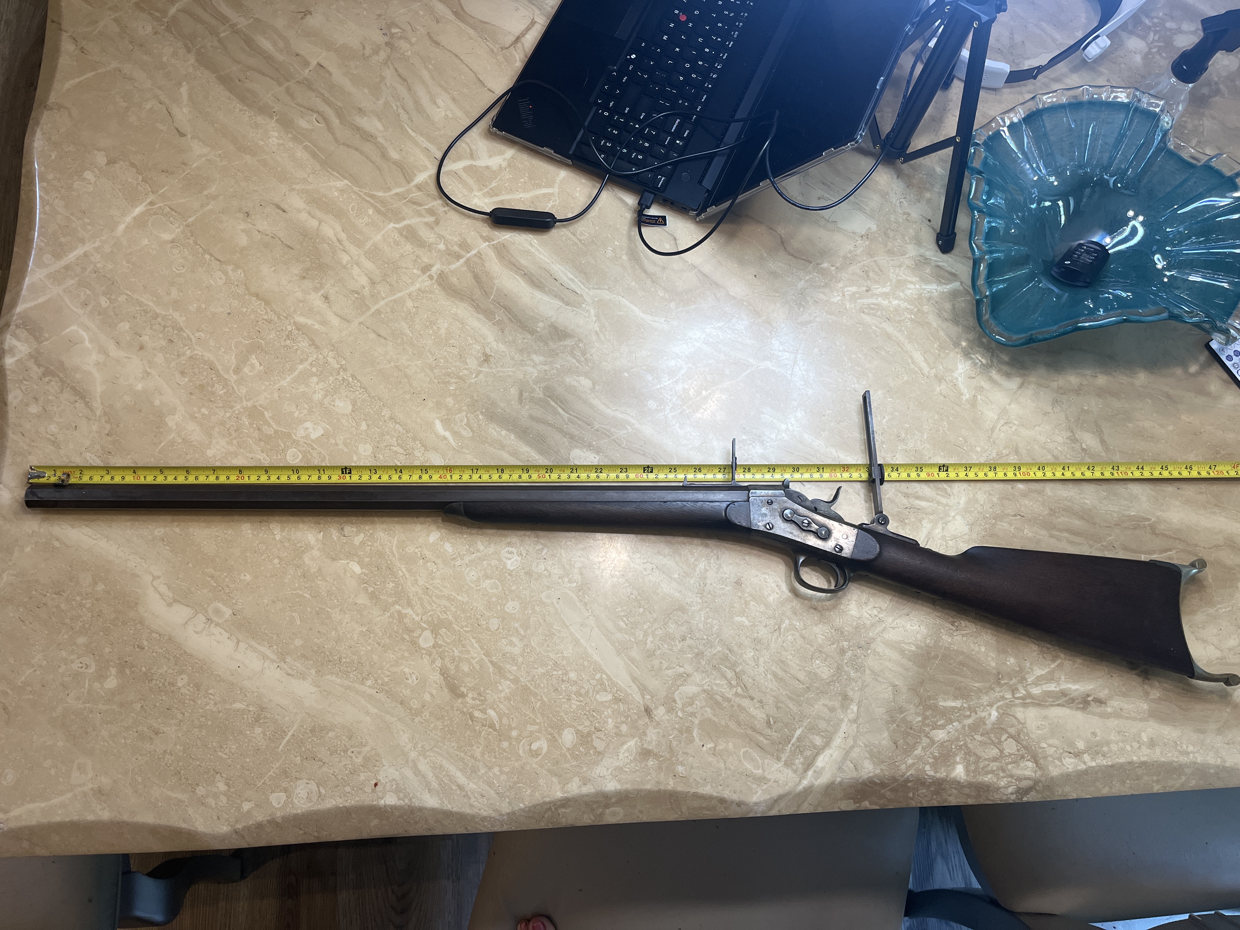

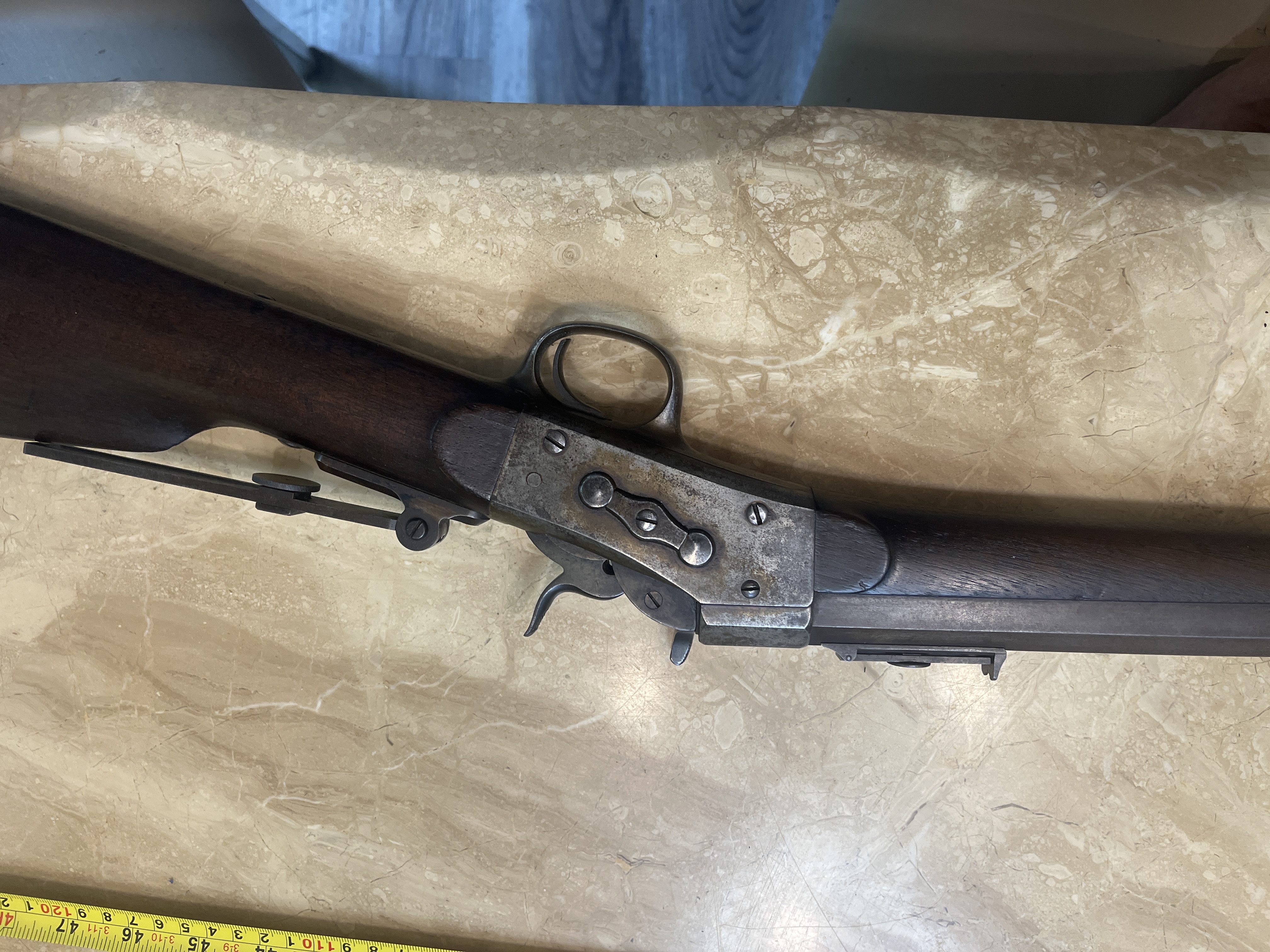

I believe I have a Remington Rolling Block 1 1/2 Sporting Rifle. It apoears as though it has been modified from 31 rim fire to what I believe is 38/55. As noted in the picture, the hammer
And part of the block appear to be a slightly different color and I suspect replacements It has serial number 3323 on the tang. When I purchased this rifle, it had no buttplate. I was given the buttplate that is on it but would like to have it replaced with the correct buttplate. Any information regarding this old rifle would be greatly appreciated.

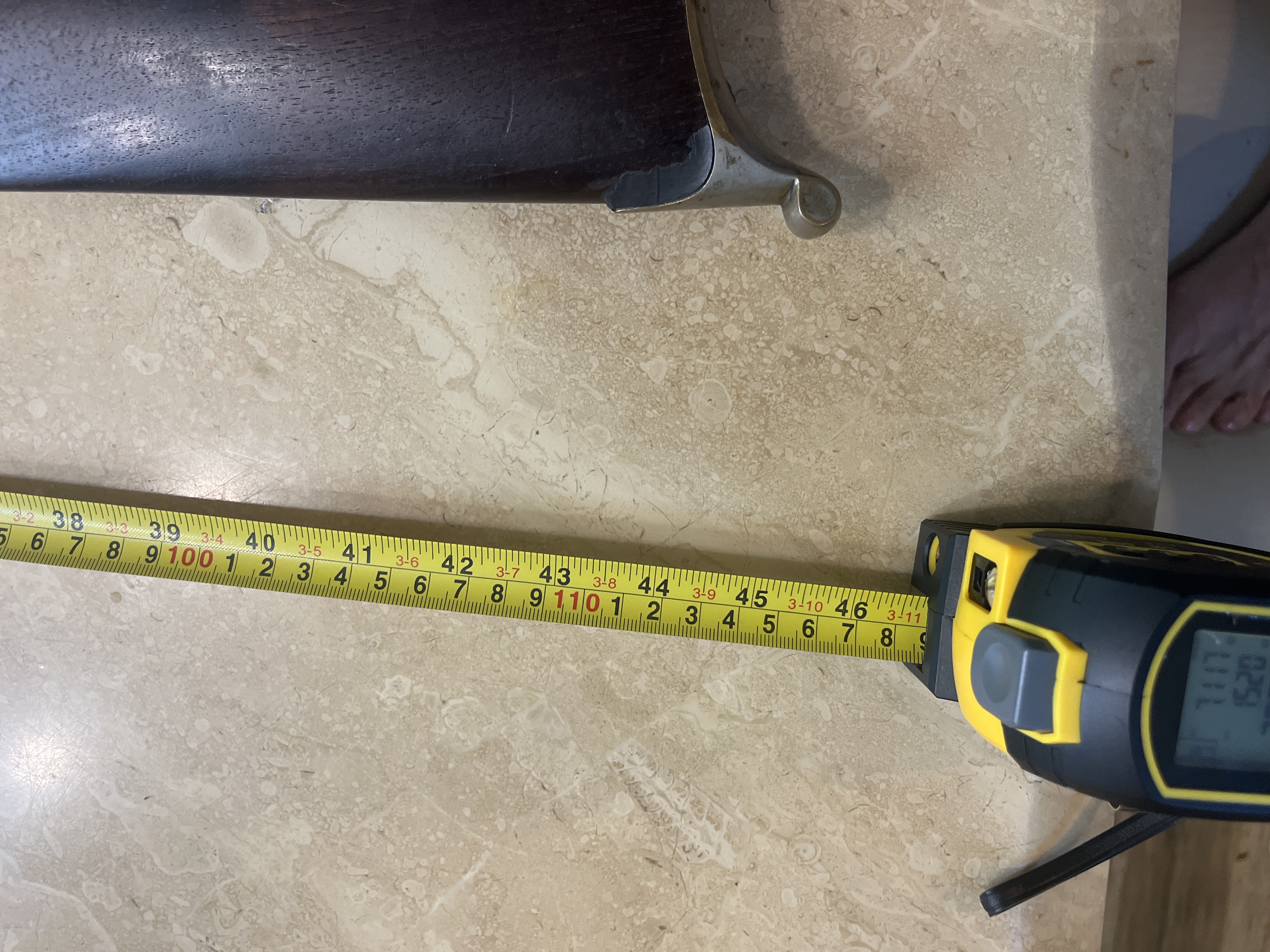

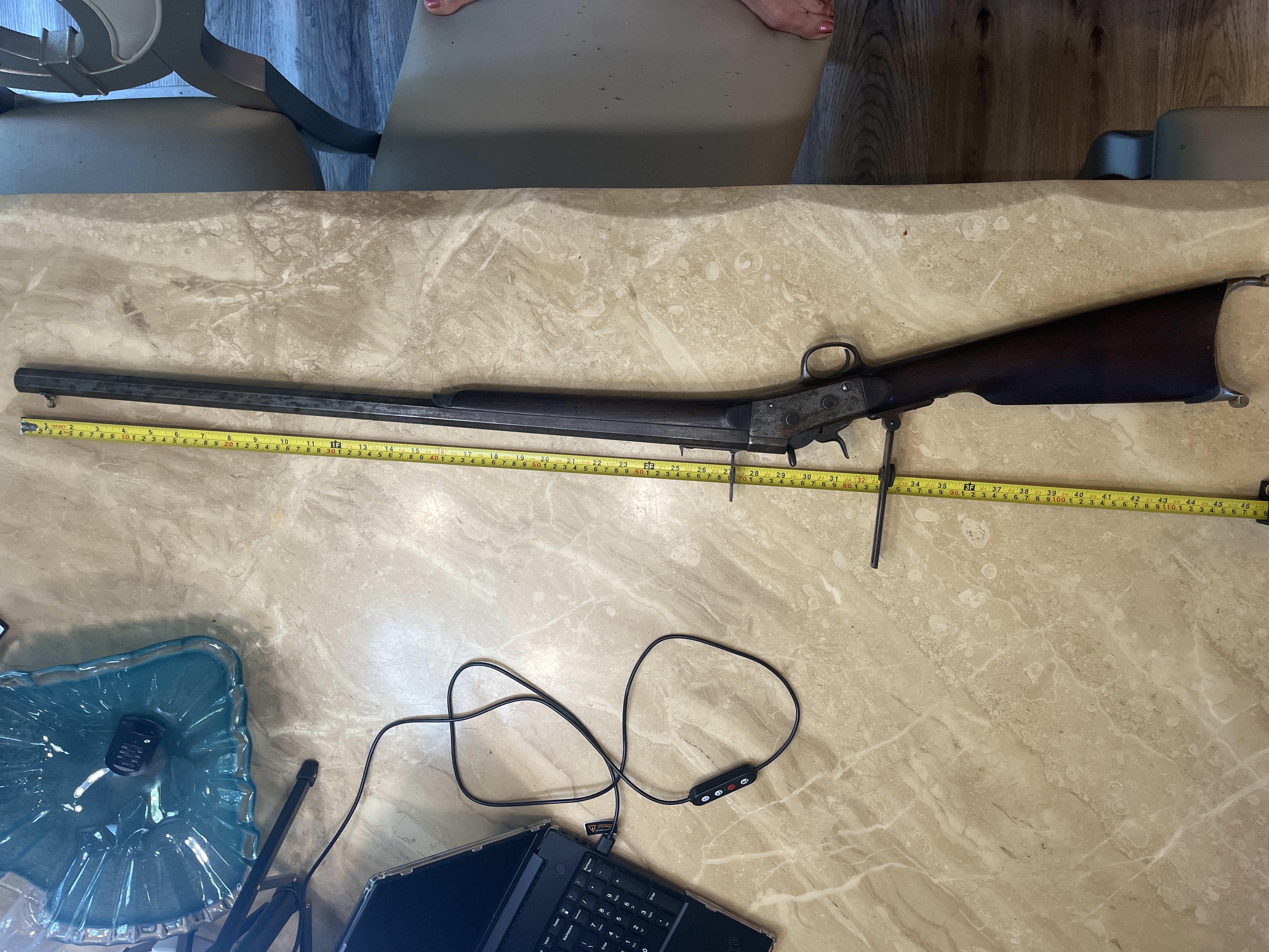

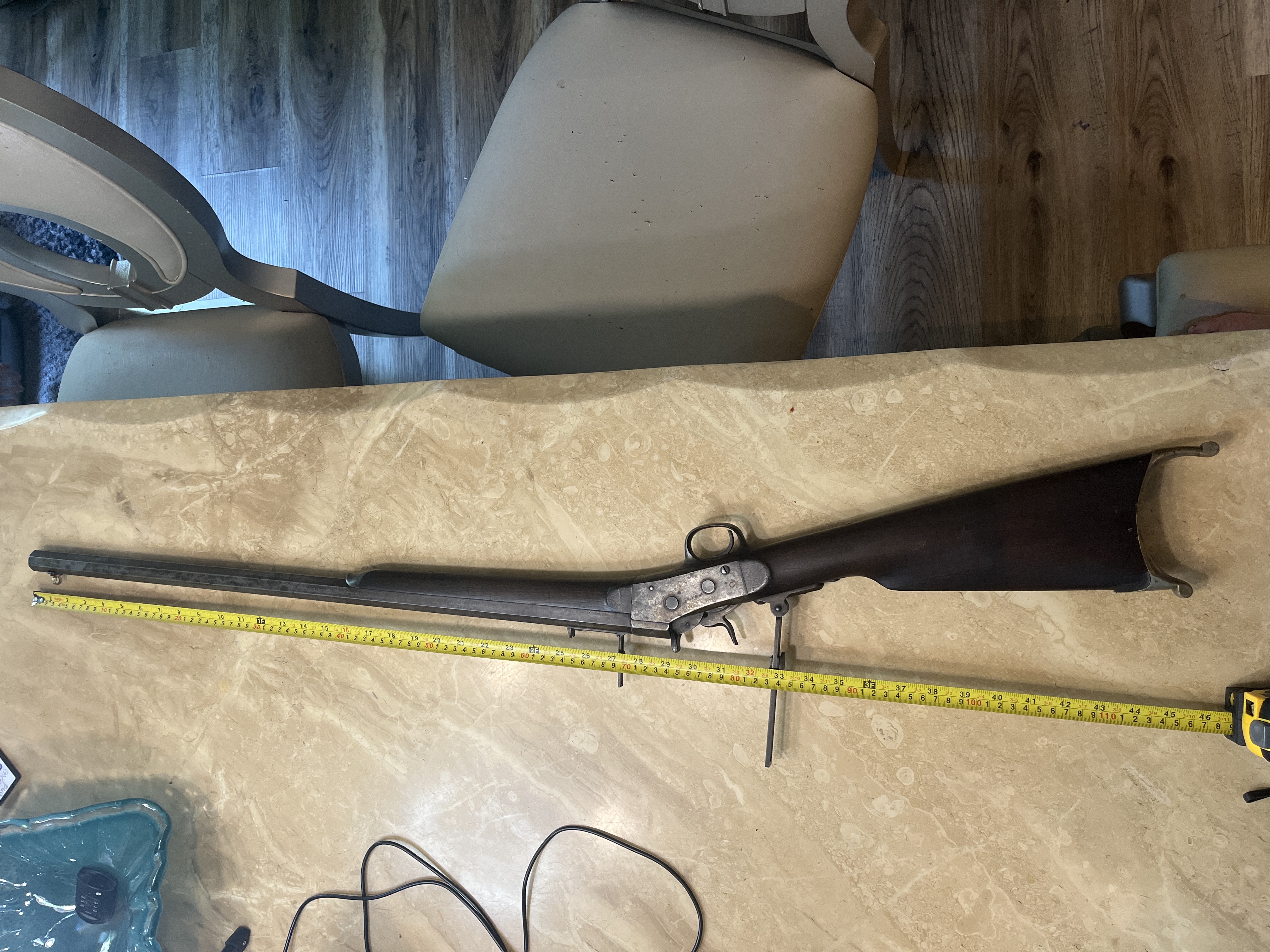

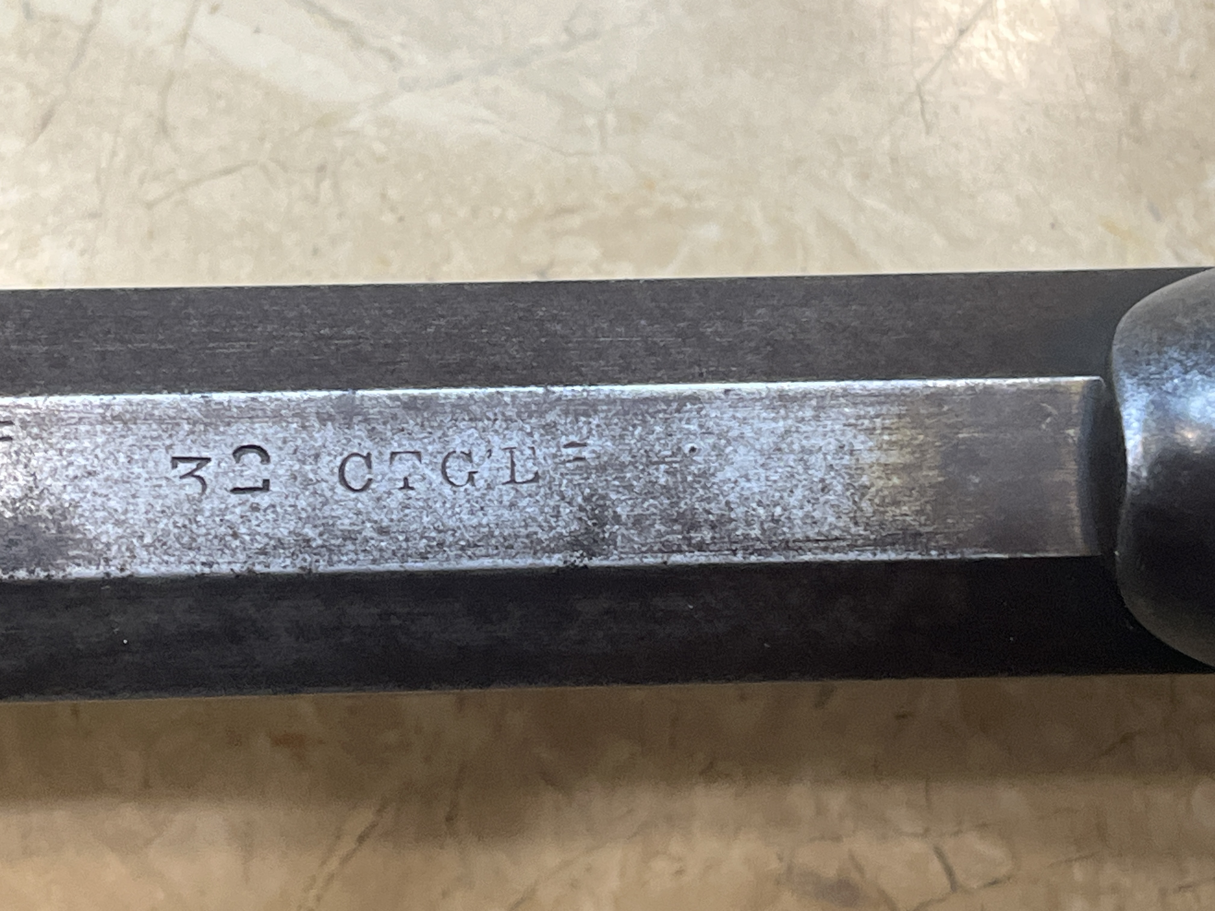

Your Rolling Block rifle is not a #1 1/2 Model. The 1 1/2 models had flat sided receivers, and were thinner. Yours with the stepped side receiver is a #1 Sporting Rifle and was originally a .32 Long RF as they made no such cartridge as a .31 caliber. The #1 action is plenty strong for the rework to .38-55 and that's a great cartridge also. The barrel on your #1 has also been shortened likely when someone changed it to the .38-55 and wanted a fresh crown on the barrel. It shows it's 29.5" on your tape measure and barrels were either 28" or 30", but not 29.5".

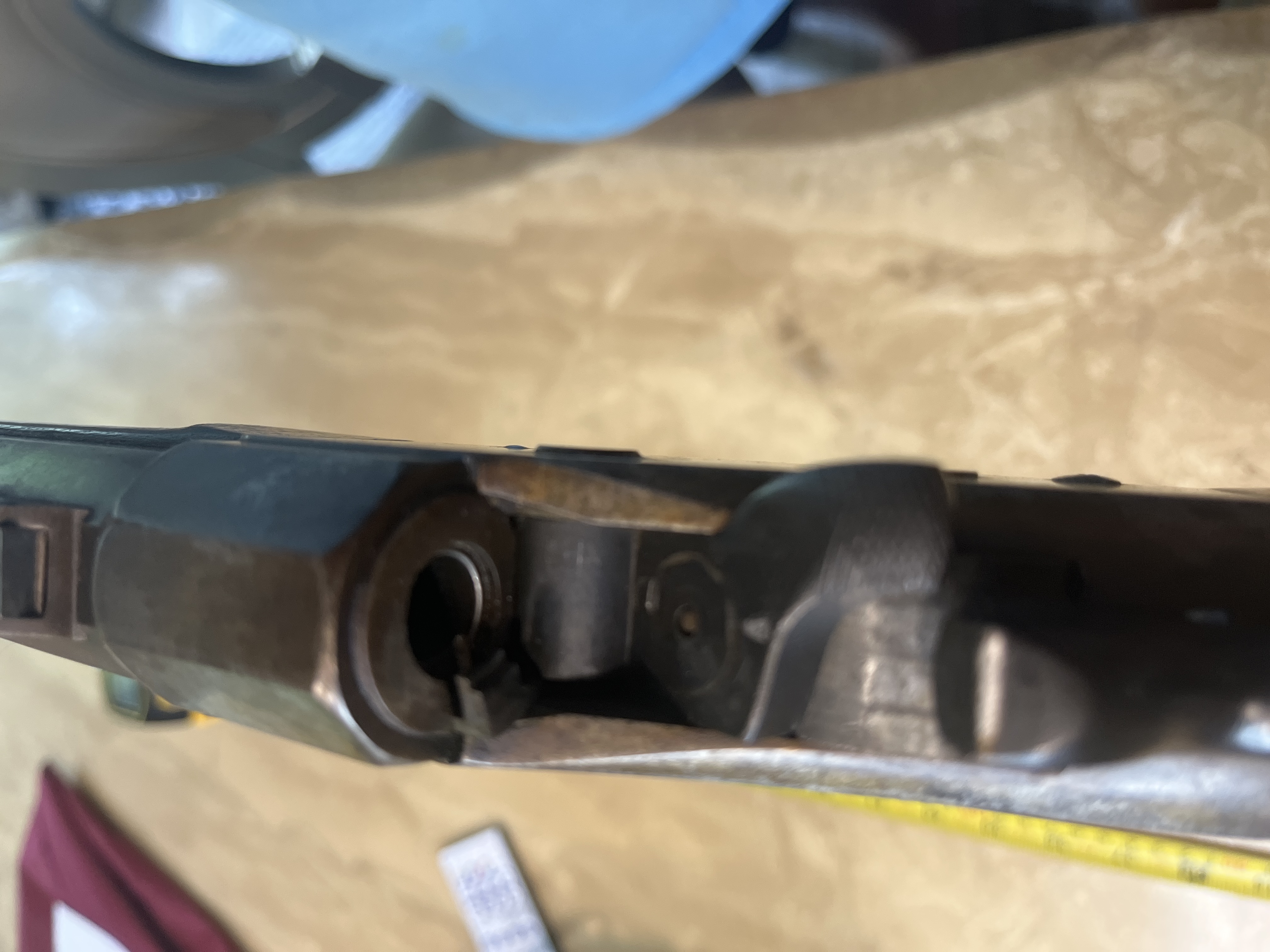

I’m having some difficulty determining the correct cartridge as a .38/55 fits a little to snug, and the hammer doesn’t want to fall, I’ve done a chamber casting but perhaps a .38/50 Ballard is it’s true chambering?? Thoughts?

McAcree wrote: Mon Sep 07, 2026 11:18 am I’m having some difficulty determining the correct cartridge as a .38/55 fits a little to snug, and the hammer doesn’t want to fall, I’ve done a chamber casting but perhaps a .38/50 Ballard is it’s true chambering?? Thoughts?
If .38-55 is too snug then .38-50 Rem. will be even tighter as it has a larger rim and base diameter.
