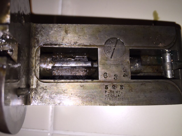

So, thanks to "jake" I found that there is an issue with the lifter. It should sit flat when the barrel is closed and it does not. When the barrel is removed, it's flat as can be!
Smokecreek
Posts: 12
Joined: Thu Jan 15, 2015 5:45 pm
Re: Help to ID old shotgun
Post by Smokecreek »

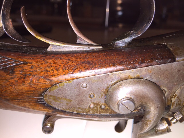

So, when I remove the barrel i can see that there is a push rod in the action. That push rod seems to lock into a part on the barrel. For whatever reason, that push rod is not allowed to seat all the way when the barrel is attached. I wonder if the repair job on the front trigger guard is to blame? Jake says that screw could be interfering with the push rod.

Its not the trigger guard there is a couple of other things to check. talk to you later we need the gun in your hands.

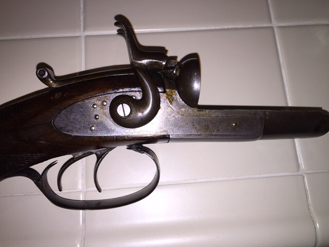

dieNusse1 wrote: Fri Jan 16, 2015 9:39 pm Without the gun in hand I can only say it's a '78 or '79 model. All earlier lifter models had percussion fences and yours doesn't.
However, as is the case with many early Remingtons, there are exceptions. In this case there is at least one '78 known with a Deeley & Edge forearm release and at least one '79 with a wedge attachment. In any event, you most likely have a '79.
