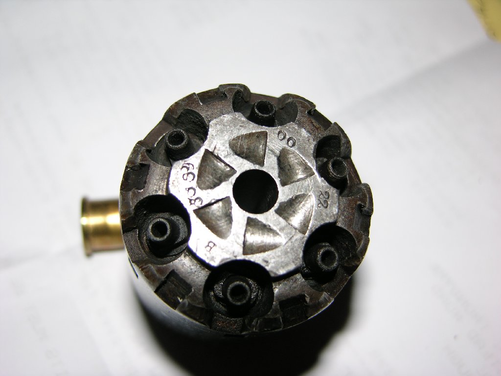

Original 1860's cylinders did, indeed, have serial numbers stamped on the "butt" of the cylinder, where the pawl ratchet indents are - on the circumference. They also included a sub-inspector's letter stamp.
I joined this forum to get some answers to my questions - got diddly-squat, not even a "welcome". Seems to me that the forum members are not a very friendly bunch!
Myself (from England) and a new member from Australia haven't had anything back from our requests for information. Lots of "viewings" but no responses.
See below - Scotch Mist? From my August 1863 .44 transitional Army revolver.
- View of "butt" of cylinder.
- Cylinder serial numbers.jpg (86.17 KiB) Viewed 7382 times

The cylinder in my photo, taken from my 30022 Serial Numbered .44, also shows that the cylinder originally had another, earlier 4 digit serial number that was struck out - 74?9, where ? = digit that cannot be deciphered.
The cylinder (externally) has the same "A" stamp as all the "A"'s on the right frame side, but also has a "B" on the rear with the numbers.
Was this "B" struck instead of the "3" leading digit of the 5 digit number of the gun, accidentally/in error?
