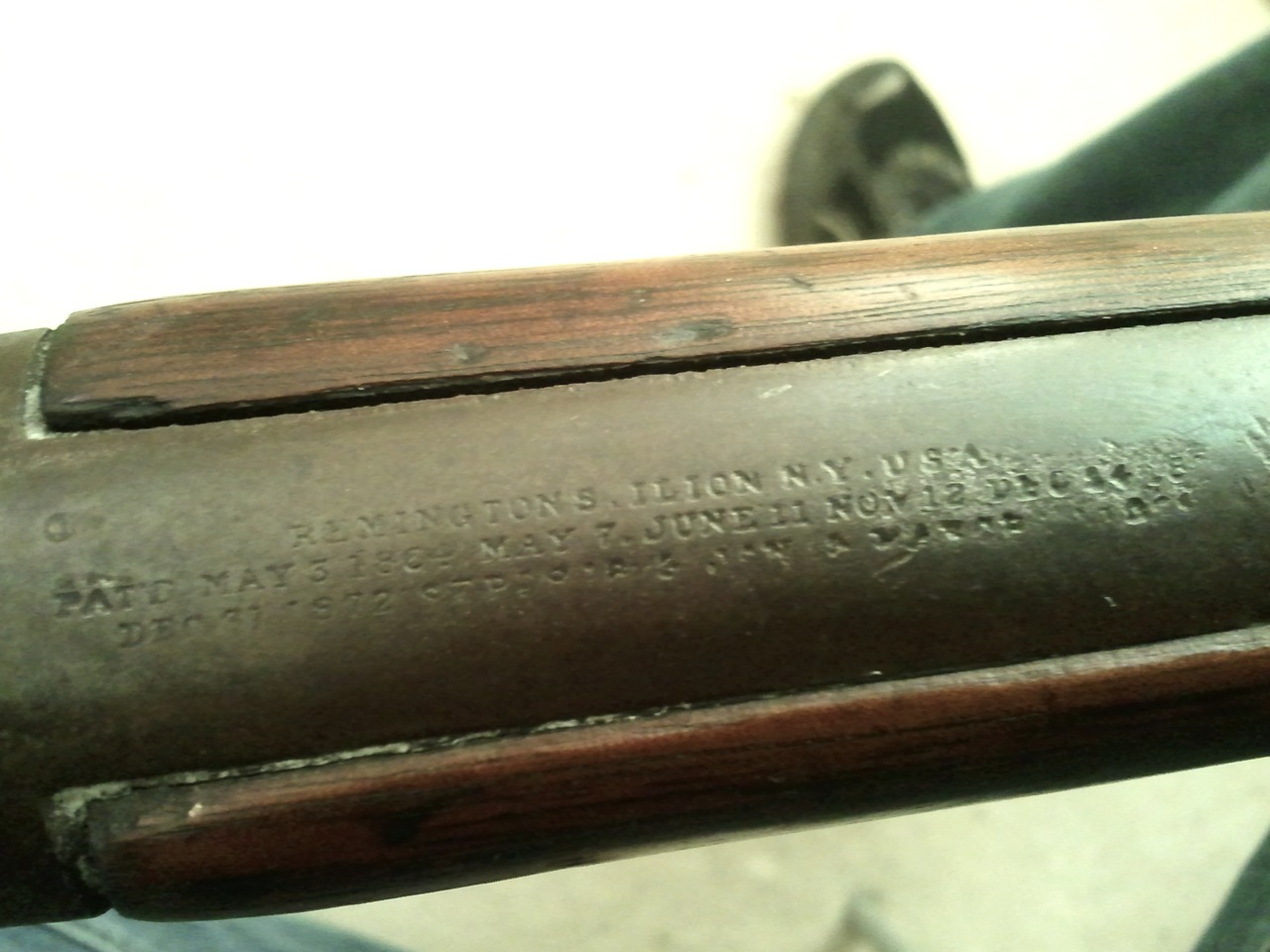

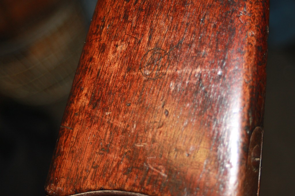

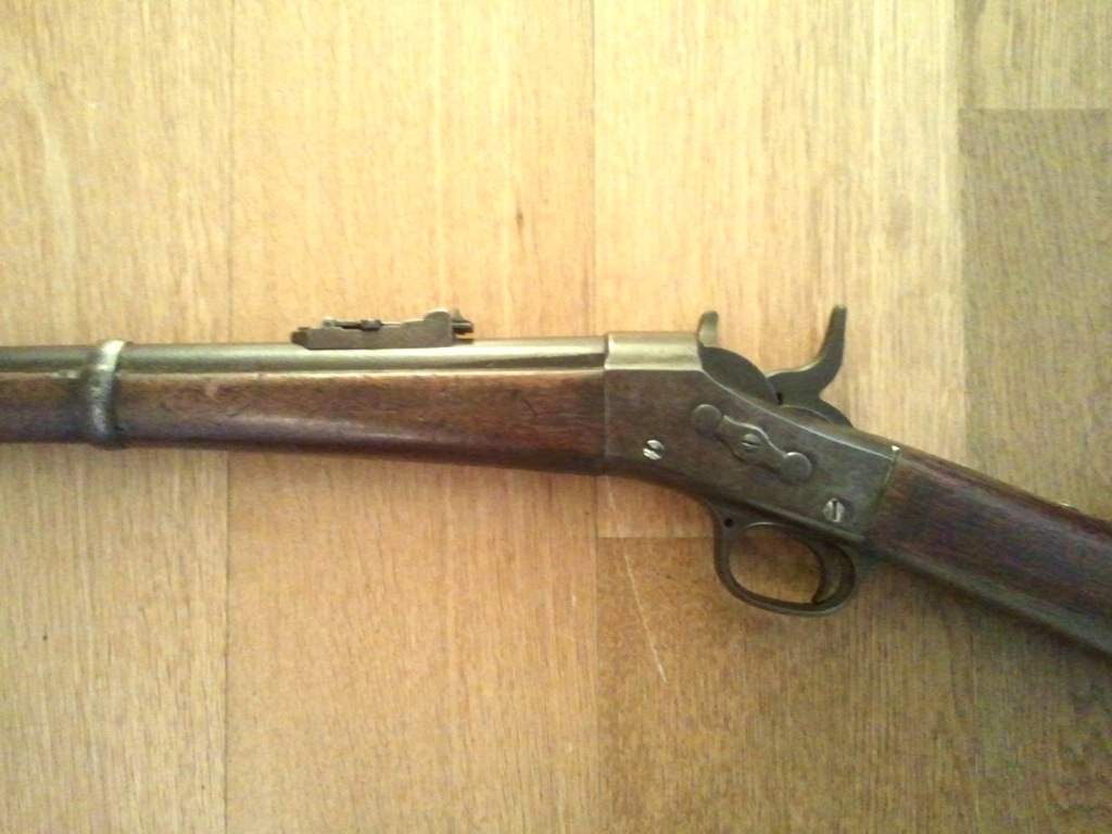

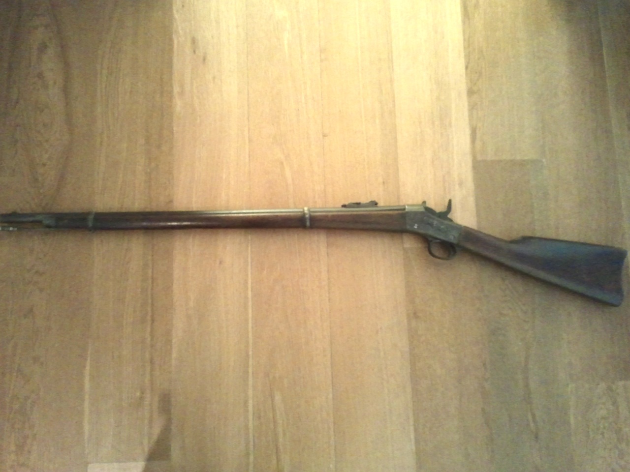

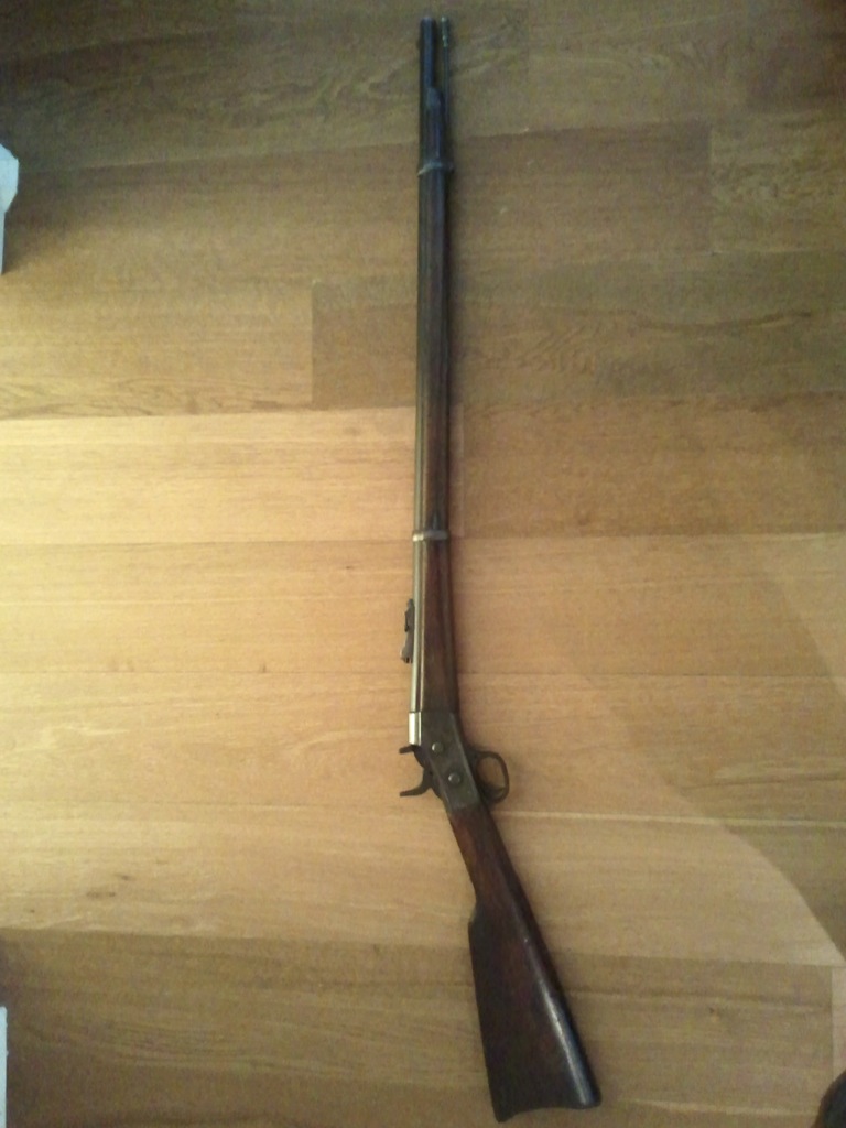

Along with a Serbian Mauser and a Greek Gras carbine, I have just come across this two band Rolling Block Musketoon or short rifle, allegedly they were all found together . The first two have been sold and I have just bought the Remington
It has no Egyptian or arabic script markings, and the calibre is either .43 Spanish or Egyptian, I haven't checked the calibre yet, there is small cartouche on the side of the butt, with the script initials ER within a circle
There is no bayonet bar, and consequently the stock finishes higher than on the Egyptian musketoon, the barrel bands are held in place by side springs rather than Baddely bands with the bottom screw. There is no provision for sling mounts, apart from the hole in the front of the trigger guard
The tang has the Remington patent dates as shown in the attached pics
I would welcome any help on identifying to whom it may have been supplied

What is the length of the barrel from the end of the muzzle to the face of the breech block? Also, in one of your photos there is a stamp on the side of the barrel band. Is that a "U" or a crown? Caliber would be helpful or, at least use a caliper to measure the very back end of the chamber. The 11mm Spanish cartridge has a base of approx. .516"; the Egyptian cartridge has a base diameter of approx. .581". Your chamber should measure slightly larger that either of these to allow for expansion.

The barrel length is 30", the bands are stamped neither with a crown or nor a U, but with what appears to be a star.
The knox and barrel also are stamped with an R

Well, the 30" bbl puts it in the category of a "civil guard" model. However, it once had a rear sling swivel mounted at the front of the trigger guard and I don't see a sling swivel on the barrel bands. It does not look like it has a saber bayonet lug on the muzzle. So, it looks like your rifle may have been modified from another form. Caliber ID would help narrow things down.

Thanks Tjack, it has no bayonet bar, however it is not a shortened three band rifle, as with the band fixing, if it had been shortened would show the old fixings, overall it is untouched.
Also both the knox, barrel and butt have Remington view or acceptance marks, granted the question of the mount on the trigger guard is interesting, however perhaps originally it had a front sling mount and rear, or on the over hand perhaps not.
