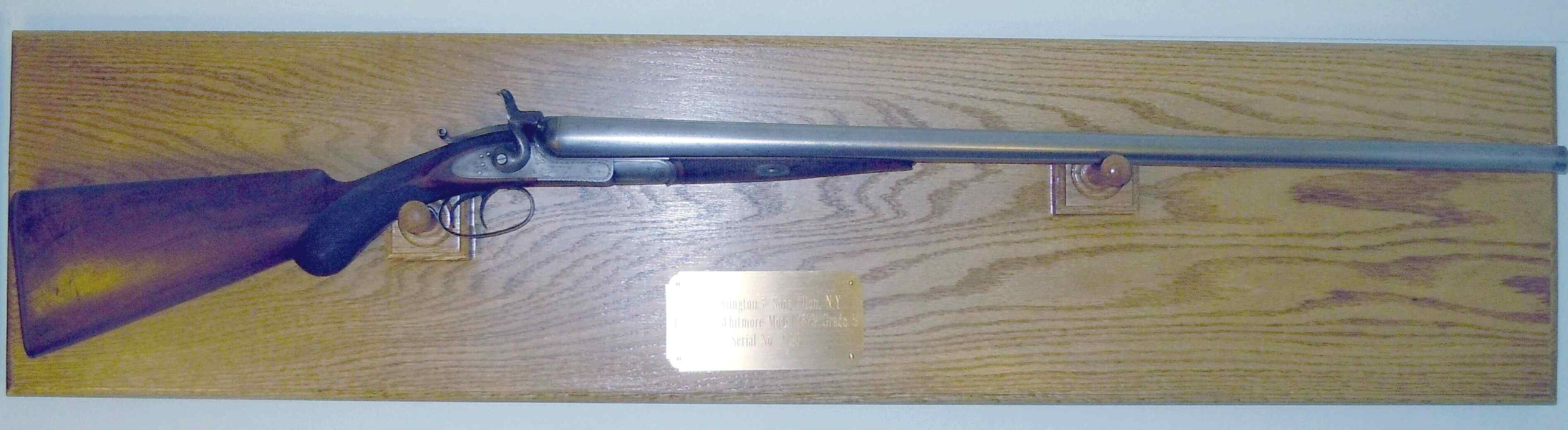

Does it look like this one?
- Shotgun 1.jpg (250.66 KiB) Viewed 11691 times

That looks like a Model 1878 Whitmore Lifter Action Remington double.

Grade 5. There is an engraved dog/duck scene on one side, and a rabbit scene on the other. This was my grandfather's shotgun, along with a .32 cal Hepburn rifle. Pics of both are posted on this forum.
The advertisement looked so much like this shotgun I just had to comment.

Jmcalli, Your Remington Lifter can be a Model 1876,1878,or 1879 the hammers,serial number,
barrel rib extension (dolls head) forend latch tells us what Model it is the pistol grip was optional.
