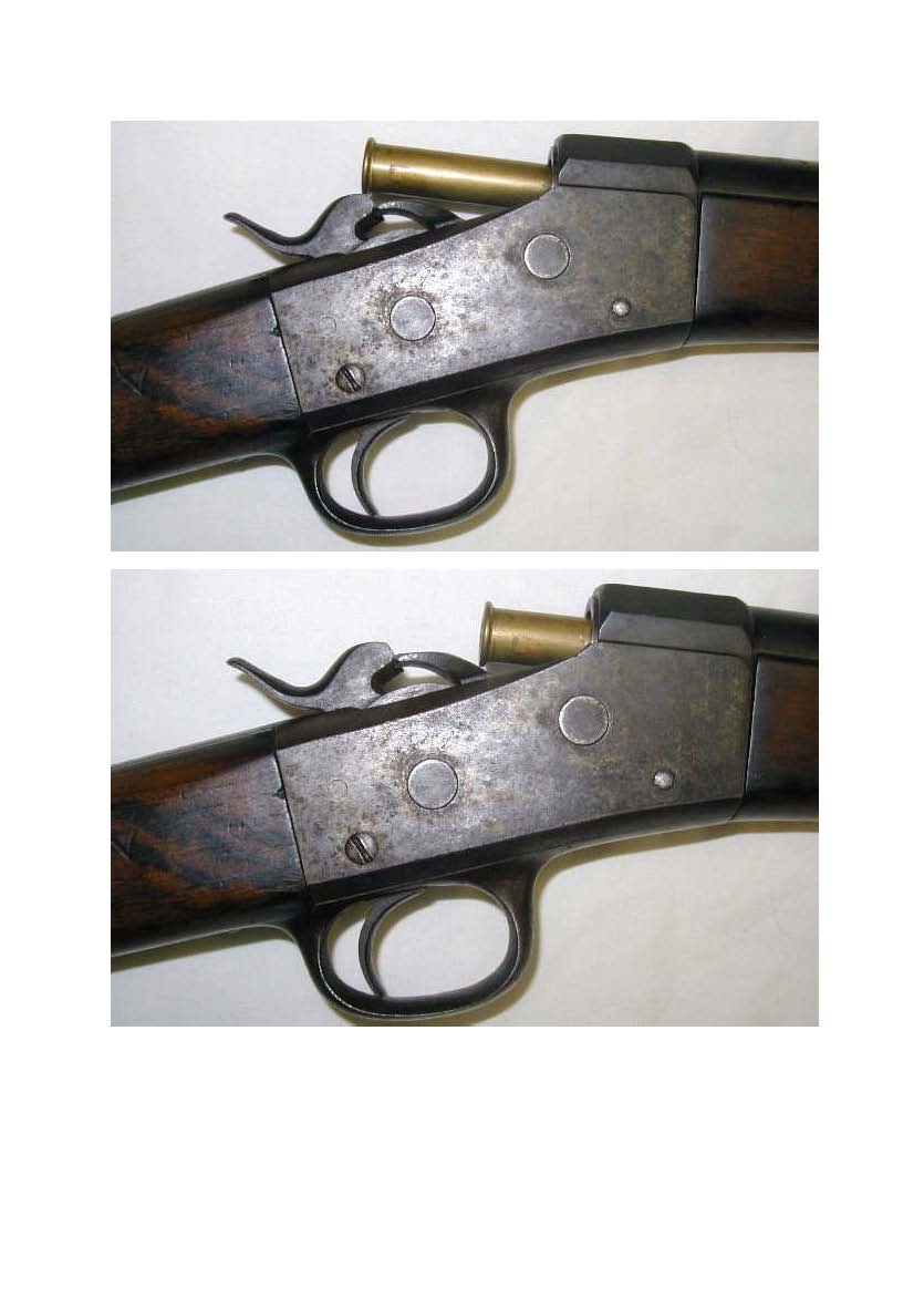

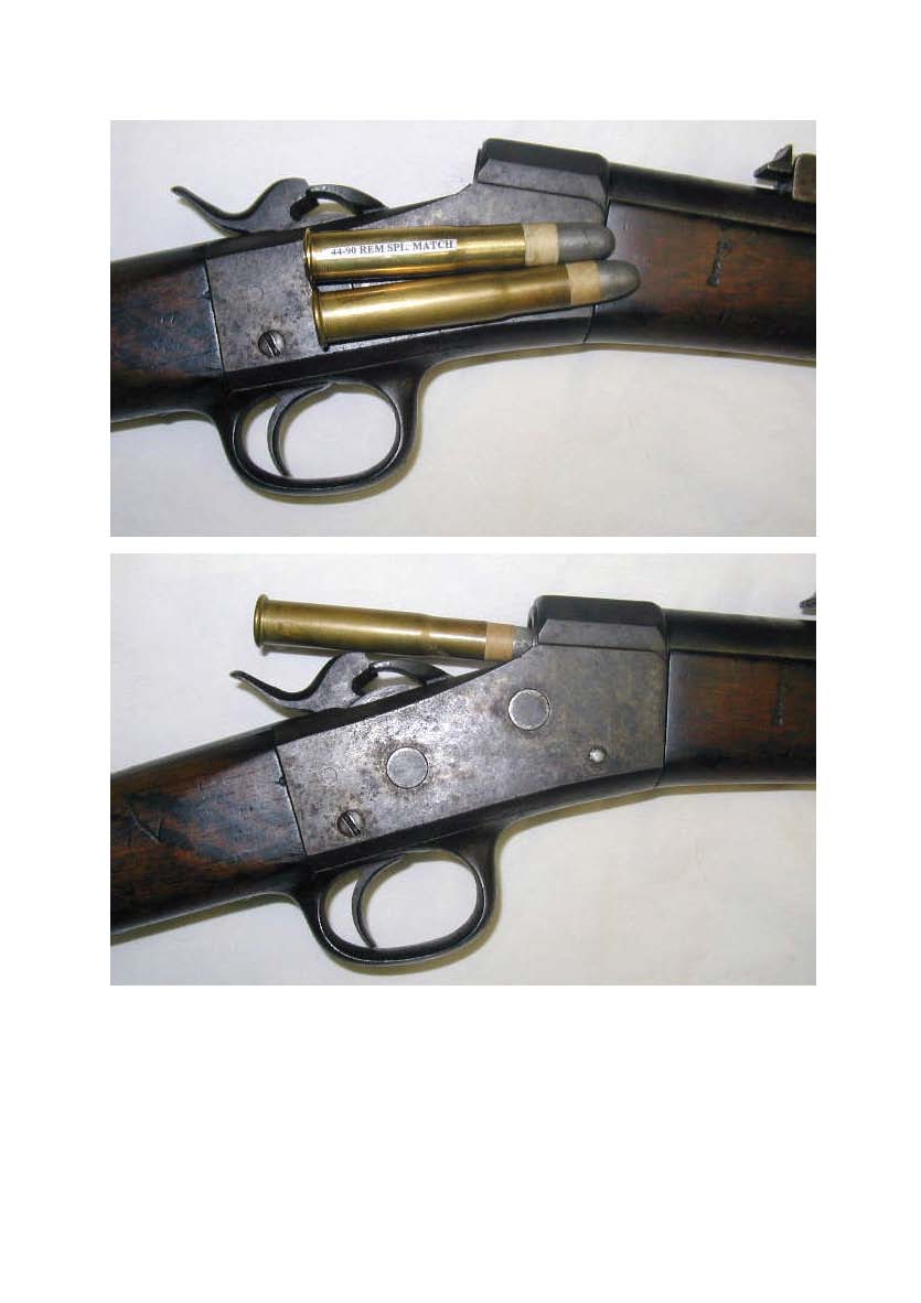

I have a Model C, Creedmoor Military stocked rolling block target rifle that is chambered in 44-90 Sharps. The hammer is not dish out at the nose and there is no problem feeding a cartridge into the chamber. At first I thought that the rifle was chambered in 44-90 (2-1/4") or the 44-90 (2-7/16") cartridge, but after doing a chamber casing the length to the shoulder matched the 44-90 (2-5/8") sharps cartridge. To see if the hammer face was modified to let the rim of the cartridge side by the hammer, I took the hammer out of the gun and replaced it with a hammer from your average millitary rolling block rifle, put it in the gun and had no problem feeding a round into the chamber.
In the photo below is the 44-90 (2-1/4") next to the 44-90 (2-5/8") cartridge so you can see the differents in the length of the two rounds.
Also the photos show the 44-90 sharps round being placed into the chamber.
Don't know if this helps any or just adds fuel to the fire.
Have a good day,
Matt
