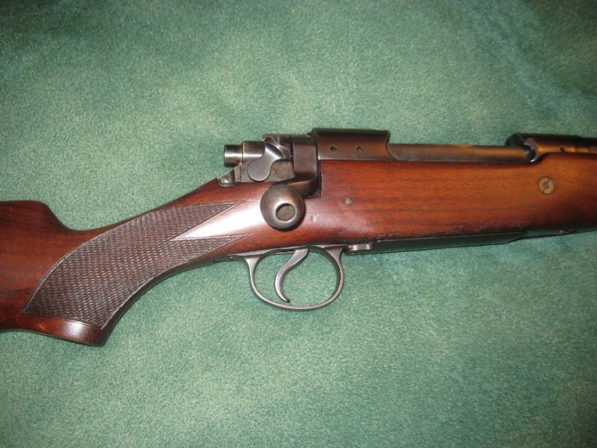

Here are a few pictures of my Model 30.
One question for you. Have you ever had a problem with extraction? I was cycling new Remington factory loads through my rifle and the first few I tried didn't extract properly. I went to a different box of ammo and everything was fine. On to a third box and fine there too.

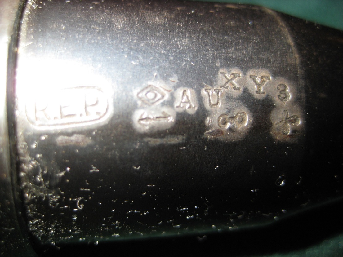

However, I did pick up another 30 express in .35 Remington. It is also an early rifle (10xxx), but it is different from the other one we discussed earlier. First of all, the magazine follower looks different. This follower on this rifle has a couple of small metal knobs (for lack of a better word) that extend to the left of the center spine. My other 30 Exp in .35 Remington does not have this. This later rifle feeds and extracts better, so I am wondering if that is in any way related to the magazine follower. Also, I am wondering if the follower on the other rifle is incorrect or if it just because it is a very early rifle. Secondly, on this rifle there are additional markings stamped by the usual date markings. These may indicate factory rework, or ? Finally, it has a Pacific aperture sight installed. The slide on the pacific is shorter than on a Lyman, and it looks like someone removed the original Lyman 48R and added some filler to close the gap left by the shorter Pacific slide.
I've attached photos (with rifle apart and Pacific sight removed) showing all this stuff. The rifle is actually a pretty good looking piece in good condition apart from the woodwork by the sight slide. I'd like to find a Lyman 48R to replace the Pacific if you think it will cure the filler issue. Hopefully I can chip out the filler and the 48R will fit nicely.
Any insight you have would be much appreciated.
many thanks
many thanks

My .35 is #10,14X, in the same range as yours. My follower doesn't have the studs like yours, it was just a cut down standard extractor, the put a plug in the magazine box for the shorter cartridge.
A lot of marks on that gun. When I get home I'll pull mine out and see if any match.
You can't see it from my last photos but my .35 doesn't have the schnabel forend, just a round one. I sometimes wonder how much work was done after it left the factory.
If you find the Lyman 48 or Redfield 80 it shouldn't be too bad to correct it since it's longer, easier than the other way around!
