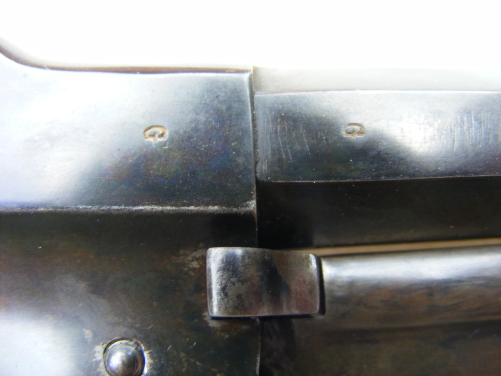

I have a very important question, i have a Remington NMA which i bought some time ago, have recently sold it on to a gentleman who is claiming that it is not a genuine Remington.
The question is, Do you think its a genuine 1861 era NMA ??
The revolver has at some time been polished up and reblued, there is no barrel address and no visible serial numbers,even under the grip.

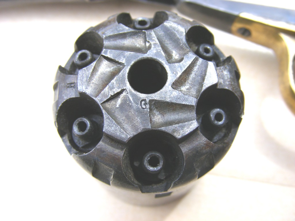

There are several inspectors marks, a G to the barrel and frame on the right side, an H on the right of trigger guard, and both G and H on the rear face of the cylinder.
There is a fouled anchor impression on the right grip.
I have e mailed some photos to your remington address. Also put a few on here, hopefully !
Your opinion would be gratefully recieved and hopefully solve this problem.
Thank you very much.
Richard.

From what I can see from the photos, is that it's a Remington.
However, I have a refinished New Model Army and there are some traces of the original markings visible. The fact that it doesn't have a serial number under the grips is very strange. This area is not usually heavily buffed, and the S. N. is usually stamped quite deep.
I don't think it's possible to say, for sure, that it's a Remington based on the photos and information given.
This is my humble opinion.

In my opinion it is a refinished original New Model (not 1861 ) The Refinisher added the inspector marks to the frame,barrel and cylinder. I have never seen such marks on the rear of the cylinder. One final serial number check is to remove the trigger guard screw and the trigger guard and see if the tab at the end of the guard has a serial number or partial serial number present. All originals were marked under barrel,under left grip and on tab on trigger guard. I don't know why the refinisher erased the numbers since it makes it look like a fake. It destroyed the value of the gun and if there is no number on the trigger guard he was trying to disguise it for some reason and I would consider it a fake. Something is wrong. Jay Huber

I am looking at one of my 1858's which has proof marks (W) on the right side frame and barrel aligned vertical ( so M or W) Mine has D,R,& W on the left side and they are half the depth of the S/N under the left grip. Those of this pistol appear not aligned with the barrel & no proofs on the left side and lack of S/N makes this one sound a little off.
Even if this pistol was refinished I gotta agree with Jay there is no reason for the S/N to be missing from the grip area and having done a tiny bit of it myself there is really no reason for the proofs to be missing with the exception of those arms which are nickeled.

Second point. If I was in the same position as '357' I would treat his gun as an 'Antique'. It is up to the authorities to prove otherwise. I have been dealing in 'Antique & Classic' guns for over 40 years and ocaisionally something like this comes up. Based on probability the gun is old. It shows no signs of Italian or Belgian proof marks and the inspectors stamp looks OK to me.
