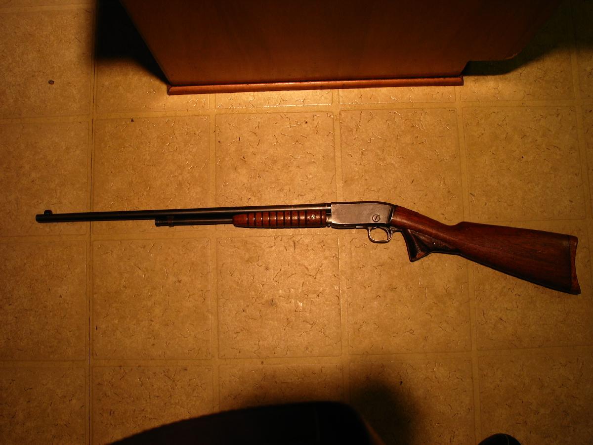

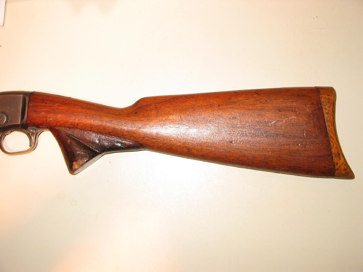

My wife has a family heirloom handed down from her father. Her understanding is that her father acquired it around the age of 10 (born 1915) and learned to shoot with it, as did she. It was "customized" by her father to fit his stature at the time, shortened stock with homemade but cap and rather crude pistol grip added to the straight grip.
If anyone can do so, I would like to know the month/year of birth.
Markings (Model number "12" not found anywhere);

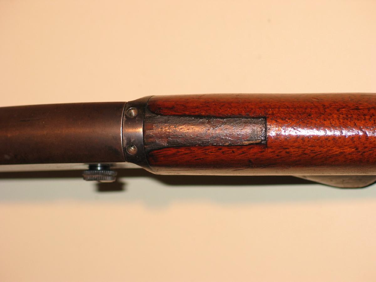

It's missing the rear barrel sight but has two theaded holes in the top of the trigger group frame and an interesting inlay in the stock to the rear of the screw holes. There's two screw holes in the left side of the barrel that are obviously add ons, but for what I'm not certain.
Left side
Left side
top rear of trigger group, flip sight?
Stock "customizations"

Your pre-Model 12 was made in 1909. There was a Lyman or King peep sight on the rear at one time. That's why the normal rear sight is missing. The barrel has been replaced since the 1909 rifles were stamped 22 Long Rifle (not short or long). There might be a "3" with two or three letters on the left side of the barrel near the receiver. If so, click the barrel code info (manufacture dates) on the home page. It will tell you the month and year the barrel was made.
