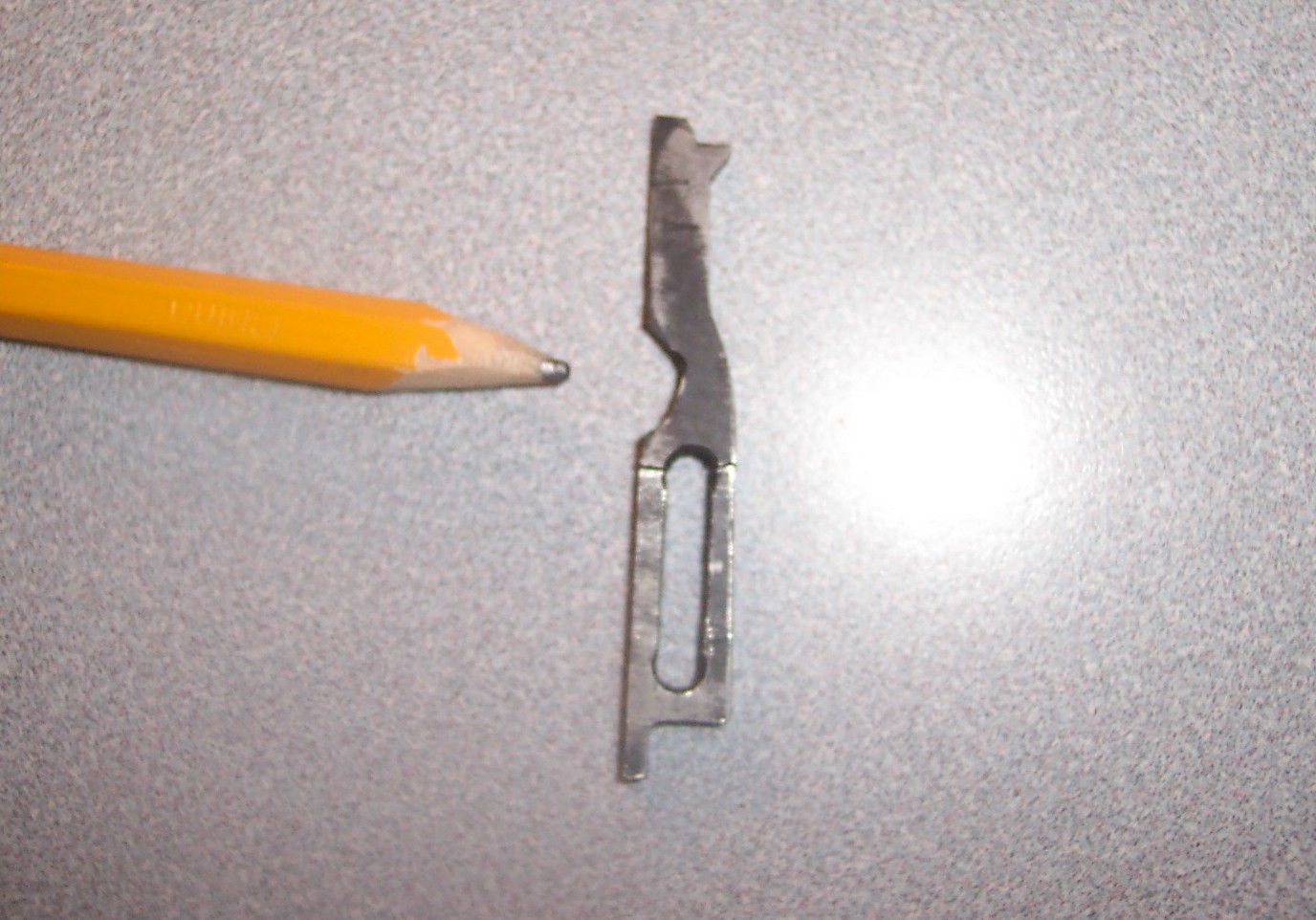

I'm replacing a broken firing pin on a model 12c, and the replacement part is a little different than the old one. The original has a notch in the side of it, and the new one doesn't, so I can't install both of the firing pin pins. It looks to me like this one will work, but I was wondering if someone knew a little more about this model than I do. I tried to attach a photo but the file was too big.

What is the serial # of your M/12??? Two different ones were used during the production run.

Your tip of your firing pin should be nearly round. Earlier ones were flat (sometimes called square). If you have the right one, some fitting is often needed.

The new firing pin does not have the notch that the pencil is pointing to, so I can't install the 2nd pin through the breech block. I just want to be sure that the gun will be safe.
