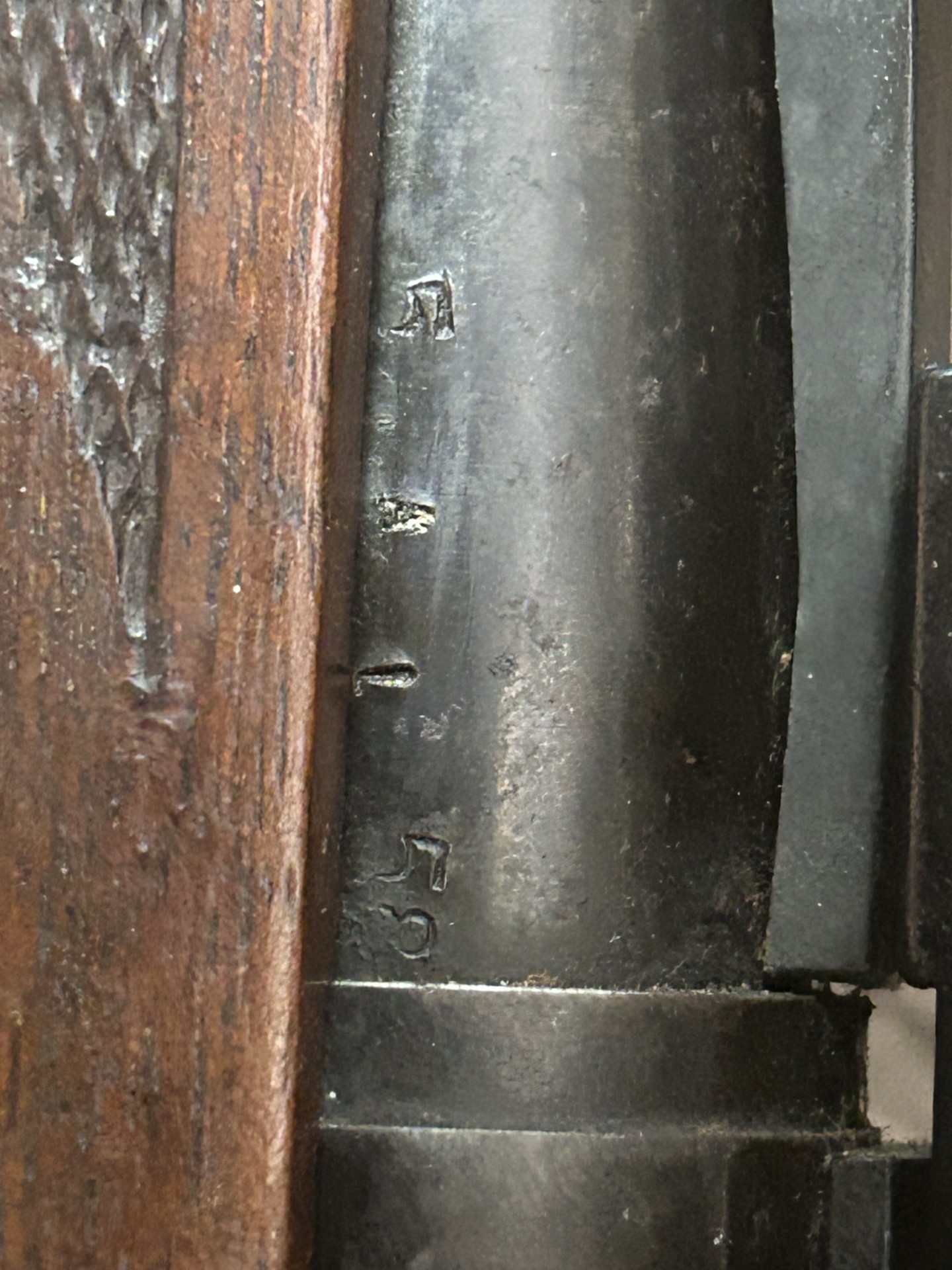

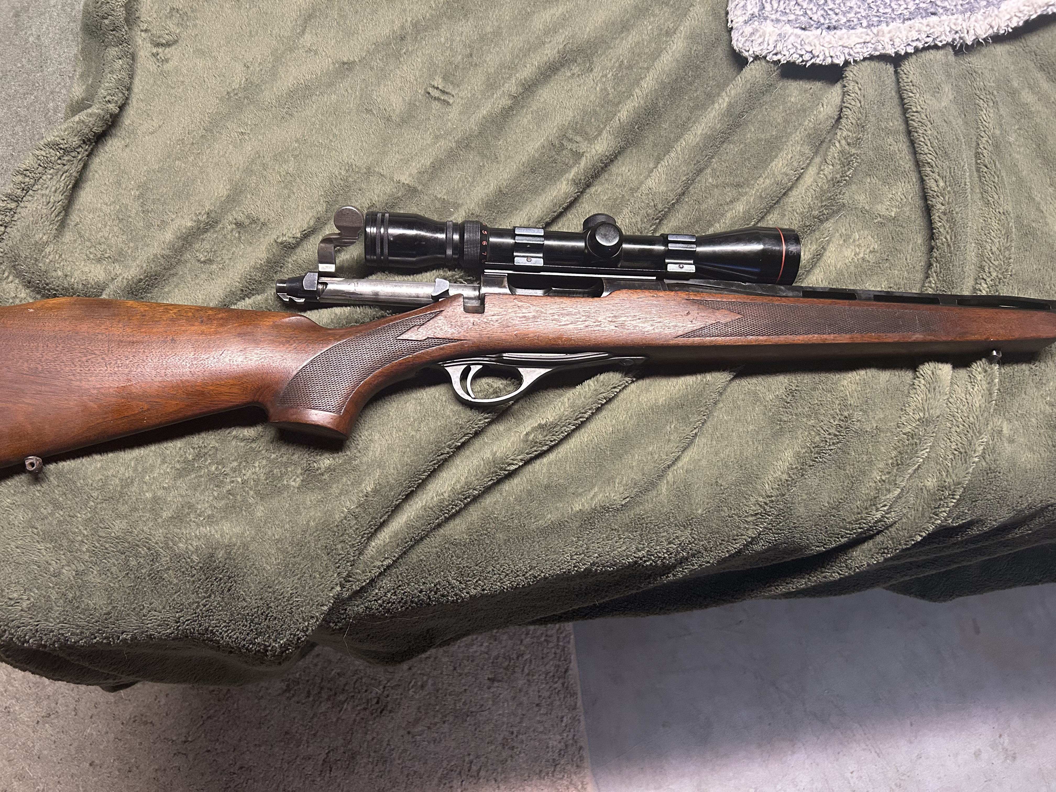

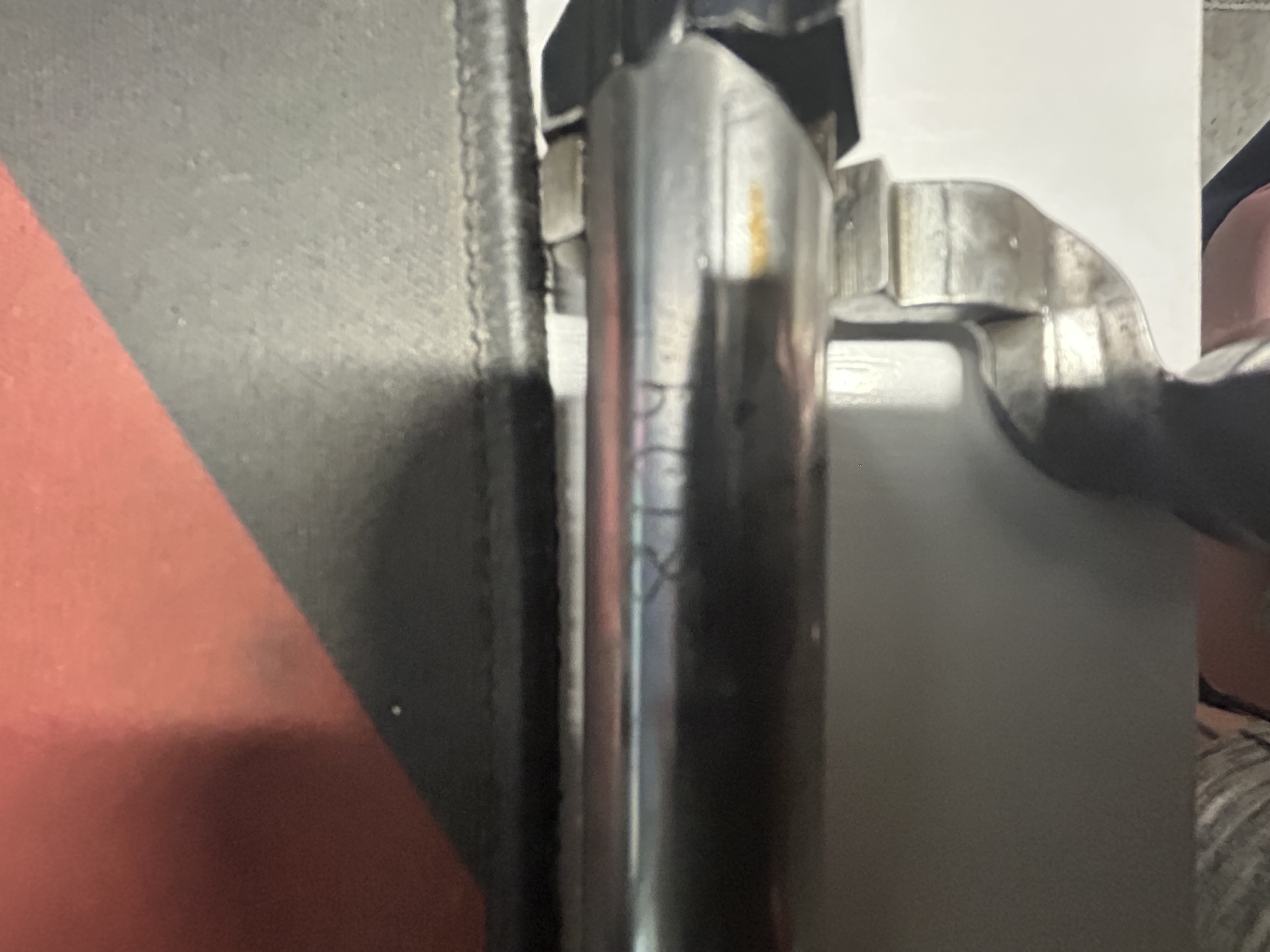

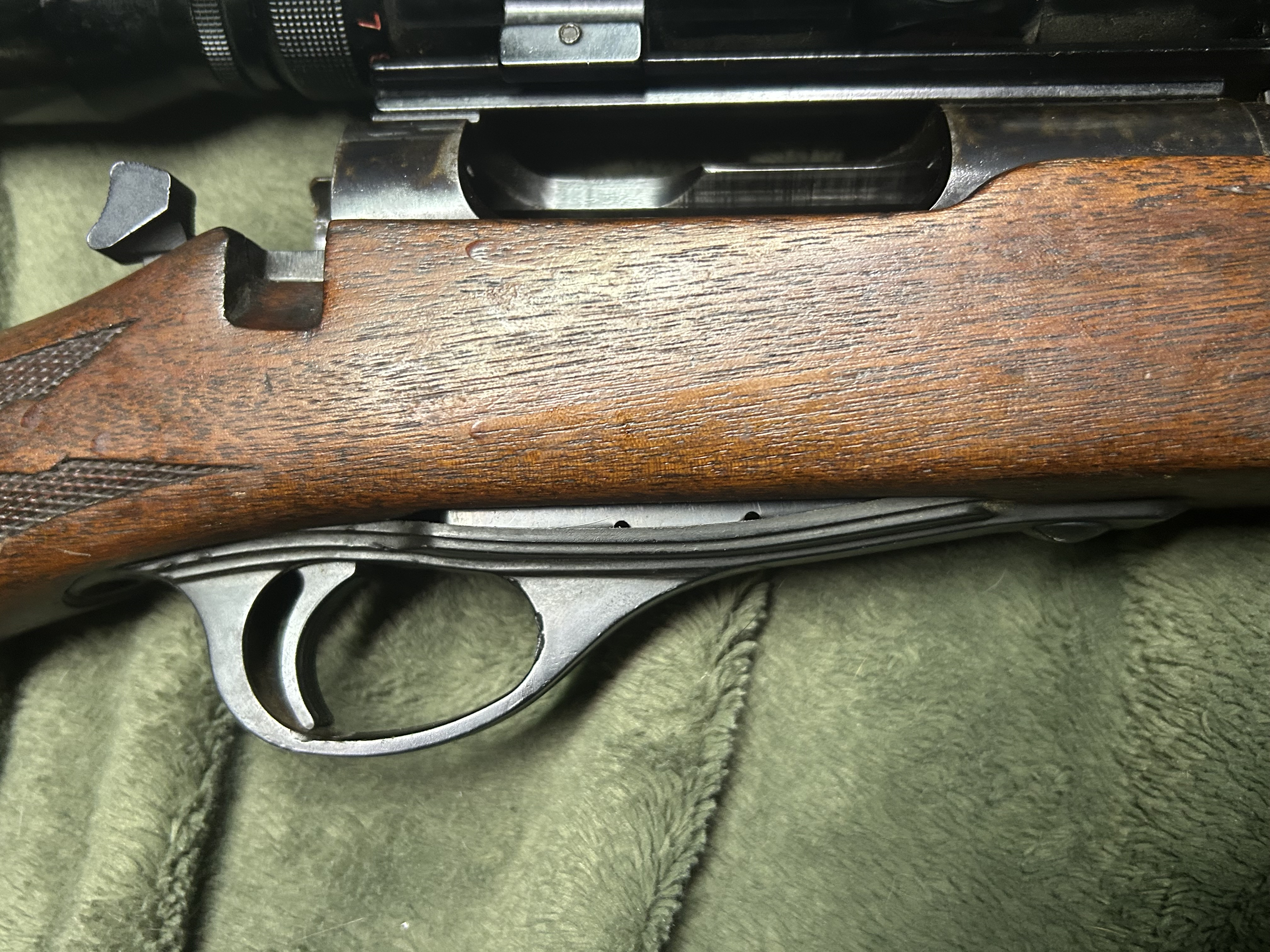

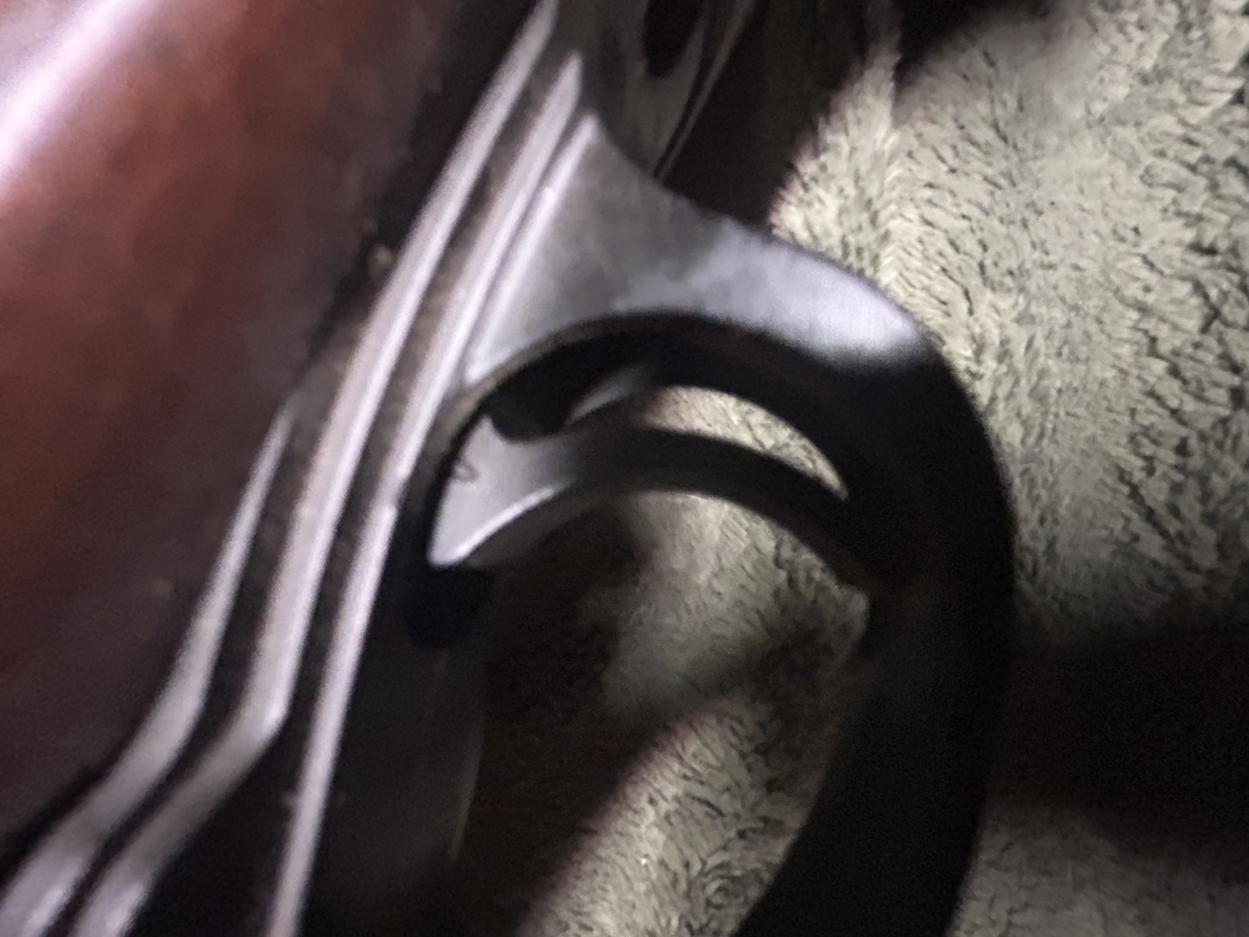

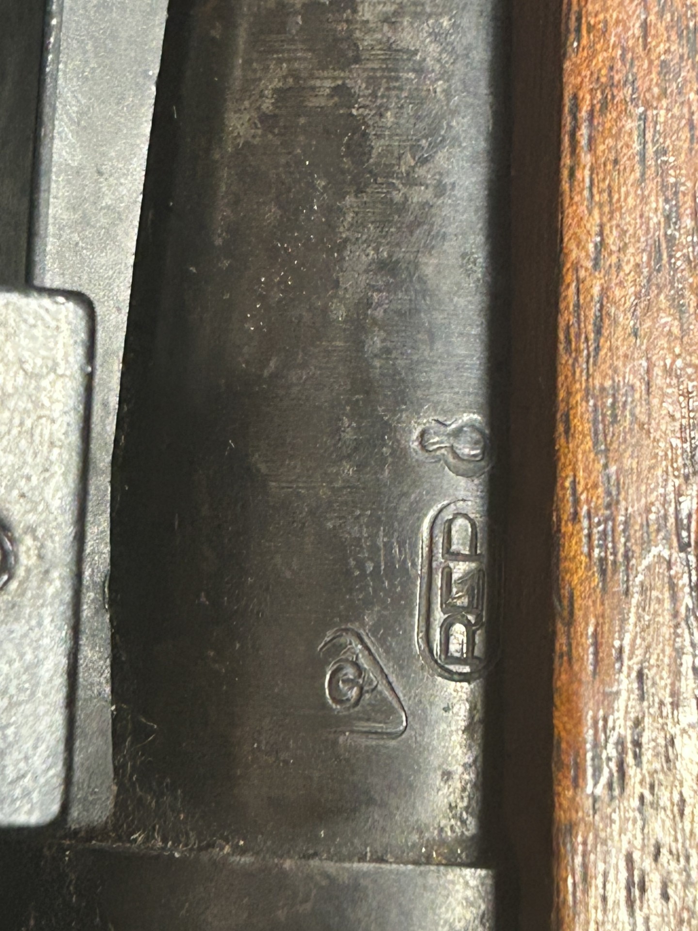

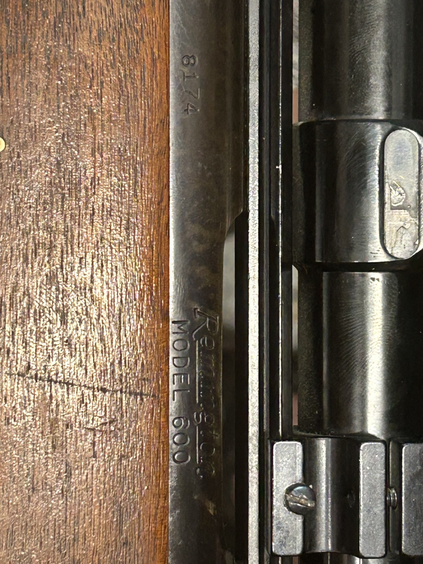

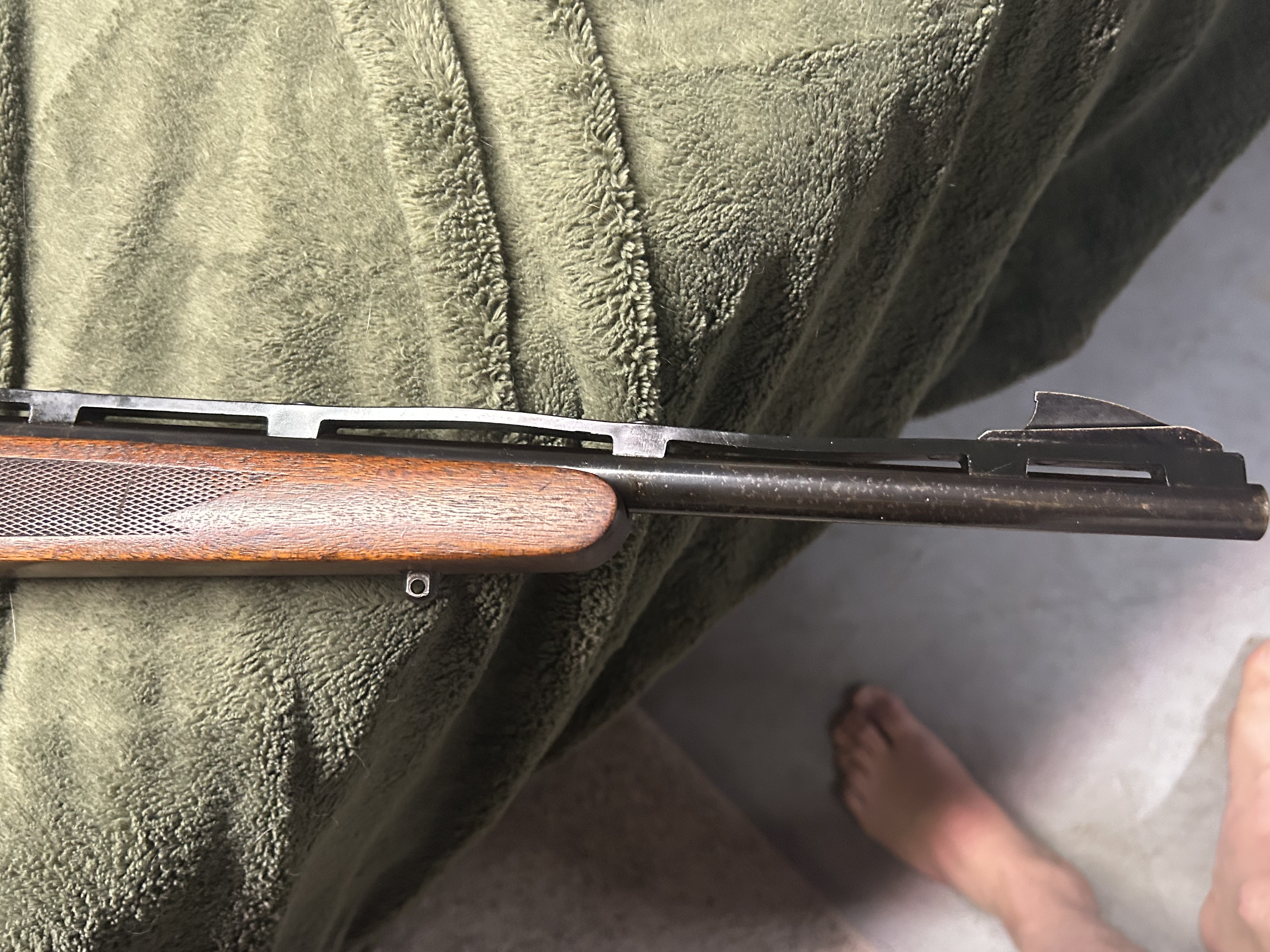

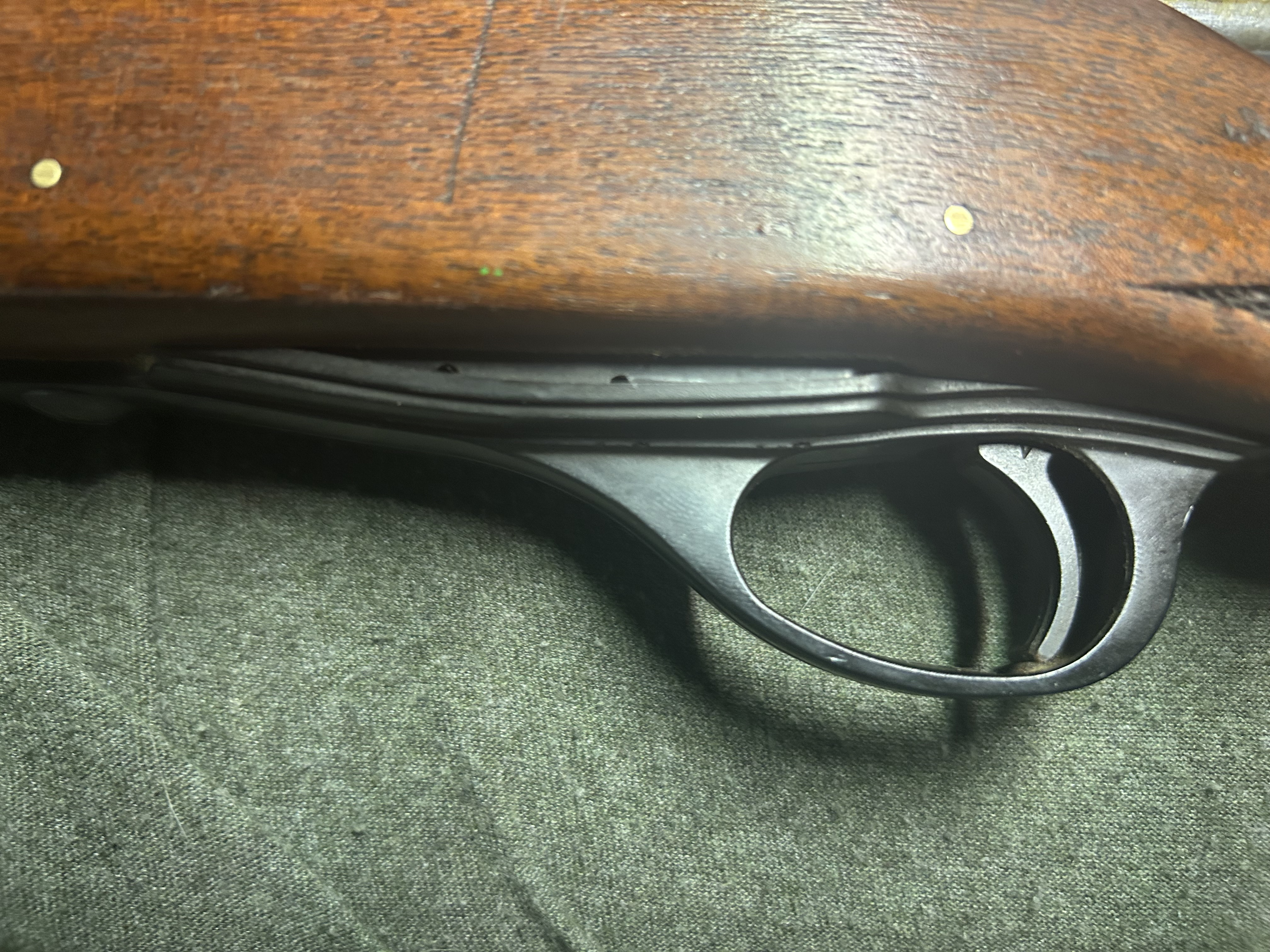

Been trying to figure out the date on my Grandpa's model 600. Left side of the barrel appears to be 5 AL 58. Left side of receiver 8174. It need's some TLC as it was his daily driver for deer years ago. Should I replace the trigger guard plate? It has the usual sag. OEM or metal replacement? Also any recommendations for recoil pad? They say the .308 kicks like a mule. What all needs updated on this or checked out to make sure it's still safe to fire? Any upgrades? I've wanted to shoot this rifle for over 30 years. Since I inherited my family's gun collection after my uncles passing my goal is to hunt with and successfully harvest whitetail deer with all my family's personal meat sticks. Thanks everyone

First year, March 1964 for a build date. The internal mag box is installed incorrectly causing the major warp in the trigger guard. It has had the trigger recall-the V on the trigger tells us that. You can still find trigger guards that aren't too warped. The rib is a bit tougher. You mite want to go metal for both warped pieces as is would add some recoil absorbing weight, albeit very little. Do NOT cut the stock for a recoil pad-ruins the value. Make sure the trigger workings stay clean and dry-no oils-dry lubes only. Watch that fluids from the barrel don't seep down into the trigger.
