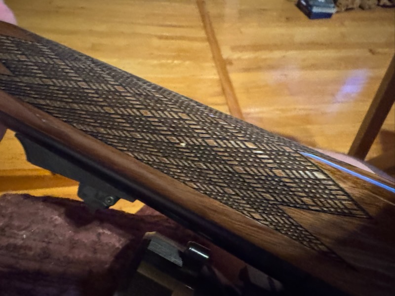

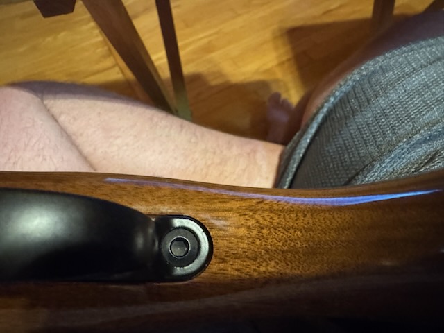

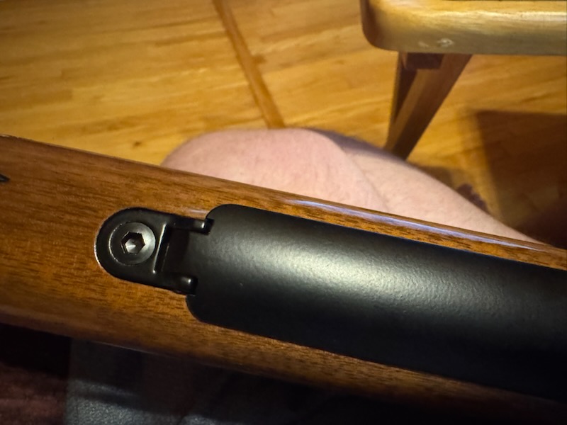

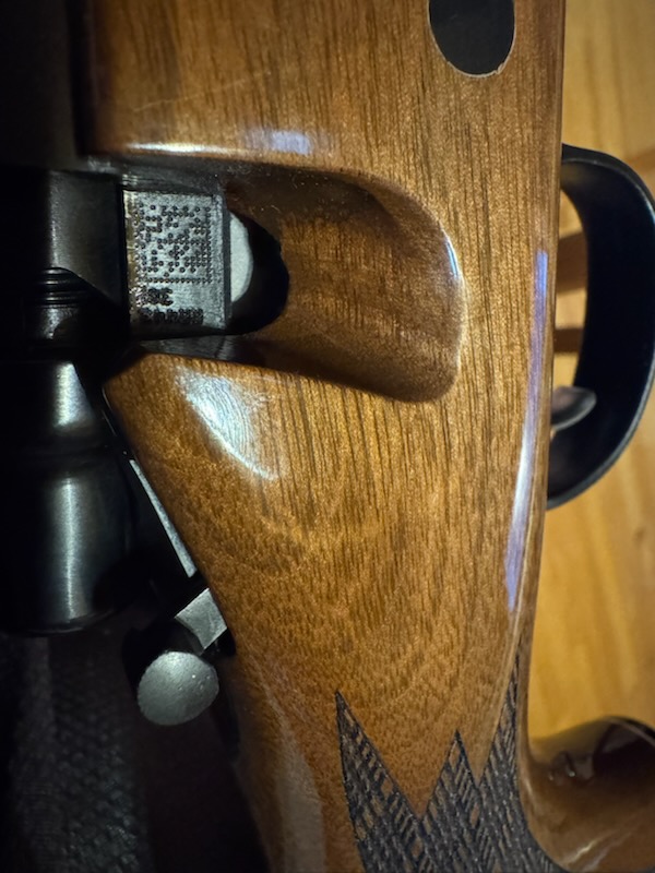

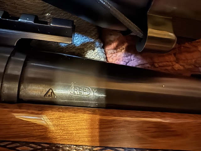

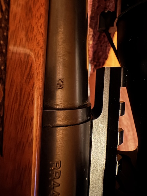

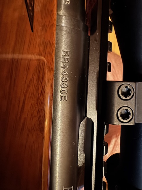

My name is Chris and I am a new member. I just picked up a previously enjoyed model 700 BDL .30-06. I know its not a classic rifle based on the action screws are Allen heads not slotted and the dot matrix code under the bolt handle. I know its older than 2 or 3 years based on trigger is not a Timney. SN RR44330E. I am thinking it in the last 10-15 years. The checkering looks laser engraved. How close am I on the age?

It is the barrel markings you are looking for to date most. The "RR" or any letter(s) before the serial number is only a clue. XH would be Dec., 2013. Mid 1999 to late 2001 the date code on the barrel was suspended.
