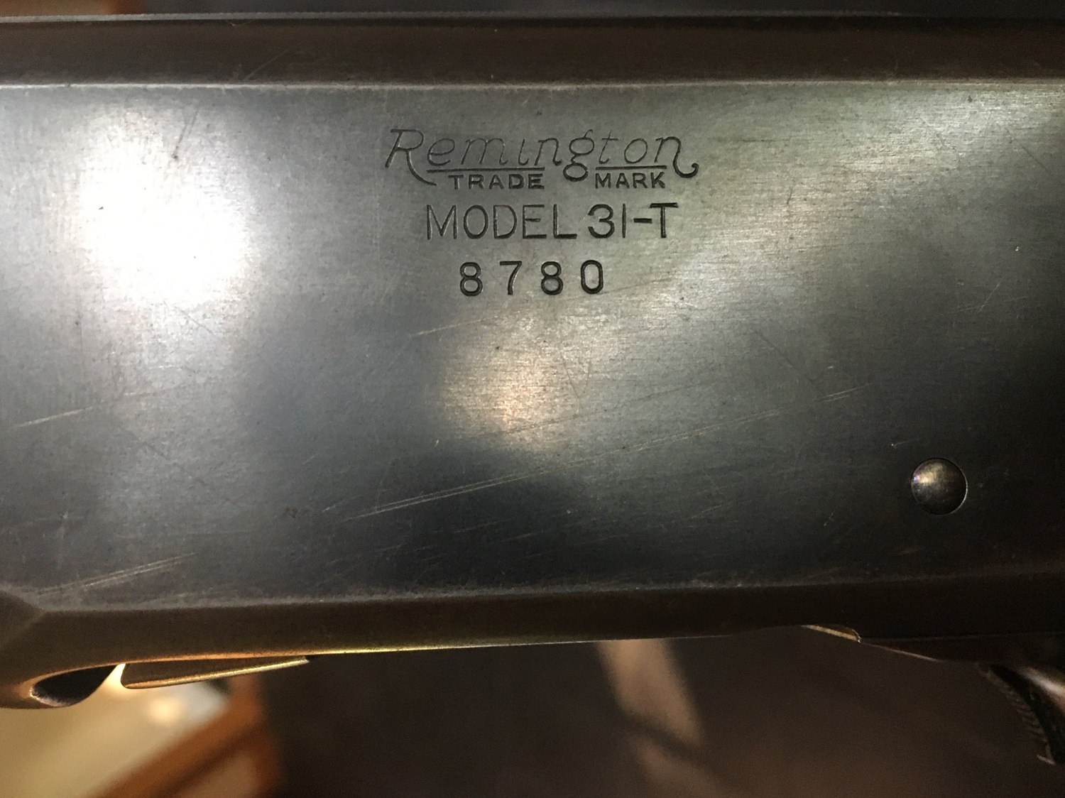

Probably just took a bit for the folks on the factory floor to catch up with what the boys & girls in the office were putting in the catalogs. The highest serial number I've recorded marked Model 31-T is 8780 --
