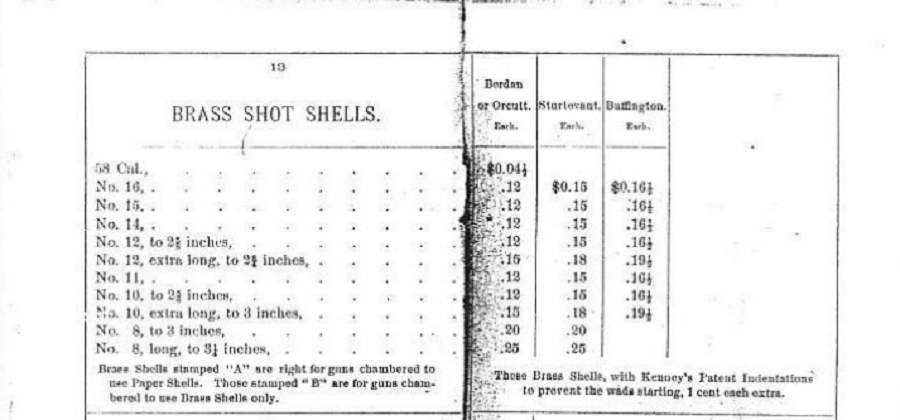

Re: Rolling Block Sporting Shotgun
You guys are talking about modern shotgun shells. Back in the day, brass shells came in A and B sizes for each gauge. Those marked A were for use in guns made for paper shells, and those marked B were for guns made for brass shells only. From an 1880 Union Metallic Cartridge Co. price list --
1880 empty brass shotshells.png (196.04 KiB) Viewed 25913 times

Researcher,
Thanks for explaining the difference between the old shell sizes and new. Would these all be black powder loads?
Do we know when "B" brass was phased out? Just curious not really a shotgun guy.
Thanks for sharing your extensive knowledge.

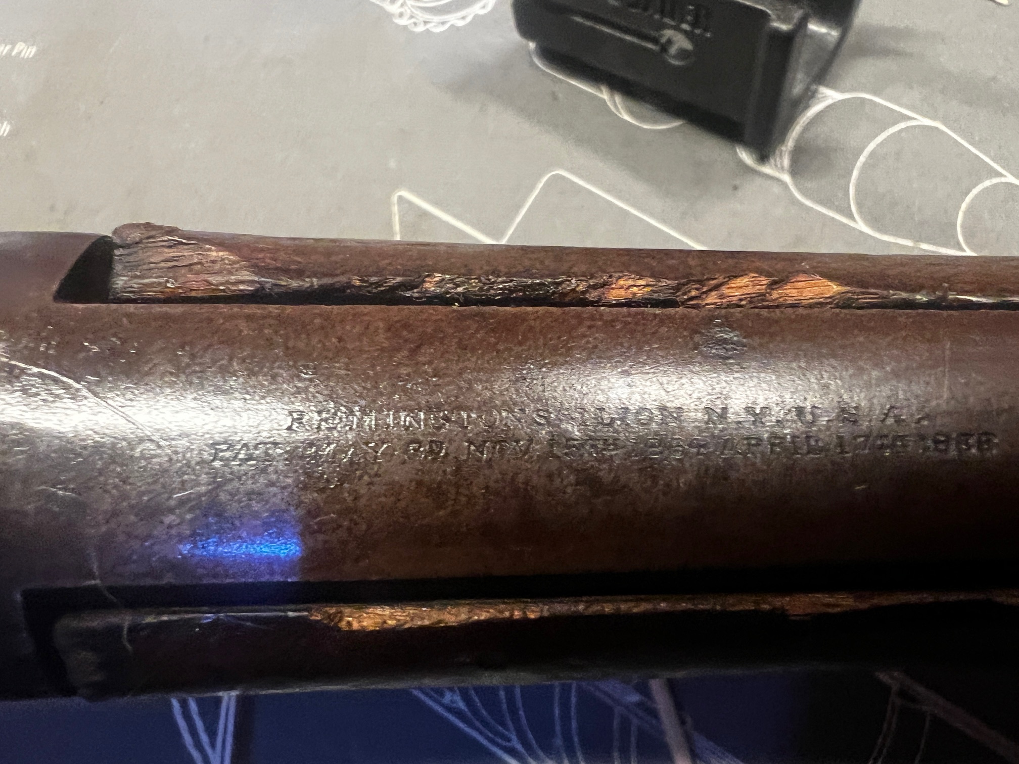

I recently purchased this Remington Rolling Block 20 Gauge shotgun. The Auction listing had indicated it did not have a serial number, but I found one on the tang.
Serial Number on Inside of the right Tang is: 41904
20 Gauge
33" Round Barrel
Can anyone tell me what model this is and what year it was manufactured? Rolling Block #1 Sporter?
