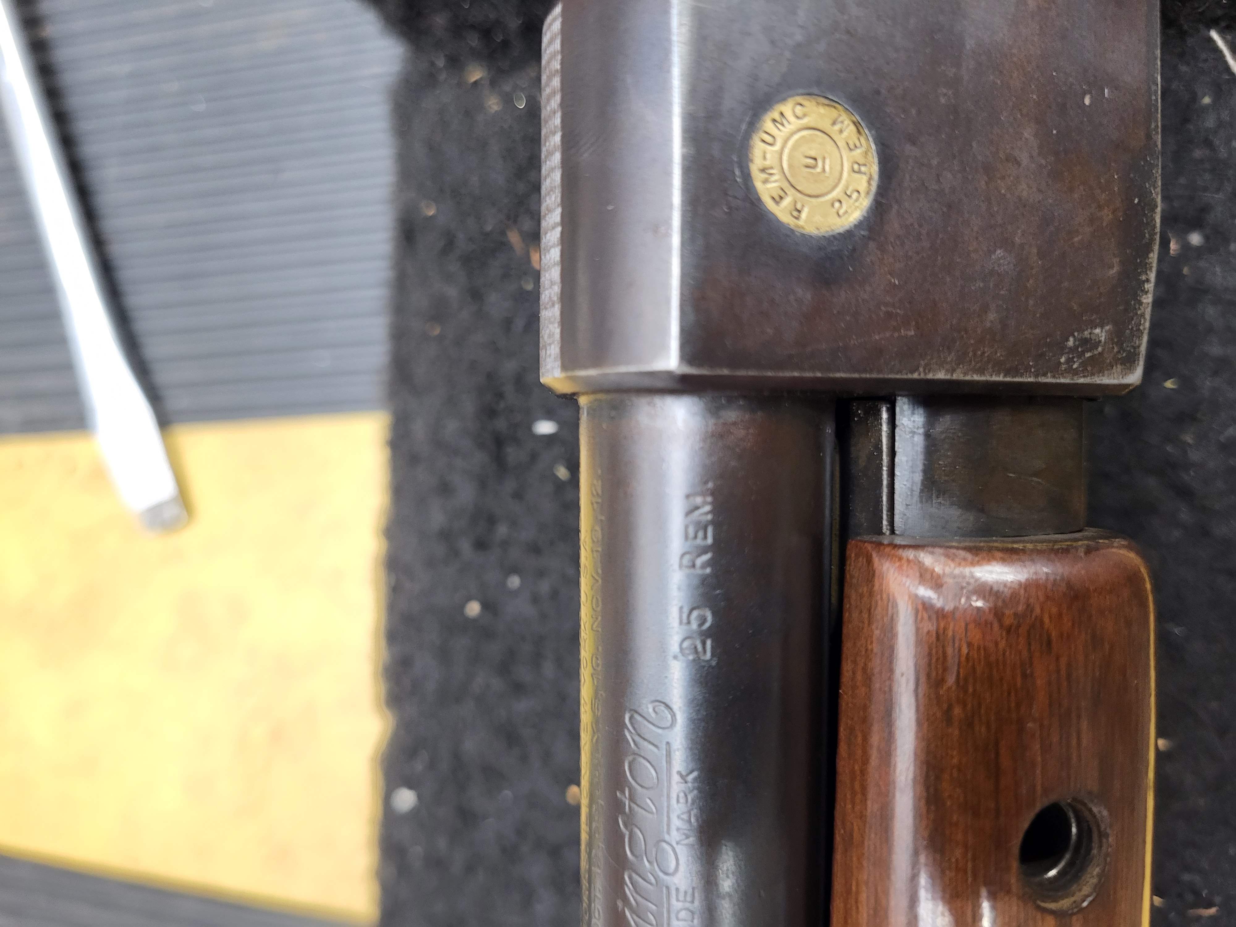

Re: Model 25 issues
Here is a pic. Everything resembles a model 25, maybe I'm wrong?
- 20240126_162157.jpg (2.96 MiB) Viewed 3421 times
Re: Model 25 issues
So it appears I have a model 14 instead of model 25. Anyone have any thoughts on the issue at hand.
