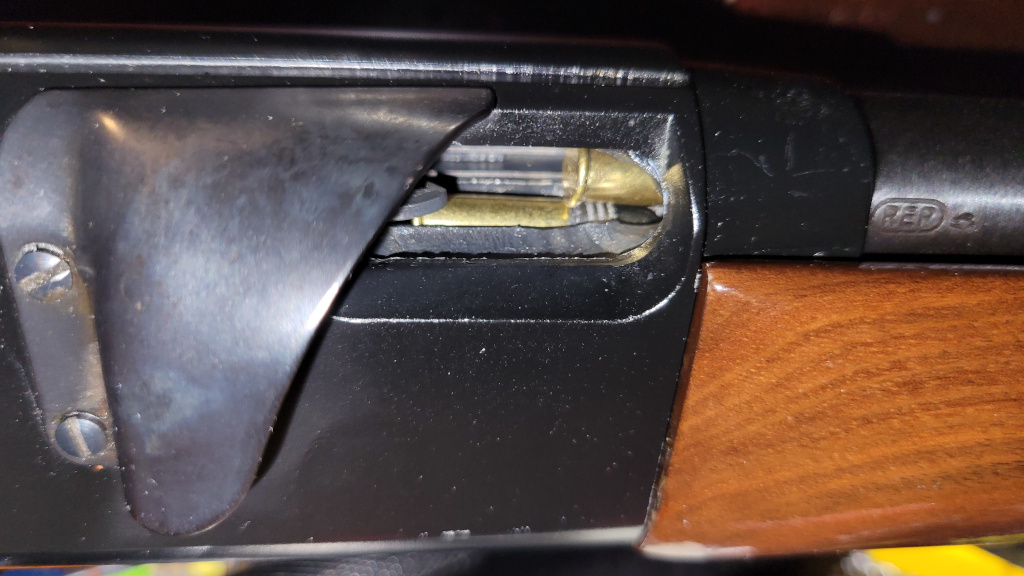

Bought a 552, and it was Filthy but functioned well. I had a tough time getting the barrel out. Took it to Miller's Gun in Jacksonville NC to have him remove it without damaging anything. Then brought it home to clean. Four hours later I had it looking pretty again. Reassembled using a Youtube Video as a guide. But it fails to chamber the cartridge.

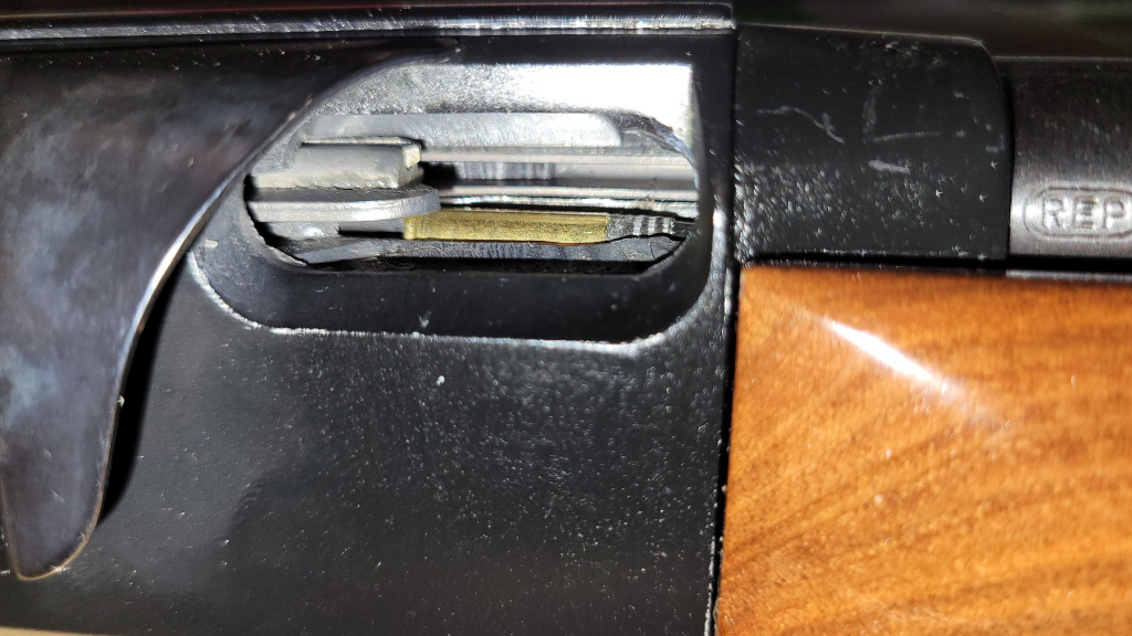

As can be seen the cartridge didn't enter the loading port at an angle sufficient to put the nose in the right place.
Resulting in one heck of a jam.
Have any of you experienced this... What did I do wrong ?

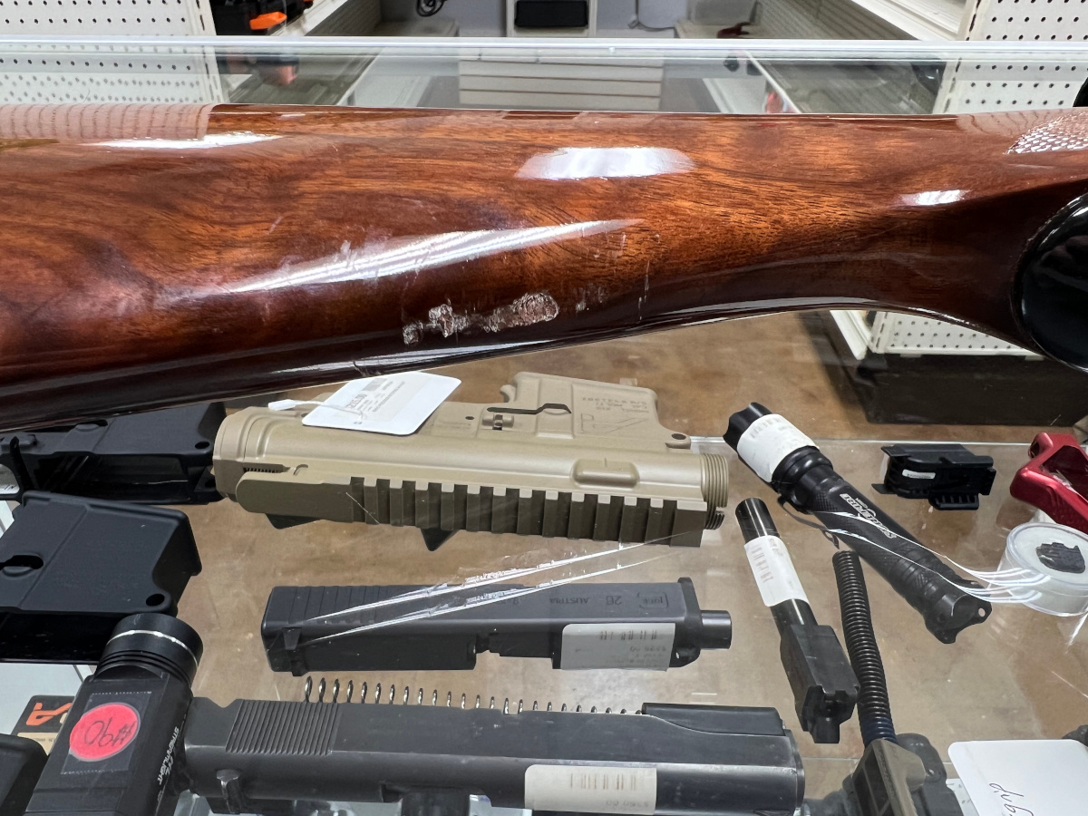

[attachment=0 Now to fix the Ugly Stock damage issue
