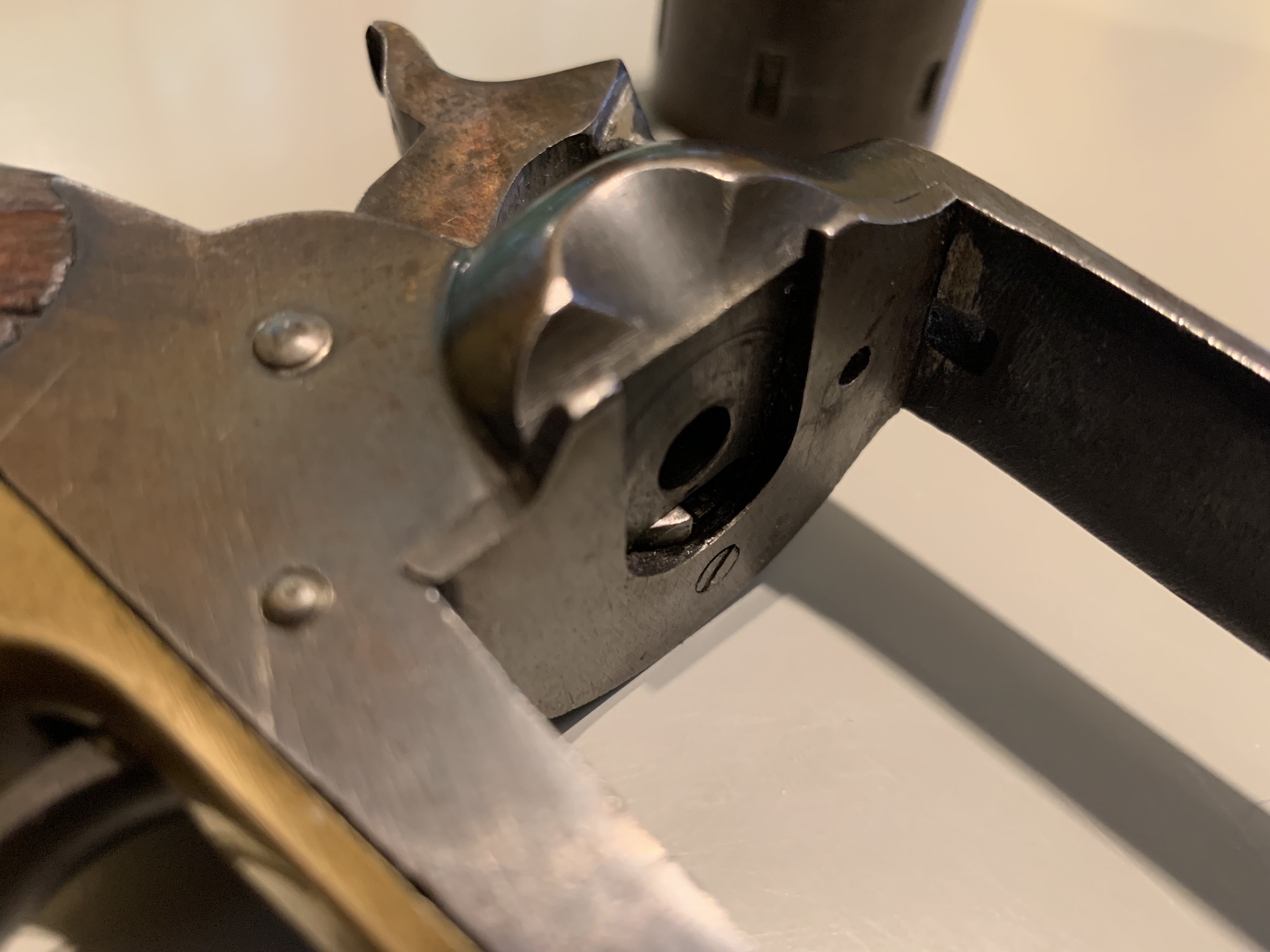

Just bought a converted '58 that appears to be chambered for 45 Colt. Chambers measure about 0.480" which matches the Colt.
S/N is 86xxx and would appear to have been made in July or August of 1864. No military marks are present unless the W stamped next to the blast shield is one. S/N on barrel has 33 stamped on top of it and 33 is also stamped near the frame S/N. S/N on trigger guard does not match.
The conversion consists of a new cylinder and a flat metal plate inserted in the front of the blast shield. The hammer has either been replaced or modified to strike the primmer.
Any comments on this type of conversion?

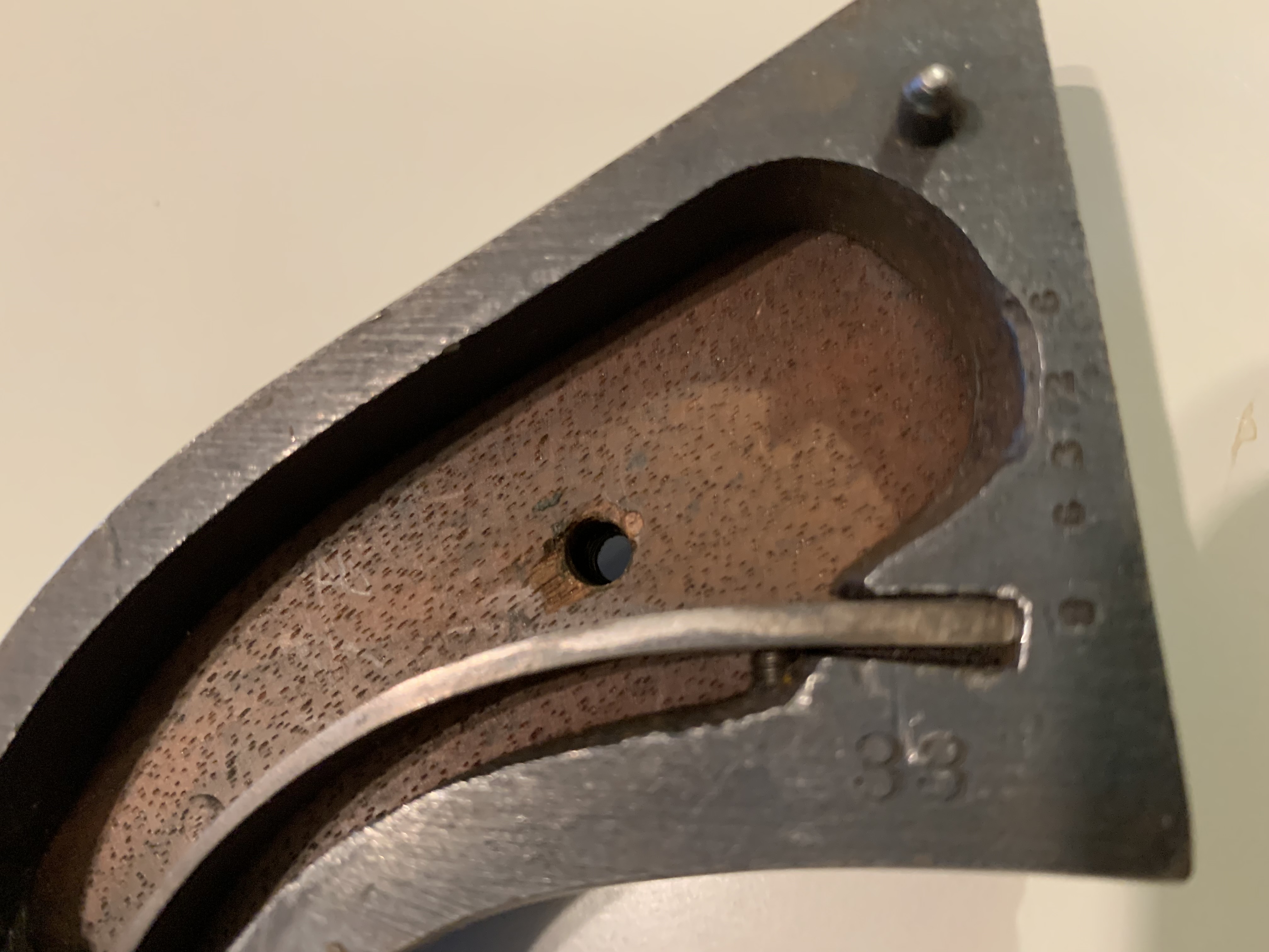

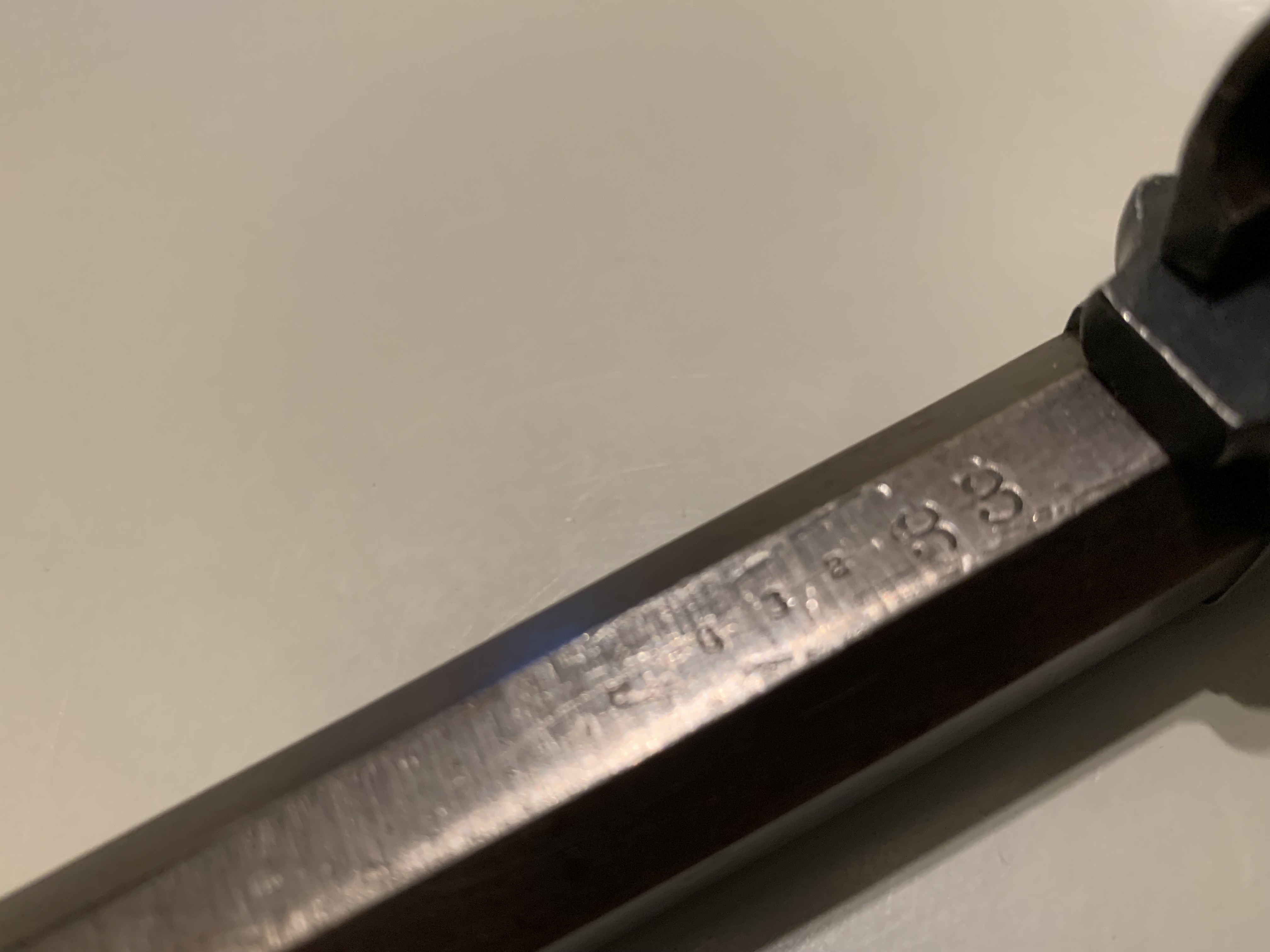

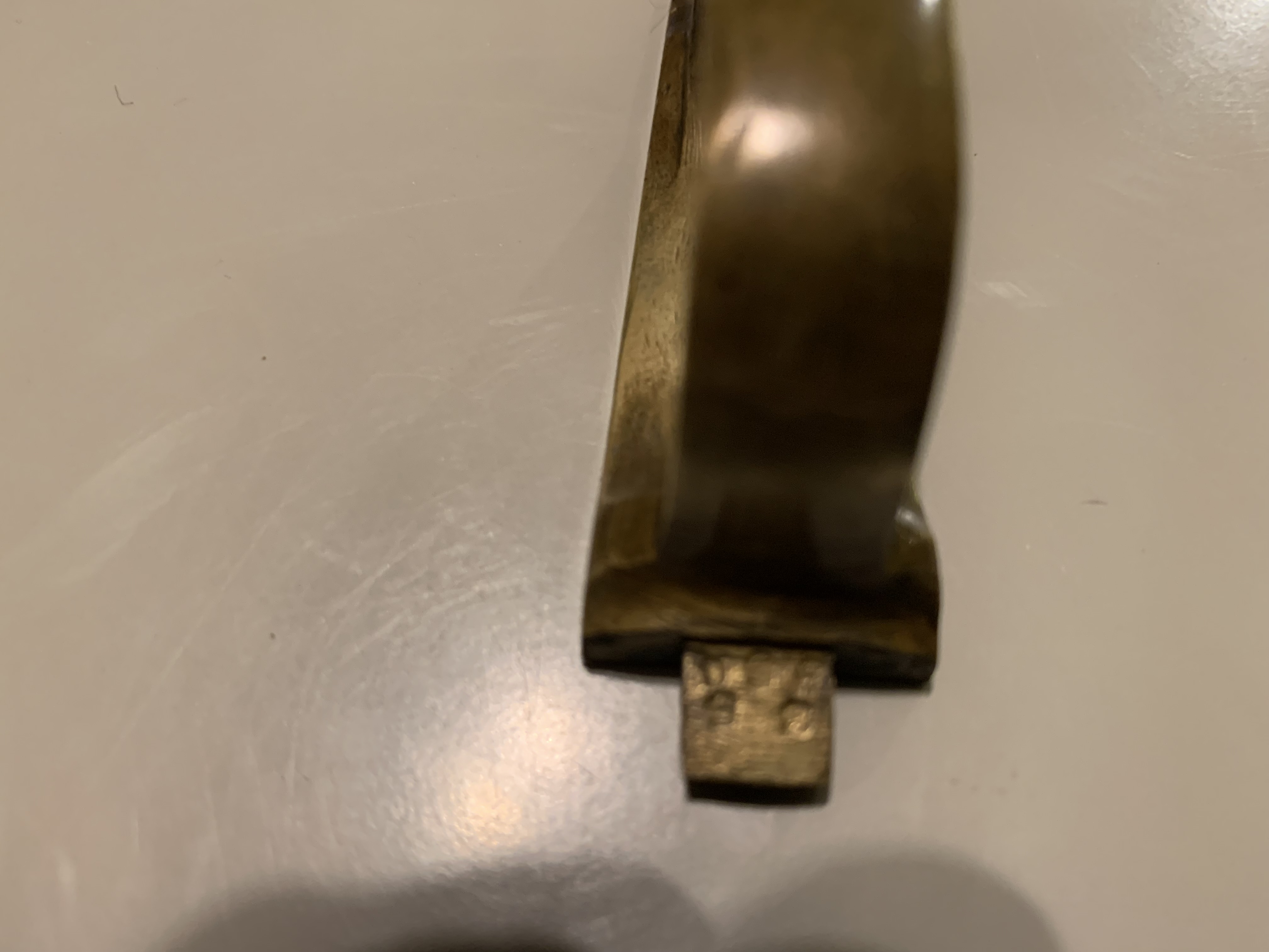

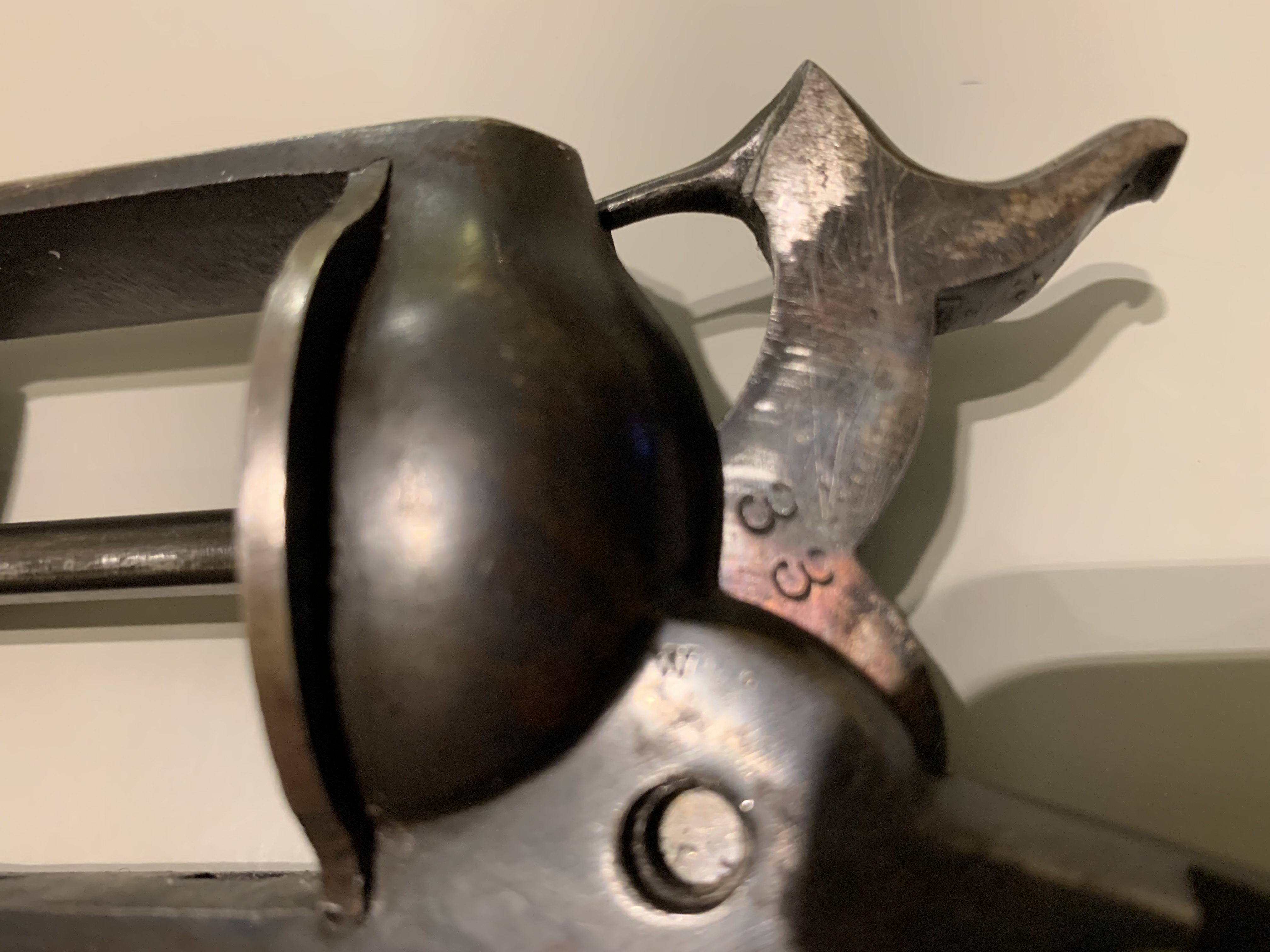

An update -- didn't notice stamp on hammer. Turns out to be 33. So 33 is stamped in at least three locations. Frame near S/N, barrel close to S/N and hammer.
Attached are additional pix.

With the number "33" stamped on the hammer, I suspect that this conversion was done by a gunsmith, a firearms store, or machine shop, not by Remington. I'll check the book on Remington conversions when I get home Monday.

Whoever made the conversion did a nice job. The frame is milled nicely to fit the steel plate spacer. I haven't removed the spacer to see what's underneath.

Sorry, but no. There is nothing like it in Ware's book on the large frame Remington revolvers, the book on Remington conversions, or the book, "Metallic Cartridge Conversions". There are some that are similar, but none are like what you have. I have seen a few conversions with long firing pins, but don't remember any details about them, or even if they were Remmies. Sorry I wasn't able to help.

Is it possible that the cylinder is two pieces, joined together? Looking at the photos again, it looks like a very faint line around the cylinder near the back. Also the finish looks slightly different between the front and back of the cylinder. It might be an original percussion cylinder with the rear of the cylinder cut off and replace with a bored through segment.
It's also obvious that the hammer screw is a replacement. Another questionable point is that the recoil shield was milled above and below the capping cutout, but why? They have no apparent purpose, and they don't allow the gun to be loaded or unloaded without removing the cylinder. A lot of questions, but sadly, no answers.
