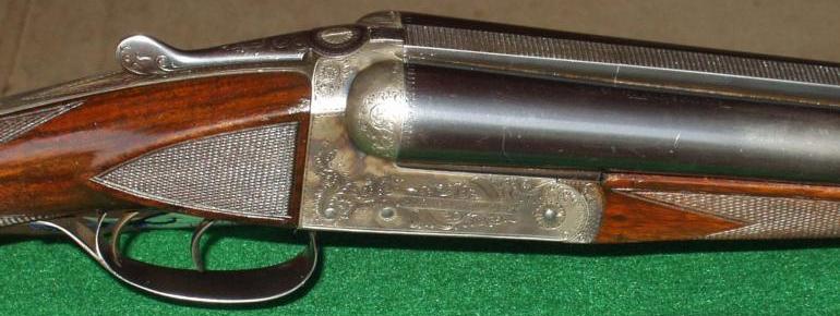

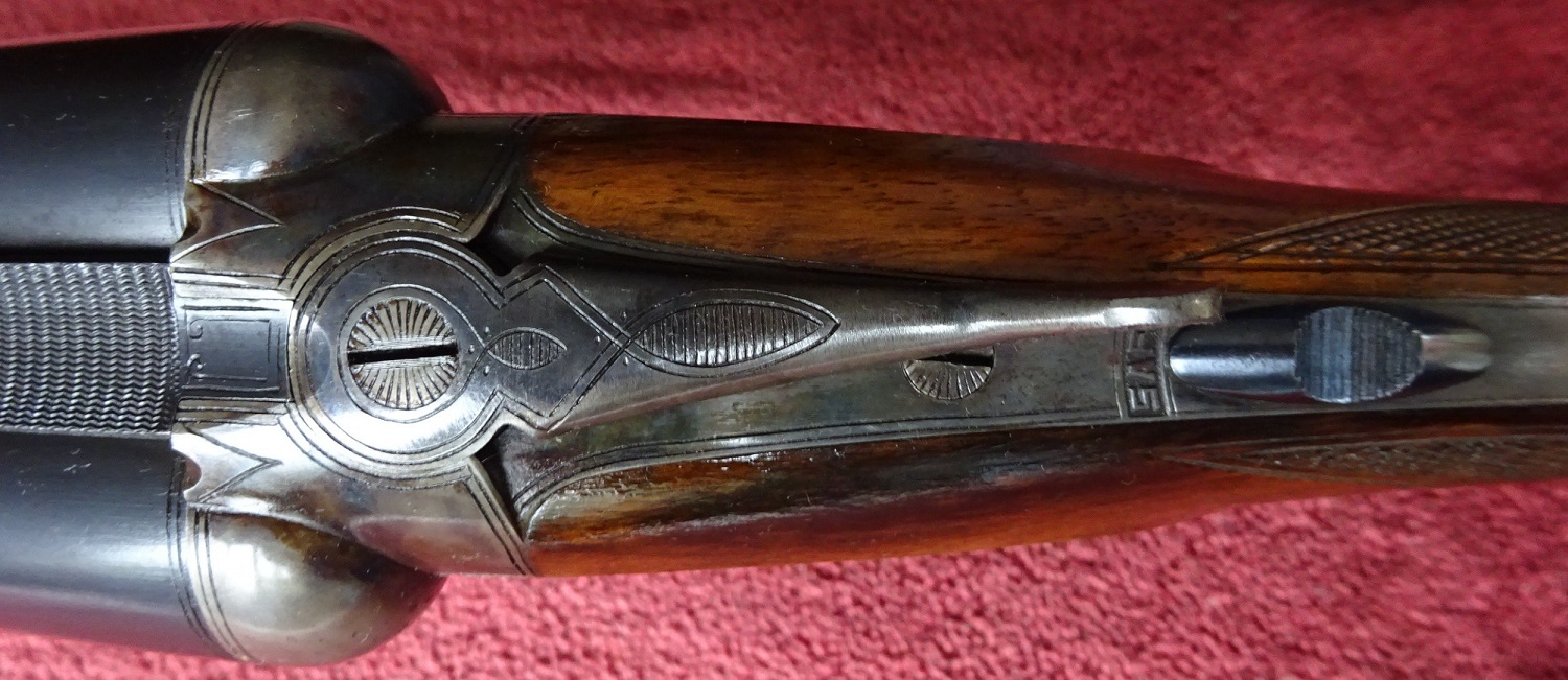

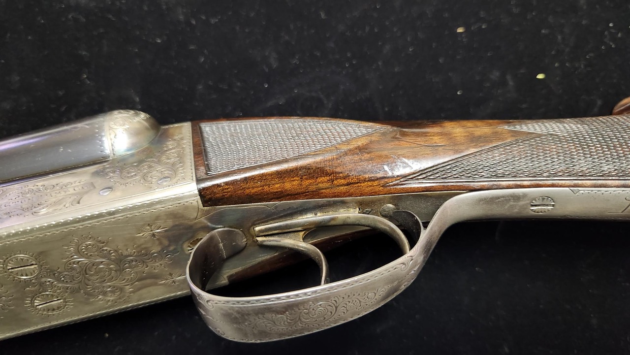

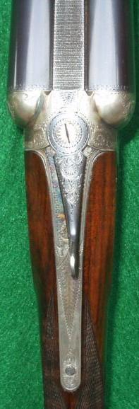

I take it you are referring to 139072 in the upcoming Guyette & Deeter Auction. I see the new style action and coming in in the high 131xxx serial number range with the highest serial number old style action I've recorded as 132225. That CEO 139072 is the only gun I've recorded with the new style action and a flat-matted rib. In Parker Bros. guns a high flat rib is considered a "Pigeon" rib. Same with several English makers. Here are a couple of pictures from last time I saw it for sale --
139072 CEO-Grade Pigeon Gun 02.jpg (30.99 KiB) Viewed 24497 times
139072 CEO-Grade Pigeon Gun 01.jpg (53.08 KiB) Viewed 24497 times

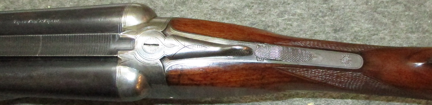

My modest collection has a mixture of concave (FE, CEO pigeon) Damascus flat rib (CE pigeon) and a flat rib on my BEO trap gun. The BEO has a dovetail milled forward of the receiver where I'm pretty sure a Marbles sight was added!

*I got photos from the auction for 139072 and noted the trigger guard has some dents and a nasty crack --bummer!
