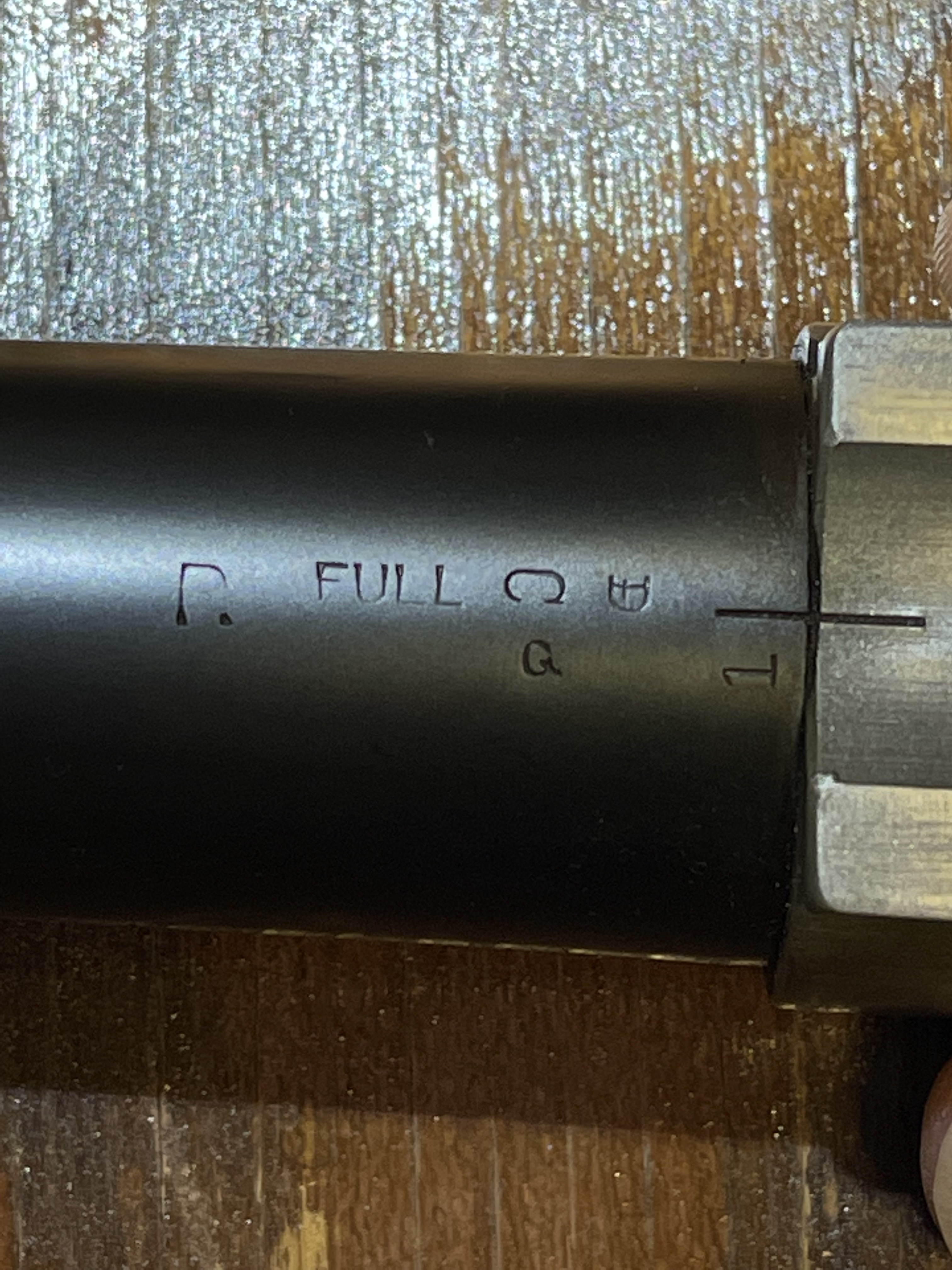

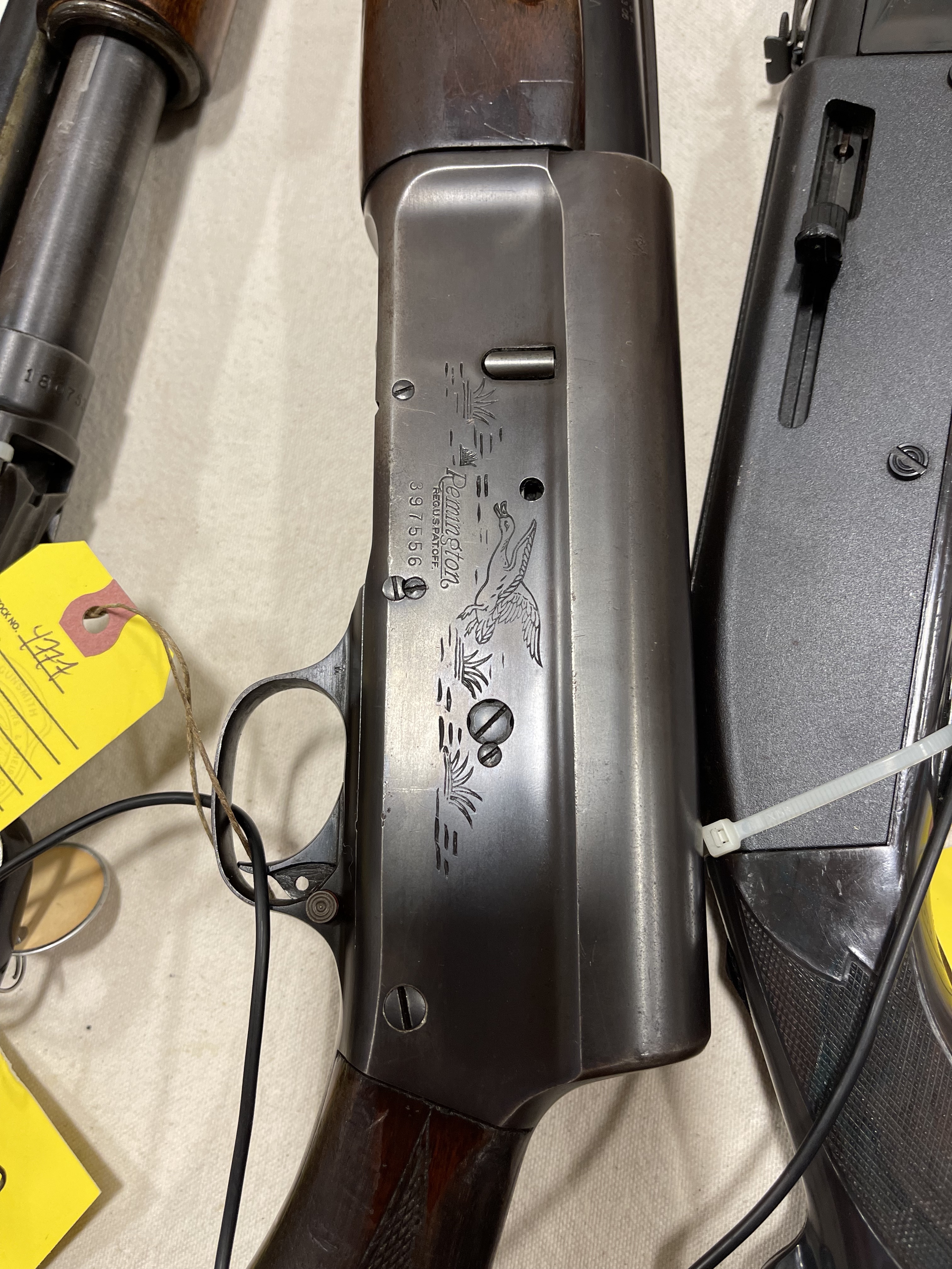

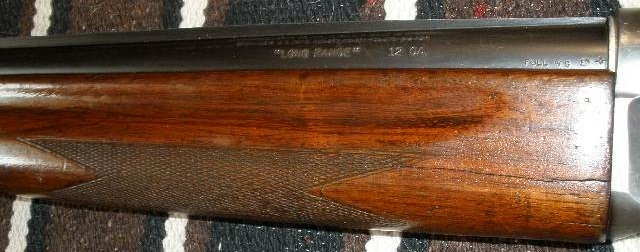

Here are a couple of photos of the "Sportsman" with a 32 inch barrel with a Vented Rib. The serial number is 397556.
I tried to identify the date code but I could not figure it out so I am posting a photo. Did Remington serialize the components like the Browning Auto 5, (ie.. receiver, barrel, and forearm/stock). Is the vent rib Long Range a fairly unique configuration?
- Sportsman Long Range Ser#.jpg (3.72 MiB) Viewed 6849 times
- Sportsman Long Range Date.jpg (1.99 MiB) Viewed 6849 times
- Sportsman Long Range.jpg (3.9 MiB) Viewed 6849 times
Re: Long Range Model 11 (2 shot?)
Forgot to add that the barrel has XP2 stamped on it as well.

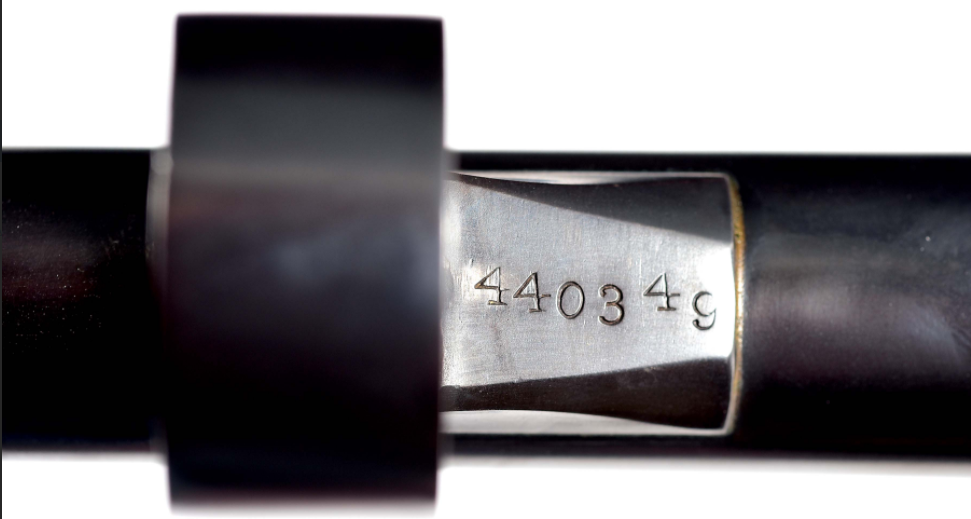

The receiver with the serial number 397556 was put in work during August 1937. Remington quit the separate serial number sequence for 12-gauge Sportsman on 24 August 1937, at 515506. So, that gun is among the first Sportsman serial numbered in the Model 11 sequence. The barrel should have the serial number on the base of the ring that goes around the magazine tube.
This is the only picture I have of a Sportsman with the "LONG RANGE" marking.

In the Blue Book there is a word of caution: "Beware of Fakes"
Without seeing the stamping it is hard to make an educated guess.
But if you notice by 1939 the catalog explicitly states 30" plain and Solid Rib barrels only on the 11 and Sportsman.
I have not seen a "Long Range" vent rib barrel that I would call "Legit" except in a 31 TC 30".
Good Luck and if you get pictures of the marking please post it.
Thanks, Will
