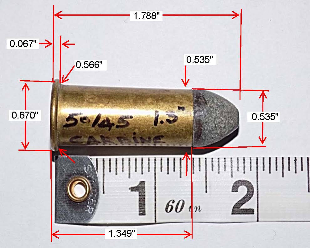

Here is a image of a 50-45 cartridge that I have take measurements from.

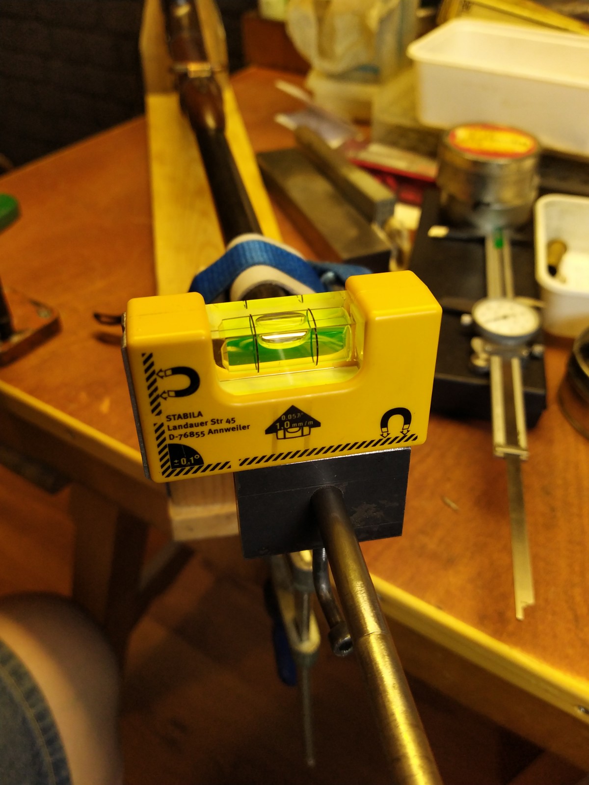

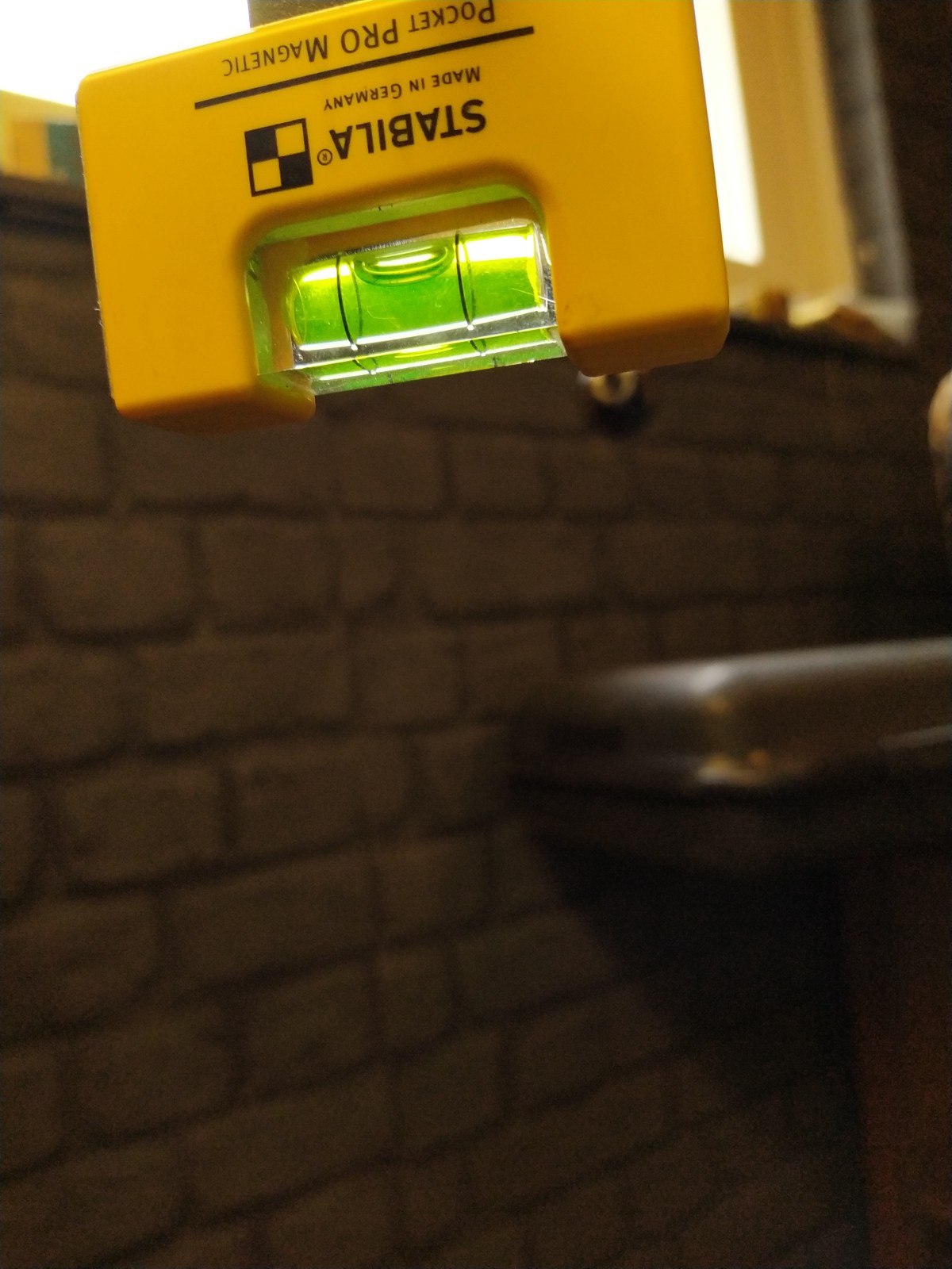

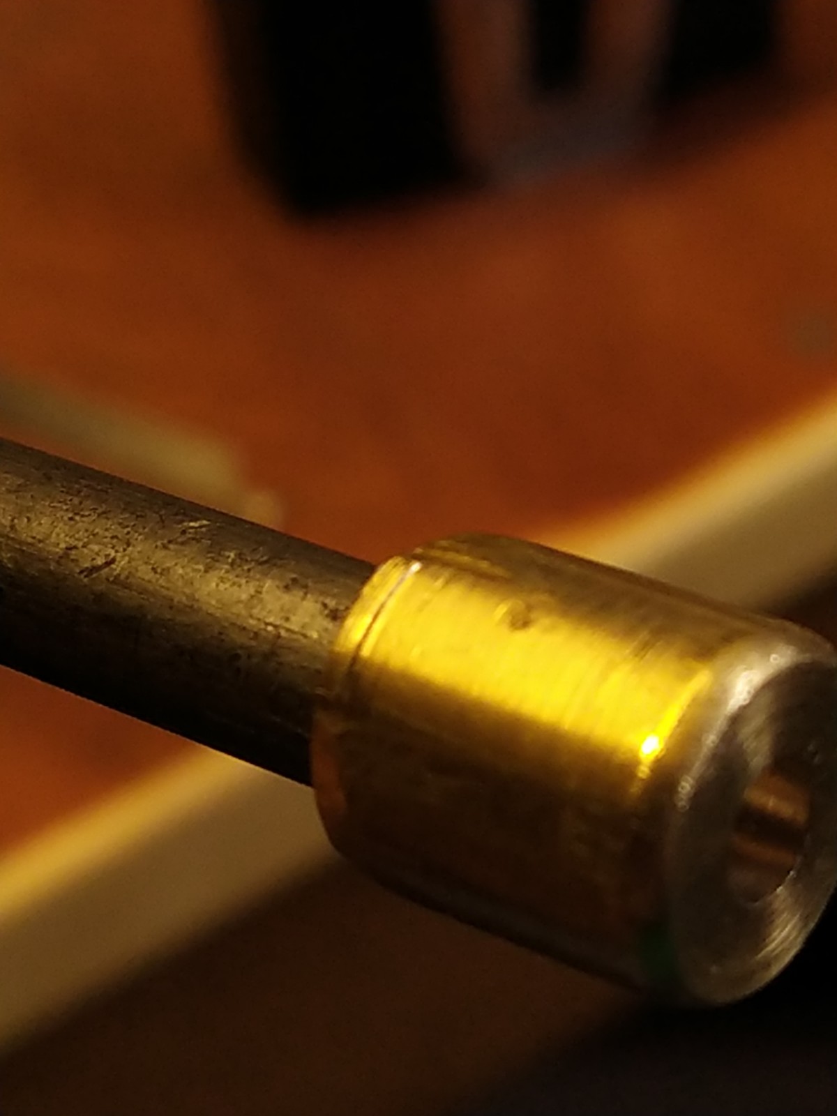

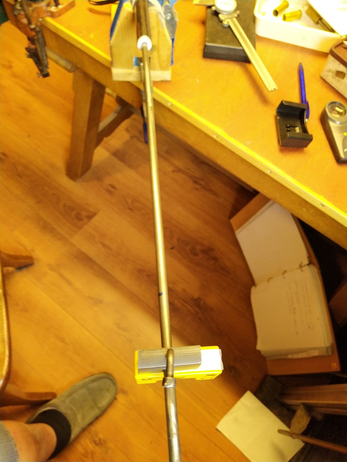

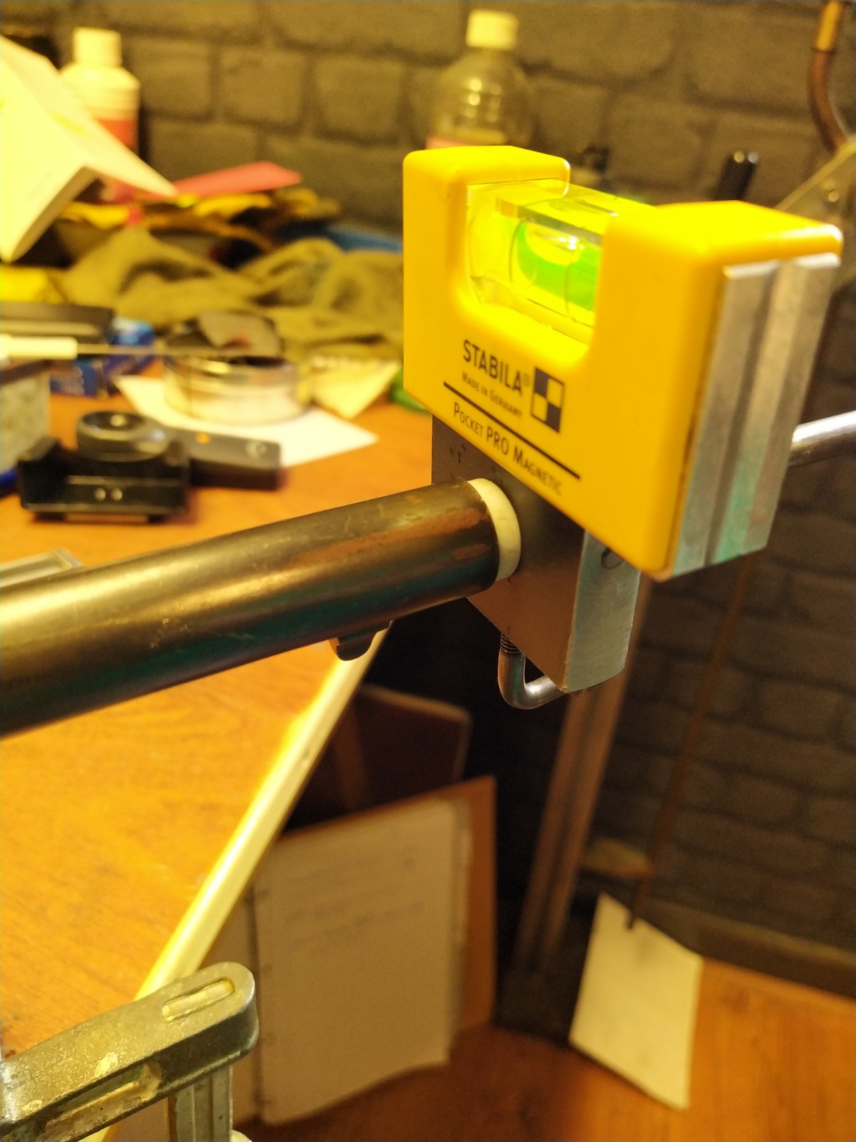

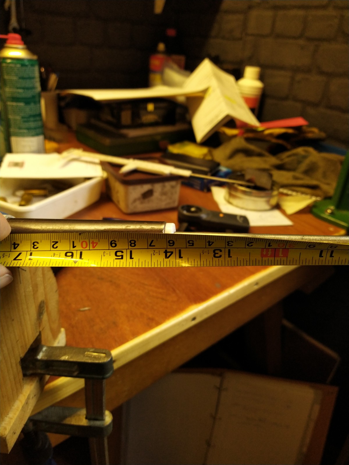

Attached some pictures of how I measured it, need a lathe and some mechanical skills however. Or a good friend having both.. I took a short piece of brass a little over .5" in dia and length and machined part with the diameter of the bore, in my case .50 and a short section: .025-.03 with the diameter of the grooves, in my case .516, both .001 smaller than the actual measured diameter and cut internal thread fitting on the cleaning rod. I marked a section a little smaller than the width of the grooves on the bigger diameter and removed the remainder. This small tab just fits in one of the grooves. I drilled and reamed an 8mmm hole (dia of cleaning rod) and drilled and tapped a M5 threadhole in the hole in a small steel block for a locking screw. First on the cleaning rod is the metal block, then the brass plug.
I inserted the cleaning rod with the brass jag attached in the bore until it ended up in the chamber and pulled it back till the tab just grabbed one of the grooves. I moved the block forward to the plastic muzzle protector and put a small magnetic level on it setting the level in the middle and locking it with the M5 screw. Next thing is retracting the cleaning rod till the level is at the underside with the level again centered. Make sure the small tab is against the same land as when it was set when starting to pull it outward. The distance between the block and plastic muzzle protector is half the twist, in my case it was 14 1/4" as you can see on picture 6, this makes it a twist of 1-28.5
The 1-30 is close enough with marked cleaning rod method.
Thanks for taking the effort!
Jan-Willem
Jan-Willem
