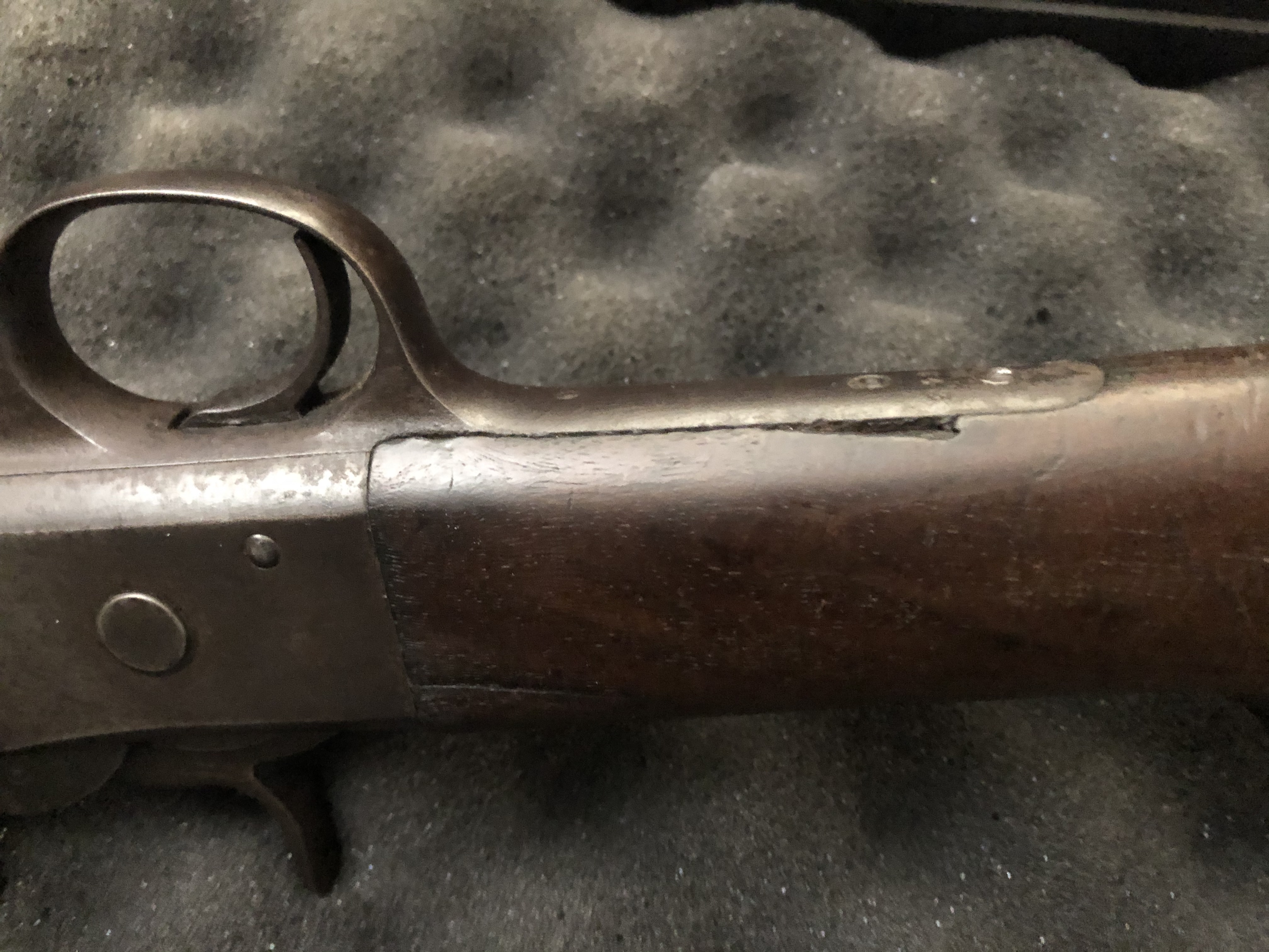

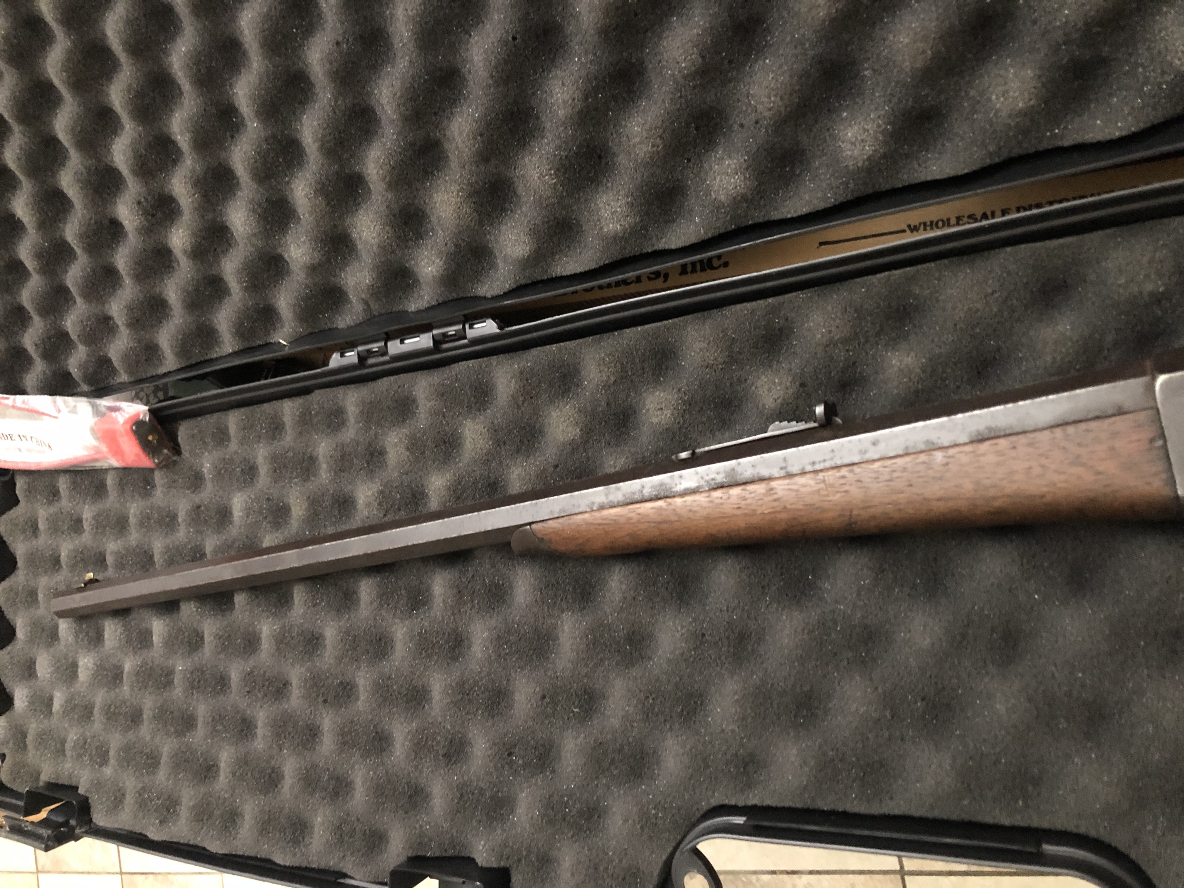

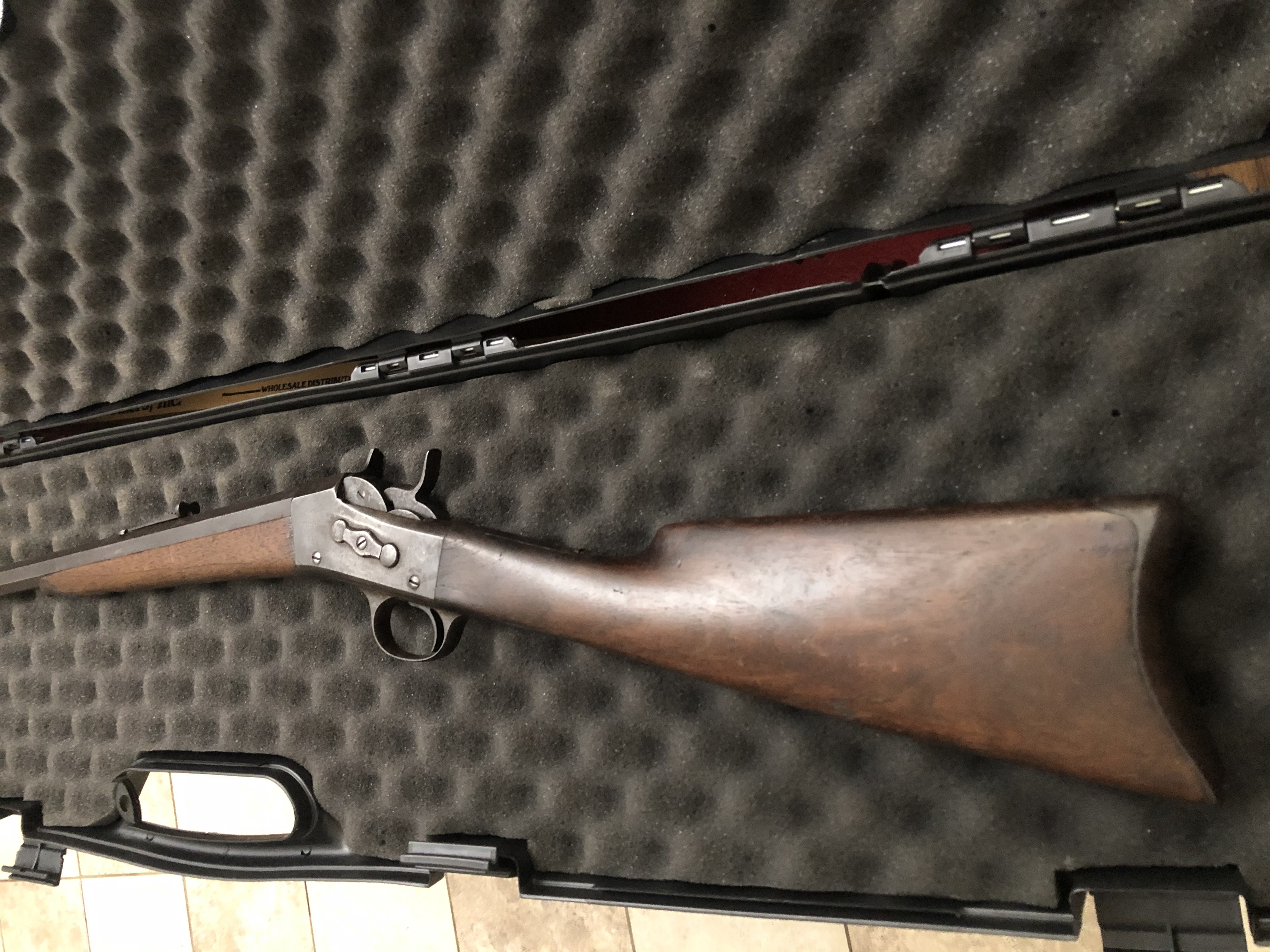

Is this a 1 1/2 Rolling Block? The receiver is about 1.14 inches thick.
I believe this to be a 1 1/2 Rolling Block. The receiver is about 1.14 inch thick. I was wondering if you can tell when it was made and how many were made. I read that they were rare.

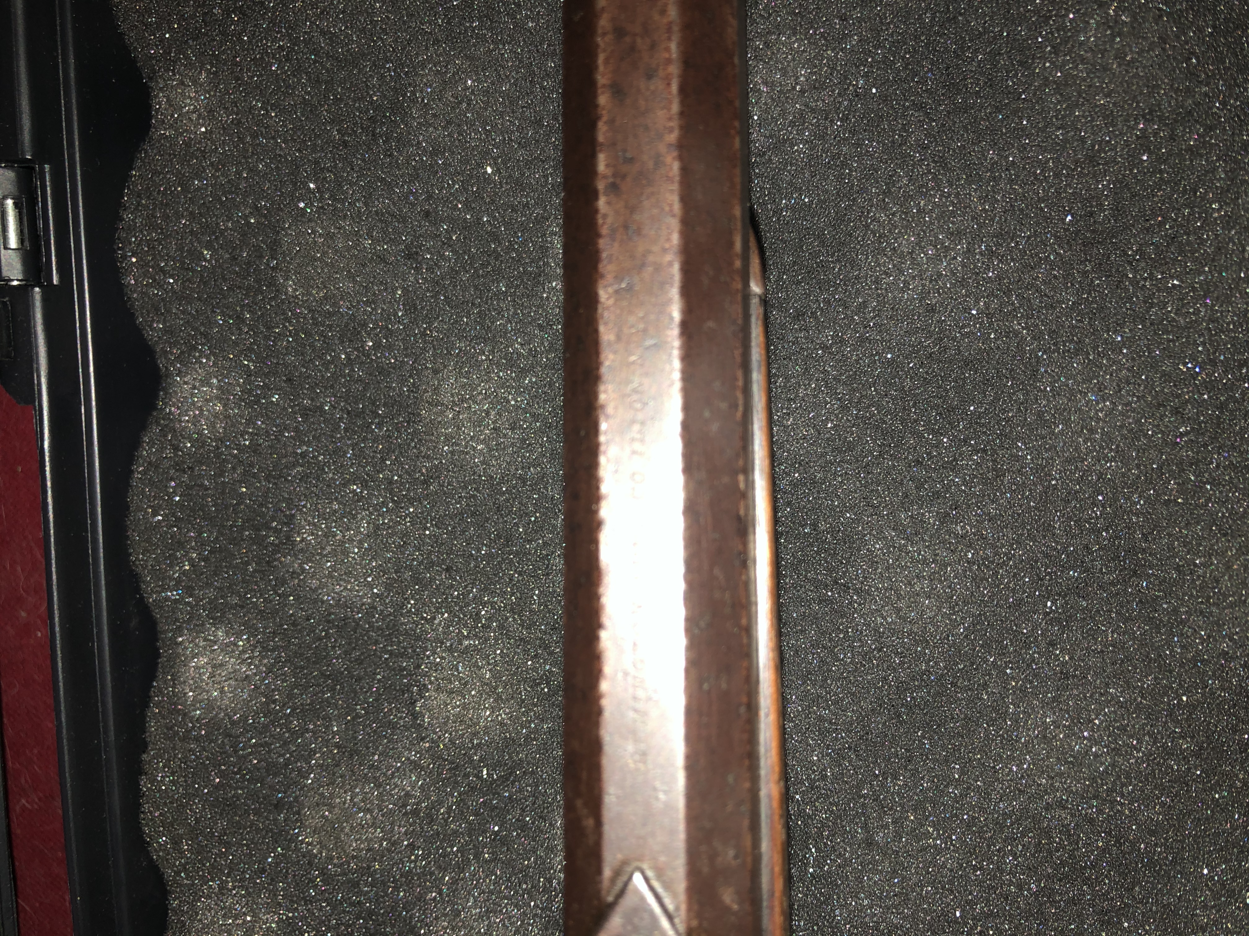

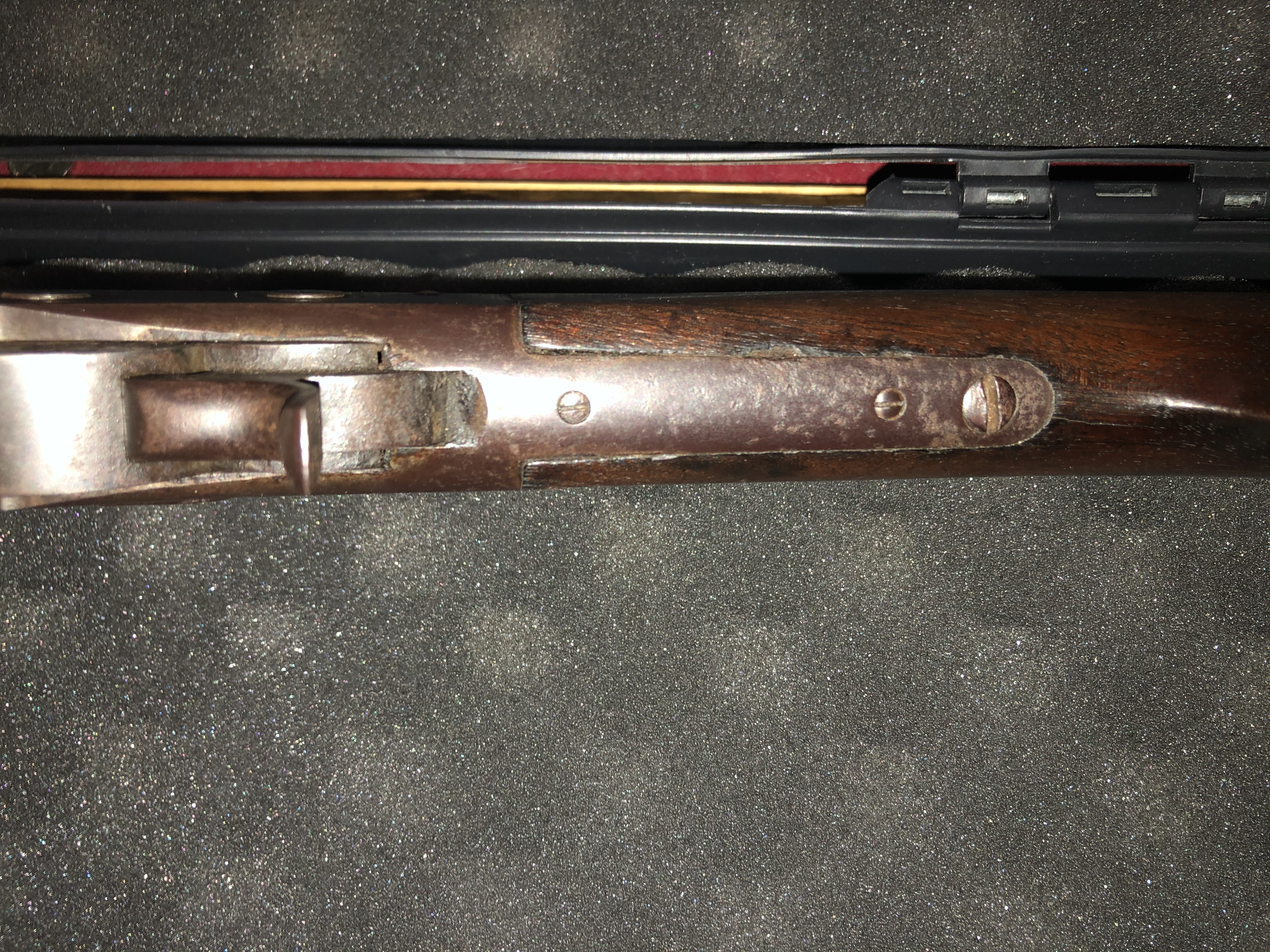

Yes, it's a #1 1/2, and an early one too! Later didn't have the neat steel forearm tip. Yours is likely an "E. Remington & Sons" rollstamped barrel.
All Remington Sporting Rifles are rare, with very small numbers in each frame size. The #1 1/2 came out around 1884, and production ended in 1897. The total made is unknown, but the highest number known is under #4400, and it's guesstimated maybe 4700 were made. After 1886 production ceased, and restarted in 1889 with the new "Remington Arms Co." rollstamp. So yours is either 1884-1886, or 1889-1897. And the steel tip tells me it's the earlier most likely.
