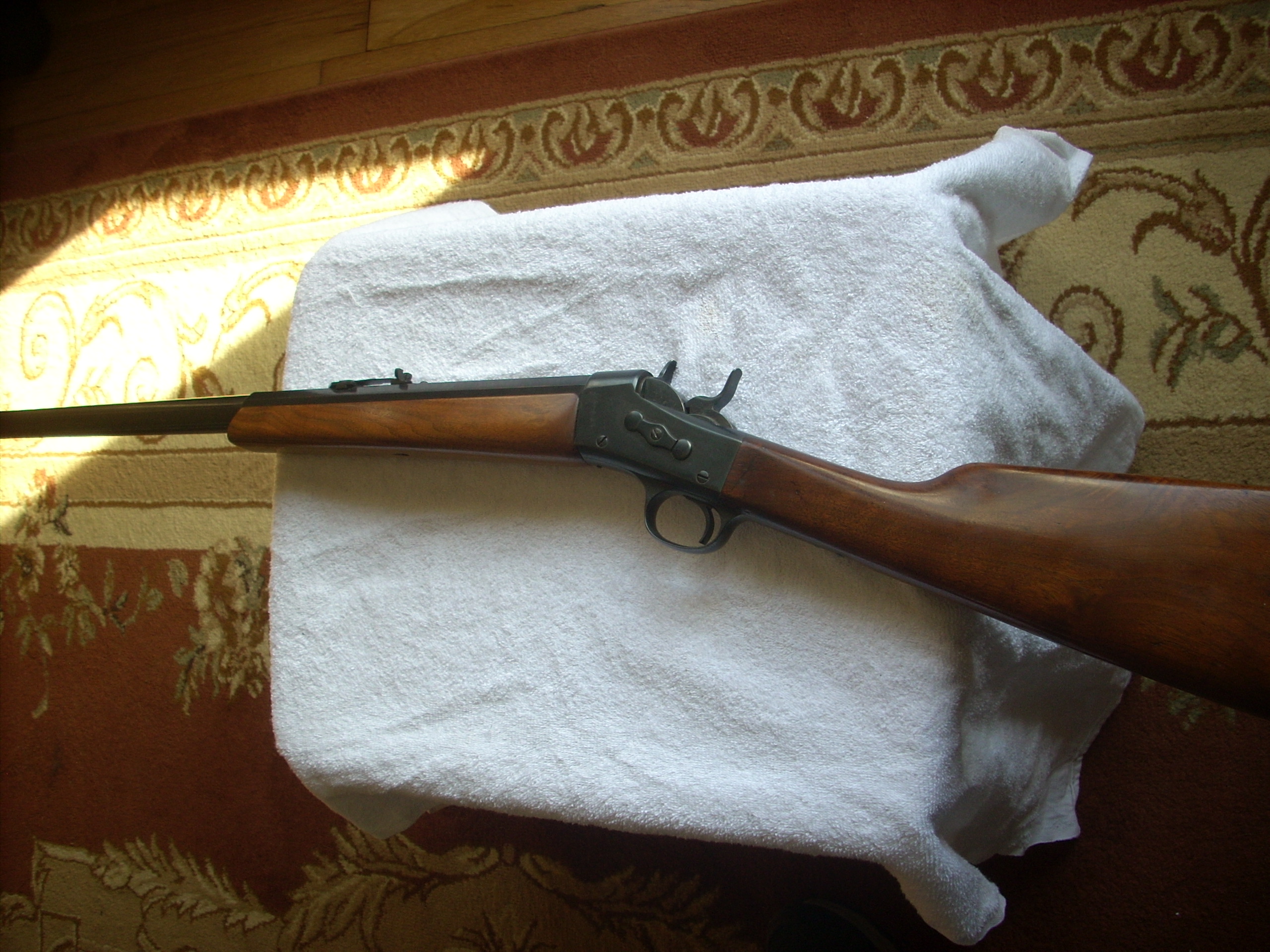

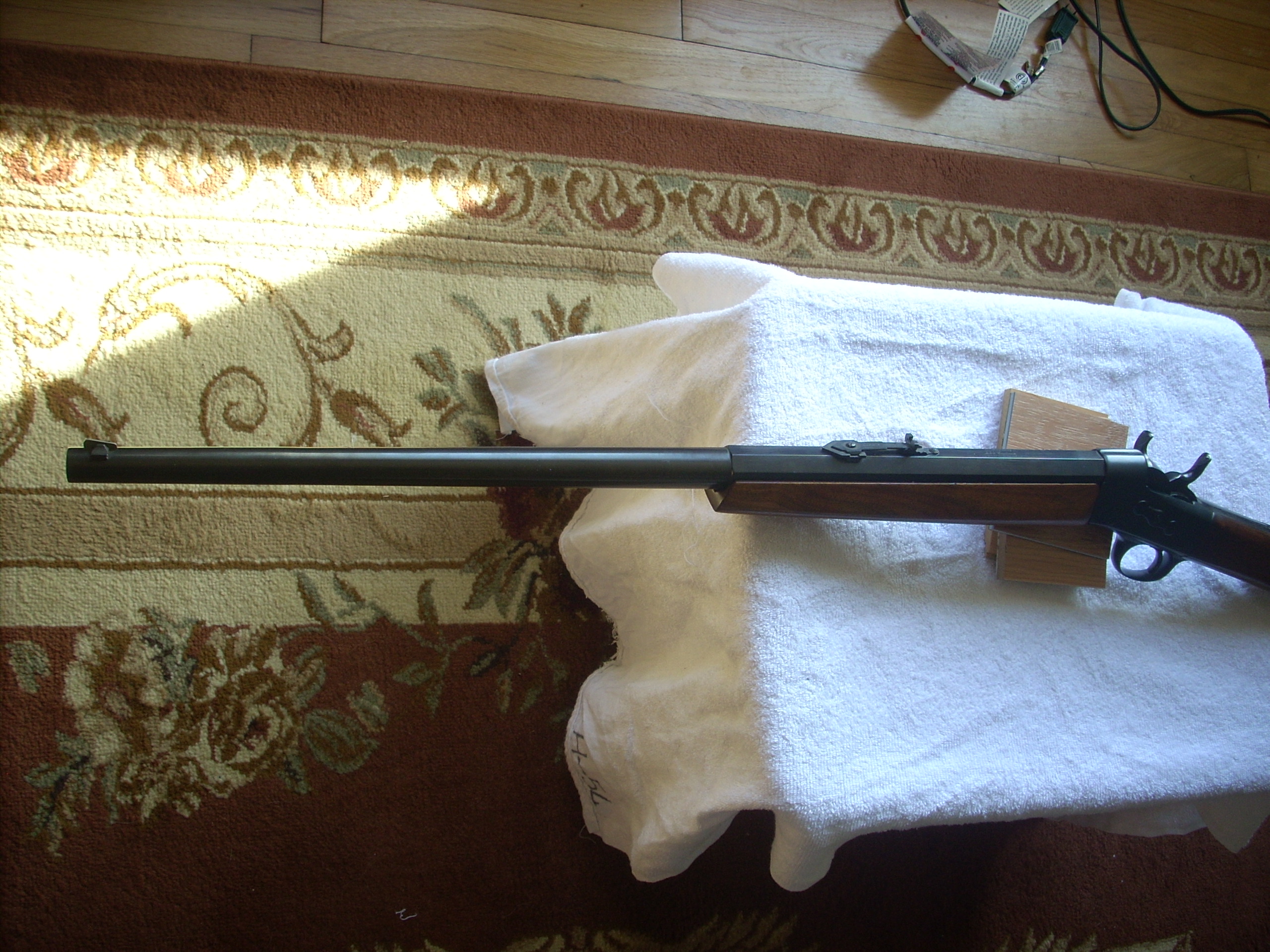

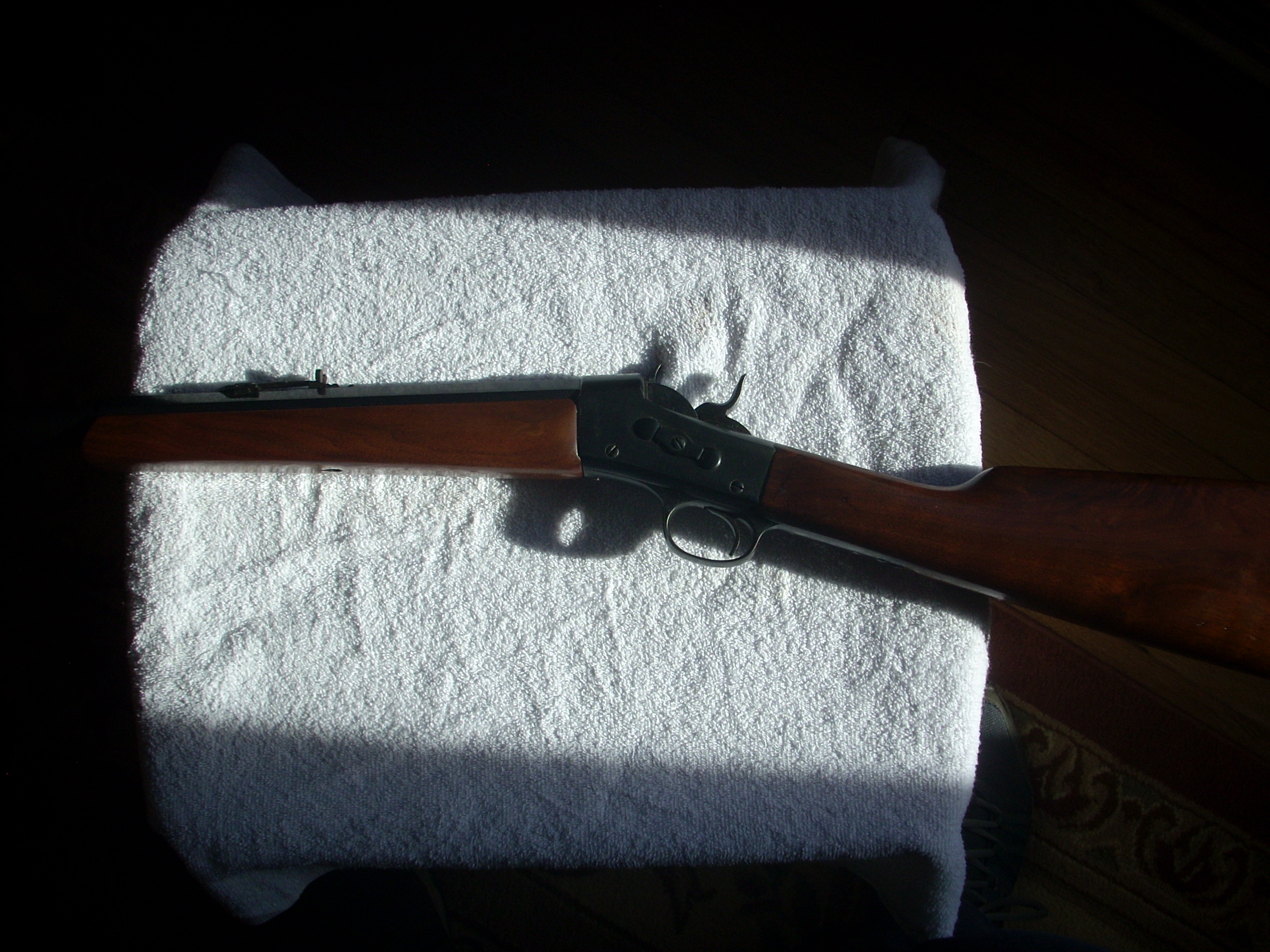

Hello Everyone,

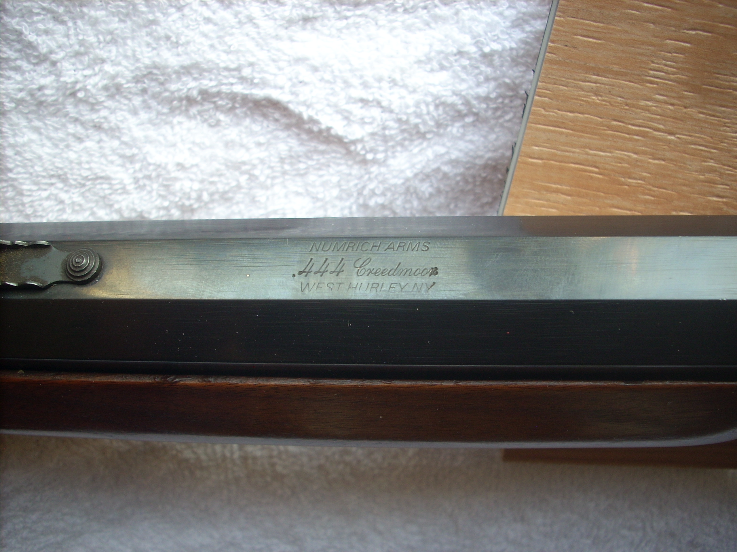

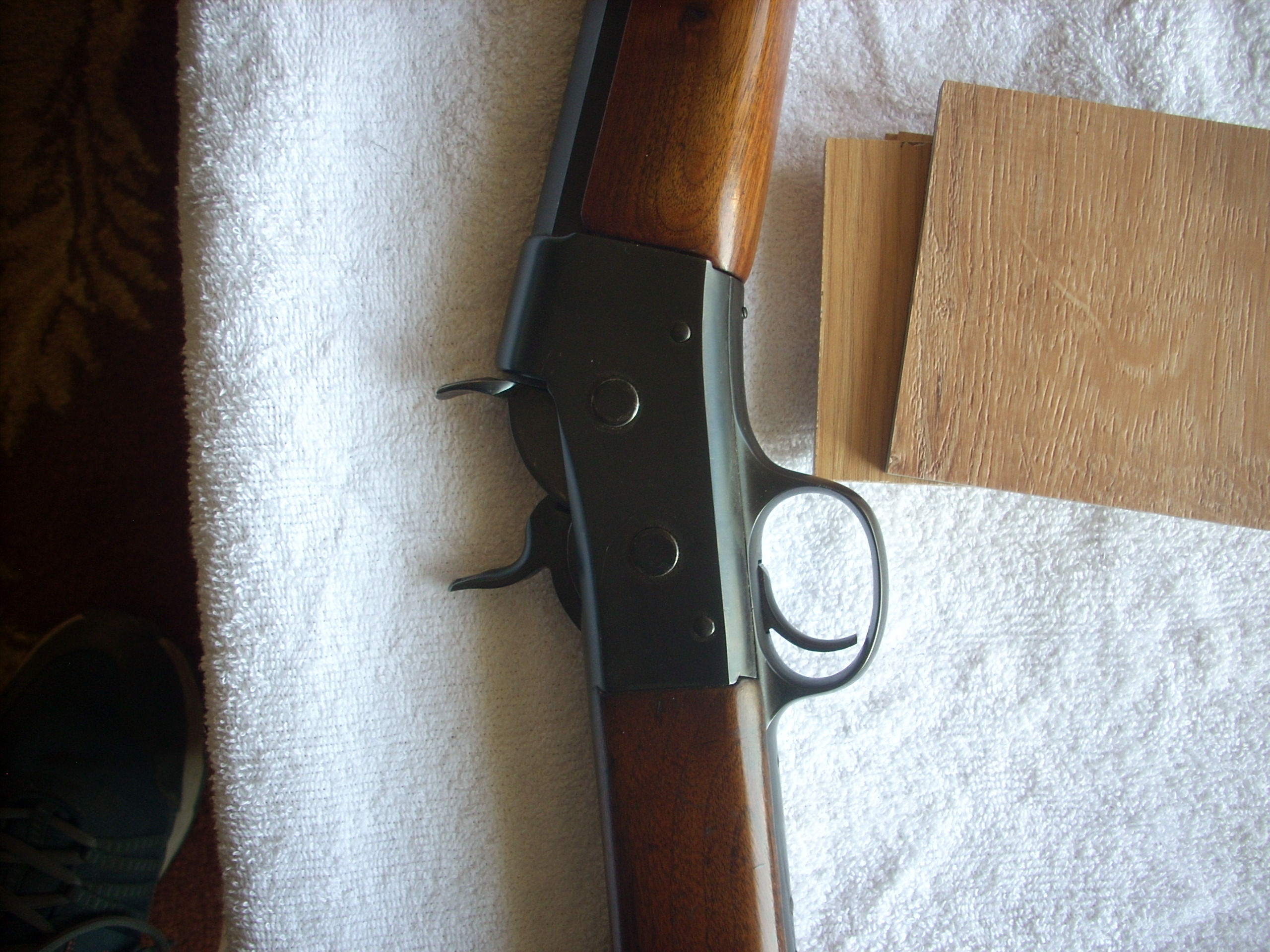

My Father In Law passed a couple years back and he had a couple old guns left to us, one of which I know nothing of and the one I'm writing about here.
I'm 60 myself and have a couple older guns, a Garand, a couple Mausers some shot guns but I actually never had one of these. I know it's a rolling block, "thats it".
I showed it to a friend of mine who said the barrel has been changed, I have no idea about the original or where it is. We did shoot it once! and I believe I know why he never shot it much, (that I know of). The extractor appears to have a very small piece broke off of it and it doesn't pull the cartridge out. It does fire fine though.
The gun is in remarkably good shape, wood and bluing. As far as I know it's not been touched in the 35 years I knew of it, it always sat in his gun cabinet.
I would appreciate any advice, thoughts, and expertises on this gun. I'll post the pics as I have. If anyone wants more, I'll do my best.
Thank's in Advance! Dave. :)

What you have is a military Rolling Block #1 size action that's been fitted with a Numrich .444 Marlin barrel. I don't see any retaining screw for a sliding extractor, so it's likely a later rotary extractor, which may indicate it's also late enough to be a smokeless action also.
Numrich sold those barrels as a kit, and I believe they also did some of the builds themselves also. The .444 Marlin is a stout cartridge in factory loads, but for those who reload it can be loaded lighter to be a very nice caliber to shoot.
Kenn Womack sells Rolling Block parts, if you need an extractor. But it might be better to take it to a good gunsmith and have the existing extractor built up via tig weld, and then filed down to fit the rim. That's what I'd do if it was mine.

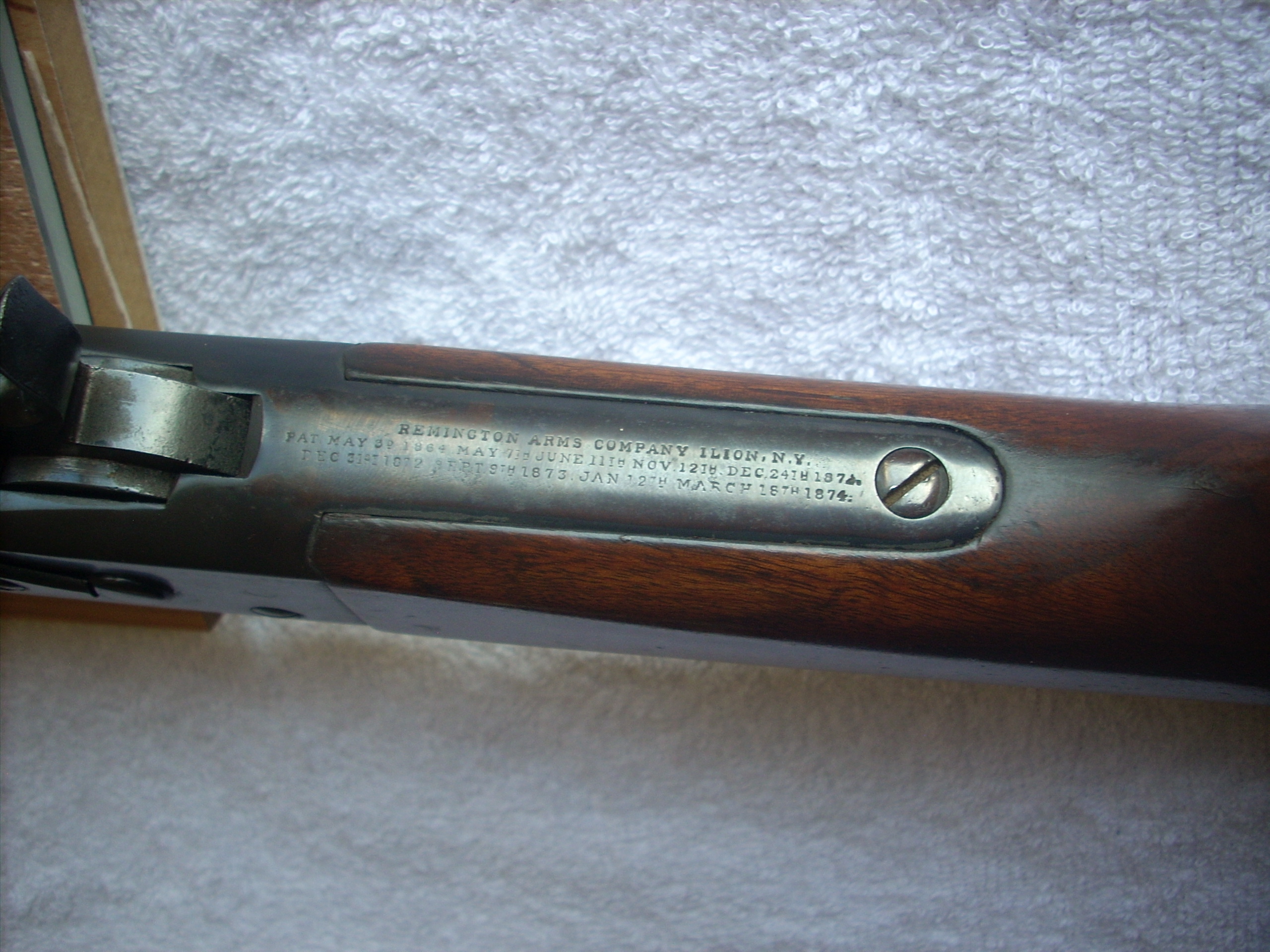

Hi There,
Most of what marlinman93 said is true except that
this is a #1, type 4 action. These are black powder
actions. The tang markings start with "Remington
Arms Company ..." which indicate that it was man-
ufactured on or after 1888 (Remington filed for
bankruptcy in 1886, went into receivership and then
was sold in 1888; that is when the tang markings
changed).
Because it is a black powder action, I would NOT use
high pressure rounds.
Good Luck!
Webb

Posts: 492
Re: Some guidance, help and info Please.
Post by marlinman93 »
Webb is correct. The factory loads in .444 Marlin can be 40,000 cup, which is a good 10,000 cup or more over what that action is good for. That's why I mentioned it might be better to hand load for it to ensure it's loaded down to milder levels.
The vast majority of factory ammo is well over 2000 fps, and likely in the 40,000 cup levels. I'd want to limit loads to under 1500 fps, and pressures to 25,000 cup.

It appears he kept the military buttstock, and only replaced the forearm. Any signs on the end of the forearm of a plug that would indicate it too is a military forearm cut down, plugged, and reshaped?

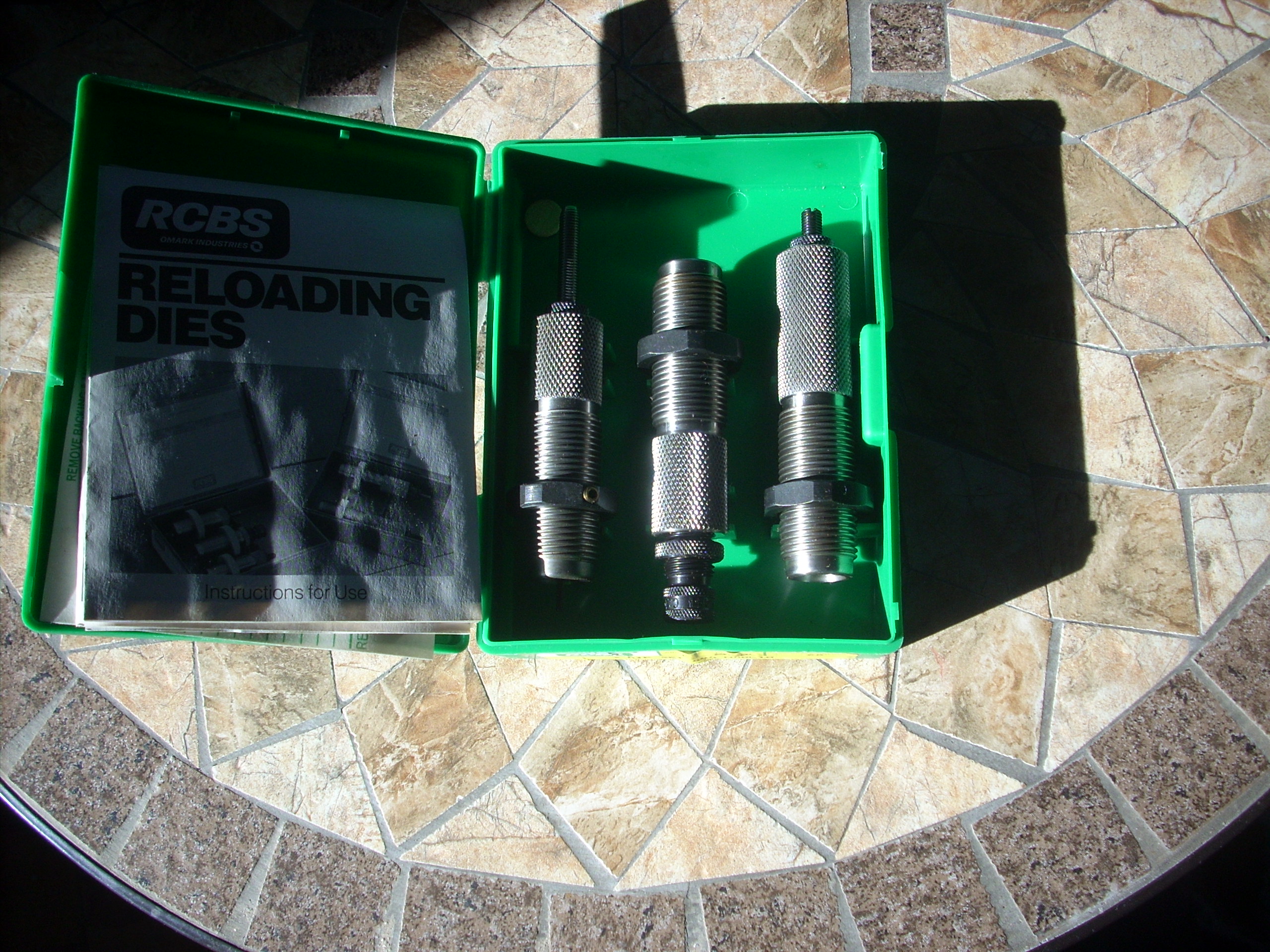

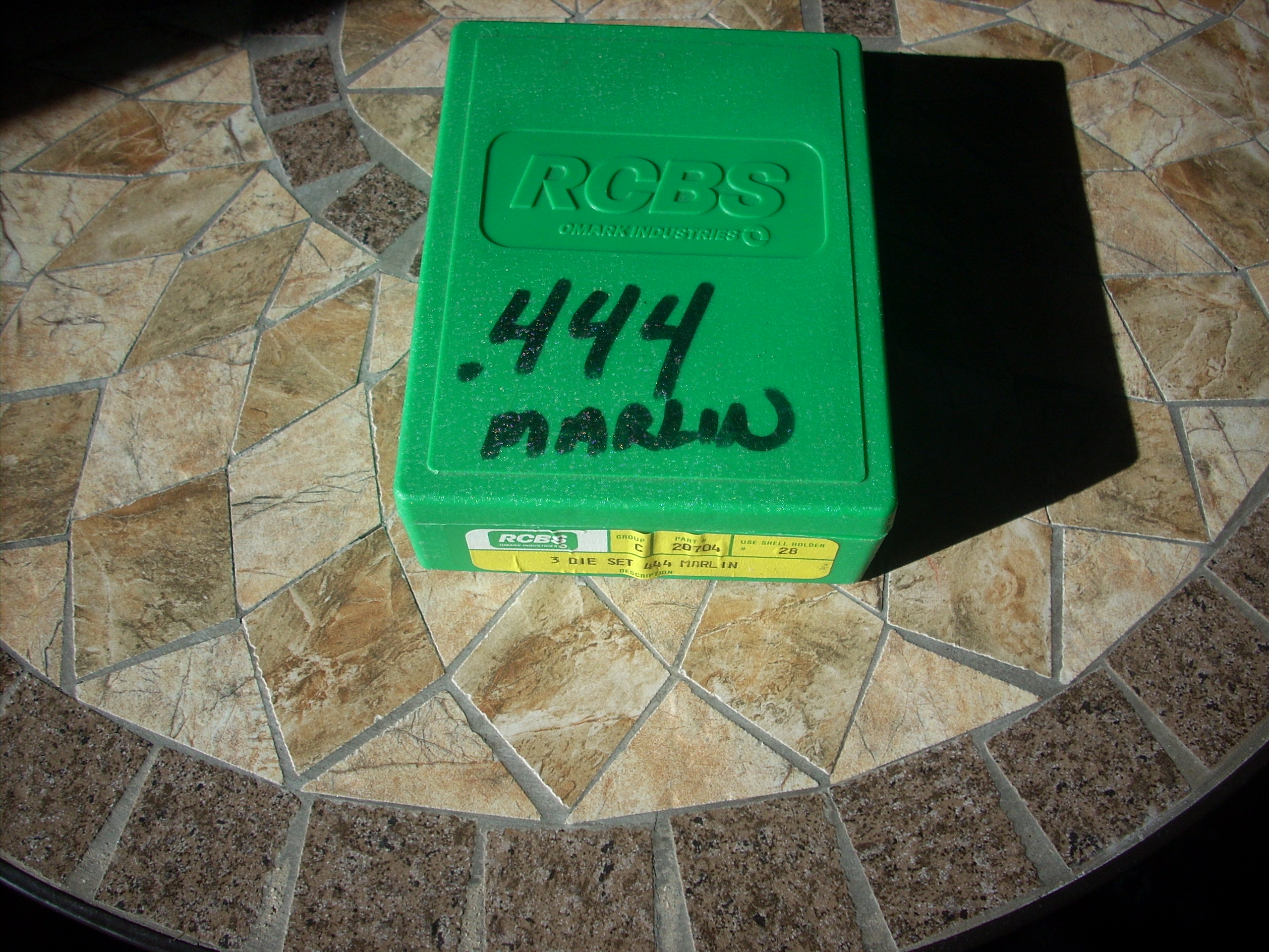

What are the Odds? Something told me to go through a box of stuff we took out of his shop so I started digging, (I'm sure you understand we have 70+ years of someones life) and haven't gone through everything yet. My wife and I packed things up along with family members so there was no rhyme or reason how things got packed. Boxes just labeled shop or garage etc. Well, ironically this was in one of the shop boxes! Don't look like they were ever used. He wrote BIG letters on them so he could see what he was grabbing.
Oh boy do I know the feeling... :lol: Well, I guess I'm all set. There was also a set of 7mm mag and 30-06 in there as well, so now I have 2 sets. :D I don't own a 7mm.

Well that's a great find! And I guess it certainly makes reloading for the .444 a easy decision now!
You'll love shooting it in the Rolling Block with milder loads. I have a gunsmith friend who built the same rifle, and he put a scope on his because his eyesight isn't great. We shot it at his backyard range of 250 yds. and never had a miss on his 10" round dinger. It was a hoot to have a gun be so accurate at the distance.

Yes, it was a "lucky" find! I knew he had some reloading stuff but it didn't dawn on me about the .444 This box of dies is marked, (Omark) Industries. These go back a few years!!! I don't think Omark was with RCBS since the 80's. I have his other RCBS reloader but it's in a box as well, I believe it's a Rock Chucker also.
Posts: 492
Omark bought RCBS in 1976, and then in 1985 Omark became Blount industries.
