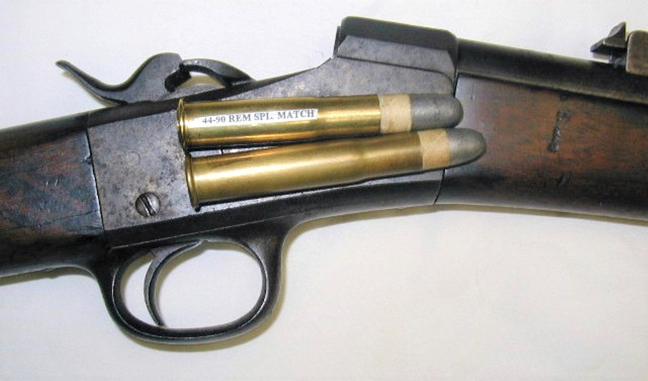

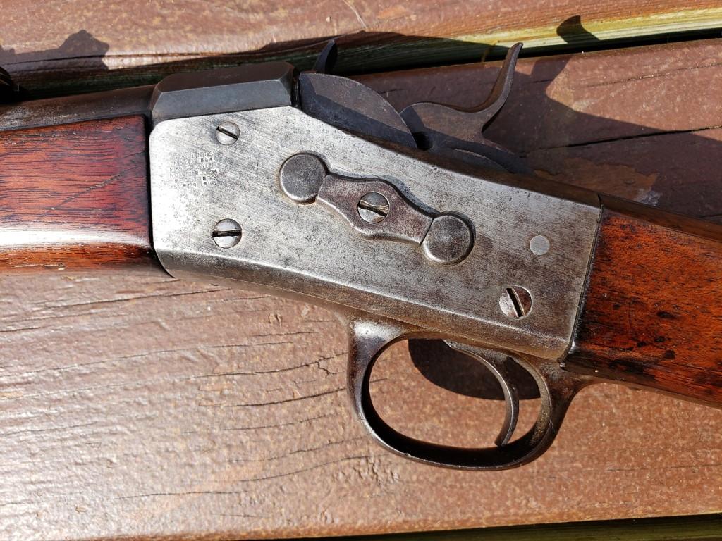

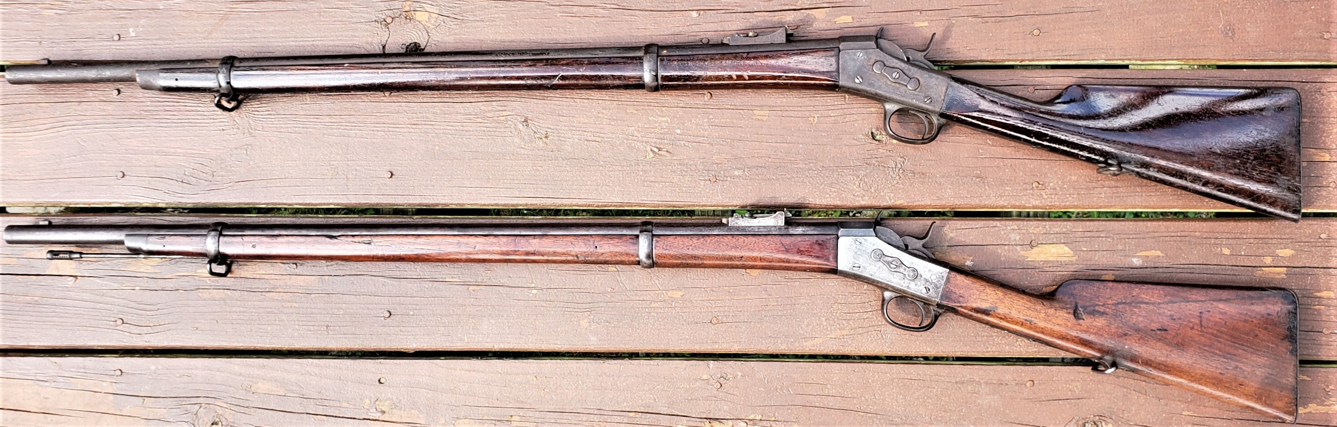

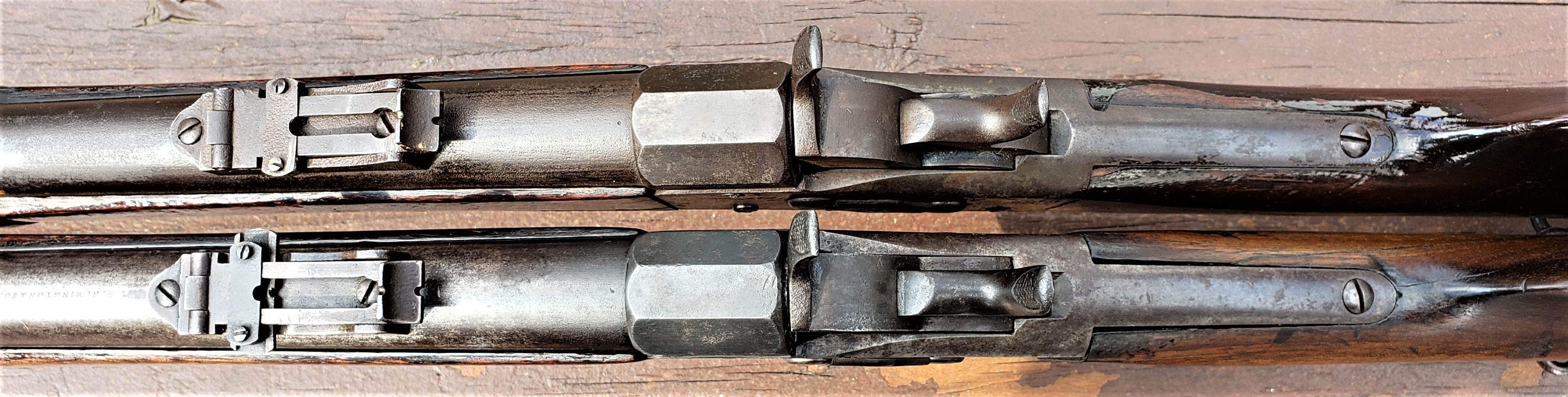

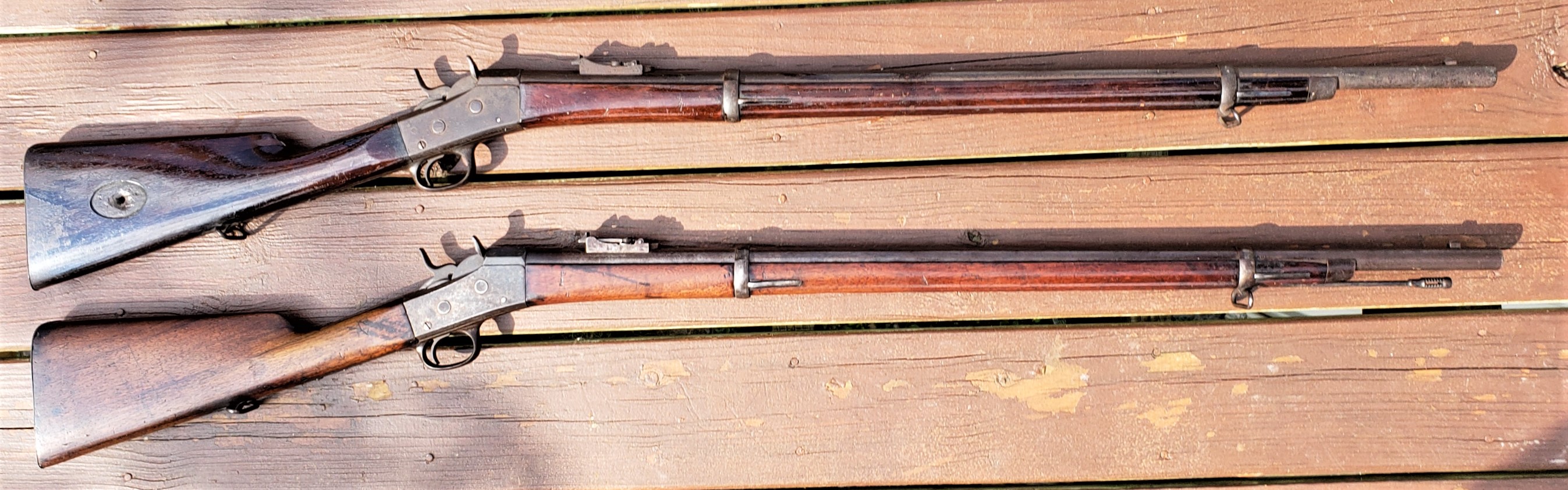

Here are some photos of two Special Military sporting rifles that I have in my collection. Instead of being chambered in 44-90 Remington they are chambered in Sharp's .44-90 (2-5/8") cartridge.
photo 1.jpg (650.79 KiB) Viewed 5306 times
photo 2.jpg (713.79 KiB) Viewed 5306 times
photo 3.jpg (288.82 KiB) Viewed 5306 times
photo 4.jpg (673.52 KiB) Viewed 5306 times
photo 5.jpg (912.13 KiB) Viewed 5306 times
photo 6a.jpg (156.19 KiB) Viewed 5306 times
Bottom cartridge is the Sharp’s .44-90
