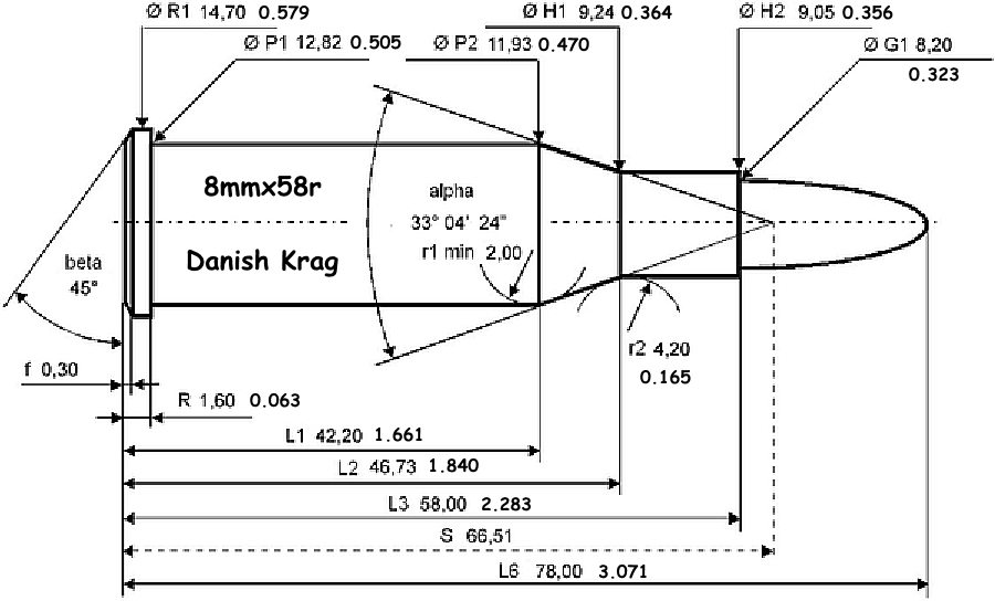

I am assuming this Rifle was made to shoot the cartridge shown below:
I added the English numbers next to the Metric mm dimensions...
However, if the 53.5mm reforms 'work', am I being too anal about all this ?

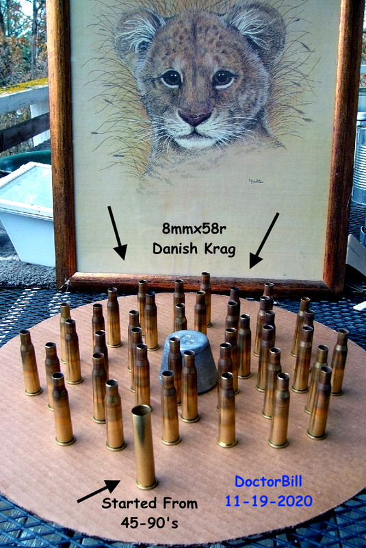

I have been on a "Learning Curve" reforming Brass for this rifle.
Here is what I do....
.................Reforming 45-90 to 8mmx58r Danish Krag...................
This requires infinite PATIENCE......
Cut a 45-90 Brass Case to ~57.5mm on the Lathe. File flat and debur the EDGE on the lathe.
Debur with a Case reamer. Rub smooth with Steel wool.
Anneal (in the Rotating Water Bath if you have one) down about 5mm.
GO VERY VERY SLOWLY ! I use IMPERIAL SIZING DIE WAX ! Cannot be done w/o a GOOD die Lube ! Lube inside the top with a waxed Q-Tip.
Set the (LEE) 8mm Lebel Die high in the press so that the handle engages almost
straight out (important for feeling progress !). Have the Center Decapper Rod in place !
Very, Very slowly reform with the Case by starting the curve. Go maybe 4mm/min slow !
Anneal again and repeat until reaching the neck. Anneal again a few mm's lower (take 5 ml
water out of the Water Bath). Proceed lower with the die constantly watching for a crimp in the case. Lube and push thru the 45-70 Die OFTEN to keep the diameter. Use 45-70 Die to straighten crimps if they start ! Anneal lower and continue by lowering the Lebel Die ONE HALF turn at a time ! (Critical !)
Push the lever down so the piston goes up 0.5mm (yes !) at a time checking for crimping.
...........TAKES A LOT OF TIME - but it is worth it !
Once the shoulder is to the proper level (42mm) – run thru the 45-70 Die and anneal entire Case in ½ inch water bath.
Run it in a 7.62x54 Russian down to about 1 cm from the rim - to reduce Shoulder Diameter.
The latter is critical to the case fitting the chamber ! Check the fit in the 8mmx58r Swedish Rolling Block.
Expect Failures from case crimping. Starline is Thin Brass !
IF you go very slowly and run it thru the 45-70 die if a crimp starts to form – you
can get 100% from the above method. I DO NOW !
Here is what you will get as you progress:
Beware crumpling - use the 45-70 Die to reshape it out ! Too much crumple and it is all over !

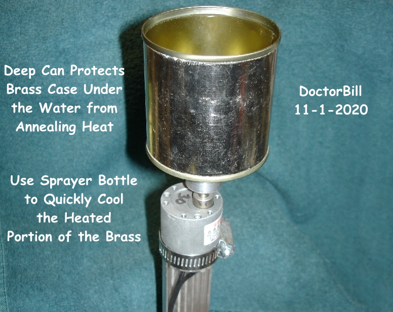

Here is the rotating water bath I made for annealing. You can get the low rpm 12v motors
from e-bay and run them with 12v plugin adapters for electronic stuff (phones, chargers, etc).
I made a SPINDLE of Aluminum and Glued a round magnet to one end to hold the cans.
Made Various cans to set water depth to protect the Brass below the water line.
Here is one of several variations..... I do a LOT of this reforming.
This is just FYI - to help newbies at this reforming Brass thing. Hope it helps someone !
DoctorBill

I have gone thru a bag of 50 Starline 45-90 Brass and am done.
Here is the result.....whew !
The Baby Tiger (?) picture was there just to cover the stuff on the table
behind it....cute little bugger ! That thing in the center is LEAD cast into a SS Nut Cup
used as a mold. Makes Nice Ingots that stack side by side (one up/one down)
and are useful as weights for gluing or wood working, etc. I made a "Pb" Stamp
from a Bolt to indicate LEAD. Wheel Weight Lead is too hard to use a large stamp !
I now have about 75 assorted 8mmx58r Brass - mostly from 45-90's, but about 10
from 45-70 making for a shorter neck. They shoot fine, however !
The "process" became routine for me after about ten done. I have NOT caused
any case crimping or collapsing anymore. The first 4-5 case I screwed up were
due to me going way too fast - and not annealing enough.
But now I am done. Will never have to do this again ! HA !
DoctorBill

Well, you may be alright. Judging by your drawing of cartridge dimensions,
the bullet is .323" in diameter and the mouth of the neck is .356". This would
imply that the thickness of the brass at the neck of the cartridge would be
.0165" (which is close to your .018").
If it were me, I would make a chamber cast and measure the neck diameter
of the chamber. That way I would know for sure what the clearance was and
whether there was any possible trouble.
Good Luck!
Webb
