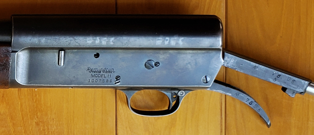

Model 11 ? why no roll markings what era
dhenzler
Posts: 141
Post by dhenzler »
Would any stock for 20ga model 11 work on this one ?
When was this made?
Re: Model 11 ? why no roll markings what era

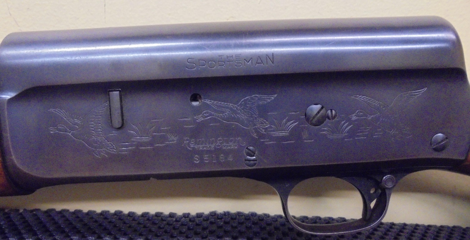

That 20-gauge Model 11 receiver with serial number 1007586 was put in work between May 3 and June 14, 1930. The Model 11A "Standard" Grade, Model 11B "Special" Grade and Model 11C "Trap" Grades had a plain receiver from their introduction until about 1937. The "Sportsman" the three-shot version of the Model 11, introduced in 1930 in 20-gauge and 1931 in 16- and 12-gauges started life with a three-bird roll stamping on their receivers --
S5164 Sportsman 20-gauge.JPG (378.46 KiB) Viewed 2905 times
