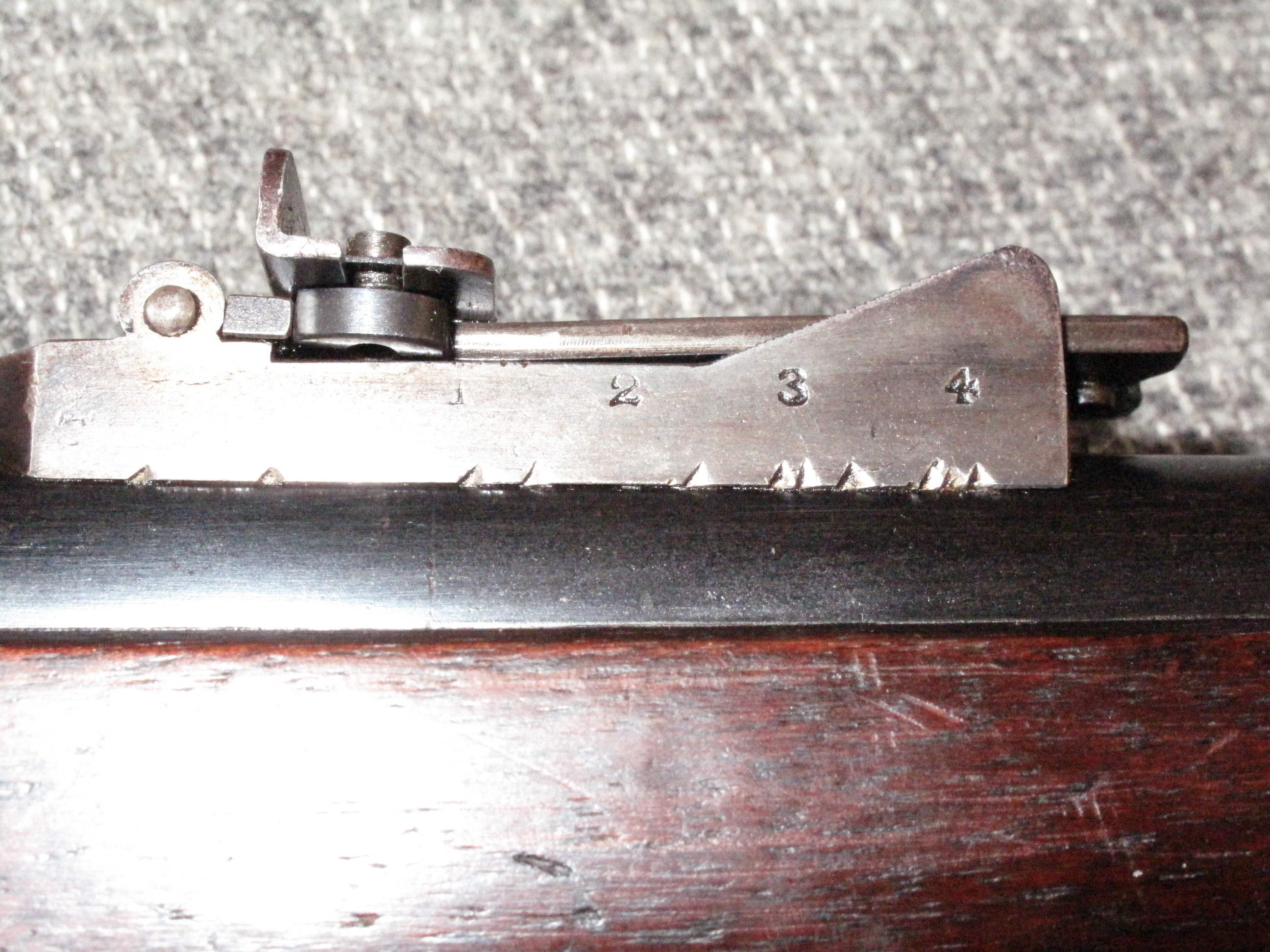

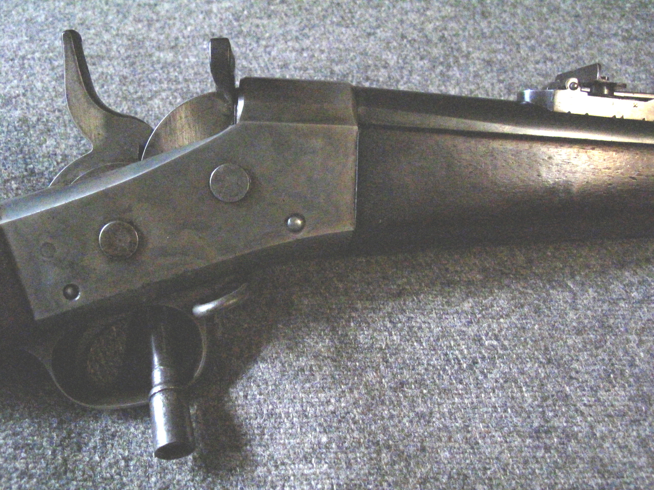

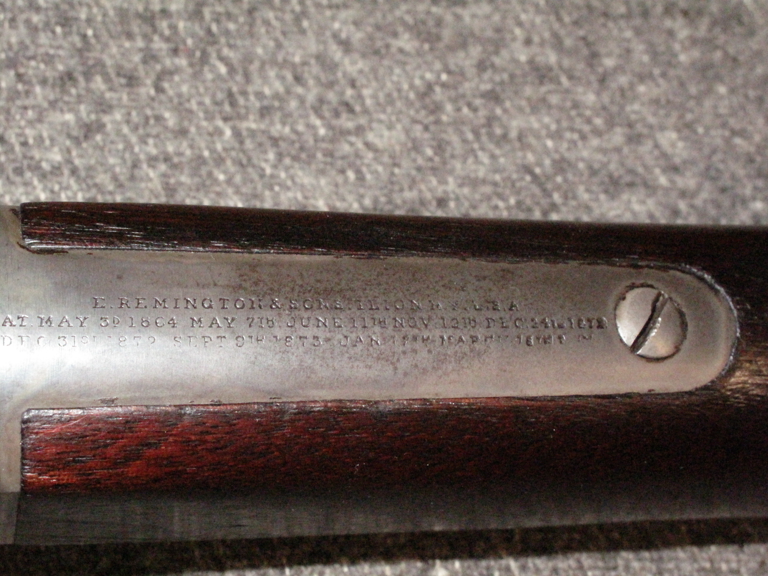

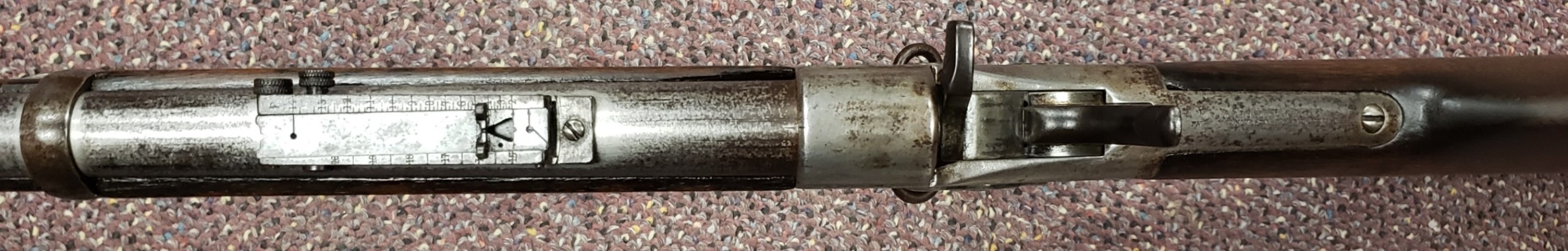

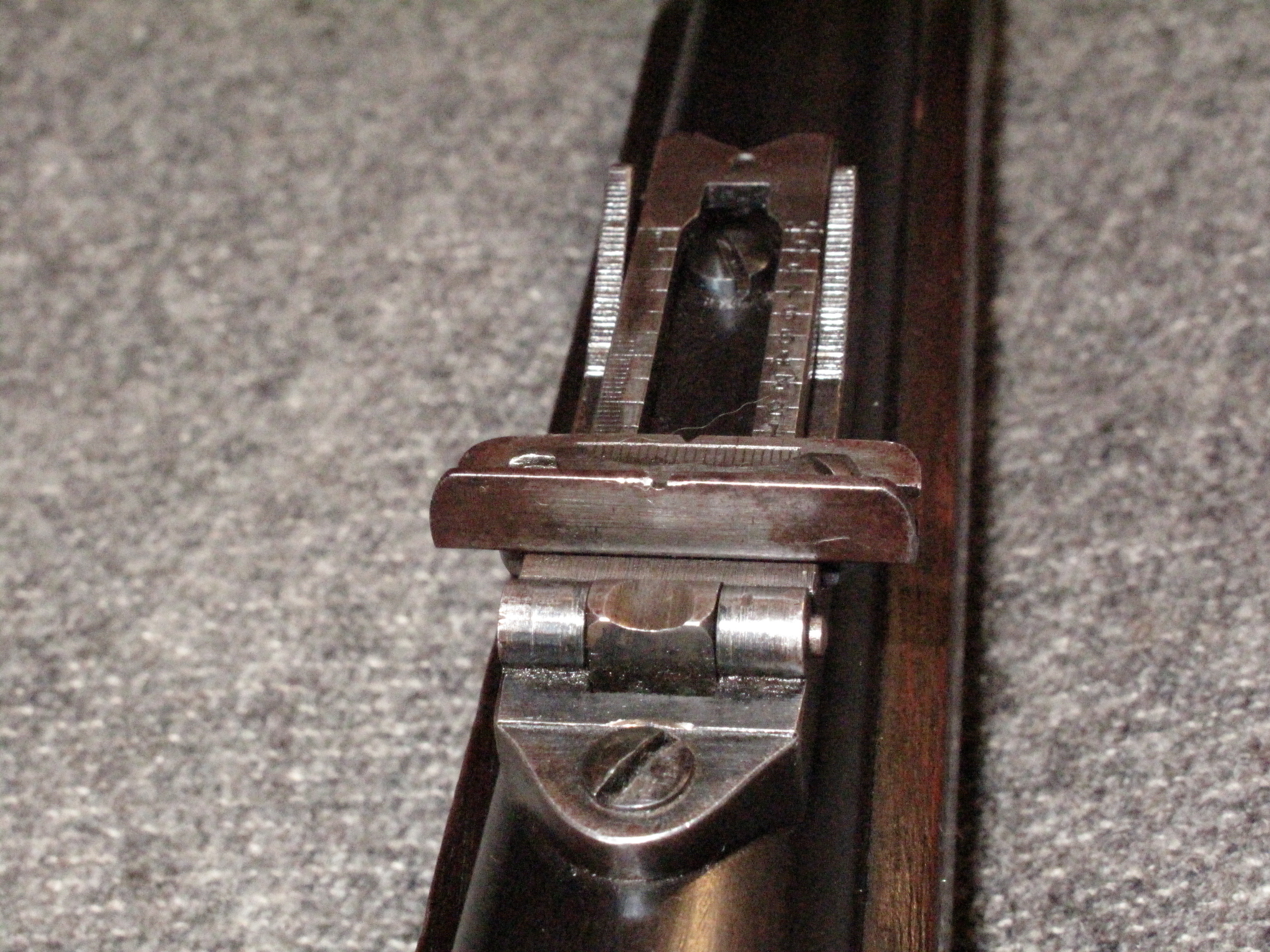

Can someone help me identify the type of rear sight that is mounted on a NGNY style rolling block rifle. The rifle appears to be a private purchase as it bears no New York State inspectors cartouche and is chambered for the 50-70 cartridge. The ladder is calibrated to 1000yrds. and it has a windage adjustable slide. The slide, ramp and ladder all have fine adjustments which may correspond to 1/4 minute of angle. my thought are that it was designed for match competition. Photos attached. Your thoughts.
oldremguy
Posts: 221
Location: Rochester, NY
Re: rear sight
Post by oldremguy »
From the patent dates on your rifle it would make it a part of the 2nd contract that was ordered on May 29, 1873 by the state of New York. A lot of the 2nd order rifles that I have seen for some reason don't have the inspectors cartouches on the the stocks, like those that are found on the 1st order rifles with the last patent dates ending in 1871. In 1877 the NYS National guard sent out a general order allowing the modification of the rear sight.
This diagram is from the book The Manual of Rifle Practice, which was written By General George W. Wingate.

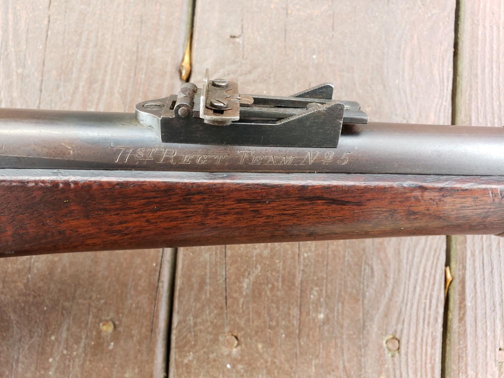

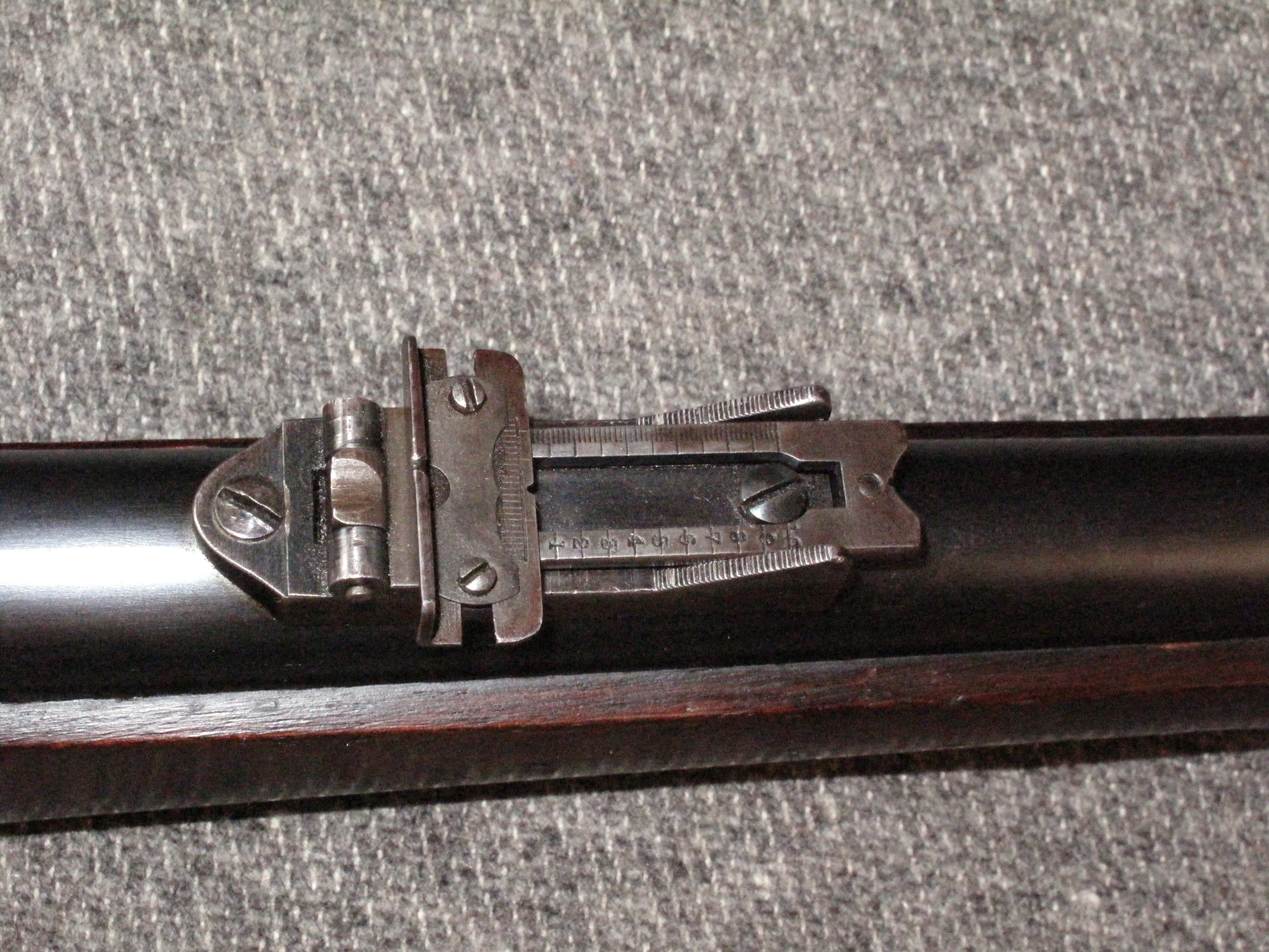

Here are some photo of the rear sight of a rifle that was used by the 71st Regiment rifle team.
Hope this helps you out.

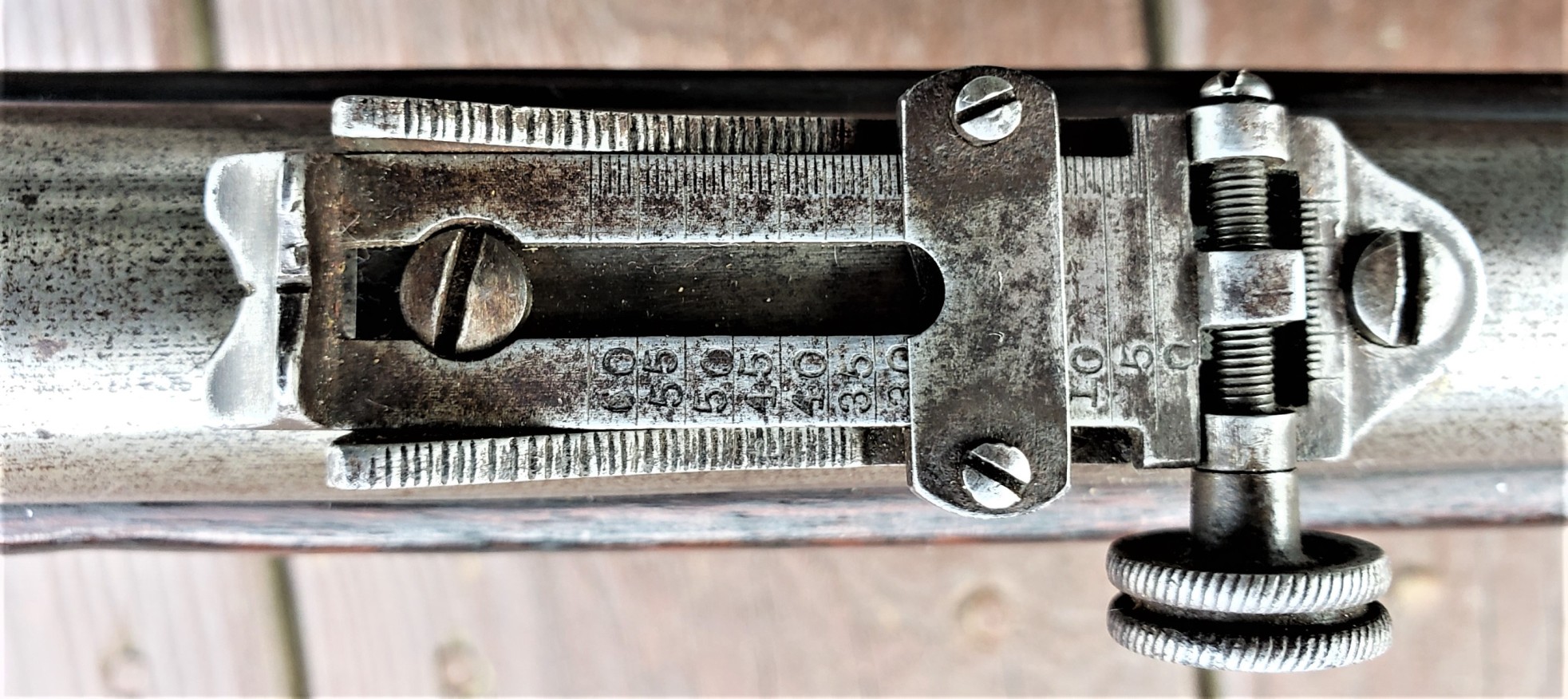

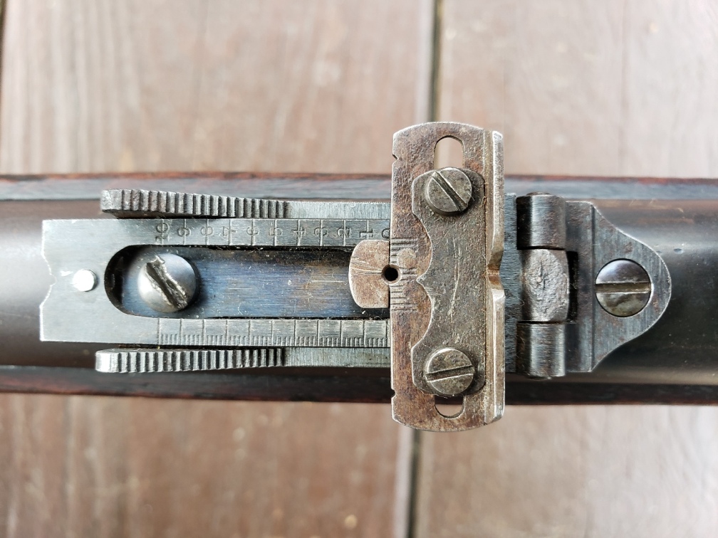

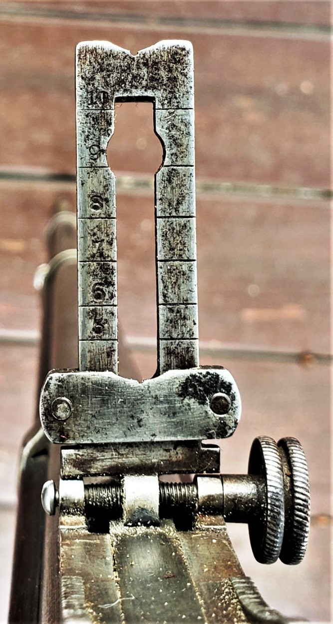

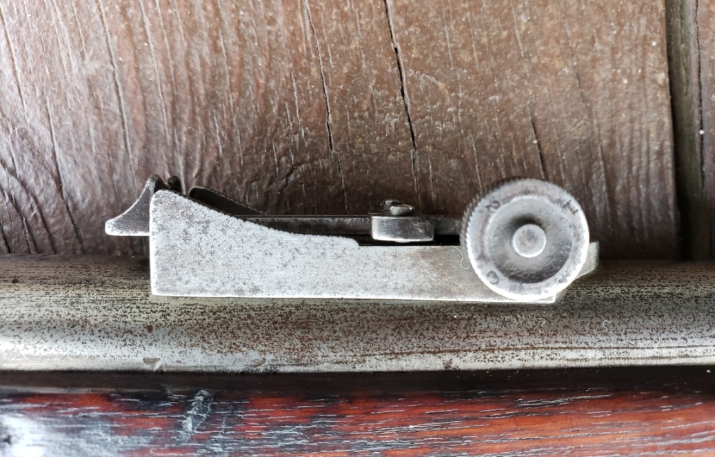

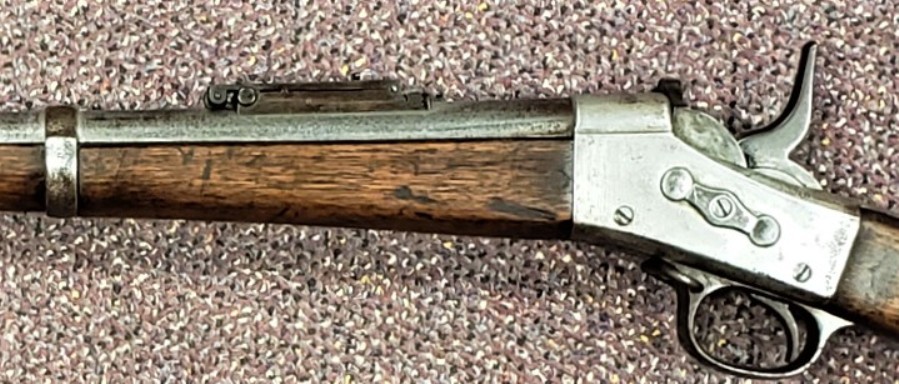

Here are some additional photos of a modified rear sight that is on another rifle in my collection. This rear sight was also modified by adding a windage knob. In 30 years of collecting military rolling blocks, I have only seen one other NYS Model rifle with this modification.
Have a Good Day,
Matt
Posts: 492
Re: rear sight
Post by marlinman93 »
Those sights with modifications for windage would likely indicate the gun's use as a match rifle for military longrange matches. Of course the windage screw adjustment would be much more precise as you get out farther, but either type would not be used for the average soldier. They're specialty changes that would be made after they left Remington most likely, and for team shooters at clubs.
Pretty neat stuff!

Thanks Matt, I suspected it was a special use rifle due to its overall condition. It was well maintained.

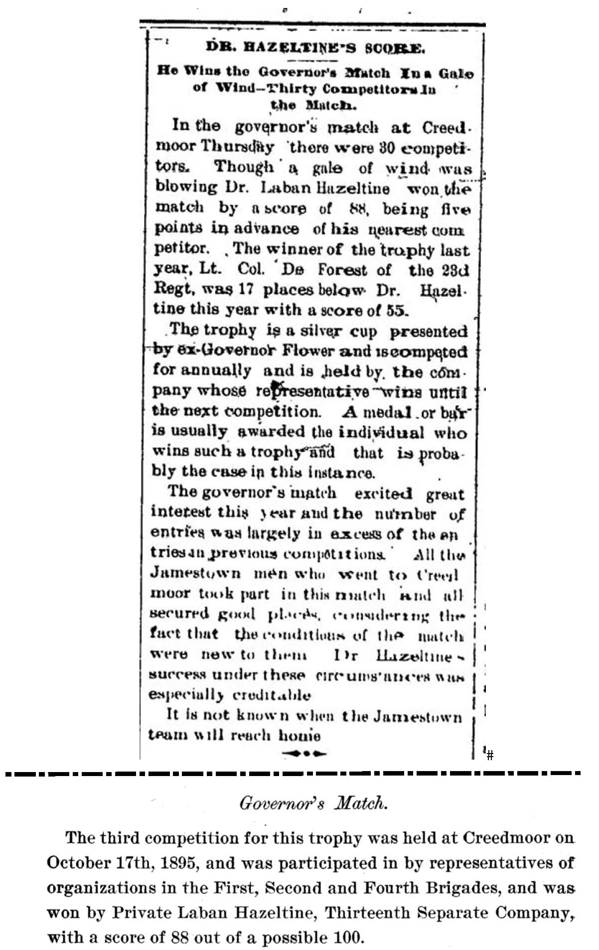

Here is an article about the 4th Brigade Shoot held at the Bay View Rifle Range in 1893 and the shooting metal that Private Laban Hazeltine won there.
4th Brigade Match 1893.jpg (228.9 KiB) Viewed 45242 times
Laban Hazeltine.jpg (208.91 KiB) Viewed 45242 times
Have a Good Day,
Matt
