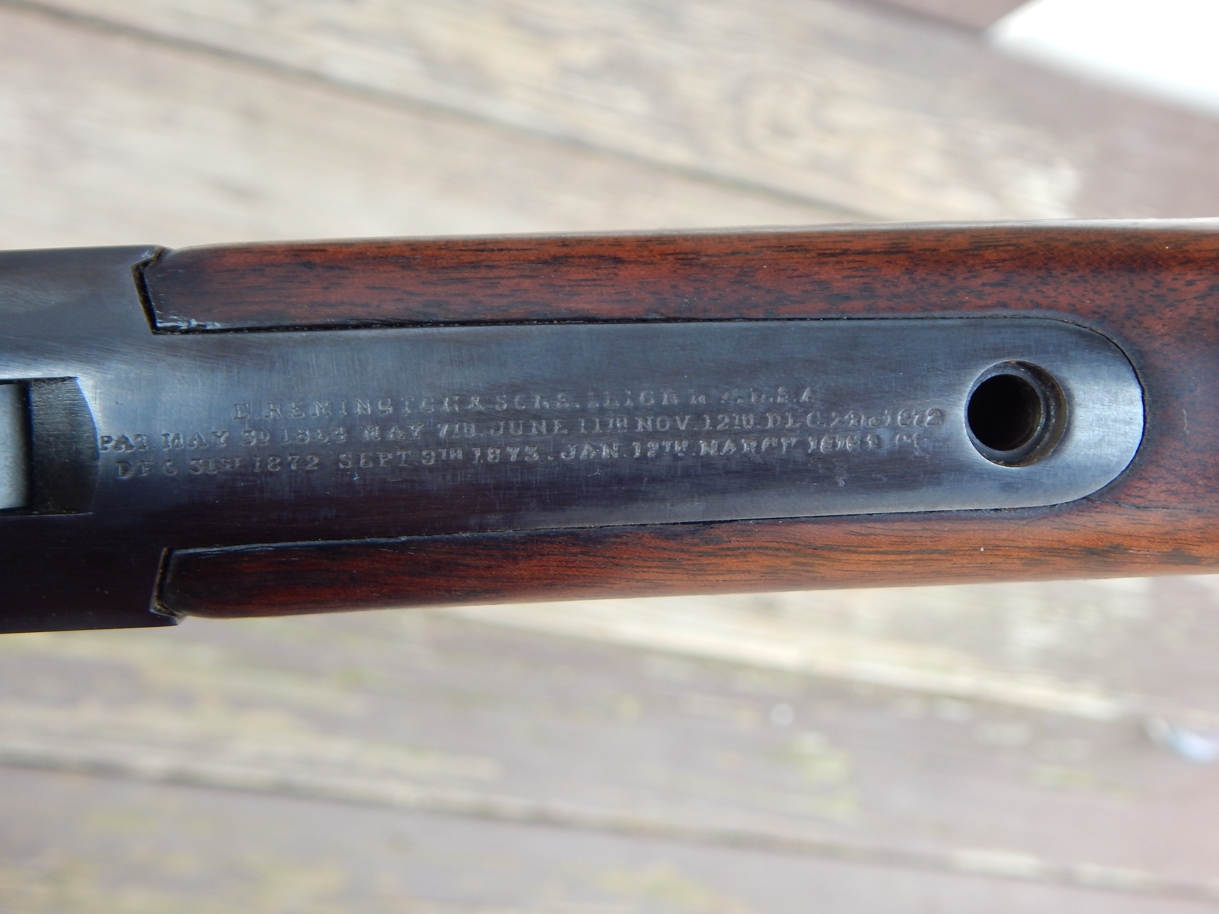

I have a Rolling Block in .348 Winchester. .348 is stamped on the top of the receiver. It is my understanding that .348 came out in the 1930s. I believe my rifle is a military rifle. I think the last patent date was 1874 but it is a little worn on the external tang just in front of the butt wood.

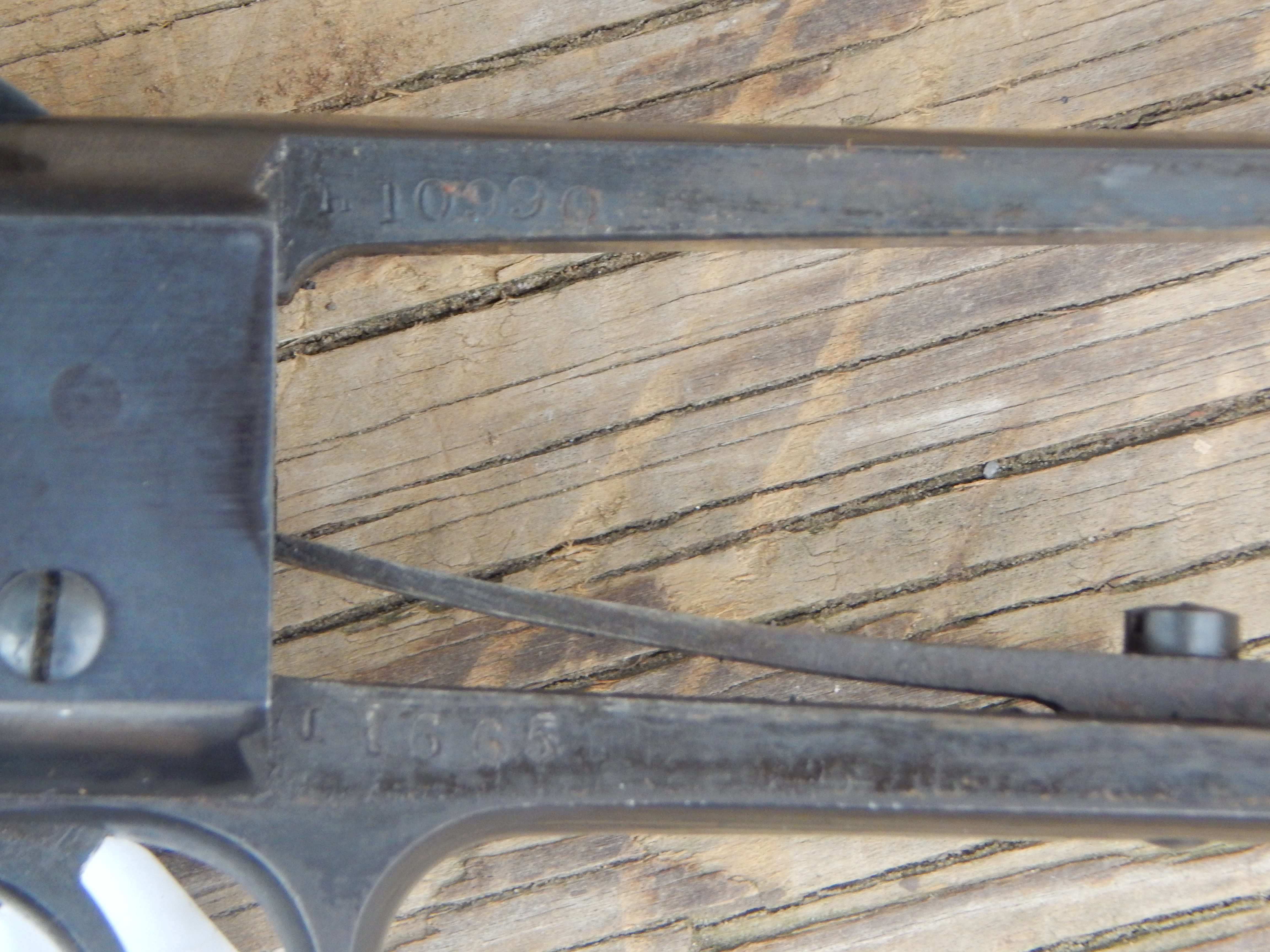

I am interested in shooting it but I would like to be safe. The gun is in excellent condition. I was told that it was rebarreled to .348.

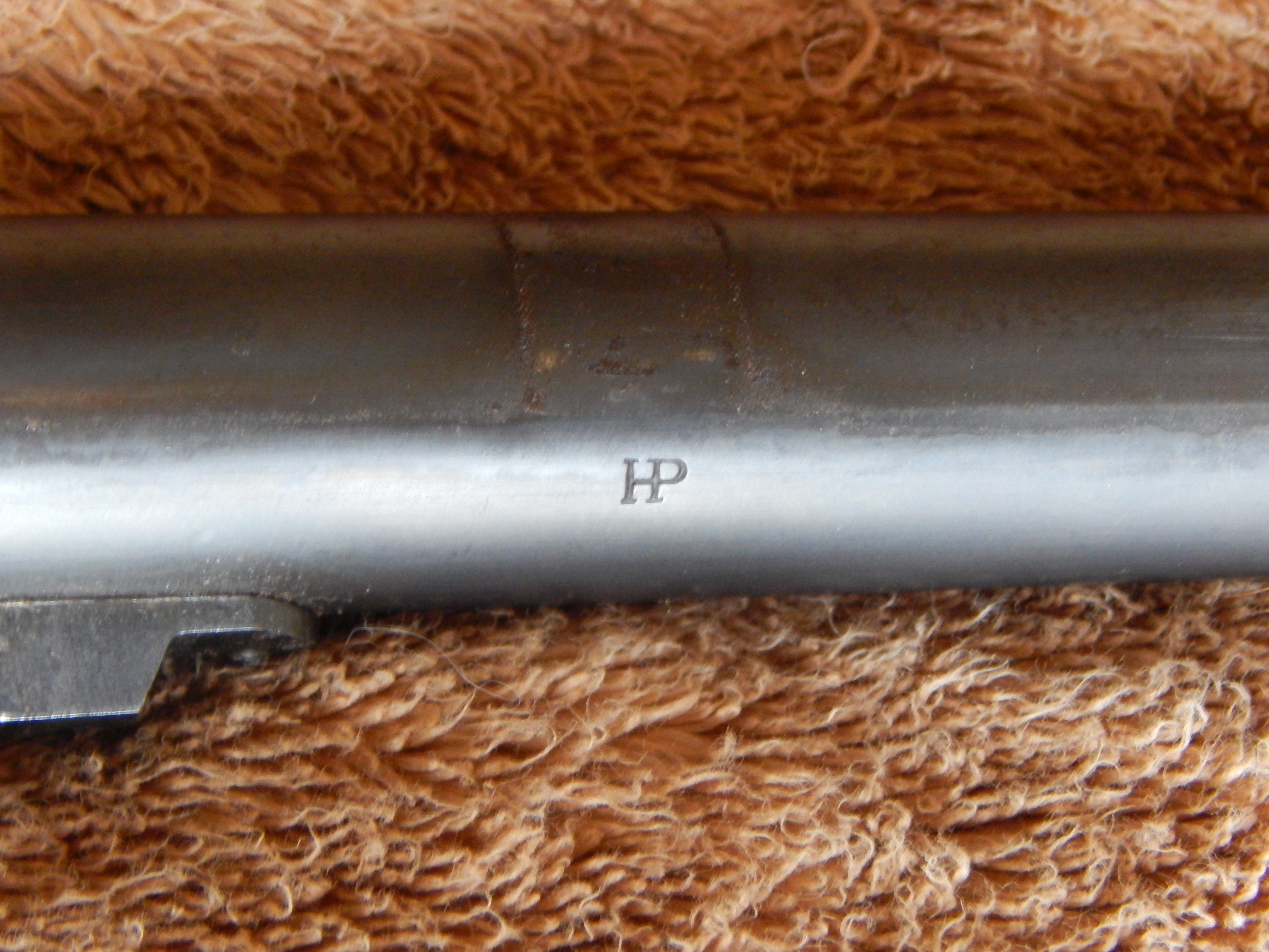

The serial number on the upper is R 10990 and the one on the trigger guard tang is U or J 1665. I could not find a chart to tell what year or model the are. The stamp on the barrel is HP with no space and B on the octagon part that touches the receiver. The barrel does not have a serial number. The barrel has a bayonet lug.
Any help and guidance appreciated. Thanks

Your RB is of the 1879 Argentine pattern with the
Nock's Form barrel (w/ Octagon breach section).
The numbers on the sides of the tang are a lot
numbers. Rolling Blocks were made in lots varying
from 10,000 to 50,000 in a lot depending on the
contract. The upper and lower tang should have
the same number. This was done to keep the
trigger guard and frame together during manufacture.
After they left the Factory, who knows what happen
to cause yours to become a mixed parts rifle.

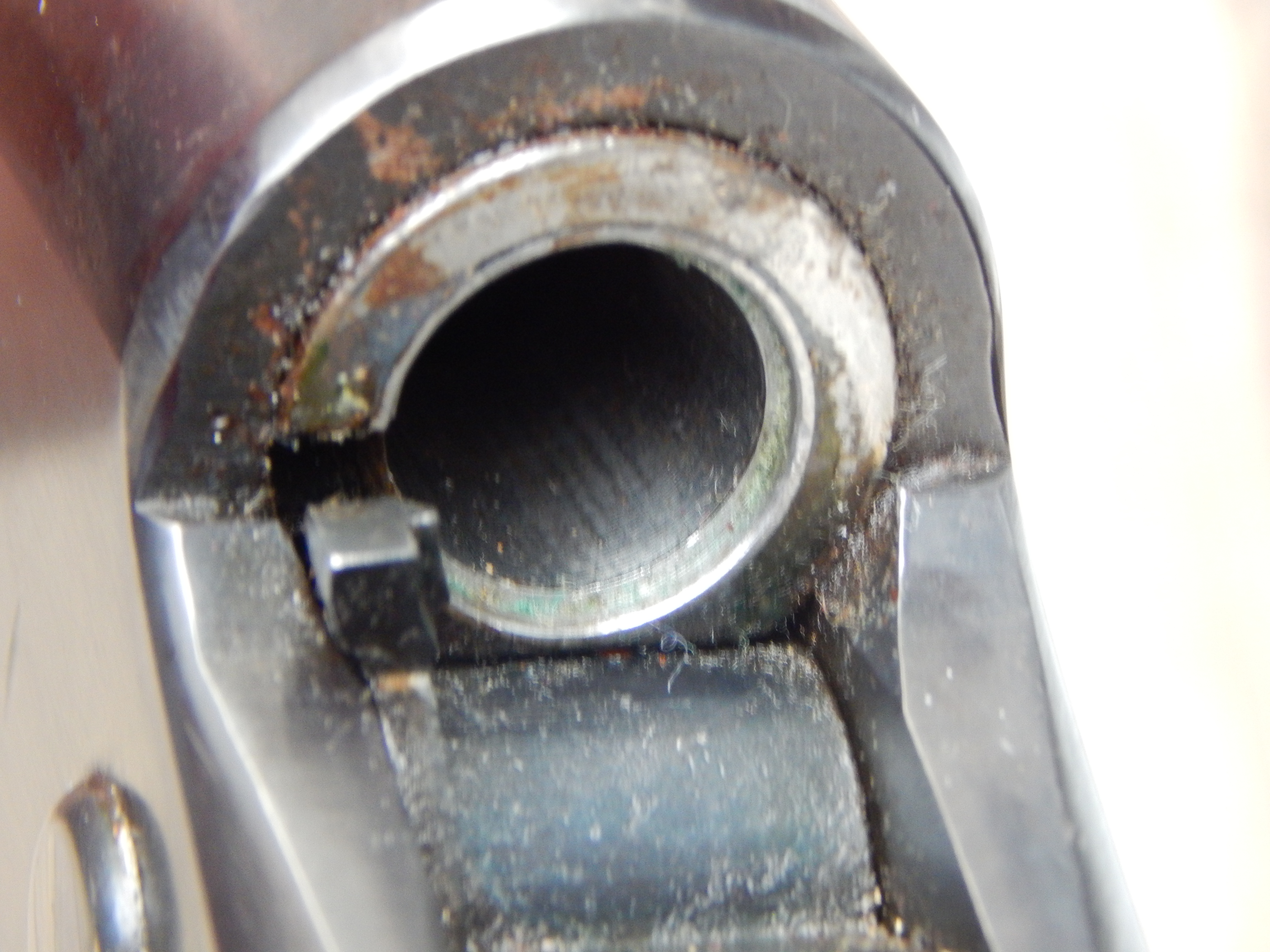

The last picture, showing the open breach, looks like
the barrel was re-lined. This would be necessary in
order to properly fit the 348 Win. caliber.
Some more pictures would be helpful in determining
if the barrel has indeed been relined. The bayonet
lug and letter "B" on the barrel show that this is an
original Remington barrel of the period.

Yes, an experienced observer could visually tell whether a
bore has been relined. We do not know the level of experience
that the OP has. That Is why I suggested they post more
pictures.
