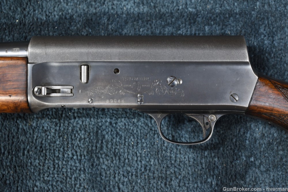

Hopefully this will post as an attachment of the larger style of scrollwork on the "American Browning" I will try to post another image of the smaller scrollwork most often seen on these particular years.
