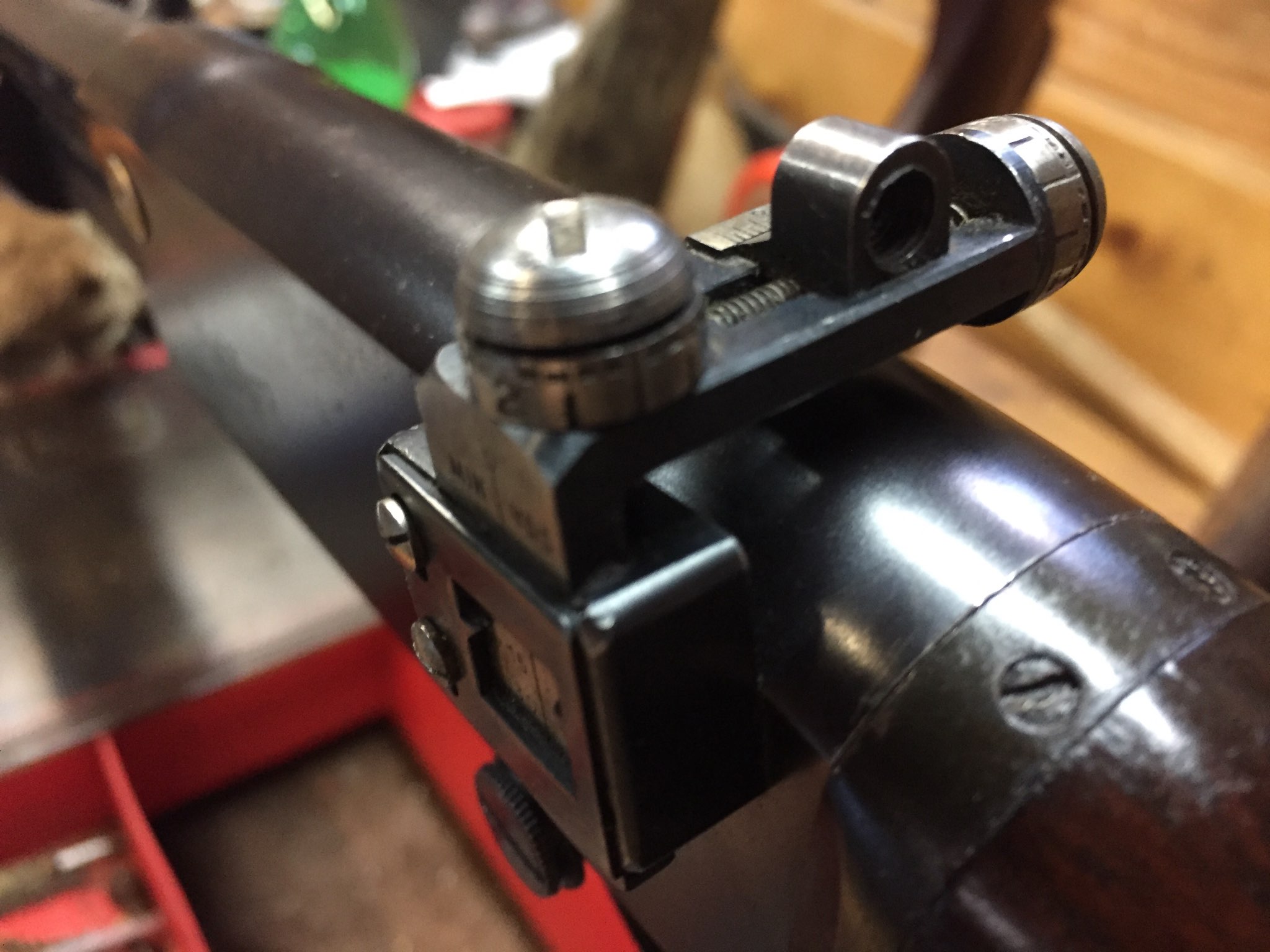

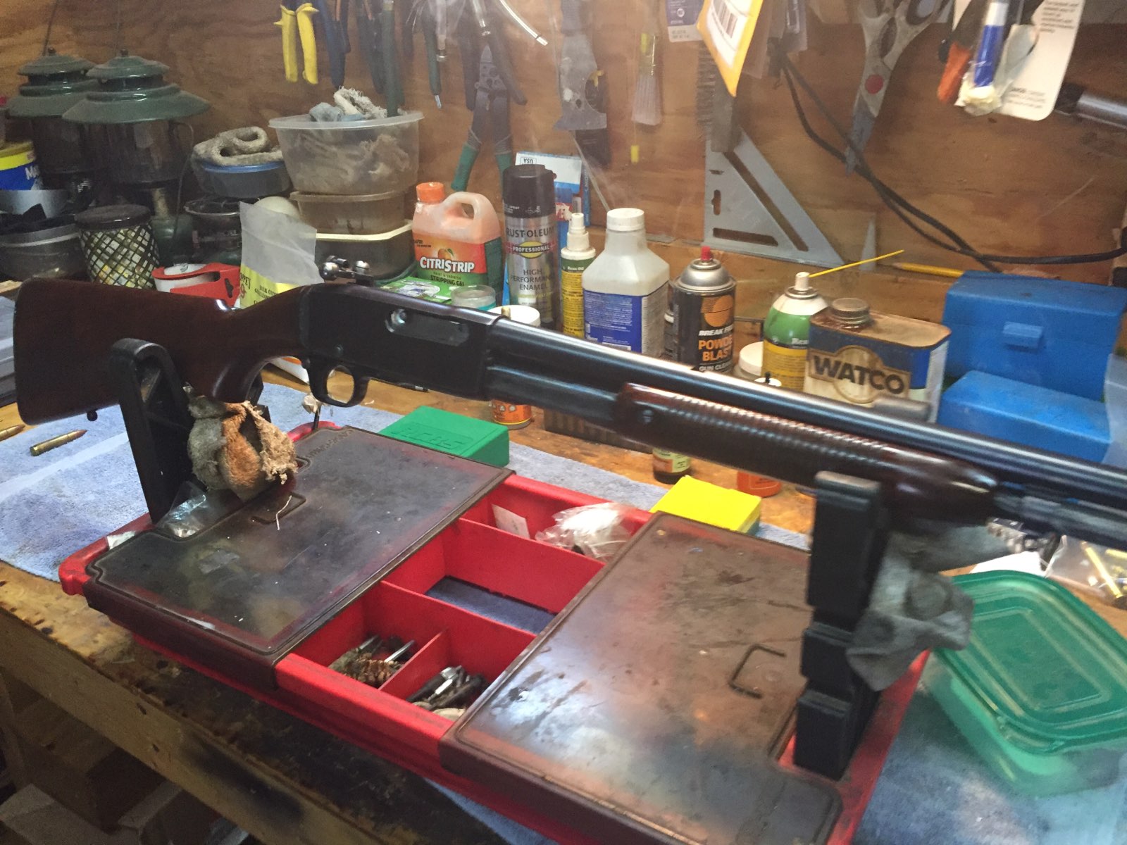

I just picked up a very nice 141 Rem. in 35 cal. manufactured 1939. I plan to load 200gr RN bullets. Does anyone have a favorite powder/primer combo for this rifle?
