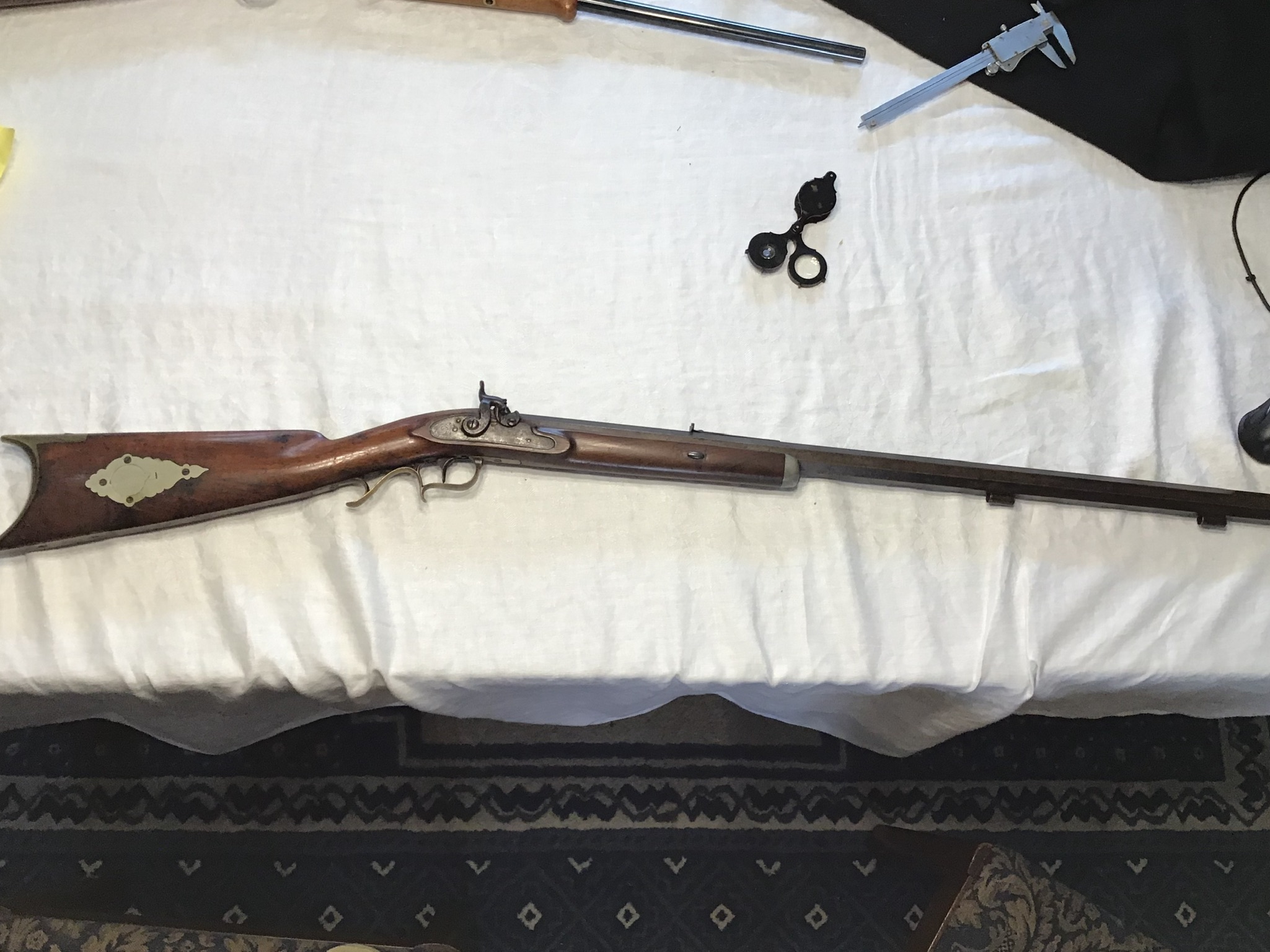

I inherited from my father an old rifle I'd like to query your collective wisdom about. I've searched several guides and catalogs and can't find anything like it. Would love an identification/estimation of value.
whole gun
whole gun
It's a percussion rifle, seemingly .35 caliber.
• 1.19 Meters long (3 feet 11 inches)
• barrel length: 78 cm (2 feet 7 inches)

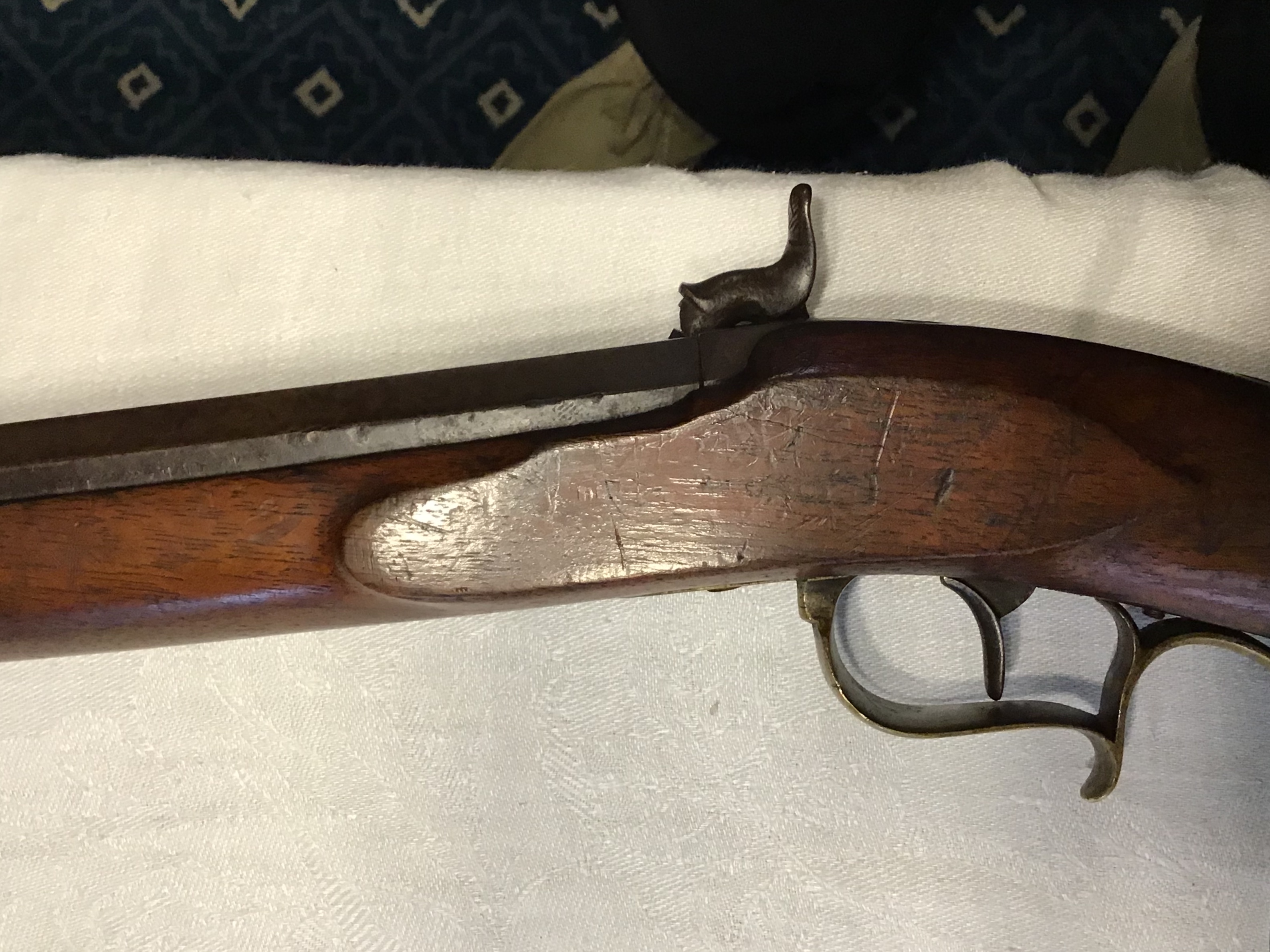

lock 2
lock 2
According to William B. Edwards (Civil War Guns, 1962) a gun with a "teat" shape to the stock cheeks on either side identifies a gun as made entirely in the Remington factory. “This detail is the unusually tapered "teat" shape to the stock cheeks on either side; on the right where the bar lock sets in, and on the reverse where there may be a simple escutcheon for the cheap single lock-screw that holds on the hardware company lock.” (p. 188). Is that pinched shape in the wood behind the lock the "teat" shape that he intends?

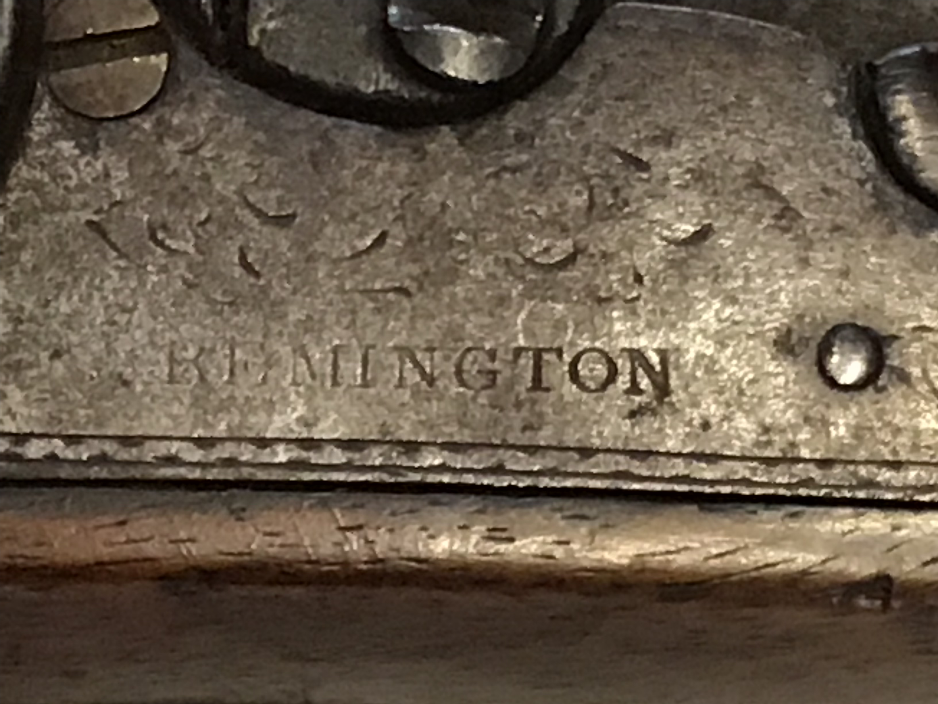

remington on lock
remington on lock
Percussion lock marked REMINGTON. According to Roy Marcot (The History of Remington Firearms [2005] pp. 8-10), the first Remington locks were made in Birmingham, England but were marked like this.

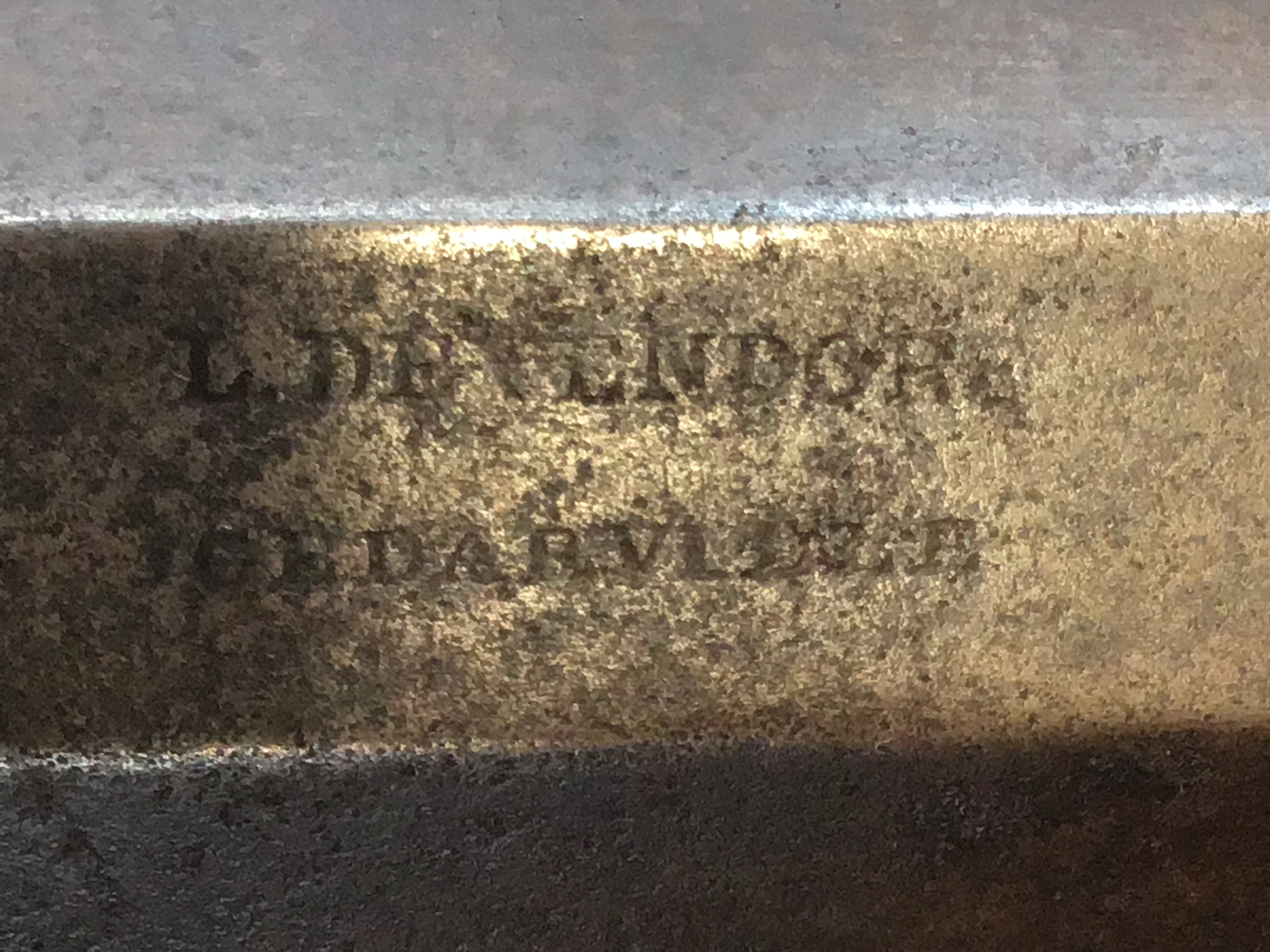

devendorf
devendorf
Barrel by Louis Devendorf of Cedarville, Pennsylvania. Holman Swinney has this to say about Devendorf: “DEVENDORF, L (EWIS) CEDARVILLE ca. 1840—Civil War times. He was a good workman who made well finished hunting and target rifles. Well known locally. His shop was west of the Ilion Gulph road and south of the main east-west street of Cedarville.” (Holman J. Swinney. “NEW YORK STATE GUNMAKERS (PART I): A Partial Checklist” New York History, Vol. 32, No. 1 (January, 1951), pp. 91-112

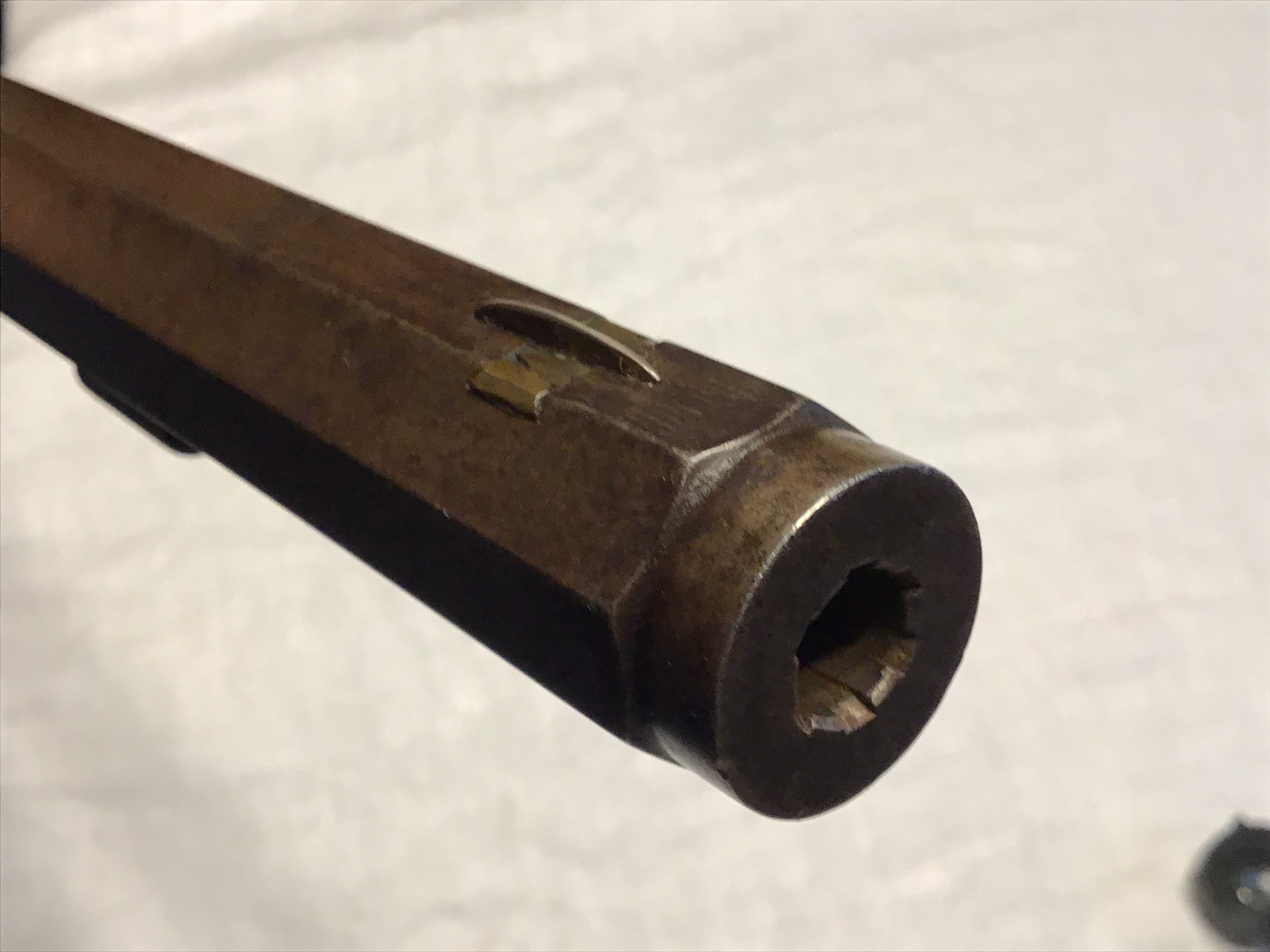

front sight
front sight
The shape of the muzzle suggests it's a target rifle (?)

The barrel looks to me like a target type and the turned
down section at the muzzle is for fitting a "false muzzle."
Your source (Mr. Edwards) stated that the "teat" shape of
the stock cheeks was on both sides. What does the other
side of the stock look like?

Thanks so much for the input. The left side stock cheek also has the “teat.” Here’s a picc

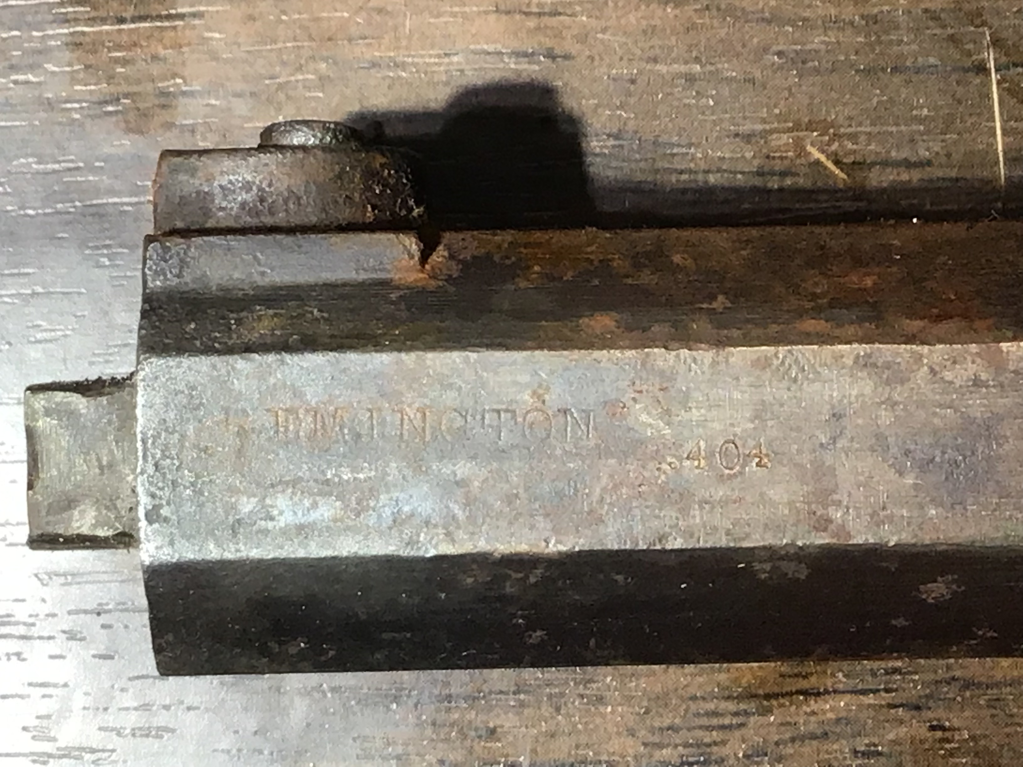

Thanks so much for that detailed information. It really helped. I removed the barrel and found out that it is indeed a Remington barrel. It's also marked .404, which I take is the caliber. See attached pic:
How significant is it to have a complete Remington of this type? Are there many others like this?
