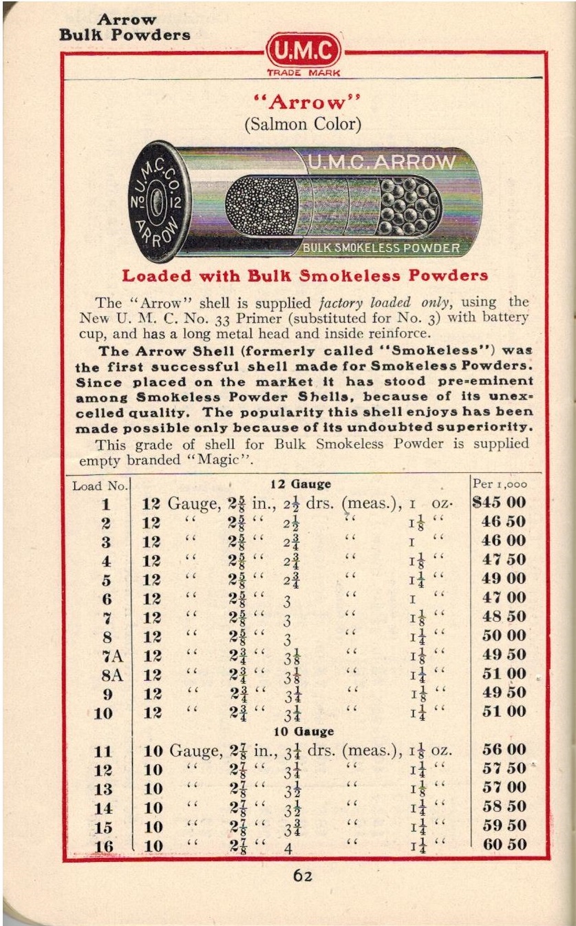

Surviving hang-tags show that at the time your gun, 250182, was built, Remington Arms Co. was targeting their 12-gauge guns with the Union Metallic Cartridge Co.'s ARROW shell with Load No. 8, with #8 chilled shot. Load No. 8 was 3 drams of bulk smokeless powder pushing 1 1/4 ounce of shot. From the 1905 UMC catalog --
1905 ARROW Bulk Powder Loads, pg 62.jpg (455.3 KiB) Viewed 15165 times
Earlier, they were using the UMC SMOKELESS shell with the same load, and later they went to using the low brass UMC NITRO CLUB shell with the same load which in the NITRO CLUB shell was Load No. X8.

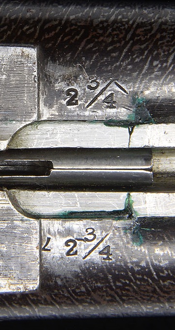

From the get go of cartridge shotguns here in North America, the "standard" length for 12-gauge paper shells was 2 5/8 inch, but 2 3/4, 2 7/8, 3 and 3 1/4 inch 12-gauge shells were available. For England and Europe the 2 1/2 inch (65 mm) shell was the "standard." Remington Arms Co. 12-gauge doubles were normally chambered 2 5/8 inch. If they were chambered for longer shells they were marked on the bottom of the barrels, just forward of the barrel flats.
121252 DEO-Grade 07 2 7-8 inch chamber marking.jpg (344.13 KiB) Viewed 15148 times
123247 11 Chamber Length Markings.jpg (130.24 KiB) Viewed 15148 times
These are few and far between and most always higher grade, special order guns, not entry-level guns made for stock.
