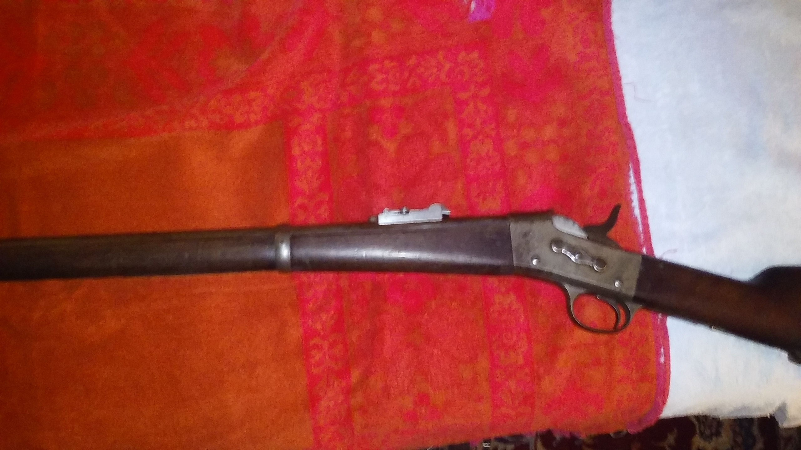

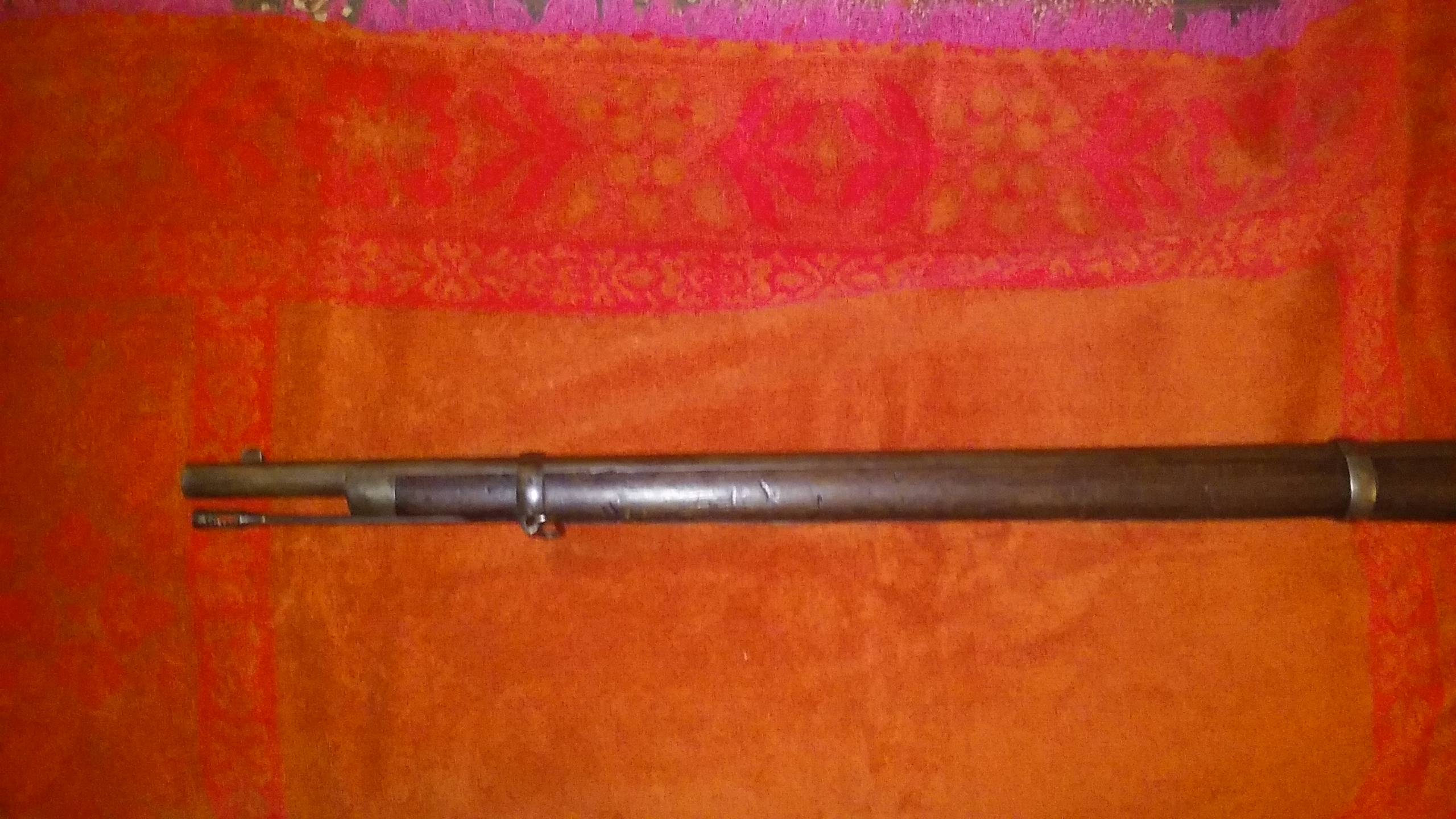

Hi There,
I just received another rolling block for my collection and
I'm trying to discover what exactly I have. It appears to
be very close to a Civil Guard model but there are a few
differences.

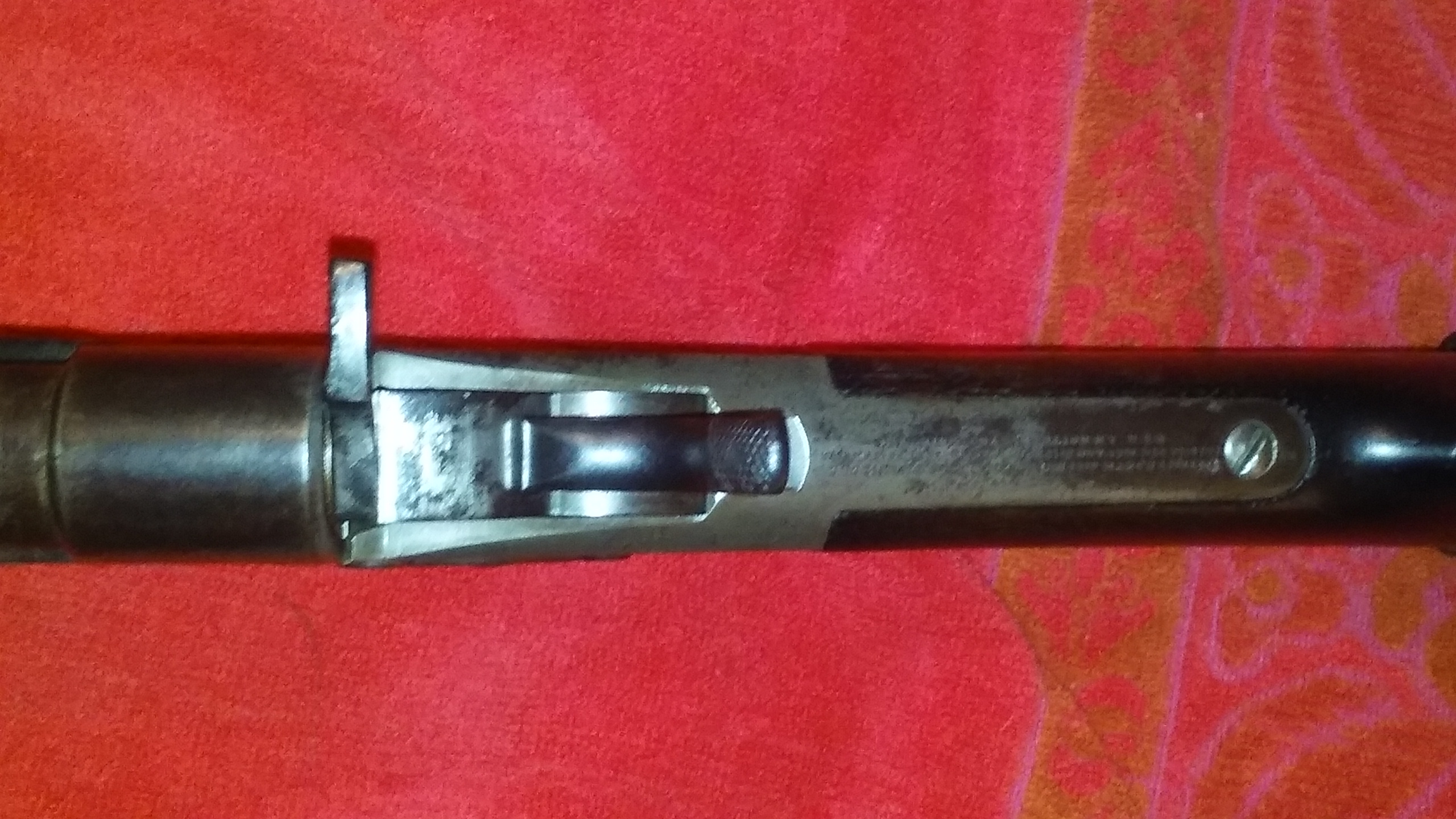

First off, Let me describe it. It is a two band rifle with a
31-1/4" barrel. It is in 50/70 caliber. I have read that the
Civil Guard model was supposed to have a 30-5/8" barrel.
I am not sure how over-all length is measured on these. If I
measure from the muzzle to the center of the butt, I get 45-3/4"
but if I measure straight down the barrel and interpolate a vertical
line down to the heel of the butt, I get something like 46-1/8".
The length of pull is slightly shorter than the standard rifle.
This one has a 12-3/4" pull where my standard Spanish pattern
rifle is 13".
The neat thing about this was, it was advertised as a .43 Spanish
caliber but when I got it in hand, the chamber was too big. I began
to wonder if it was a .43 Egyptian so I started measuring the rim
diameter and base of the chamber. They were not even close to
the Egyptian dimensions. I looked down the chamber and bore and
noticed that this wasn't for a bottleneck cartridge. So, I made a
chamber cast. Sure enough, the dimensions were for a 50/70.
The groove diameter is a little tight (at .511" to .512") but not
excessive (especially if I size my bullets correctly).

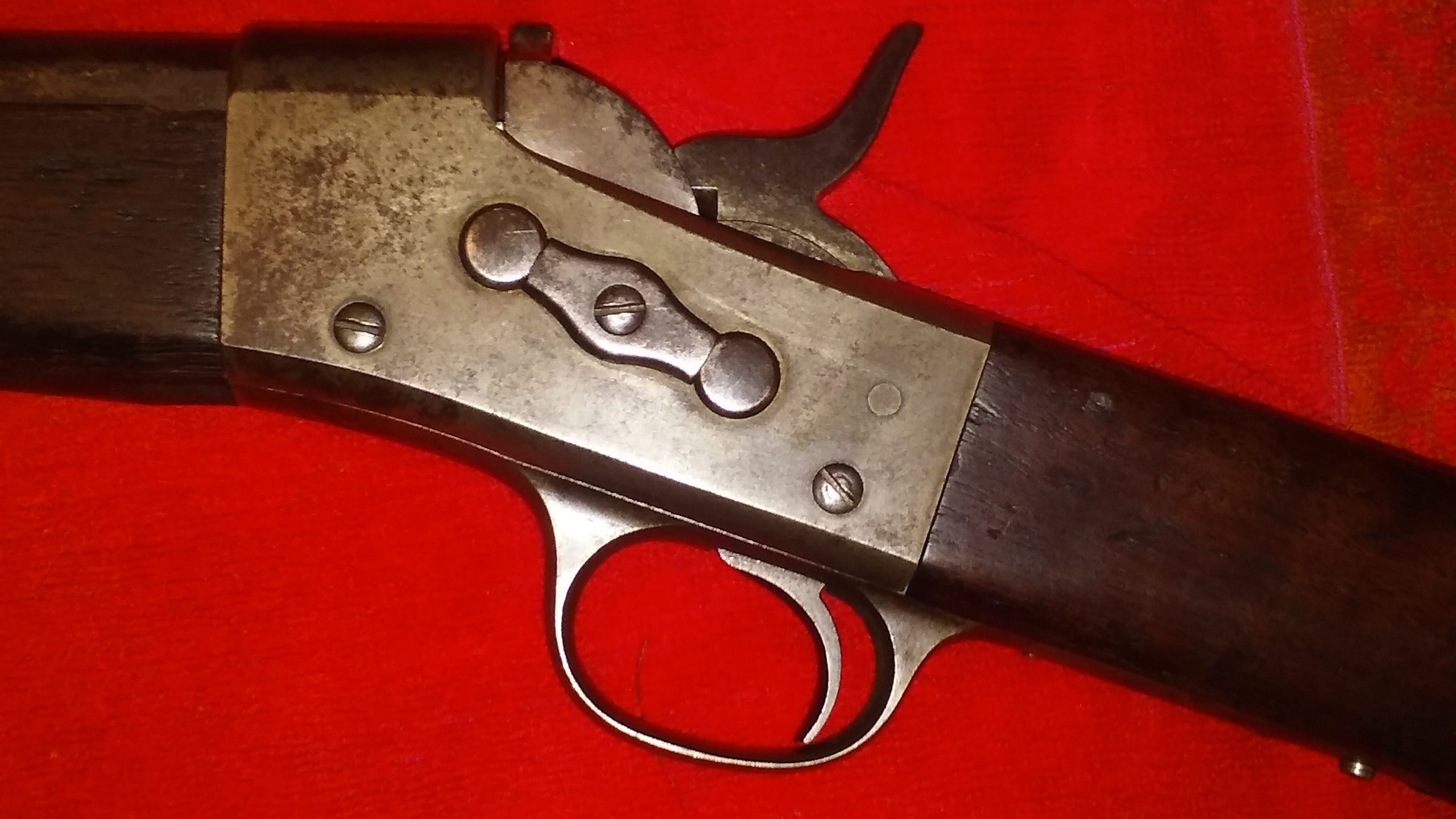

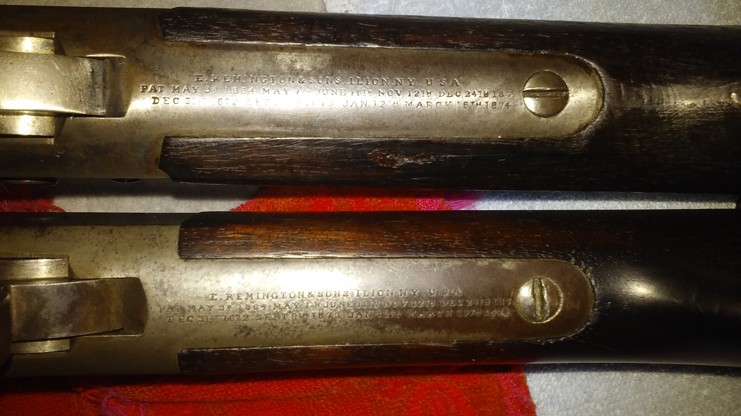

There are a couple of other points that intrigue me. The frame
appears to be a "type 4" but it doesn't have the "mortises" where
the wood abuts the frame. I post a pic here with my Spanish model
over top so you can see the differences
I am curious to know what others think. Post your thoughts.

The rear sight on the guard rifle is the same type that is found on the New York State rolling block rifles.
Also I think the frame and breech block may also be the same as found on the NYS Rifles. That would help
explain why it doesn't have the mortises as found on the later frames. I will try to post some photos of my guard rifle in the next few days and take some measurements of the barrel length.

Yes, this was on GunBroker for a while. It is NOT
a New York type locking action. It does have a New
York style breach block (with the three pointed shield
impression) but these have been used on other
rolling blocks too. Like most 19th Century firearm
manufacturers, Remington used surplus parts whenever
they could.
I was re-reading my copy of Remington Rolling Block
Military Rifles
by George Layman
and under the section
on Cuba, George mentions that he recently acquired
a Civil Guard model from Cuba that had a 1-1/2 action.
This got me thinking and I measured the thickness of
mine. I found that it is thinner than the standard Number
1 action. The standard is 1.312" thick and this one is 1.225"
thick. Not as thin as a 1-1/2 (which are supposed to be
1.14") but thinner than a standard No. 1. I wish George
was still around to ask about this.
As I think about it, I wonder if it was originally a type 3
action (with rotary extractor) that was machined and/or
ground down to eliminate the step. In any case, it is
professionally done and appears to be a factory job.
In the above mentioned book, George says that type 3
actions had the mortised frame too.

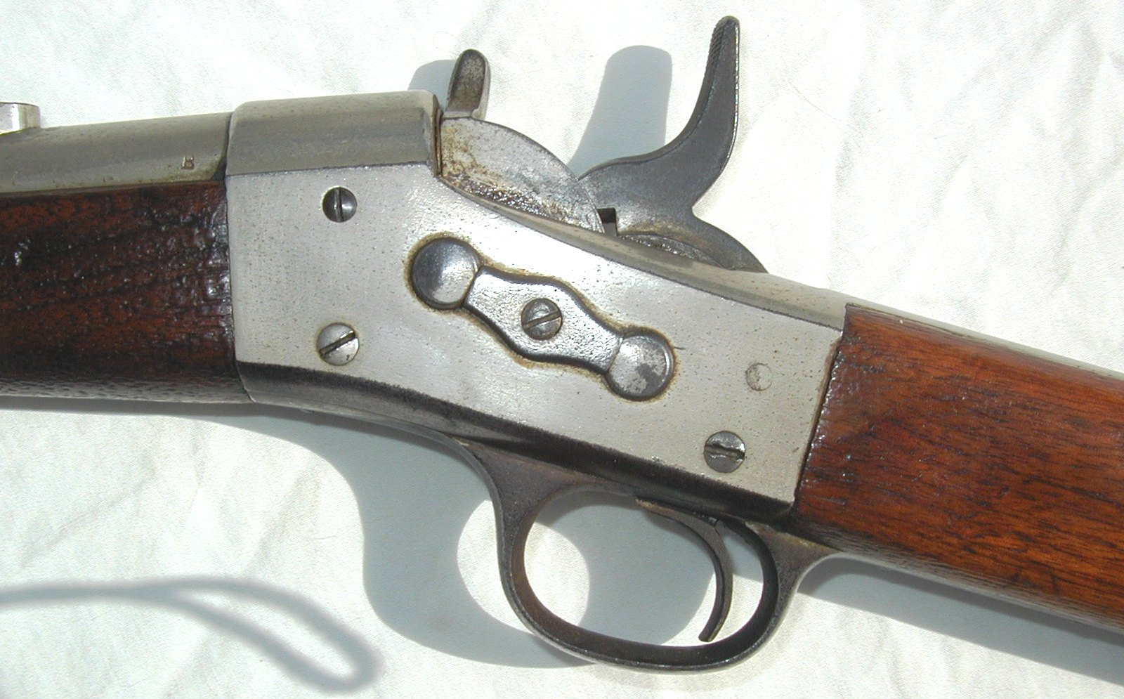

Hello Webb,

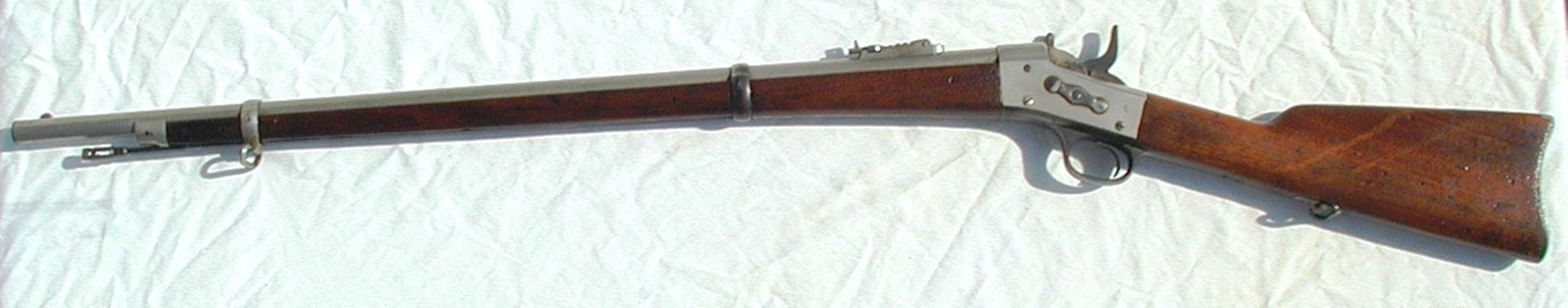

Here are some photos of my guard rifle.
The barrel length is also 30-5/8 inches.
The thickness of my receiver is 1.315 inches.
My rifle has the slide extractor on it.

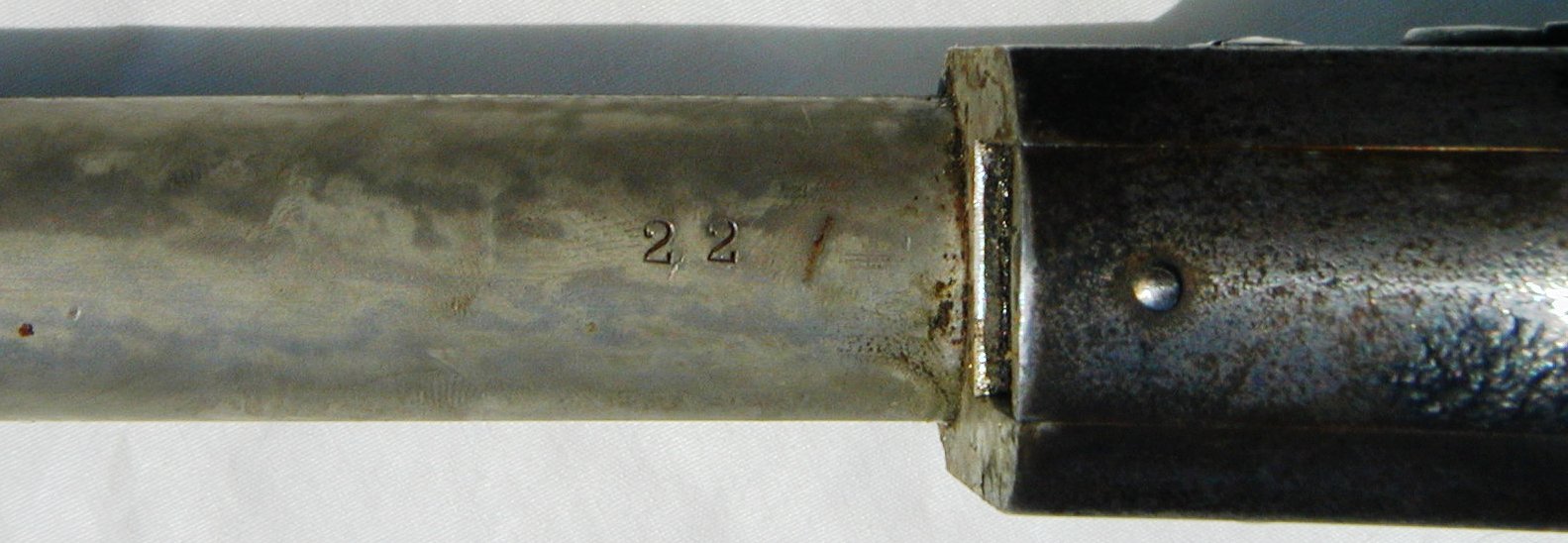

Post by oldremguy »

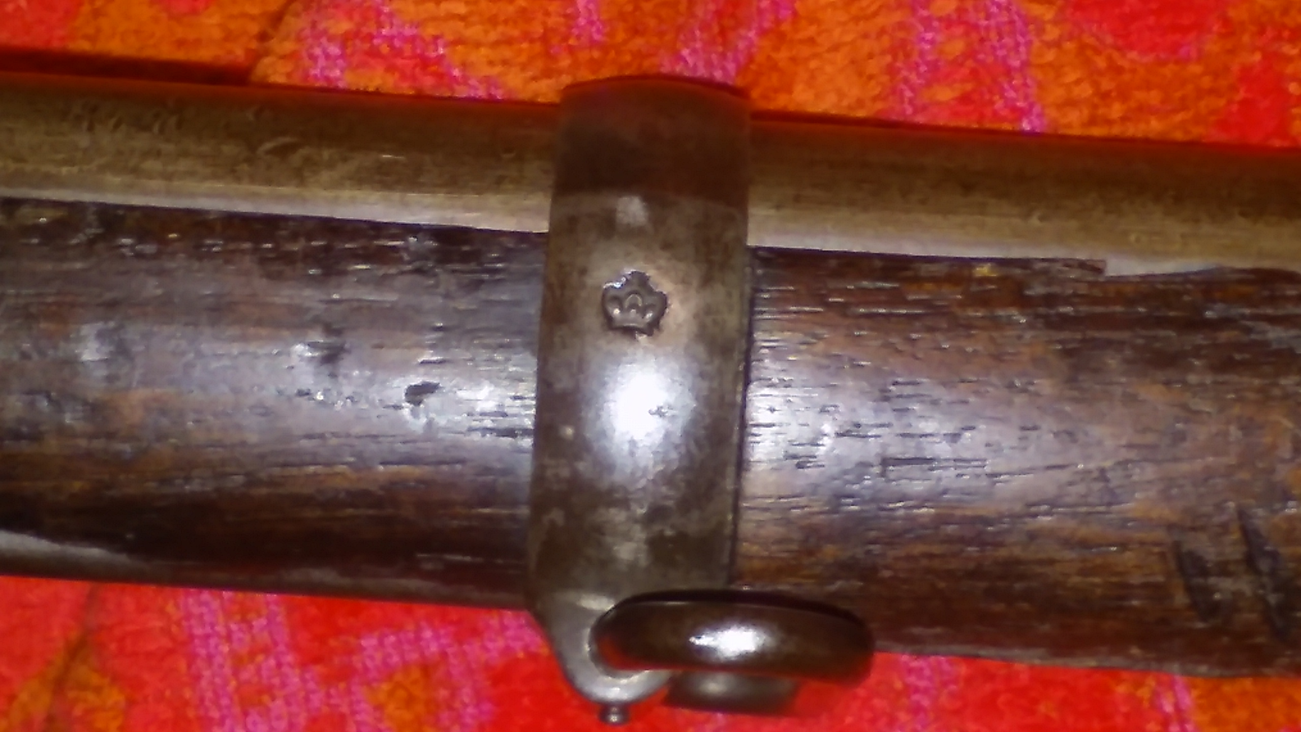

Here are some photos of the barrel bands.
The number 22 which I believe to be assembly numbers is stamped on the barrel, frame and forearm.

Hi Matt,
Thanks for responding!
Your Civil Guard model is very nice! Does it have
a "tinned" finish? It sort of looks like it does.
There are no assembly numbers per se, except for
the left-side upper and lower tangs have 356.
Your receiver is a "type 2" with slide bar extractor
(as you mentioned and mine is an unknown type.
It doesn't exactly match a "type 3" or "type 4" but
it looks more like the "type 4" except lacking the
mortises.
My Barrel Band are just about identical to yours.

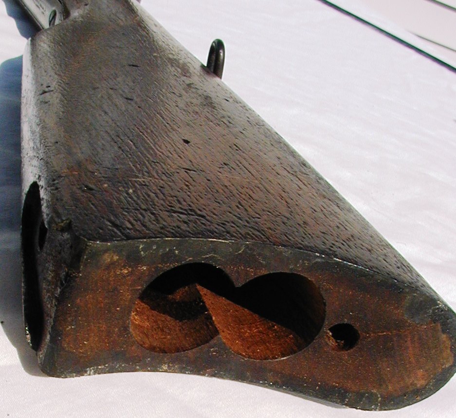

Hello Webb,
I believe my rifle is nickel plated and it is also chambered in 50-70.
The butt stock on my rifle was drilled out to help reduce the weight of the gun.
This is the only rolling block rifle that I have ever examined that had this done to the butt stock.

Mine doesn't have any cutouts under the butt plate.
How deep do yours go?

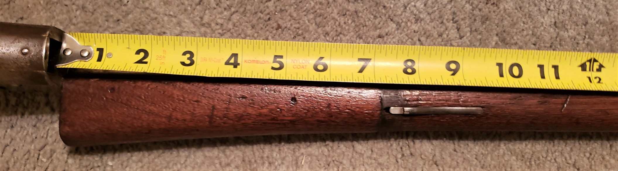

Hello Webb,
The cutouts in the buttstock are approximately 1 inch in diameter and the top one is 3-1/4" deep and the bottom hole is 5-1/4" deep.

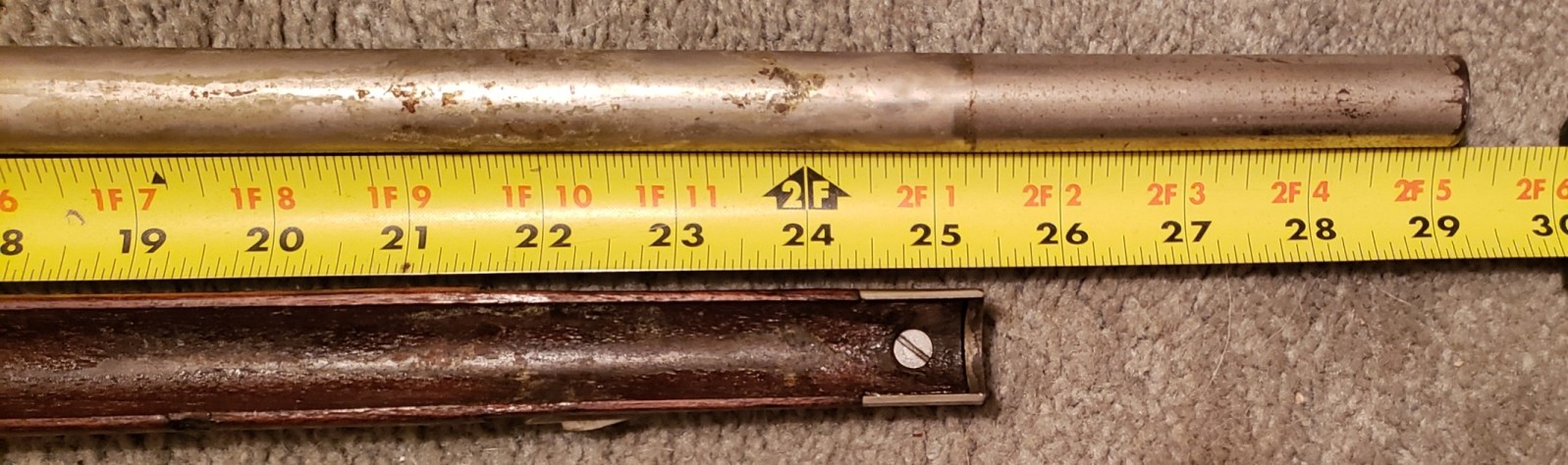

The distance from the end of the forearm to the muzzle is 29-3/16"
Photo 3.jpg (230.32 KiB) Viewed 7607 times
Distance from front of receiver to rear barrel band is 7-3/16"
photo 1a.jpg (271.65 KiB) Viewed 7607 times

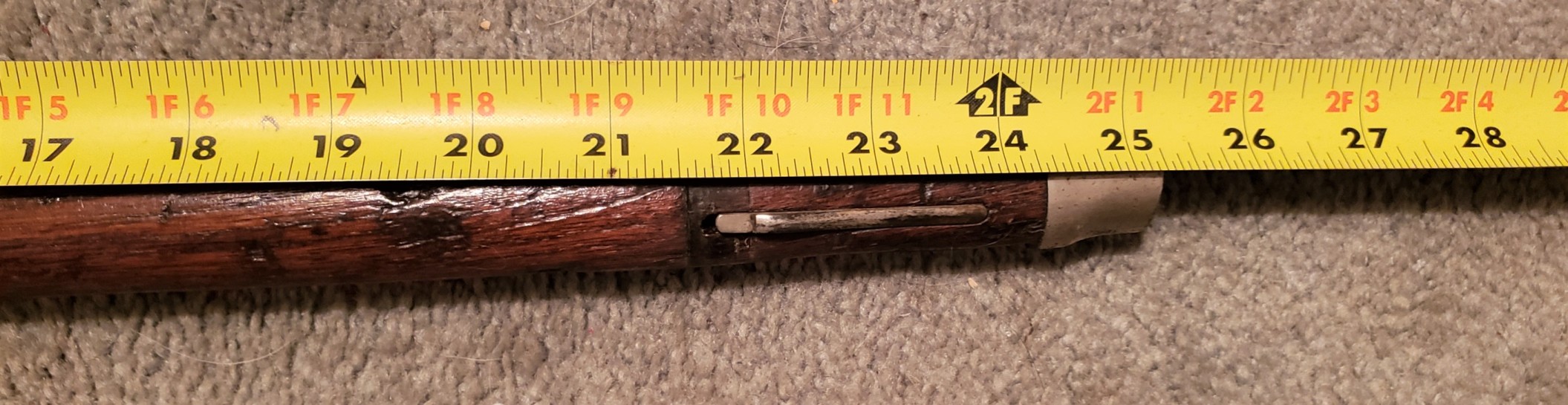

Distance from front of receiver to front barrel band is 21-5/8"
Photo 3a.jpg (304.79 KiB) Viewed 7607 times
Distance from front of receiver to rear of barrel forearm stud is 5-15/16". It looks like they made a mistake and cutout the barrel stud in the wrong place in the forearm and had to redo it.
photo 1.jpg (356.78 KiB) Viewed 7607 times

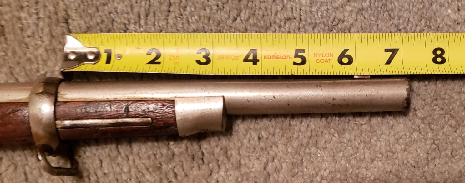

Hello Webb,
Here is one more photo showing the distance from front barrel band to end of barrel is 7-1/8"
From the end of the nose cap to the end of the barrel is 3-7/8"
Photo 4.jpg (212.76 KiB) Viewed 7607 times

Thanks for the measurements Matt. Mine are
similar but not identical. I don't have pics and
I didn't record all of the same measurements you
did. What I do have is this:
Forend Tip to Muzzle: 3"
Front of Receiver to Rear Barrel Band: 7-1/4"
Front of Receiver to Front Barrel Band: 23-1/8"
Front of Receiver to Forend Tip: 26-3/4"
Front of Receiver to Muzzle: 29-3/4"
Barrel Length from Breech Face to Muzzle: 31-3/16"
Measurements are similar but they diverge more as the
they move away from the receiver.
