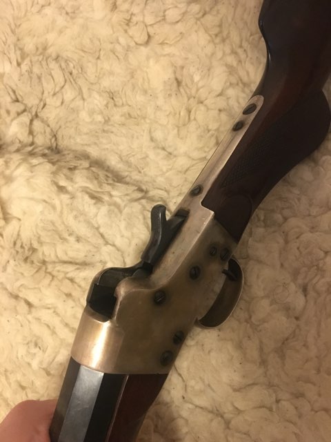

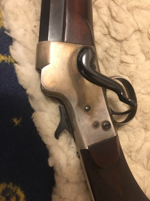

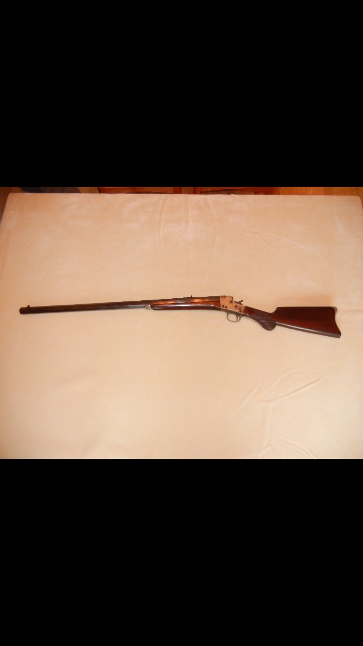

My son purchased this rifle and am looking for any information on it. Serial number is 3756.

Not 1876 since the Hepburn was patented in 1879, and first hit the Market in 1880 advertisements. Appears to be very evenly worn case colors, as the only place I see any left is under the lever. But beautiful anyway!
The lever is blued, which is unusual also. They were usually case colored, and that bluing looks so pristine it might have been blued later?

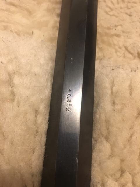

I am still learning to navigate this forum so let me add a couple more pictures. It has a full octagon barrel and the caliber is 40 2 1/2. I think. My son and I are trying to figure out everything about it. Thank you for any help.

.40-2 1/2 would indicate the .40-70 Sharps Straight. It is a caliber I see more frequently in Hepburn rifles than almost any other. A really great caliber, and one I enjoy shooting. No ammo available today, and brass is a bit expensive, and hard to find. But if you reload it can be made from .405 Win brass with a bit of work forming and trimming.
I've got two in this caliber, and they shoot extremely well once the groove diameter is figured out, and the correct sized cast lead bullet used.
