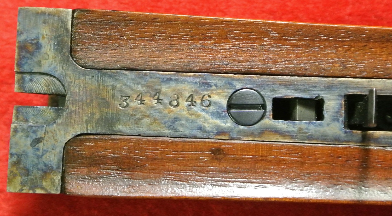

There was a discussion on another site and the question came up about forearm irons on extractor guns. We found plenty of examples of Model 1900 extractor forearm irons --
344846 05.jpg (494.13 KiB) Viewed 2626 times

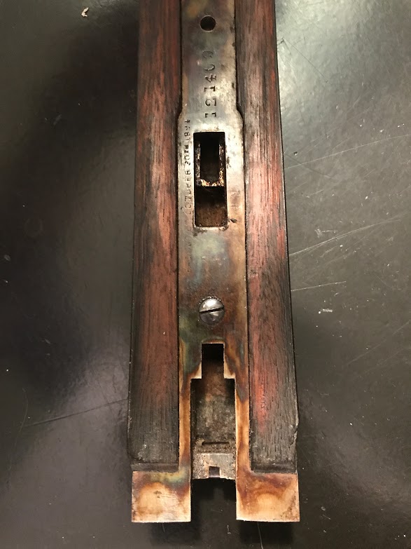

The extractor Model 1894s we could come up with all used empty ejector forearm irons --
121409 01 A-Grade.jpg (77.41 KiB) Viewed 2626 times
Any of you have or know of an extractor Model 1894 with a purpose built extractor forearm iron? I seem to recall seeing a C-Grade at Las Vegas several years ago with one, but I have no pictures or documentation.

All three of my 1894 extractor guns have ejector forearm irons. A quick look on Gunbroker found five extractor 1894s and they also had the ejector irons. Based on this relatively small sample, I'd say if purpose built extractor forearm irons were made they aren't the norm.
But I'll keep looking and let you know if I see one.

All of my '94s have ejectors so no help there. However, in the 1902 catalog copies sent to me by Art McKee several years ago all appear to show drawings of ejector type irons - no mention or showing of extractor type in the spare parts section.
