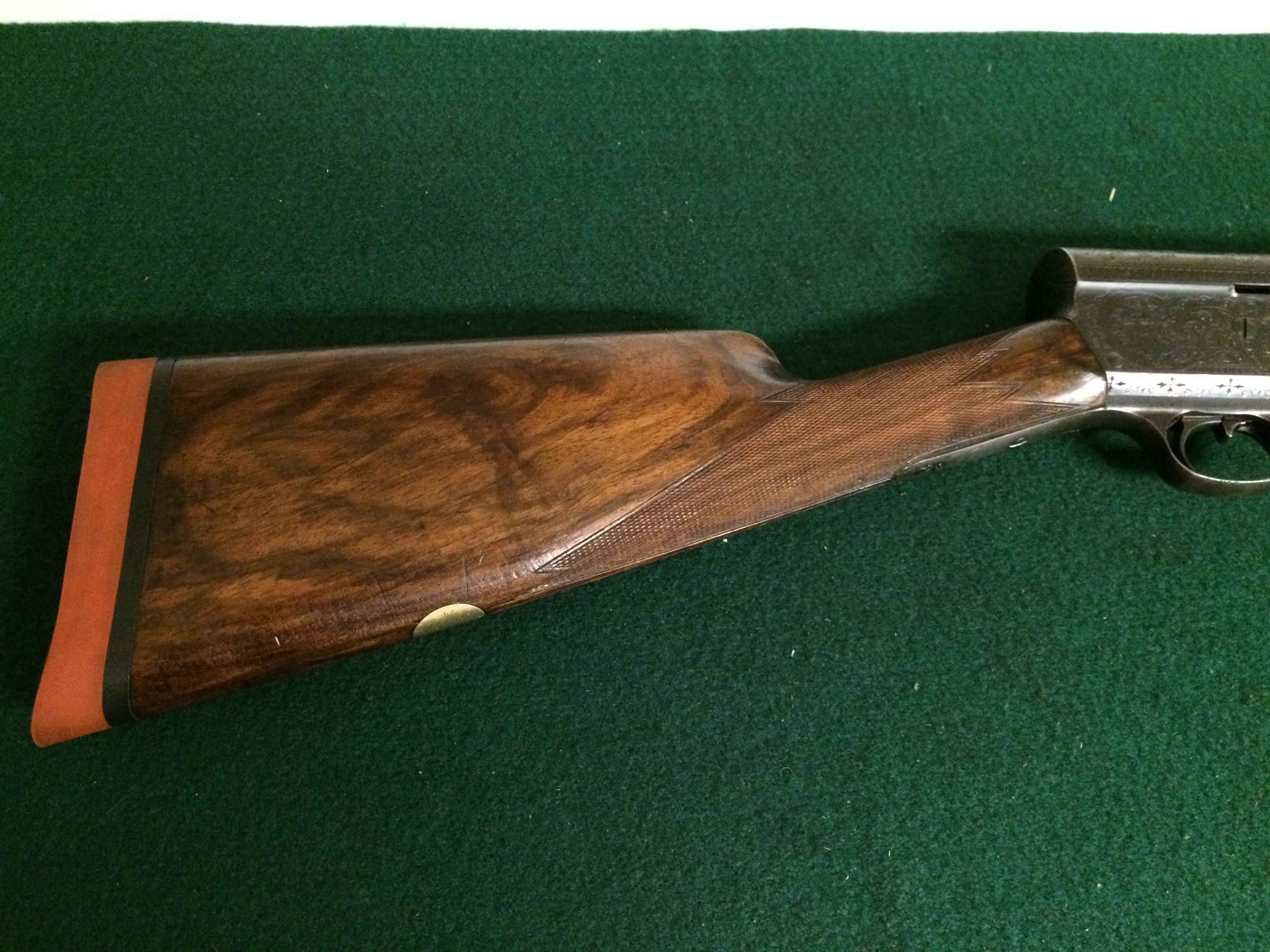

Mike,
I have used original Noshoc's with good success for look and pliability.
The new Silver's to my eye look too, "Top Heavy", too much pad to thickness of baseplate.
The older Griffen & Howe solid pads were a little better but are hard to find.
Will
AZMike
Posts: 130
Re: FE Trap restoration
Post by AZMike »
Will, that pad looks terrific on that ol'humpback!

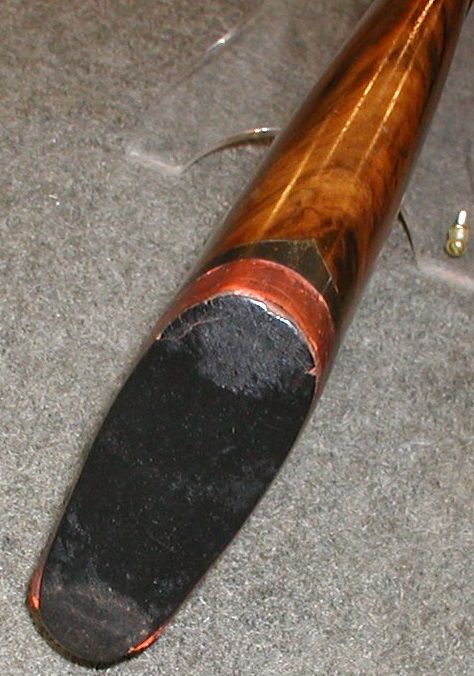

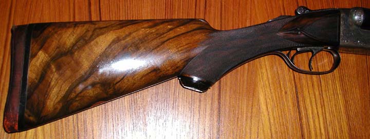

I believe this spurred, leather-faced, Silvers is original on my DEO-Grade 16-gauge --
P132280 08 16-ga DEO-Grade stock left 8x10.jpg (58 KiB) Viewed 12817 times
P132280 09 16-ga DEO-Grade stock right 8x10.jpg (52.89 KiB) Viewed 12817 times

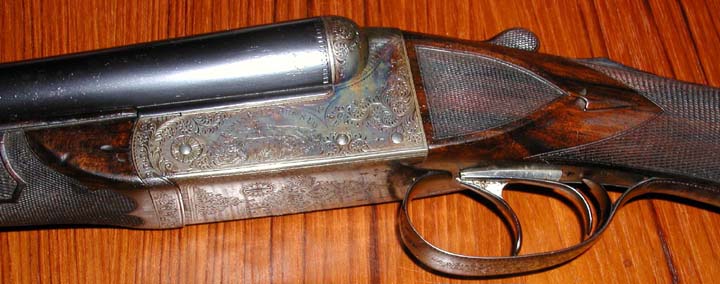

Here are a few more pictures --
P132280 18.JPG (128.46 KiB) Viewed 12805 times
P132280 12 DEO-Grade 16-ga left 8x10.jpg (62.19 KiB) Viewed 12805 times
P132280 11 16-ga DEO-Grade trigger plate 8x10.jpg (70.81 KiB) Viewed 12805 times
P132280 04 16-ga DEO-Grade forearm 8x10.jpg (48.05 KiB) Viewed 12805 times
Fowlgunner
Posts: 198
Post by Fowlgunner »
Wonderful gun Dave!
Mike I completely forgot about the spur.
That makes things a little more interesting for sure.
Not sure how I would approach but I bet it would be expensive since most of my cranky nuances are!
Let us know what you decide.
Will

Thank you for the photo posting. I don't think that graded Remingtons give up much to the Foxes and Parkers!
