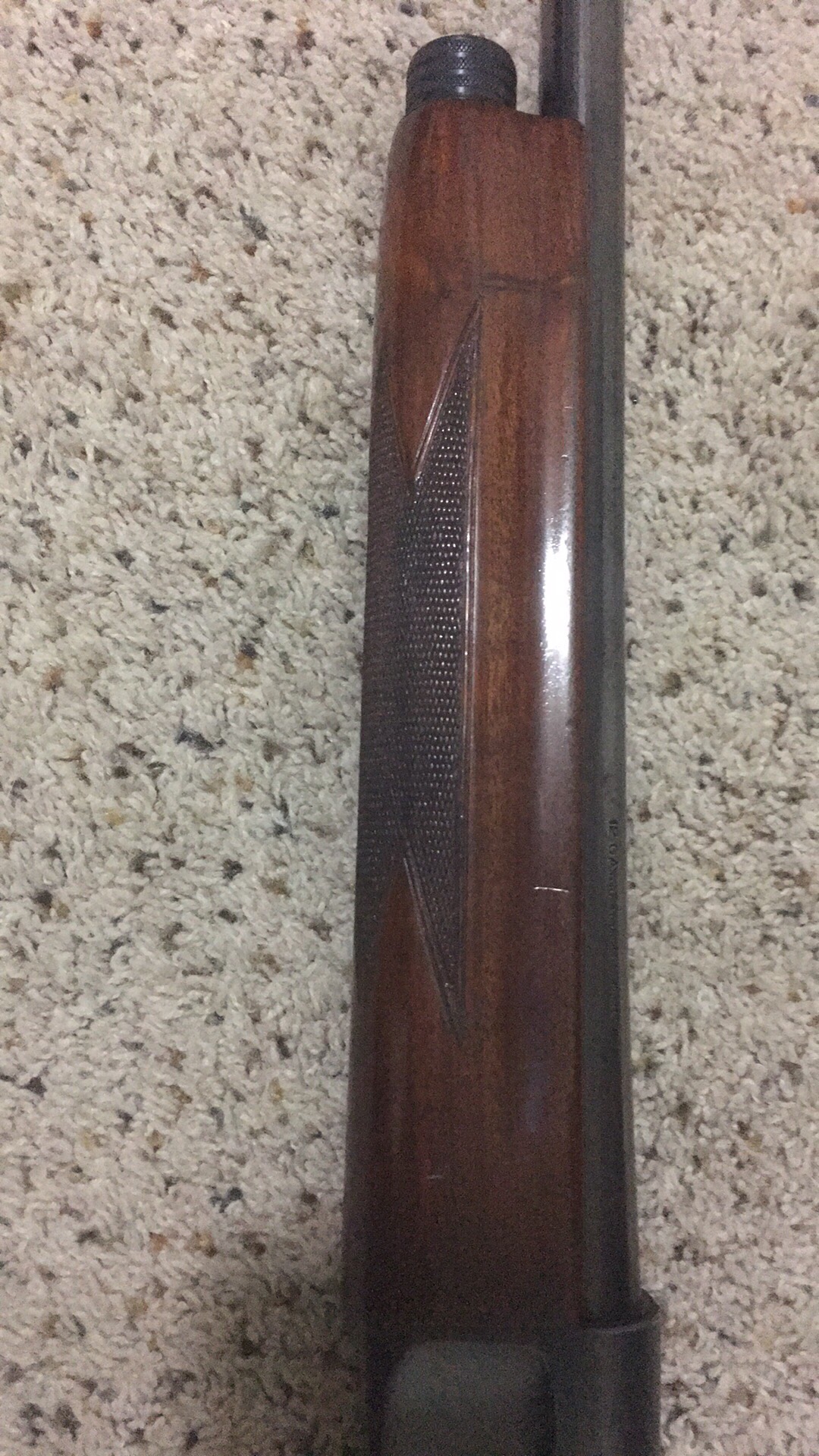

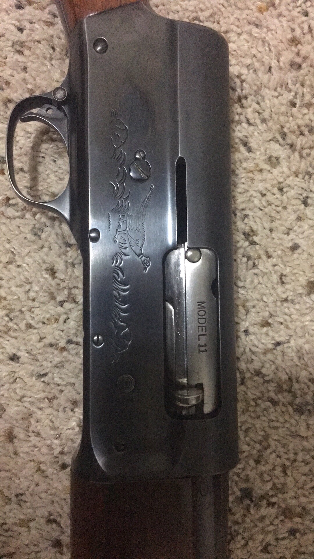

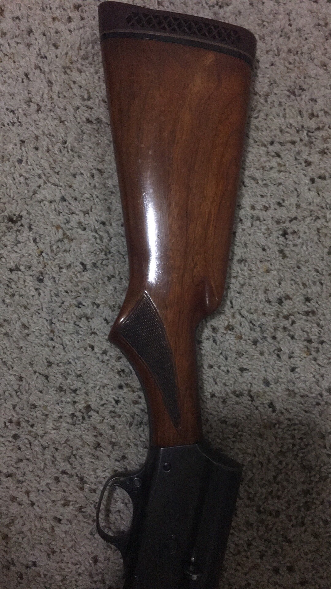

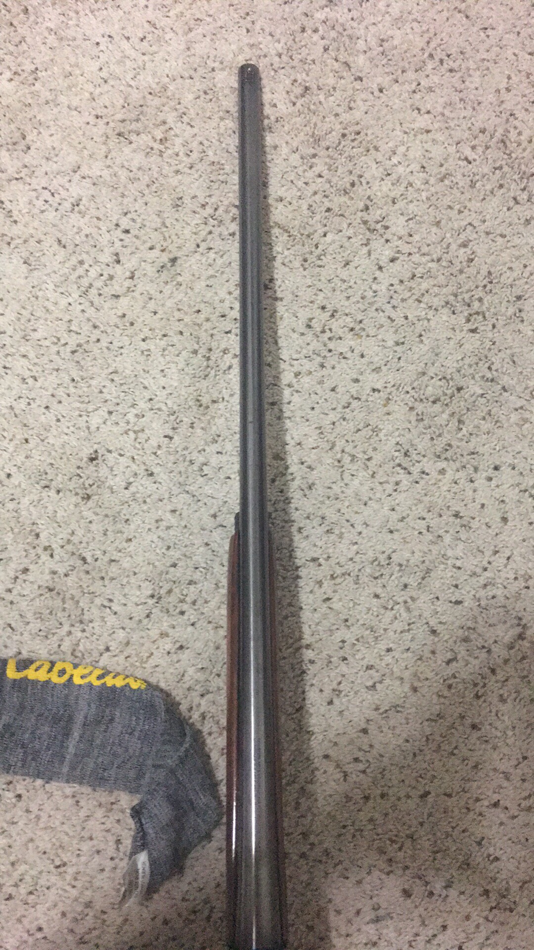

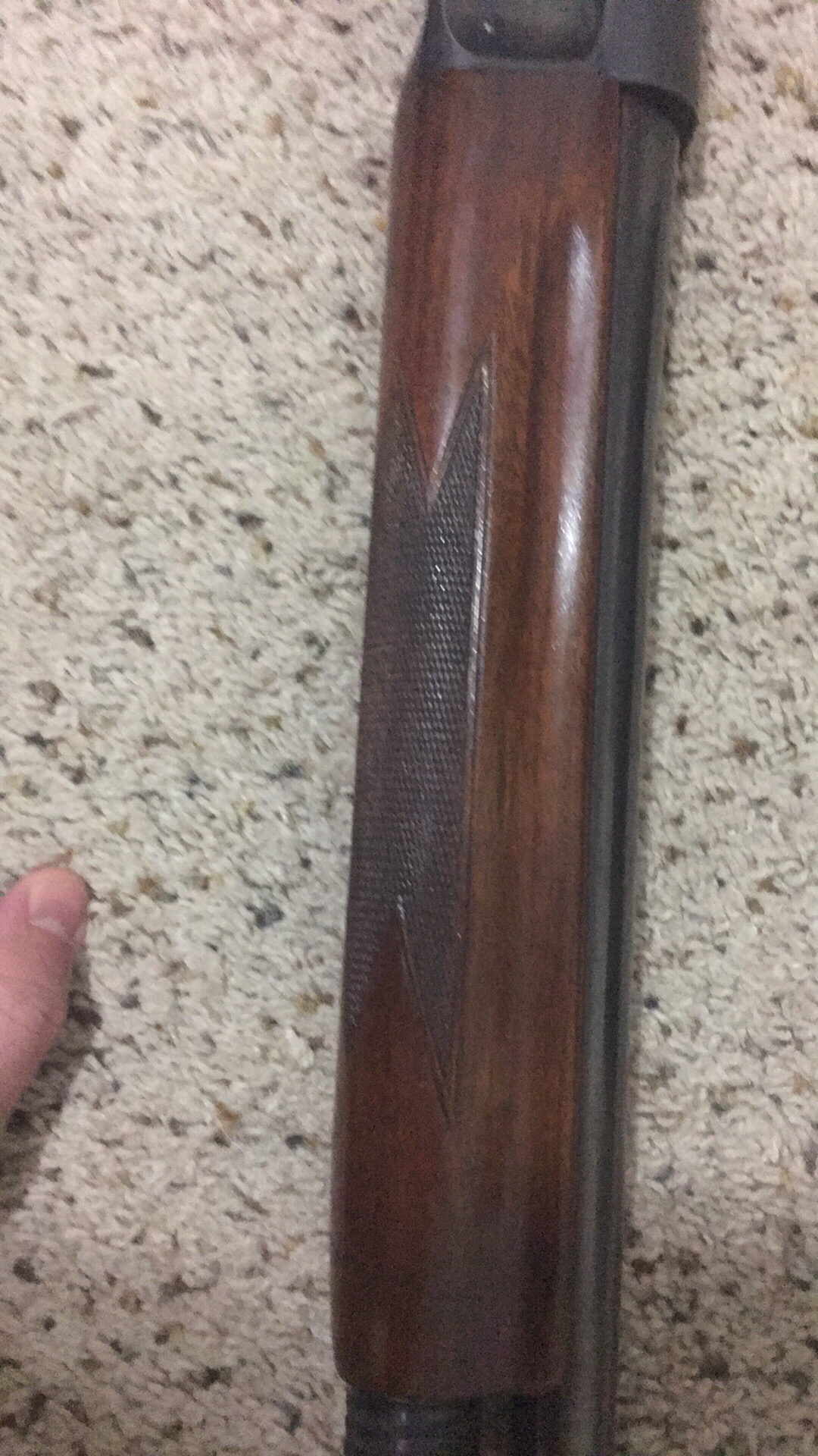

Hey guys have a model 11 with serial number 714412. Date code on the barrel reads APP. Brrel is also stamped FULL. I am just looking to determine whether this is an A or B grade model 11. I’m also wishing to learn how to tell the differences.

The receiver with serial number 714412 was put in work during March 1944. The barrel date code of APP is March 1945 -- A = March PP = 1945. The gun is a Model 11A "Standard" Grade.

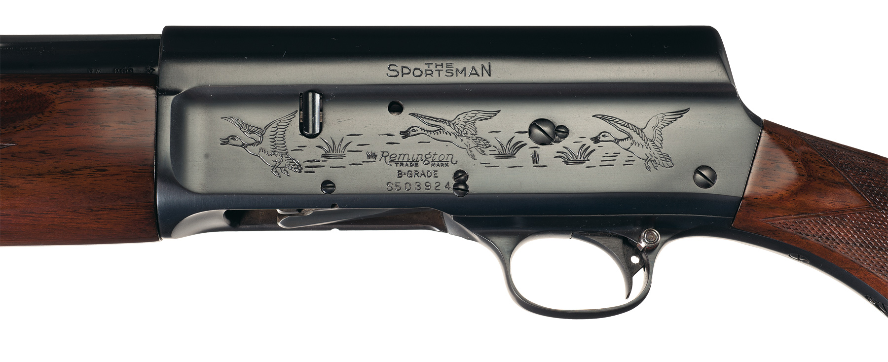

From the introduction of Remington's John M. Browning designed autoloading shotgun in 1905 to the late 1920s, the Model 11A "Standard" Grade had a plain blued receiver and and plain uncheckered wood. The Model 11B "Special" Grade had a checkered, European Walnut, stock and forearm. About 1928 or 9 when the Model 11 got the cross-bolt safety behind the trigger, the Model 11A "Standard" Grade got checkered American Walnut wood. Circa 1937 Remington Arms Co., Inc. went to using the same receiver with the one-bird roll-stamping on both sides for the Model 11 and the "Sportsman" and dropped the seperate serial number sequences for the "Sportsman". A B "Special" Grade was marked B Grade on the left side of the receiver --
