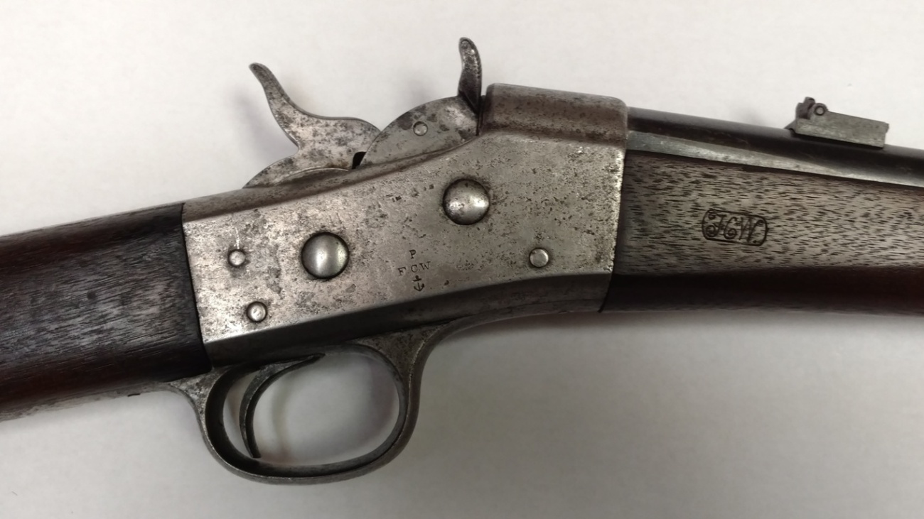

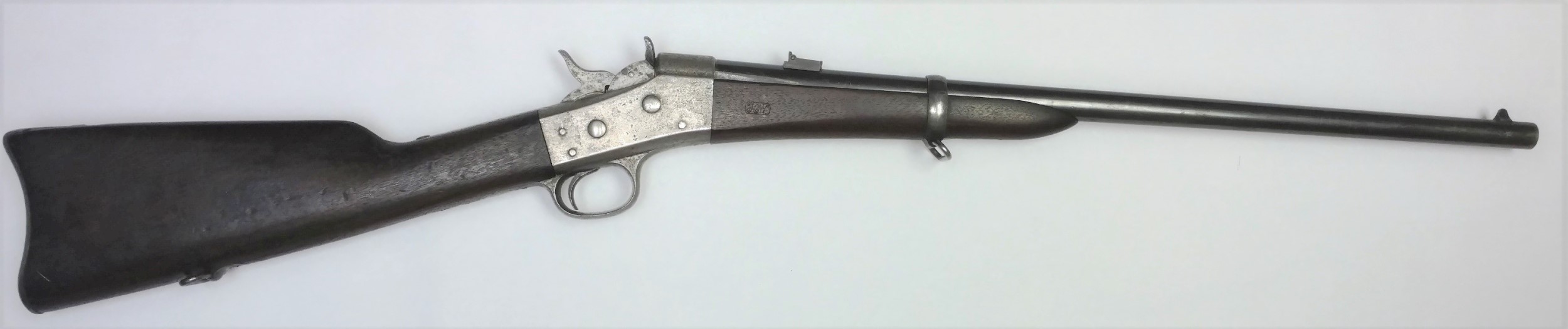

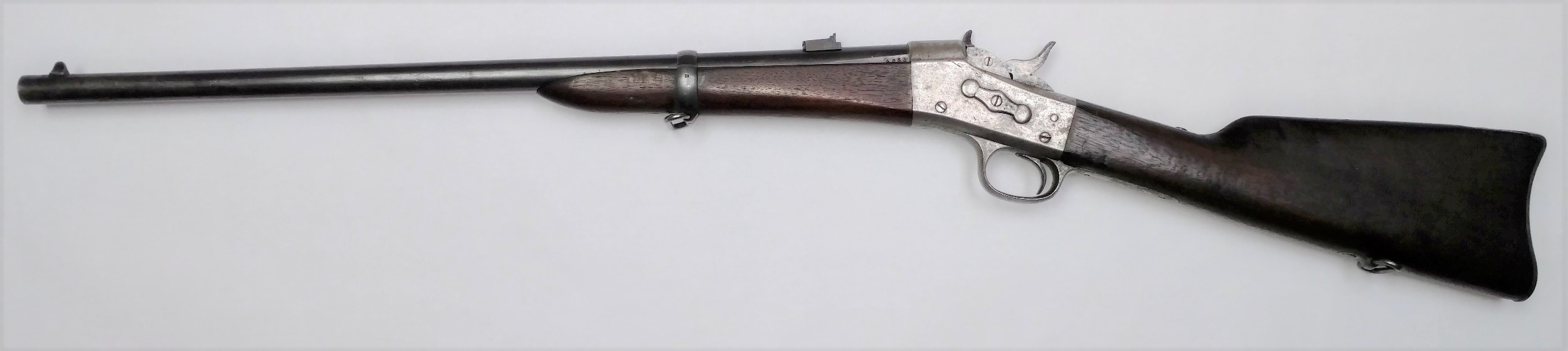

Here are some photos of the 1867 Navy Carbine, they were not marked with KM on the receivers.

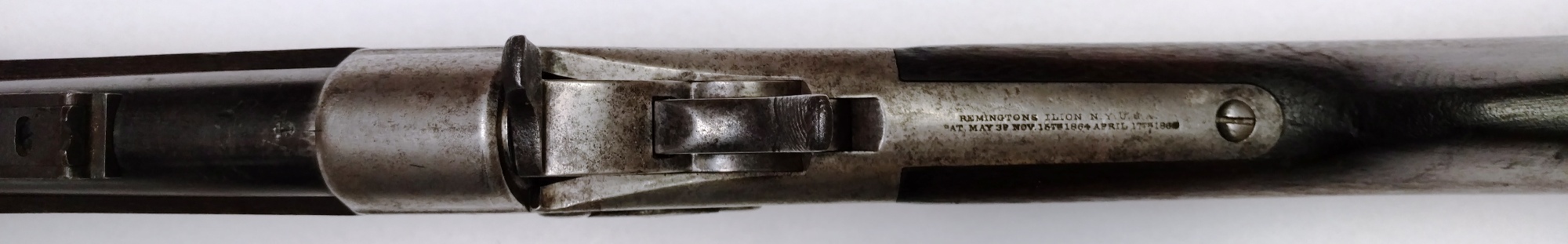

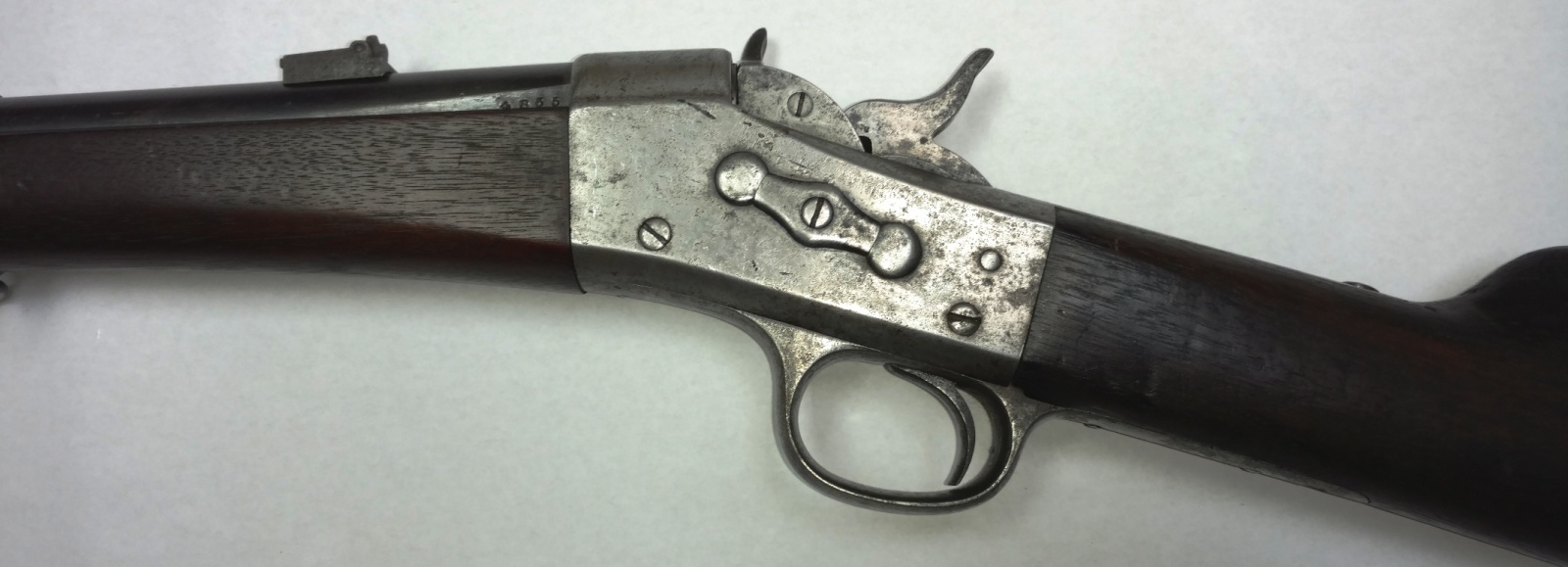

Photo showing the patent dates on the receiver.
photo 6 - Copy.jpg (175.17 KiB) Viewed 5163 times
