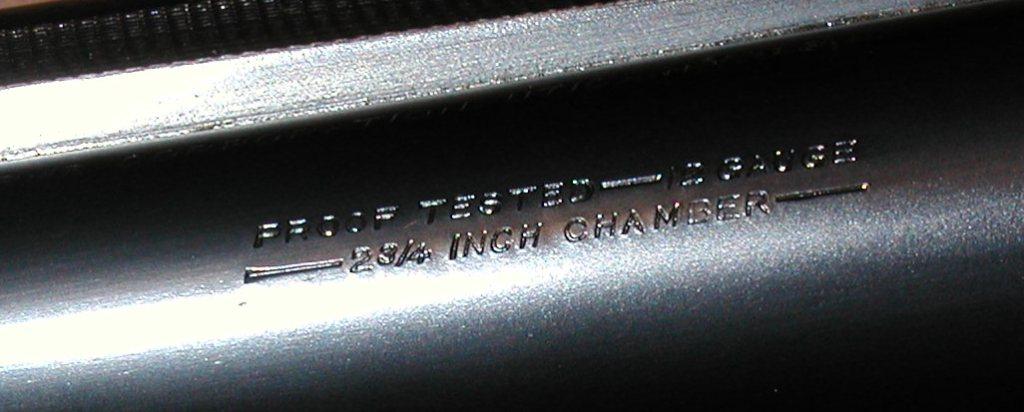

The SAAMI meeting where it was suggested that manufacturers begin marking chamber length on their shotguns was in 1937. I have Remington "Sportsman" autoloaders and Model 31 pumps from 1936 and 1938 that just have the gauge marked but ones from 1941 and later also have "For 2 3/4 inch or shorter shells".
This marking began appearing on Ansley H. Fox doubles made by Savage during 1938 --
Proof Tested 12 Gauge.JPG (68.3 KiB) Viewed 4365 times
Savage also placed it on older guns returned for service that were reproofed.

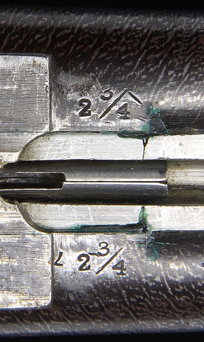

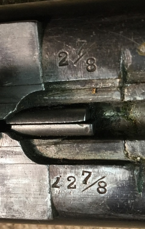

Even though there was no requirement for chamber length markings, Remington Arms Co. did mark the chamber length on their Remington Hammerless Doubles when the customer requested a 12-gauge chamber length longer then 2 5/8 inch. Parker Bros., A.H. Fox Gun Co. and Ithaca Gun Co. didn't seem to bother with this, though they all offered longer chambers for no extra charge. On Remington Hammerless Doubles the length was stamped on the bottom of the barrel tubes, just forward of the barrel flats --
123247 24 Chamber Length Markings close up.jpg (145.28 KiB) Viewed 4356 times
121252 07 DEO-Grade 2 7-8 inch markings close-up.jpg (132.71 KiB) Viewed 4356 times
