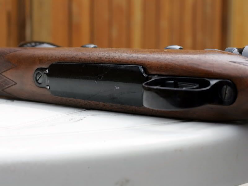

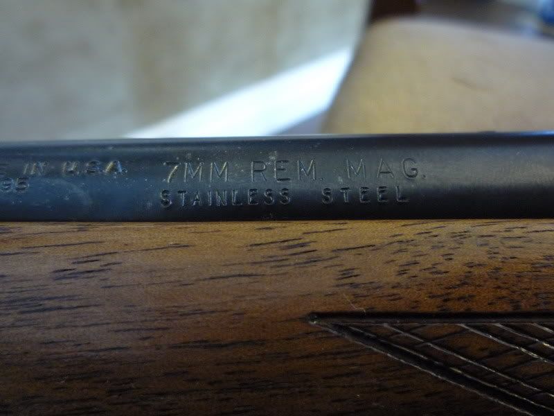

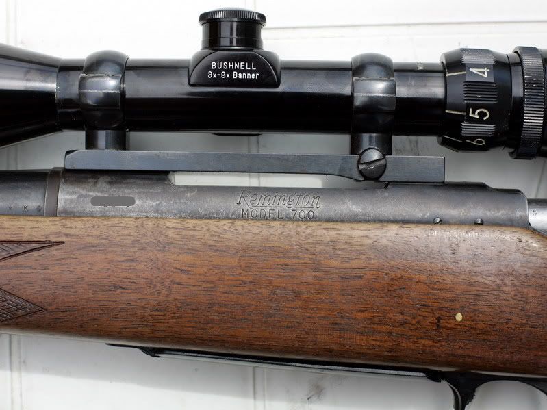

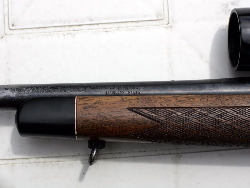

I've ran across a model 700 in 7mm rem mag and its the first time I've seen one before.
It has a blued barrel and action but it has the words "stainless steel" stamped on the barrel.
Im wondering if this is just a stainless barrel or if the action is stainless as well. I know its in rough shape but I was thinking maybe I could use something to remove whats left of the bluing or glass bead it to clean it up a bit. The bottom metal is clearly not stainless so it might require blasting and finishing with a coat of something like ceracoat or armacoat.
My main question is, is the action stainless steel or just the barrel?
The seller has blocked the serial number in the pictures but any information on this rifle would be greatly apprecaited. Here are a few pics of the culprit.

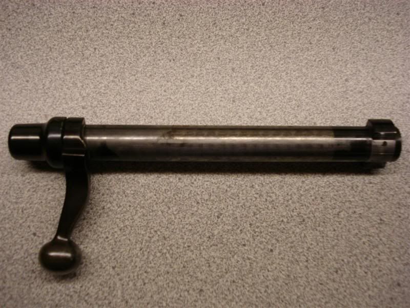

the reason I thought it was quite a bit newer was the bolt handle.
I have an 1983 model 700 and it has a smooth bolt handle without any checkering.
Update:
I recieved this response back from Remington this morning.
Prior to 1971 our magnum calibers had stainless barrels. The barrels were finished in a process referred to as Japan black which was basically a painted finish. The rest of the rifle was carbon steel. So, your Model 700 pre dates 1971. Thanks!

The picture of the bolt. Is that the same bolt that is in the gun. By time you invest all the time and money in making a gun that you probably wont get the money you paid for it you might as well buy the stainless gun. It sounds like that is what your trying to make this one into. If the appearance is that beat up whats done to it that you can not see. This is just my opinion, and it doesnt meen much. Its your money. Also the stock is not the original stock. And the unoriginal stock has a poor refinish job. I have a feeling it does not shoot good anymore.
The picture of the bolt is from an 1983 ADL in 30-06 I have. I bought it from a friend for pretty cheap and i'm going to actually rebarrel it myself as part of a machining course at our local college. Going to built a 25-06 from the action. I've already spun off the old 30-06 barrel.
