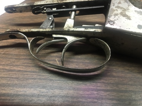

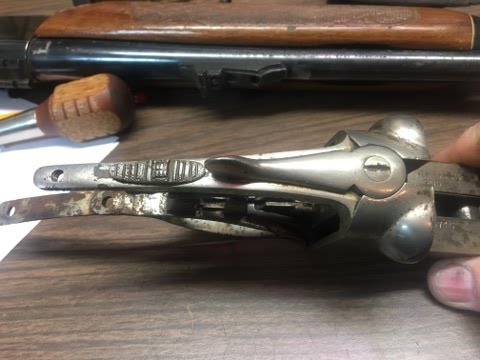

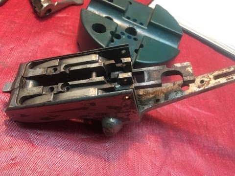

More photographs of the firearm that I am re-building.
IMG_5445 (1).jpg (57.28 KiB) Viewed 8849 times
Walz
Re: Anyone have any information about the 1894 1900 shotgun?
Post by Walz »

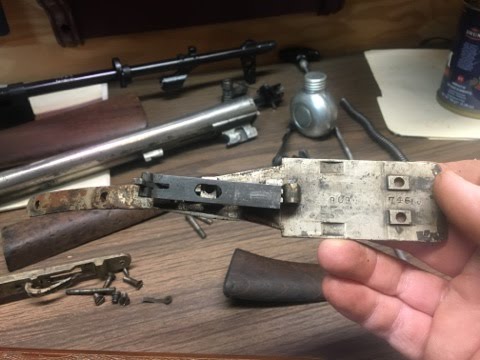

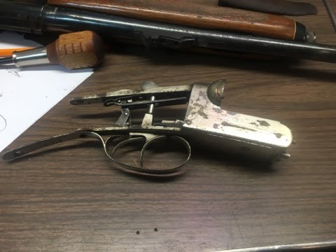

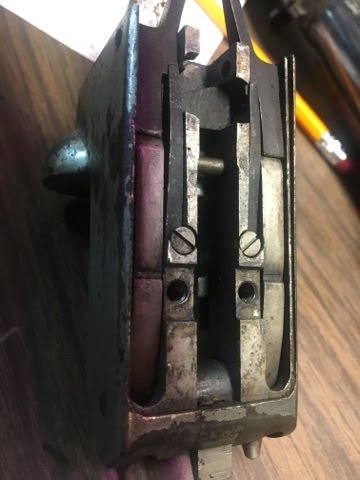

:cry: Can anyone tell me what this safety plunger does???
Bluing is what I want to do to the finish. The forend is salvageable, the stock looks like shit, pieces are missing. It locks up real tight so that's not a problem, the barrels are steel so that's a plus, better than the other barrels, and I don't know much about the older shotgun shells except that they were shorter, and the newer manufacturer shells are to much for the barrels so I'm buying the old style shotgun shells. :idea:

From the S/N, your 1900 K grade was made in 1901. Two versions of the K grade were offered at that time. Your plain K grade has steel barrels and extractors while the KED has damascus barrels and ejectors and cost about $10 more. Later, 1903, the KD was offered followed by the KE in 1906 or so. So, in total there were four versions available -- K, KD, KE & KED depending whether or not they had ejectors vs. extractors or steel vs. damascus barrels. Your gun should be stamped with a K on the barrels.
The production of all SxSs (1889, 1894 & 1900) ended in 1910 as Remington saw the pump and auto loader as the future.
As they came from the factory, all K grades (and 1894s) were color case hardened. However with all things Remington some had blued trigger guards/top levers (?) and others didn't. There are smiths out there that do very good work and I've had several refinished with wonderful results.
The safety plunger (mounted on the trigger plate) moves the safety to the SAFE position when the gun is opened.
The 1900 and 1894 are nearly the same gun. The 1894 has a Purdey style forearm while the 1900 has a simple snap on.
You haven't mentioned barrels but they should be cold blued as the hot dip method tends to eat at the solder and you end up with two separate barrels -- not good.
As for chamber length -- it is 2 5/8". Most of us use standard 2 3/4" plastic shells and low pressure loads - plastic case thickness is much less than the paper case used back then. There are also reams available to modify chamber length.

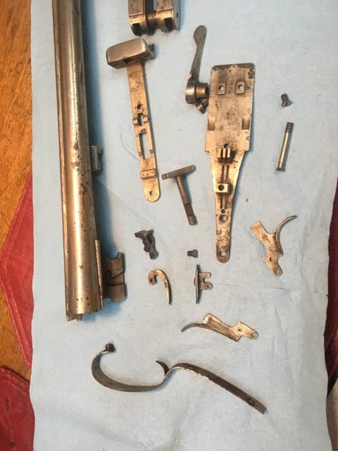

I really need a diagram illustrating the parts installation, I have detailed pictures of my disassembly, however I have a two chingaderas that fell out during disassembly and they are broken. So I really need something that is a diagram. I have worked on many of firearms, and everyone is different, no one can just put a firearm in a standard category, they are unique, really unique, and no one can expect a gunsmith to know every firearm, I can put this together, however the time would be double since I don't have a diagram, I was just hoping to find one.

Which parts are broken besides the top lever spring? From your pics almost everything seems to be there. I don't see the safety plunger spring. It's a small flat spring that mounts to the wood with a very small wood screw and keeps the plunger in place.
As for assembly instructions -- there isn't any source that i'm aware of. It's been a year or two since I've taken one down but it's basically just the reverse of disassembly. Can't remember any "tricks".
Yep - cold rust blueing for the barrels.

dieNusse1 wrote:Which parts are broken besides the top lever spring? From your pics almost everything seems to be there. I don't see the safety plunger spring. It's a small flat spring that mounts to the wood with a very small wood screw and keeps the plunger in place.
:!: "safety plunger spring" That's got to be it, the stock is broken at the neck so it's the safety plunger spring. Thanks
