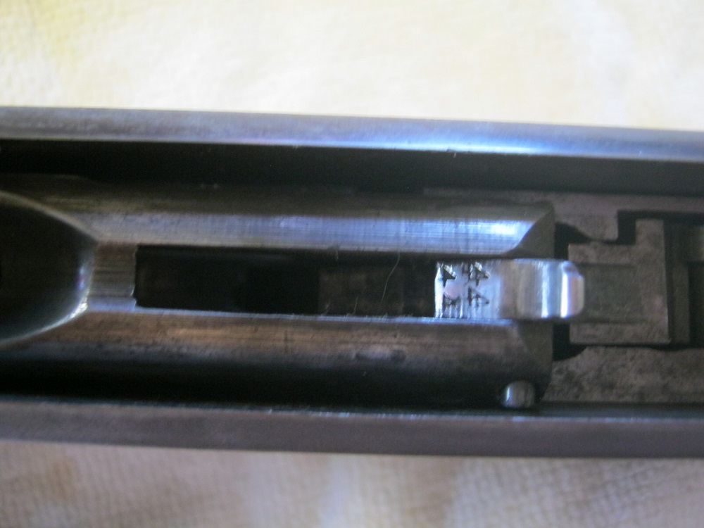

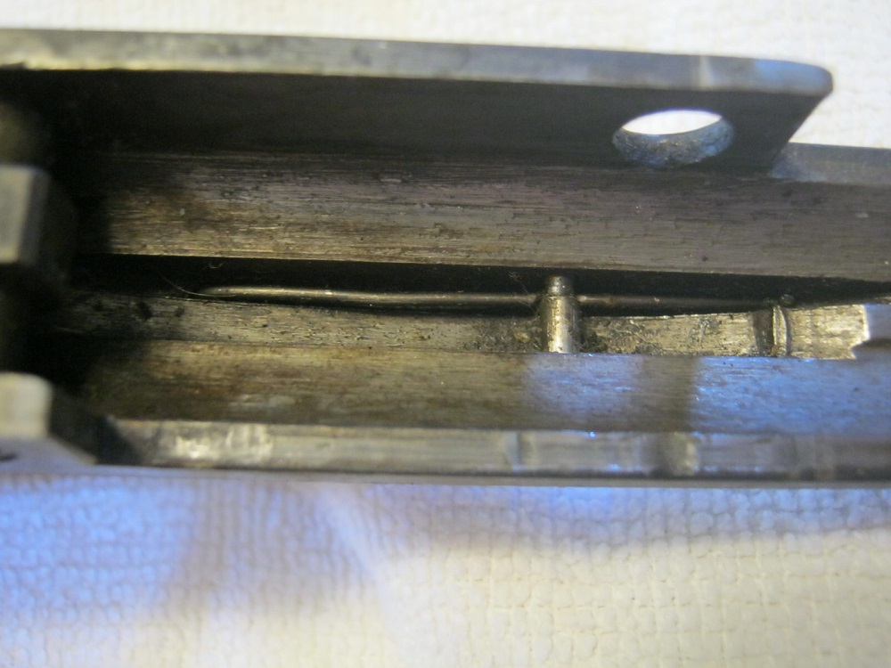

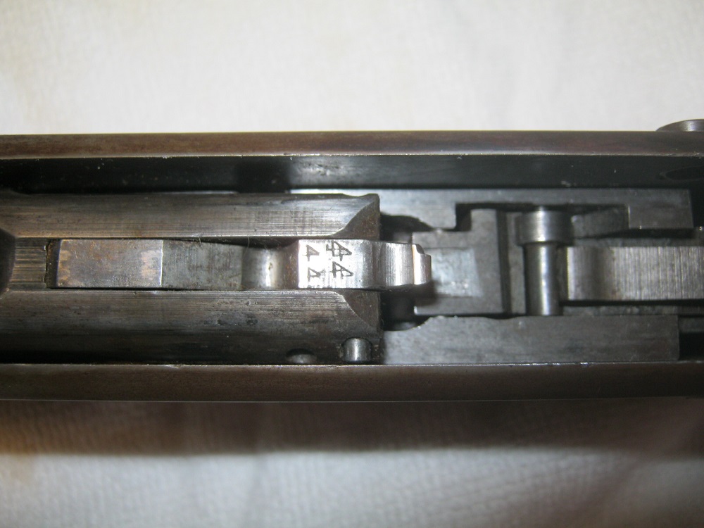

ok just got around to checking out the carrier dog,I have included a few pics to see if I am looking at the right thing,the first pic is the part I am thinking you are talking about and when pushed down it does not spring back up.I then took it down and showed a full pic of the part,on the carrier dog assembly there is a slide on the side that goes back and forth when pushed and that does spring back.So my question is am I looking at the right part and if so it looks as if a spring is missing and any idea as to a part number or actual name of the spring I need.Thanks again

cmax
Re: Model 14 1/2 .44 rem.
Well I think after looking at a schematic on numrich I may have figured it out? It looks as if the carrier dog spring is broken and the carrier dog is missing? Not sure but if anyone see's something different that I am missing I would appreciate your in put.Thank you.
The carrier dog spring is "shot" and the carrier dog is totally missing.
I replace these on a regular basis if you want to send the guard to me for repair.
I charge $53 including the return postage plus parts which would be about $25. I can install the stuff properly but no way of telling how it works without the entire rifle, chances are it will be just fine....................it sure isn't going to work the way it is and I diagnosed it for free!
