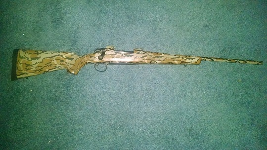

I just done some trading and got a good deal on a early 90's Remington 700 factory dipped Mossy Oak Bottomland rifle in .280 caliber. I've decided to keep this rifle and do some deer hunting with it. I went to the local sporting good stores to buy ammo and no one has any. I get online and find that most ammo dealers don't even have it, especially the 140 gr. Remington Accu-Tip or Federal Premium 140 gr. Nosler Ballistic tip. Well I decided I would just hand load me some 140 gr Nosler Ballistic Tips and be done. Well. now I can't find any brass! Have I made a mistake trading for an excellent caliber rifle that no one makes brass or ammo for anymore? Any advice or suggestions would be greatly appreciated.
