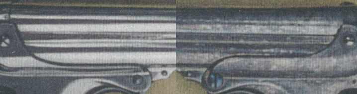

They made little over 10,000 5 barrels and nearly 26,000 4 barrels starting at 1 serials for each, not mixed, not batches.
There's also two frames on the 4 barrels from all my "watching" I guess some would call research they change somewhere around 18,000 where the side frames were lowered.

Here's a frame line up I took after several people told me I was crazy, once you see it, it's obvious
- Elliot_line_up.gif (124.82 KiB) Viewed 1786 times
