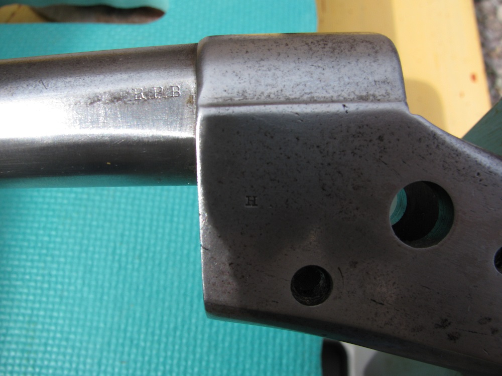

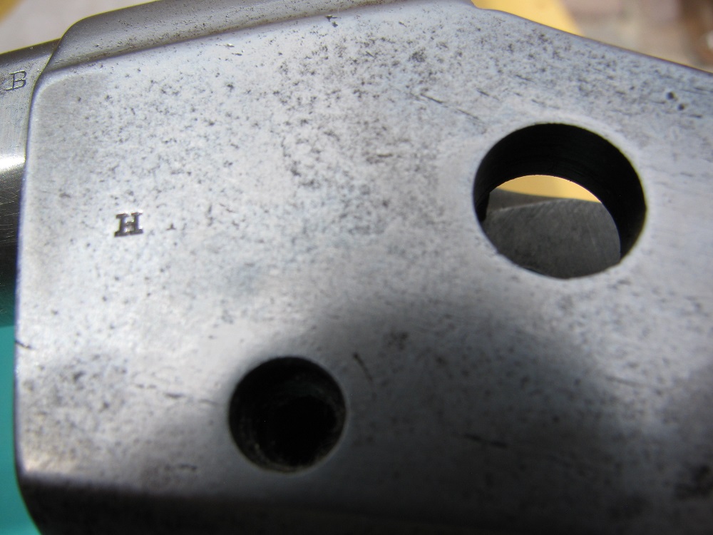

Attaching files for RB #1.

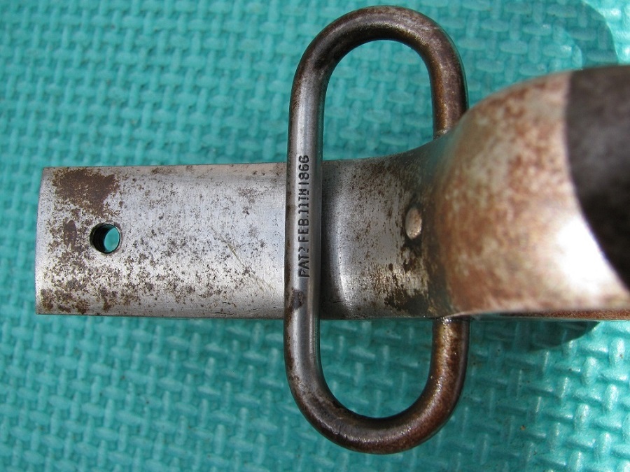

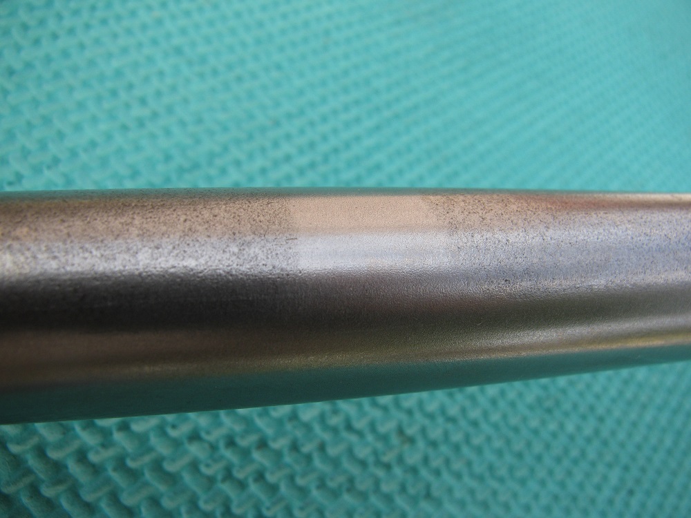

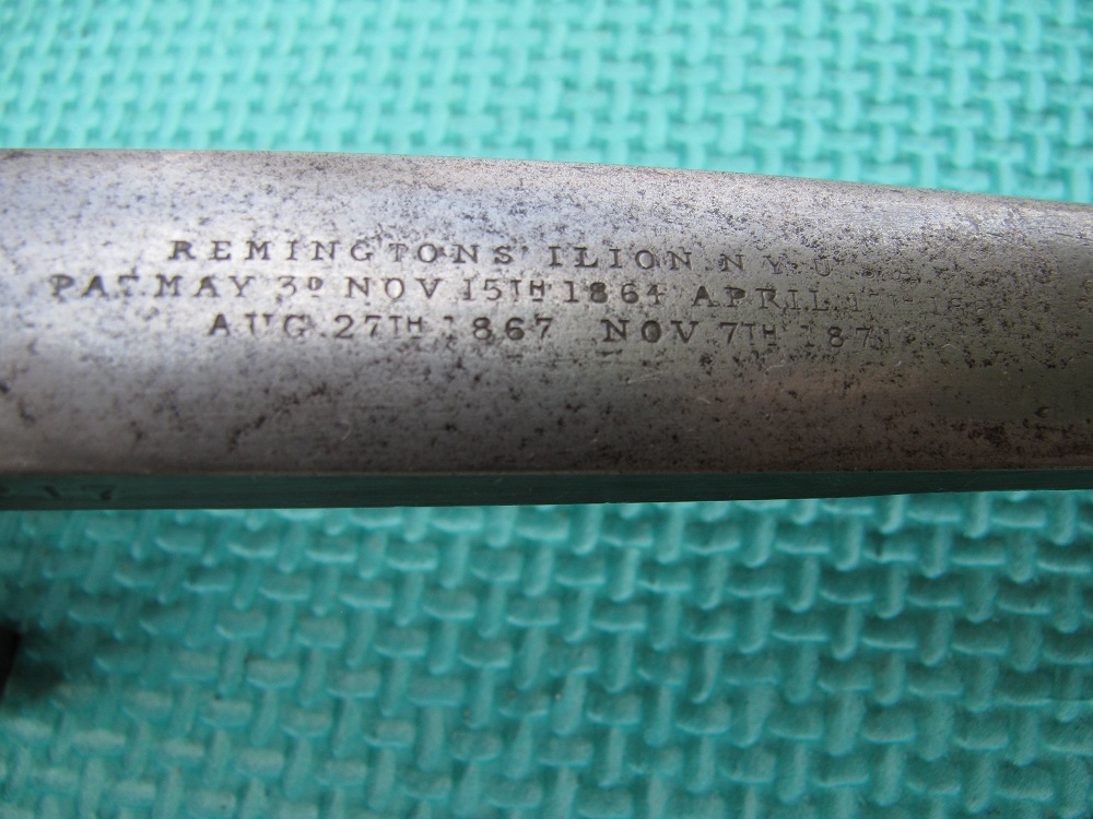

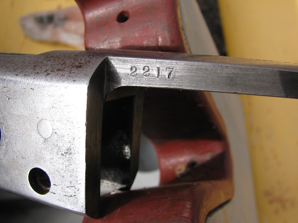

More Photos Re: NYS Rolling Blocks ?s on "Tinned" finish
These are some more since the max is 3 per post.
- IMG_3718.JPG (211.76 KiB) Viewed 4936 times
- IMG_3715.JPG (222.34 KiB) Viewed 4937 times
- IMG_3714.JPG (206.49 KiB) Viewed 4937 times
Re: NYS Rolling Blocks ?s on "Tinned" finish New PHOTOS ADDE
Good photos. The frame does look buffed/smoothed as if either worn or inexpertly prepared for plating. The finish is now matte, not shiny as if polished. However, I cannot tell from the photos whether there is "plating" -- no obvious flaking is shown. Maybe others on this forum can comment from their own experience.
Looks to me like the well-weathered remains of an original "in the white" (in Springfield terms, "National Armory Bright") finish.
In other words, I see nothing remarkable. That said, pictures are only pictures, and there can be nuances which are only visible by actually handling something, rolling it around at different angles, etc.

NYS Rolling Blocks ?s More added to this thread
Thanks for all the info on these RB's as I was confused about the references in the RRBMR to the NYS rifles being made with a "Tinned" finish. Thanks guys for letting me get educated on the actual 'In the White" finish used on most of these. On this NYS RB the areas under the the rear sight and barrel bands were in the original "In the white" finish so I had some ideas of what the remainder should be like. That's when I soaked the barrel in rags of Ballistol and water to soften the surface oxidation"rust" and most just wiped off and then a rub down with simichrome polish to bring back most of the original finish. I am just about ready to reassemble this one and will add some pics when it's done.
