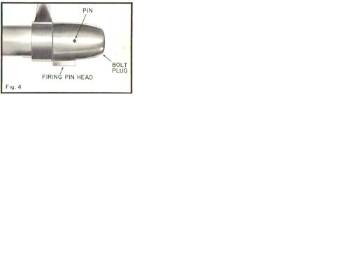

These are the directions from the owners manual, I have attached a file of Fig.4, I hope this helps.
Dick TO COCK BOLT—Bolt must remain cocked to put into rifle. If bolt “uncocks”, firing pin head will snap forward into cocking cam in rear of bolt. To cock bolt, hold firing pin head (Fig. 4) firmly to prevent movement. Use vise jaws if available. Raise bolt handle. Bolt will cam cocking surface (beneath handle) against firing pin head. Continue raising handle until cocking detent on rear of bolt engages firing pin head. Bolt is then cocked and ready for re-entry to rifle.

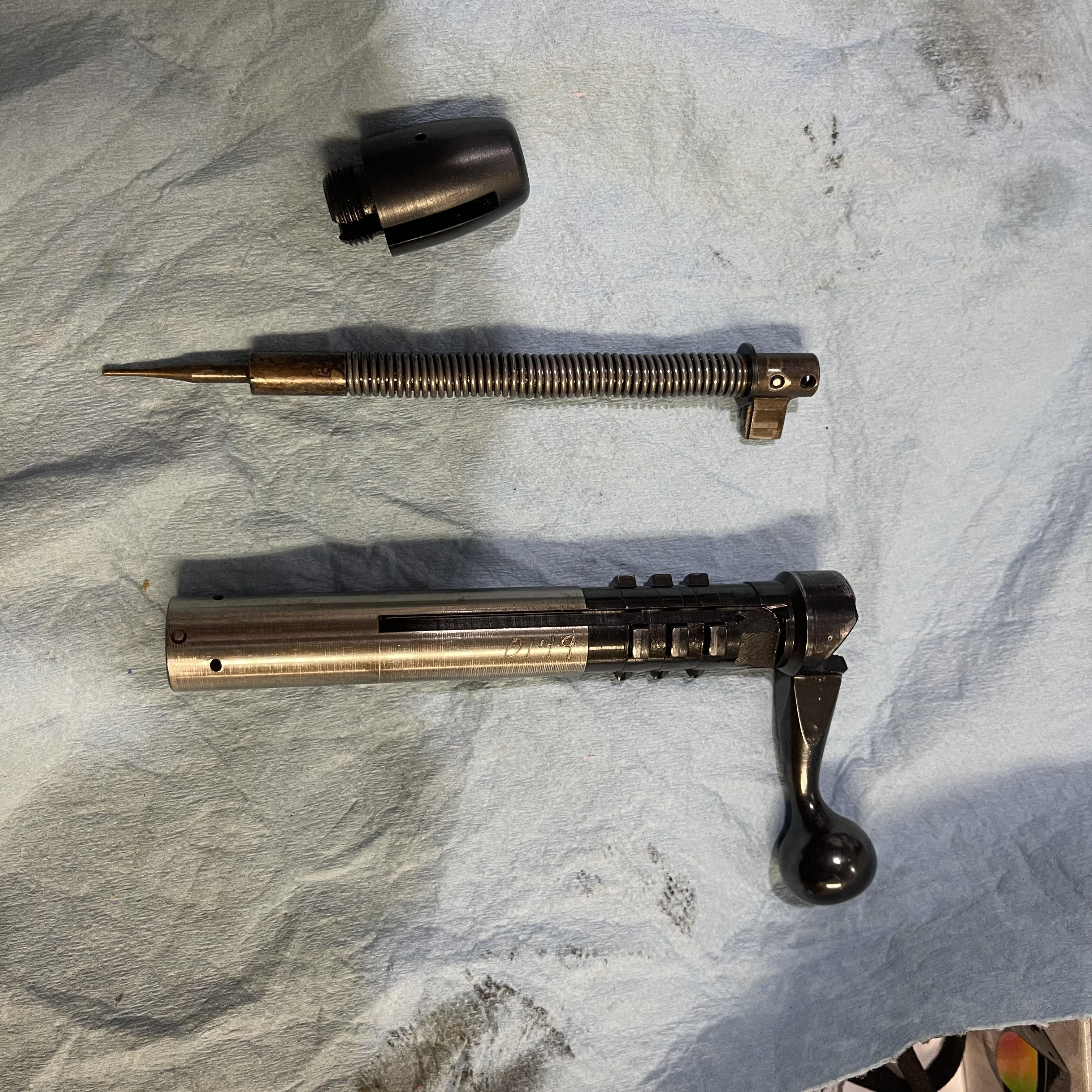

push firing pin in, load spring up, stick a punch small enough to fit through the rear hold, crank back onto the bolt assembly. done.
- bolt.jpg (1.4 MiB) Viewed 3822 times
