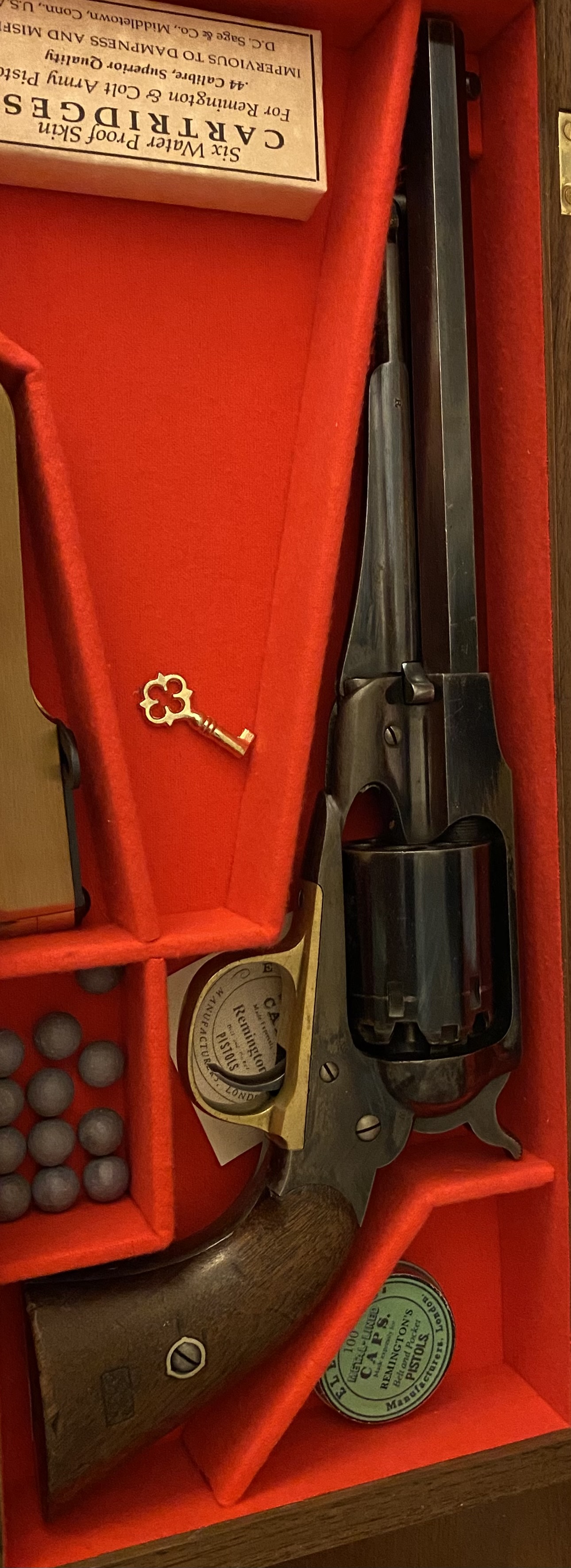

Post by Stewart1703 »
Picture of the gun is attached I will try and take photo of mark on the handle

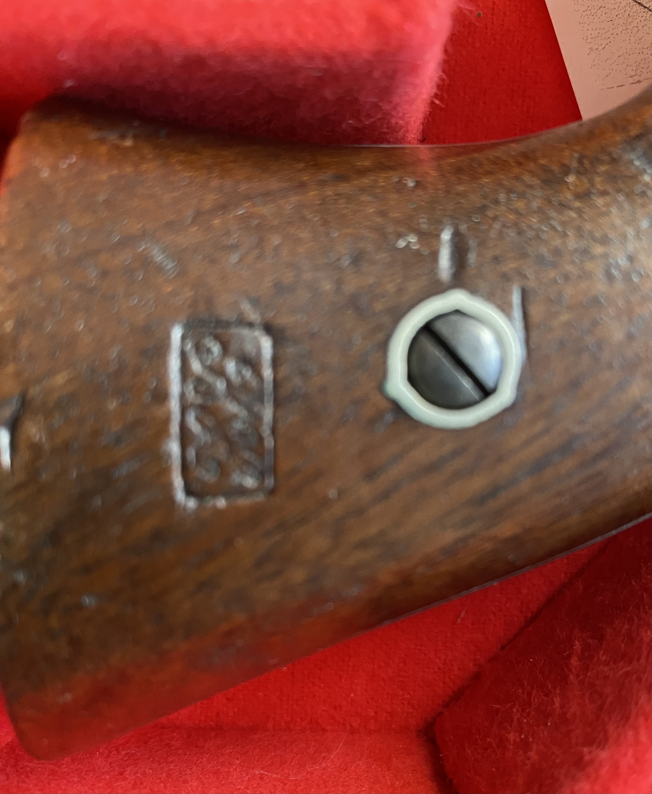

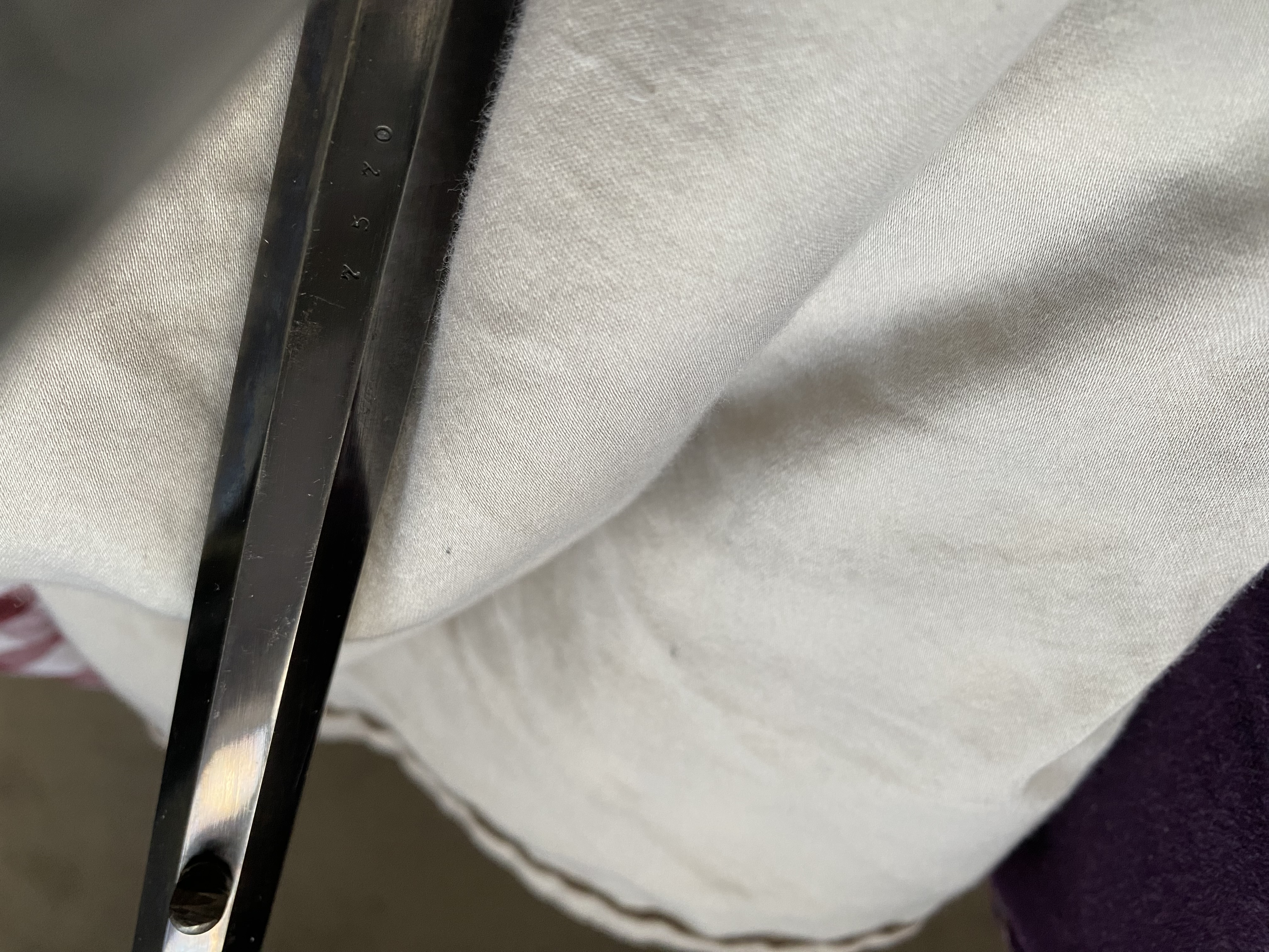

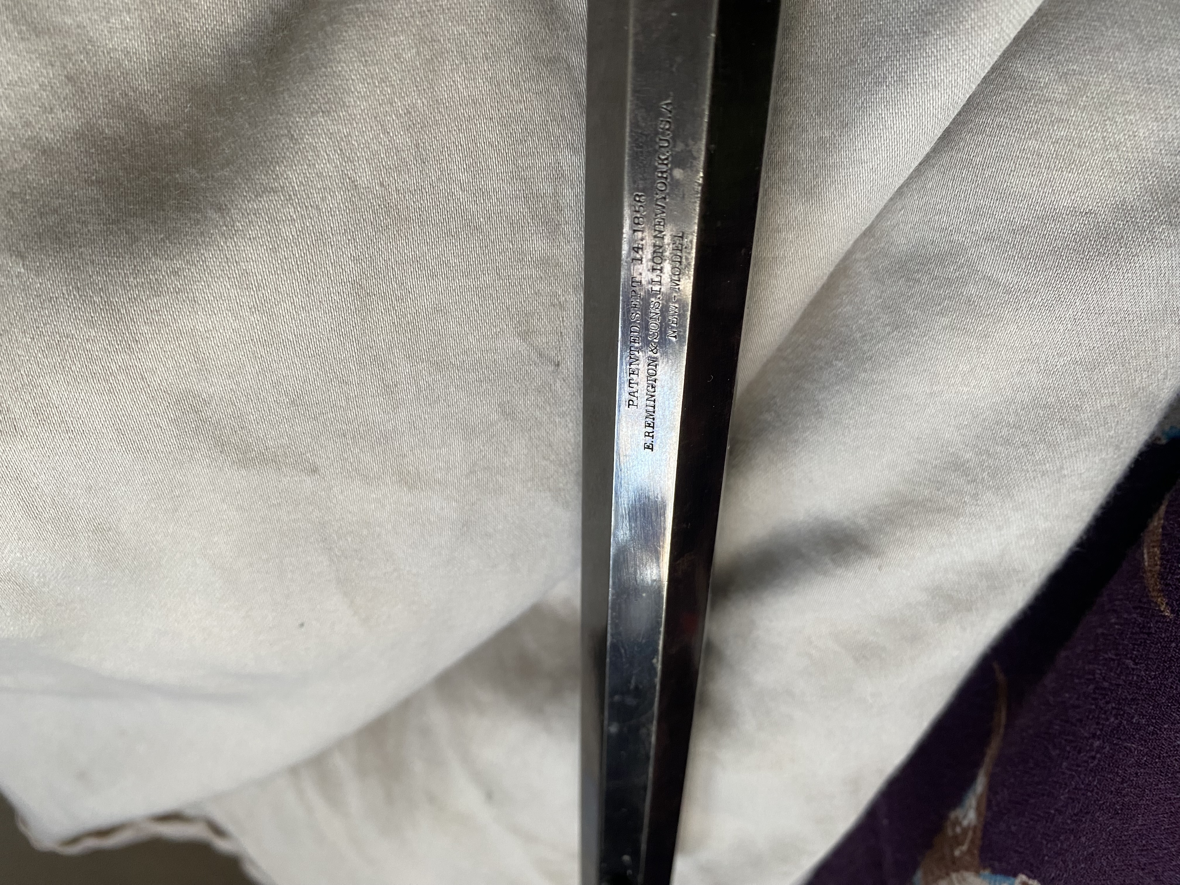

Picture of serial number under the barrel and mark on handle
Also picture on top of barrel
dieNusse1
Posts: 497
Location: Washington, IL
Re: Dating 1858 Remington
Post by dieNusse1 »

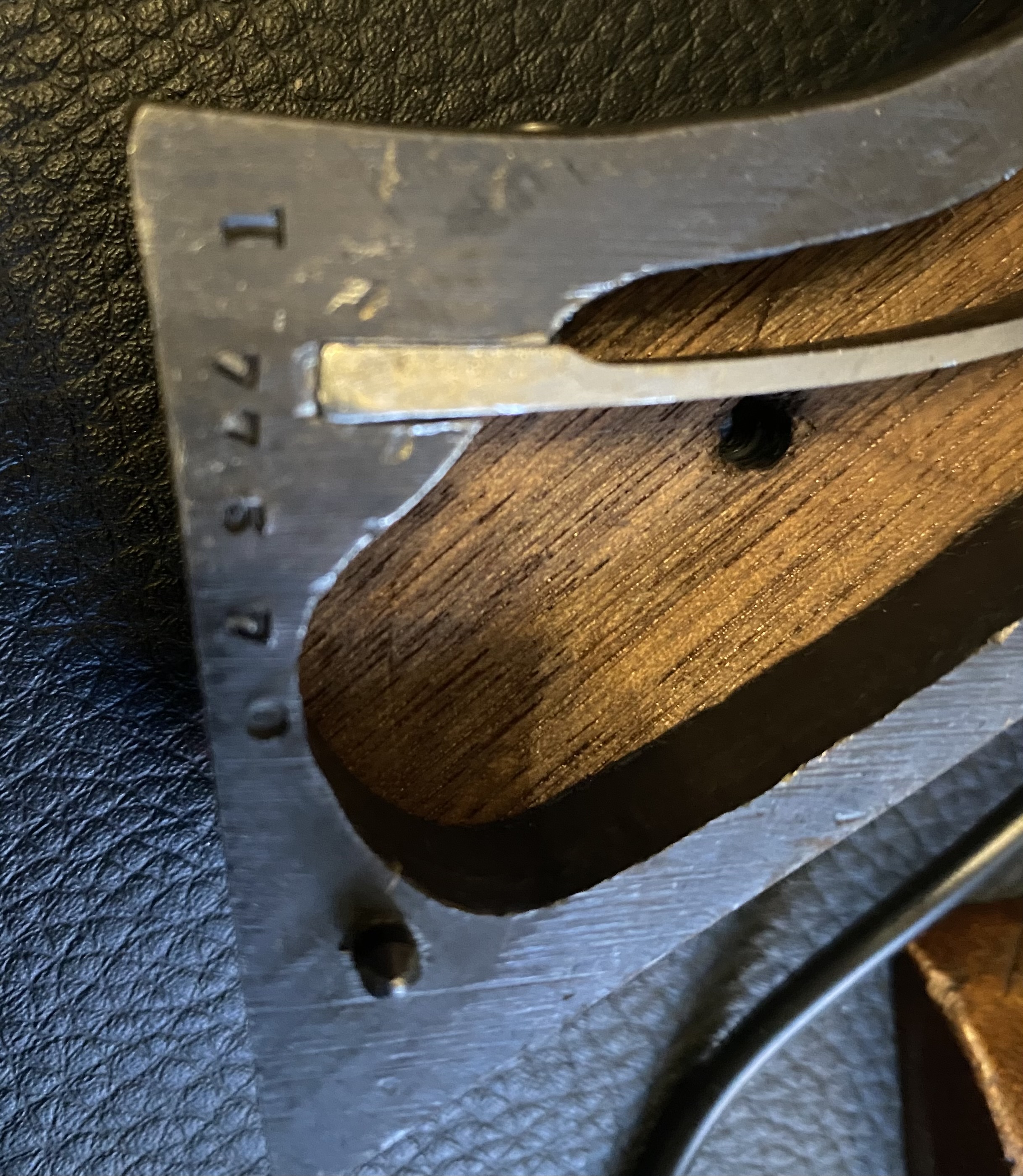

Your pictures seem to indicate a S/N of 7570 which still a very early example. Hope that the S/N on the frame is the same as many damaged guns were rebuilt as needed using parts from other damaged guns.
Hi thank you for your help, I’ve taken a picture of the frame it could well be the same number, what do you think?
